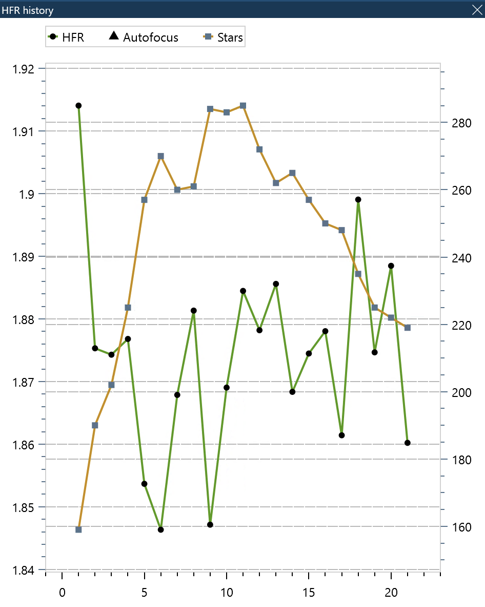

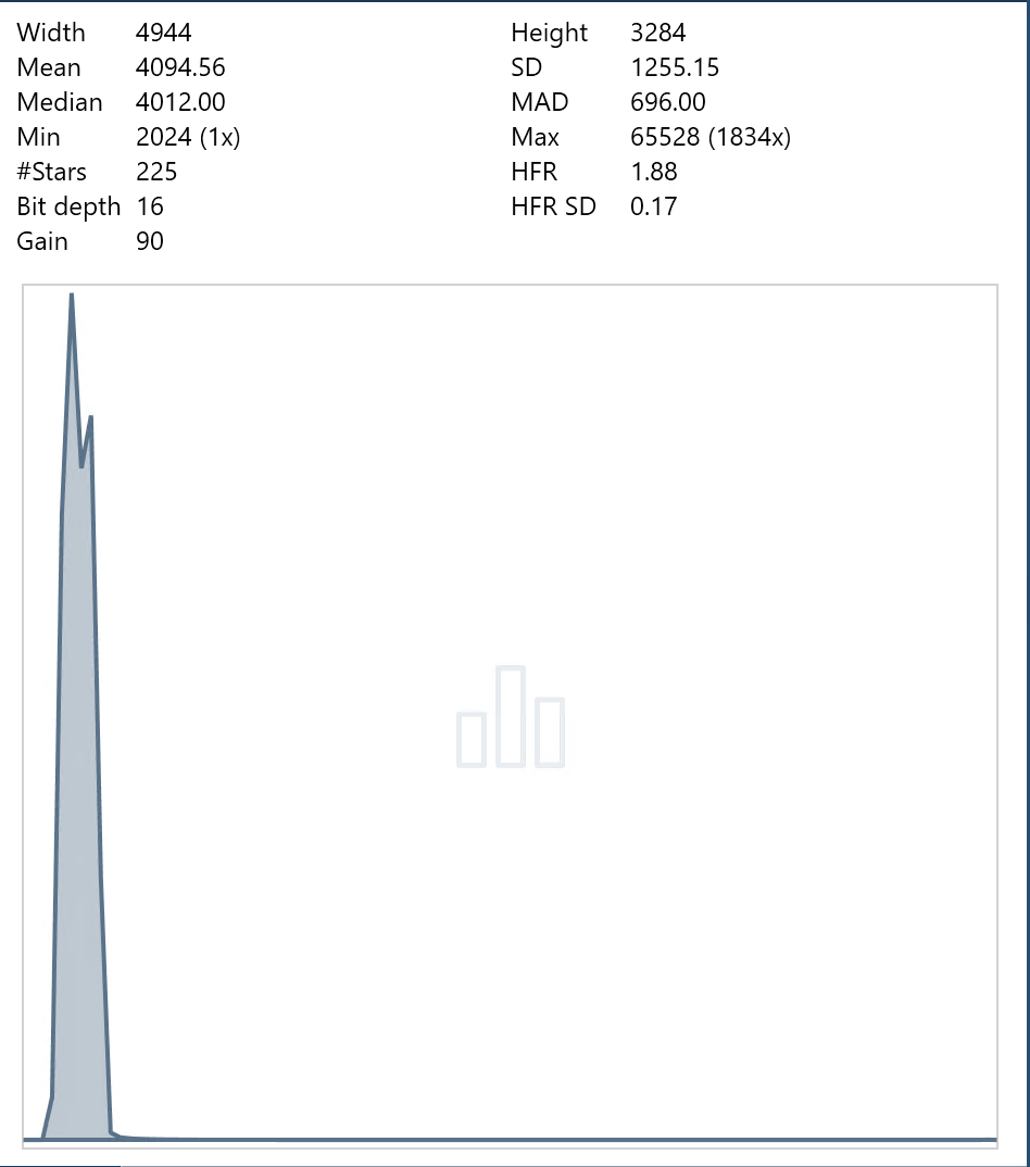

Just started my first test with Panel 618, it is not yet completely dark but the moon will not rise until in 30 minutes. Using 2 minute exposures with my Samyang 135 f2.0@F2 and ASI071MCPro with gain 90.
Nina Statistics tell me that I have 1800 blown out pixels, so I think I am on a good way, any thoughts on optimizing those settings, Stars acceptable? I think I see a little tilt on the left side, seems I will need to do another round of aberation inspector
Guiding with my Staradventurer GTI is at 1.12", this is a really calm night, too bad that the moon will soon destroy all this.

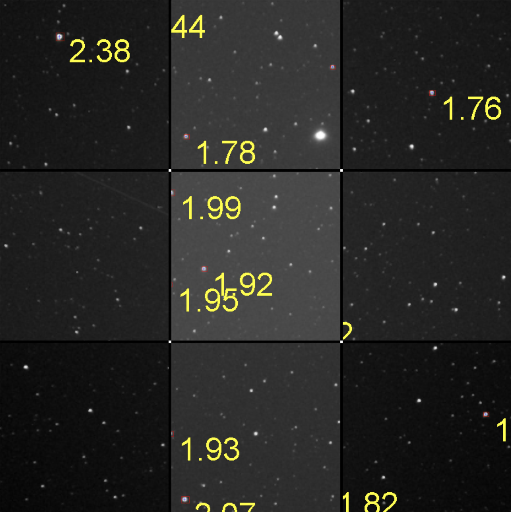

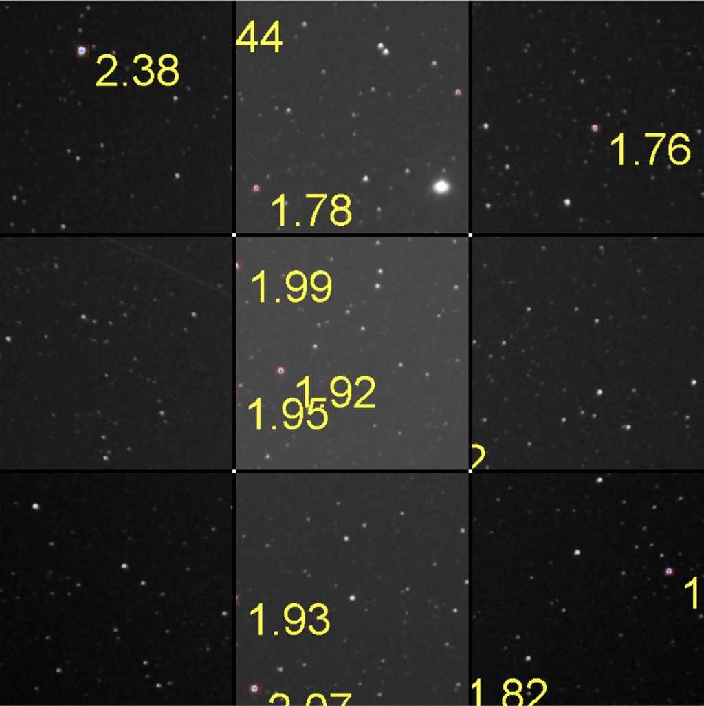

First statistics from Subframe Selector for the first 13 subs are now also available, FWHM is arround 1.42 Eccentricy is a little high with 0.74, SNR at 1.32
Michael

Hi Michael,
that looks pretty good to me!
Yes, the stars aren't perfect, but I guess we first can't expect that, and secondly they are better than many images shown online, so that is more than enough (at least in my humble opinion).
To me, the settings seem good, but since I only use DSLRs, I can't tell that much about it.
However, I guess we can't compare the SNR number you mentioned directly to the desired SNR of the survey. If I remember correctly, the SNR was specified for a star of a certain brightness, whereas the number mentioned in image processing tools is computed on the whole image and has another meaning.
CS Gerrit
MichaelRing 4.64
The SNR number is for a single frame, nothing stacked yet. Wonder if those numbers will be compareable to numbers of other users in Bortle 4 skies..... I will definitely learn a lot in this project that will also make my astro pics in general better, glad that Brian started this.
The number or stars is now sinking, the big bad moon is arround the corner to tell me it is time to soon go to bed....
