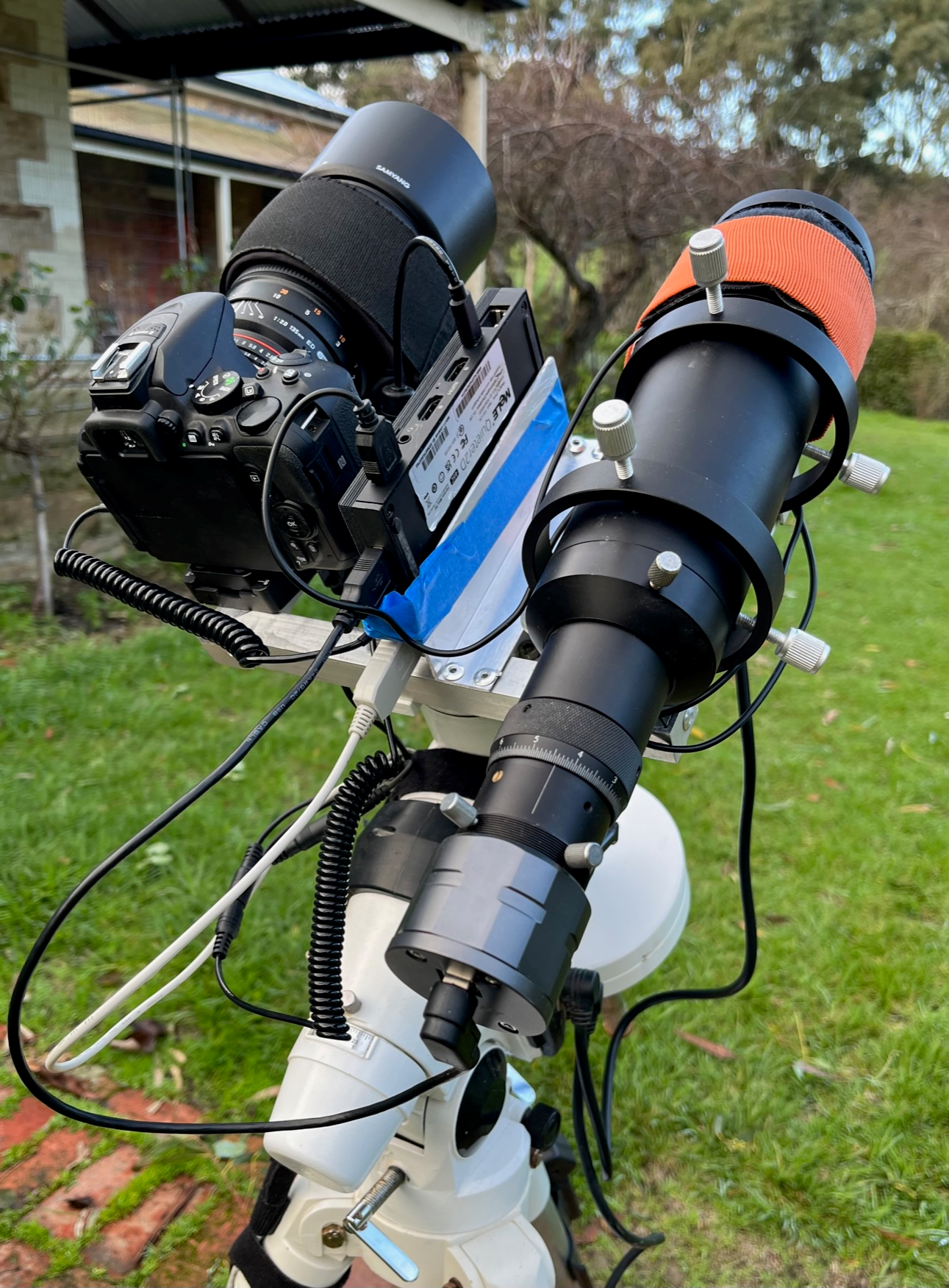

First attempt at a rig after discovering that the Samyang 135 + Nikon is just too heavy to bolt on top of my normal scope. Learnings: - I need to rotate the camera 90 degrees (cue embarrassment)- - Mounting the camera via the normal shoe just isn't good enough - this lens is heavy! - The lightweight aluminium tubing I used has too much flex - Polar alignment in NINA using the Samyang really struggled. Successive attempts had me shifting things back and forth by a degree or more, and constant corrections during guiding indicated that even then the alignment was significantly off. I ended up using the guide scope for polar alignement and that worked a lot better. - Focus on the Samyang is really touchy and needed regular tweaking. I need to figure out how to connect my EAF I've ordered another pair of 3-point mounting rings, which should take care of supporting the camera + lens and allowing for rotation. Hopefully a steel top plate will fix up the stiffness issues. Does anyone have any experience of the Astrodymium or Hyperpod 135 mounting systems? Both look like an all-in-one solution for mounting, focussing and rotation.  |

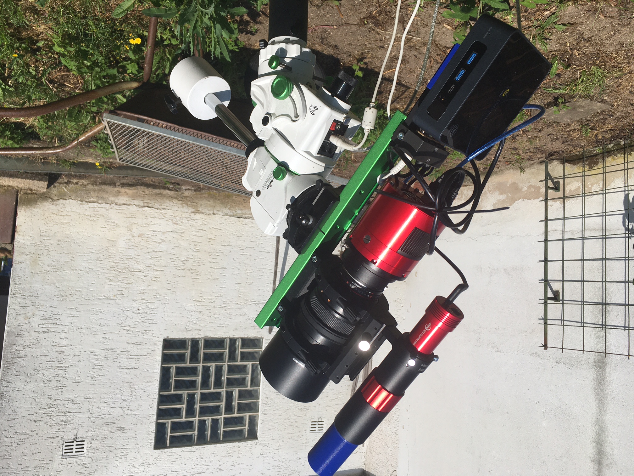

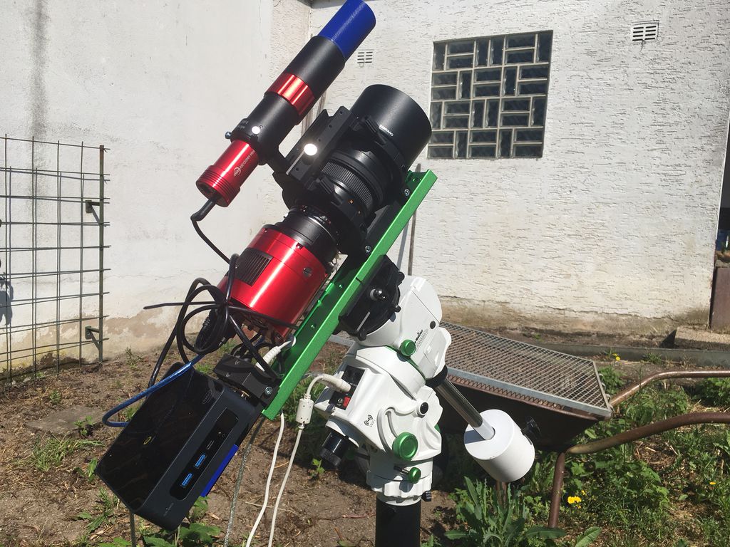

 Since we are sharing I thought I would show you my rig. [Note I just took the lens cover off and the air temp has been pretty much tracking the dew point for the past week - both around 0C - so the plastic lens hood looks a bit damp... ] Its a Nikor 200mm f2 with a ZWO ASI 2400MC. The lens is fabulously expensive new [its a 100mm f2 refractor] but I got it for 1/10th the price on ebay becasue the AF didn't work. Sometimes you just get lucky.... As you can see I don't have an off the shelf system for bolting on guide scopes and focussers. My ZWO EAF focusser is attached to the focus ring via a 3D printer capstan (on the EAF spindle) and 3D printer belt. Various ARCA clamps and other photogrpahic brackets have been repurposed to build something of a Frankenstein's monster of a wide-field field. It is heavy (10kg) and I needed an EQ5 mount. I did try the EQM35 but it was a pile of s**t. Control via ZWO ASIair and tracking better than 1arsec with the ZWO ASI120MM mini and an Astrozap dew strap with heating on max for these cold nights where I am close to the dew point. [As you can see I am a bit of a ZWO fanboy.] Oh, and yes, my cable management is truly apocalyptic. I just don't have a neat and tidy mind. I run the Nikor wide open. I used to stop down, using a bit of a plastic milk carton inserted into the aperture mechanism on the lens, but the image quality gain v speed losses weren't worth it. And certainly not now Blur Xterminator exists as a robust deconvolution option. As I previously said, not using deconvolution is like not photometrically calibrating your data. Data simply isn't data until you take as much of the instrumental response out. I am pretty happy with my system - it is very fast. Although I did make life hard for myself by going the 200mm focal length route. I do look at Samyang/Rokinon 135mm f1.4 owners, and the Astrodynium bracket with envy. A lot of good reports on it by AB users I respect. So @James Tickner if your wallet can afford it, I think it is a wise investment. CS Brian

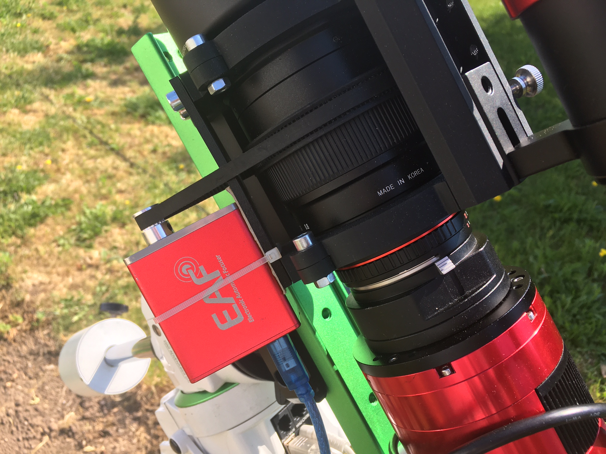

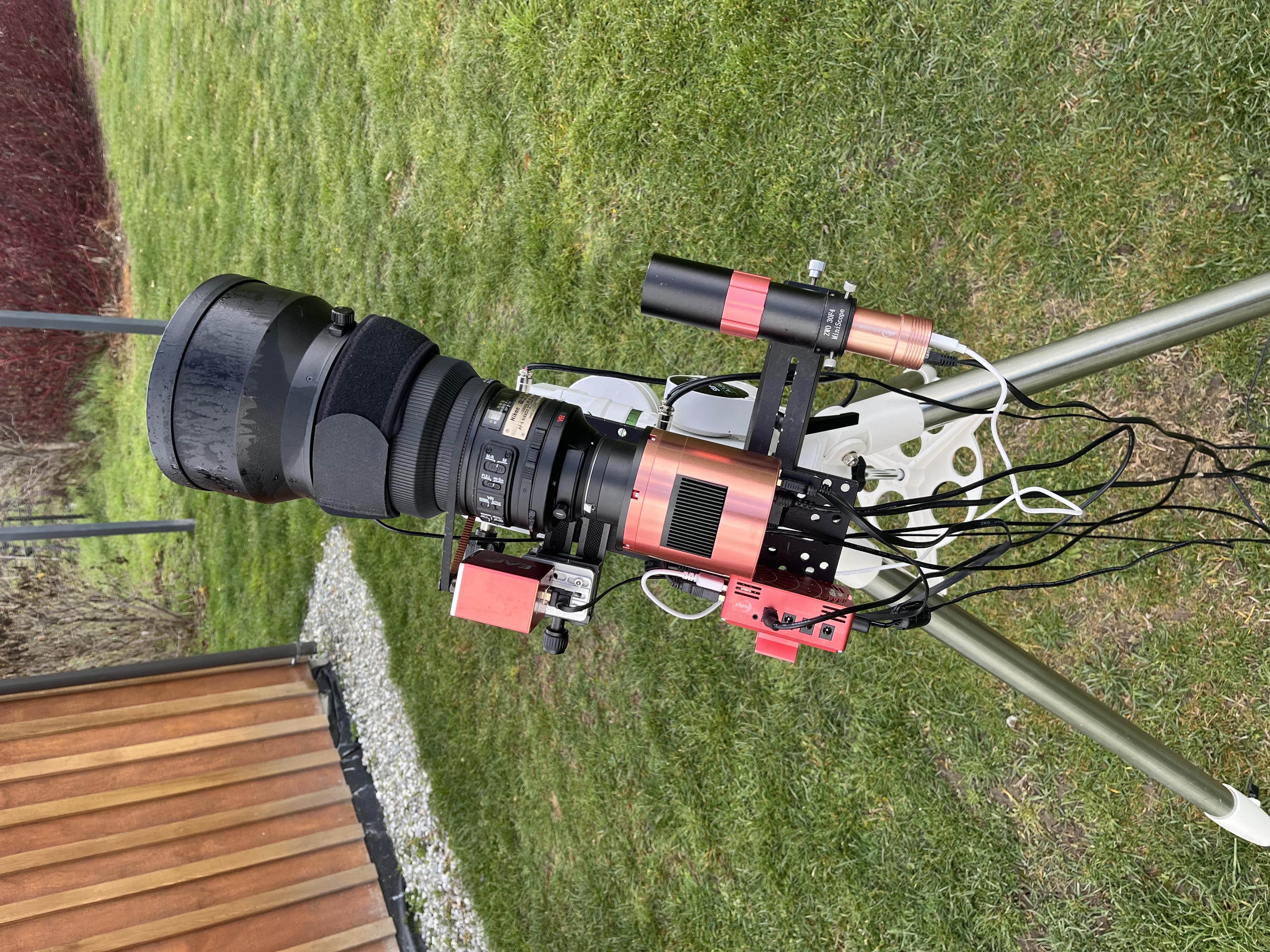

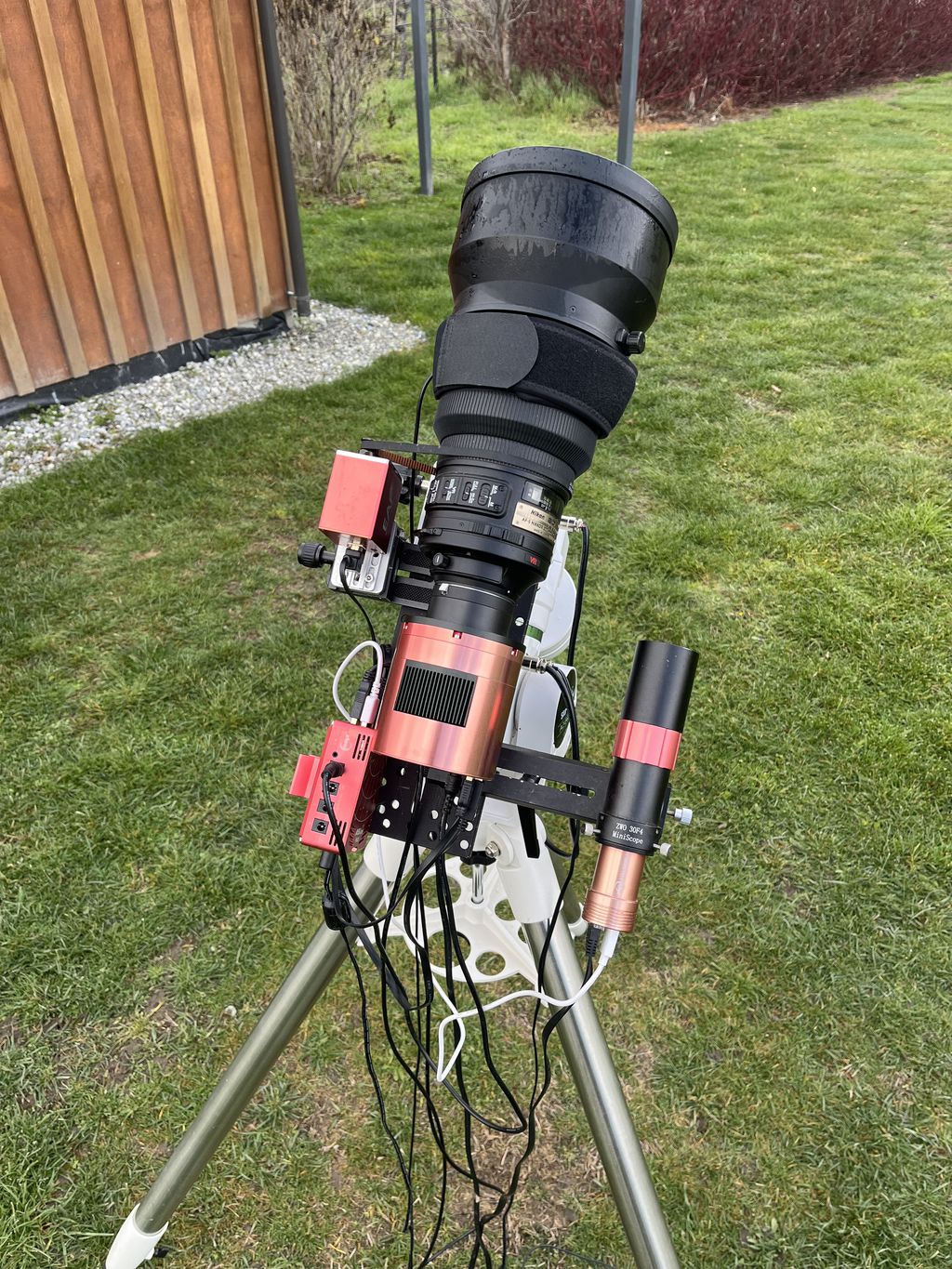

Here's my current rig, all parts besides the green vixen rail are 3D printed, please excuse the mess at my Parent's home.... The focusser is easy to attach, see the extra picture. For my 400mm twins (Two Esprit ED80 lenses) I use this as a mounting solution: https://www.teleskop-express.de/shop/product_info.php/info/p4430_TS-Optics-Doppelbefestigung-Losmandy-Level-fuer-parallele-Befestigung.htmlIt is a sturdy solution for a fair price. @James Tickner If you want I can 3D print that focussing ring, with this and a GT2-Belt it is easy to attach a ZWO Autofocusser to the system (or share the STL in case you have access to a 3D printer). I am currently designing a V2 of my mounting solution for the Samyang, it will come with a built in Rotator and a focusser attachment that will rotate with the lens, the main drawback of my V1 solution is that when I rotate the lens I have to redo Focus or, even worse, have to detach the focusser to be able to rotate. V2 will fix that. Michael   |

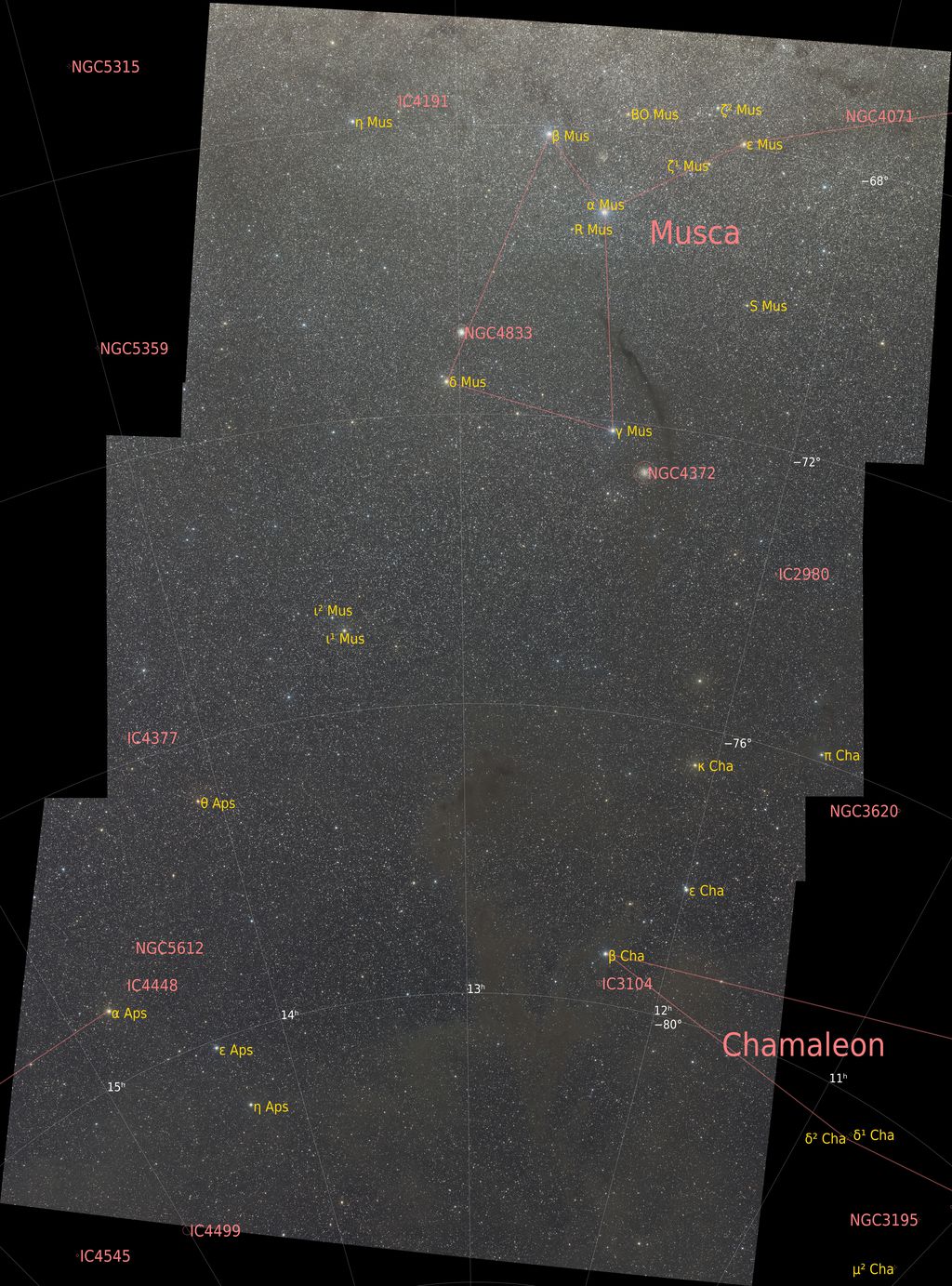

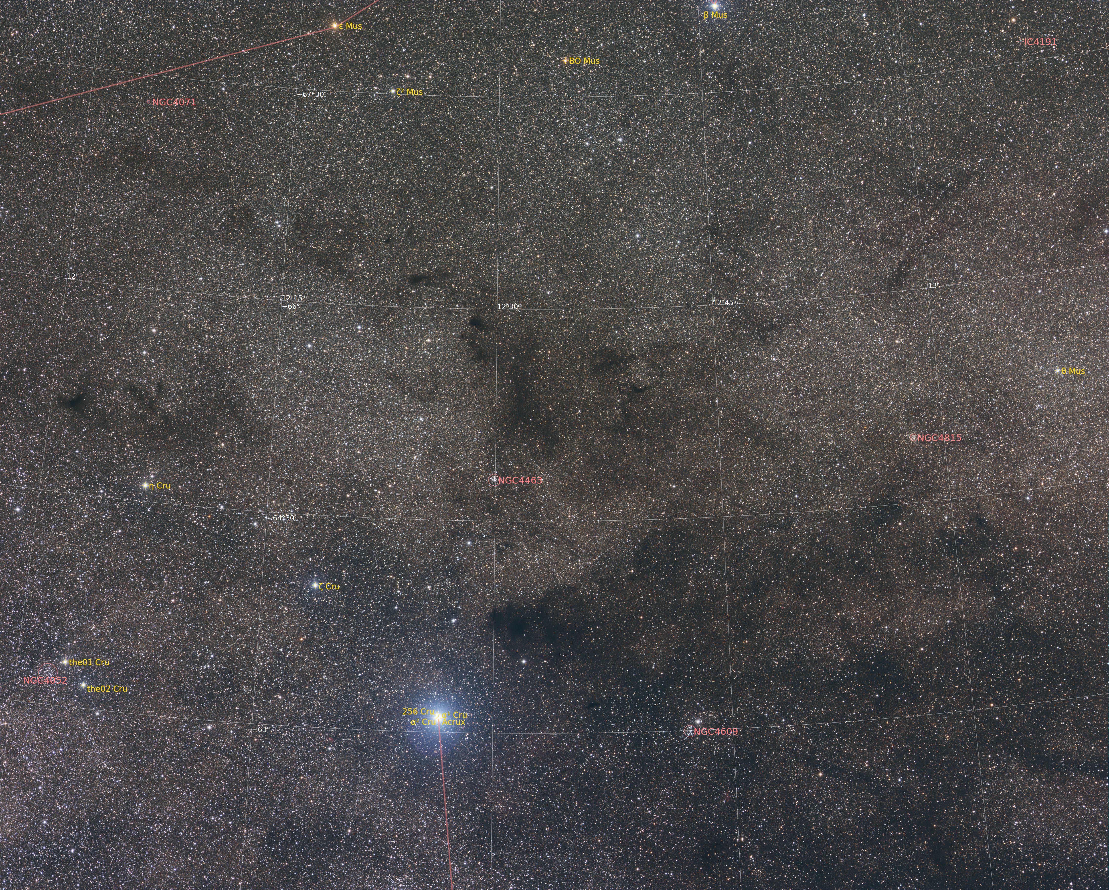

Brian Boyle: ASI2400mC Full frame at 200mm focal length. Based on the position of Beta Mus on both our images, I reckon we have about 1.5degs of overlap....
CS Brian As I said before, it's at lower Dec that the missing overlap exist. I'll need to move to lower Dec to have a full coverage.

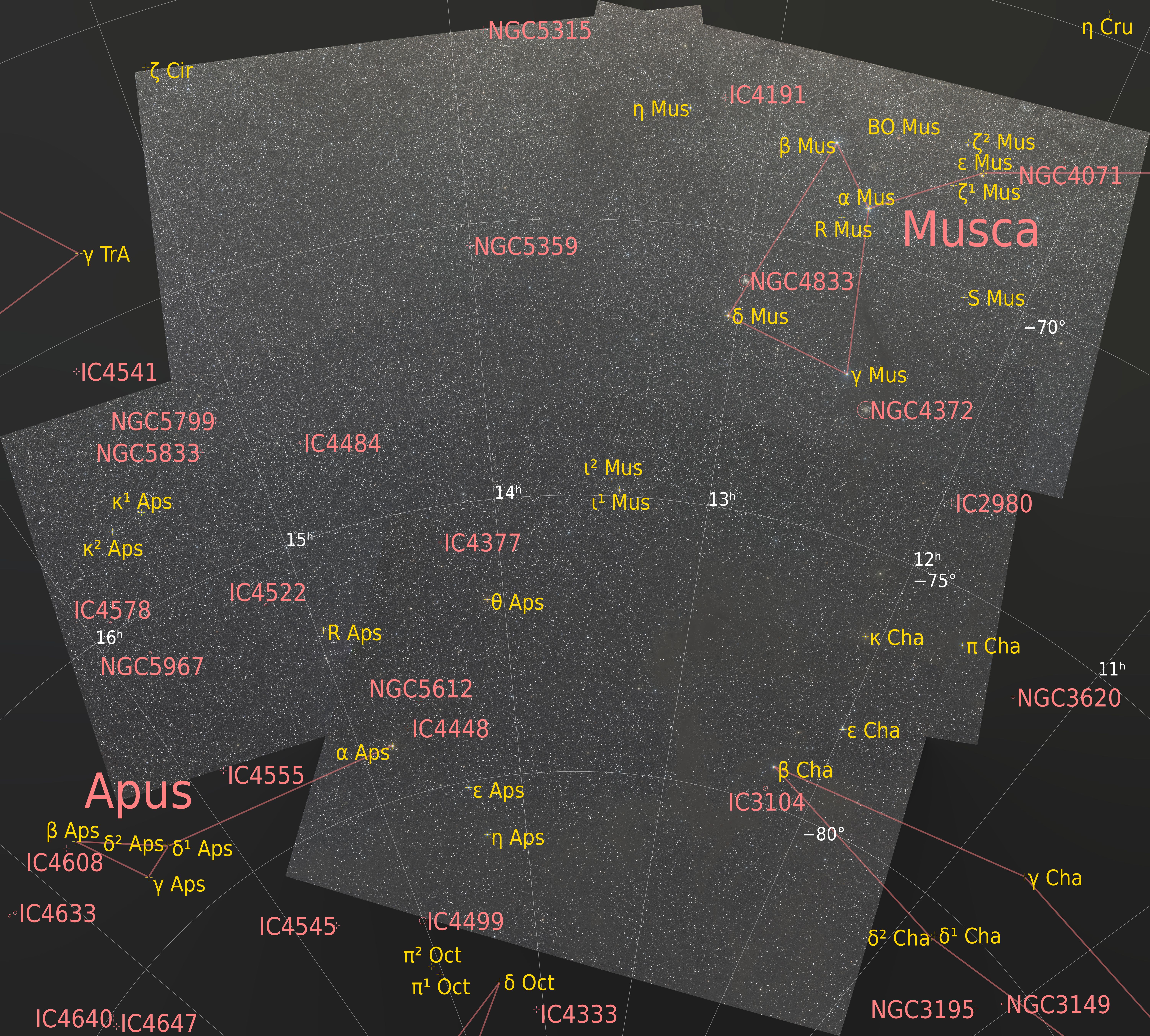

Here is a quick and dirty PI GradientMergeMosaic from a MosaicByCoordinates using Hammer-Aitoff projection of the first five fields I have covered. Note that Field 24 has some fog during the exposures which resulted in halos around the stars - I am retaking the data as I write. The PI Merge is not great - obvious seams exists (very noticale when you apply STF without ouf the black missing data. Does anyone know how to make PI work at doing mosaics. I use APP, but I beleive we agreed not to go there. But its a start - and the tiling works geometrically!  |
CS Brian As I said before, it's at lower Dec that the missing overlap exist. I'll need to move to lower Dec to have a full coverage. @andrea tasselli Apologies, I misunderstood. By lower dec I thought you meant more southerly dec.
@Brian Boyle Looking good! Do I see correctly that the belt from the EAF is directly wrapped around the ribbed rubber focus grip? I was playing with that idea, but noticed that the commercial 3D printed mounts have a toothed gear that clamps onto the focus instead. Do you find your approach works well? Certainly looks simpler. For cables (and all sorts of other bits and pieces) I'm a big Aliexpress fan. There are loads of suppliers providing USB cables in every length and connector combination - I tend to go for really short leads with right-angle connectors (you can choose the direction) so that the cables emerge from the different devices heading the right way. Plus they're usually really cheap! Good to see the EQ5 as well. That's my only mount at the moment and it definitely gets loaded up to the limit.
Brian Boyle: The PI Merge is not great - obvious seams exists (very noticale when you apply STF without ouf the black missing data. Does anyone know how to make PI work at doing mosaics. I use APP, but I beleive we agreed not to go there. Glad to see the geometry bits are correct, one less thing to worry about. GradientMergeMosaic doesn't do that well depending on the degree of feathering and the size of the overlap. Usually, making smaller overlapping areas makes the job easier.
Michael Ring: Here's my current rig, all parts besides the green vixen rail are 3D printed, please excuse the mess at my Parent's home.... The focusser is easy to attach, see the extra picture. For my 400mm twins (Two Esprit ED80 lenses) I use this as a mounting solution: https://www.teleskop-express.de/shop/product_info.php/info/p4430_TS-Optics-Doppelbefestigung-Losmandy-Level-fuer-parallele-Befestigung.html

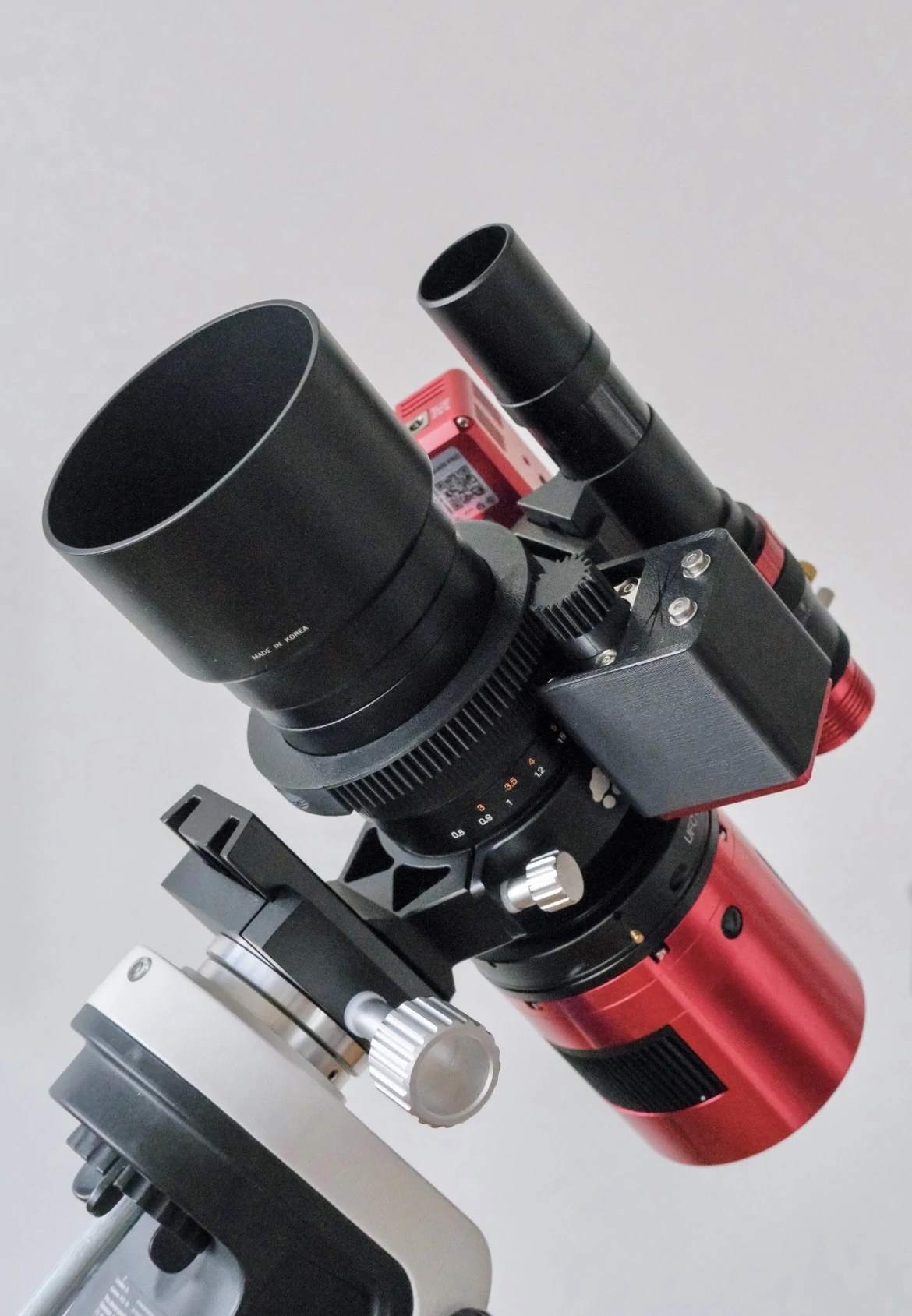

Michael @Michael Ring If you could PM me the STL file for the focussing ring that would be great. Did you also print your own mounting rings?
James Tickner: @Brian Boyle Looking good!
Good to see the EQ5 as well. That's my only mount at the moment and it definitely gets loaded up to the limit. Yes it is - and it works well. I get a consistent focus with the EAF every time. I do do need a few spares however. It has survived one winter of sub-zero nights, not too sure about this one.... CS Brian
Glad to see the geometry bits are correct, one less thing to worry about. GradientMergeMosaic doesn't do that well depending on the degree of feathering and the size of the overlap. Usually, making smaller overlapping areas makes the job easier. @andrea tasselli Thanks, I might try that. Certainly making the fields a little smaller (to reduce the overlap) also takes one further from the vignetted areas in corcens what the flat-field correction is noisier. Brian

Brian Boyle: Here is a quick and dirty PI GradientMergeMosaic from a MosaicByCoordinates using Hammer-Aitoff projection of the first five fields I have covered.

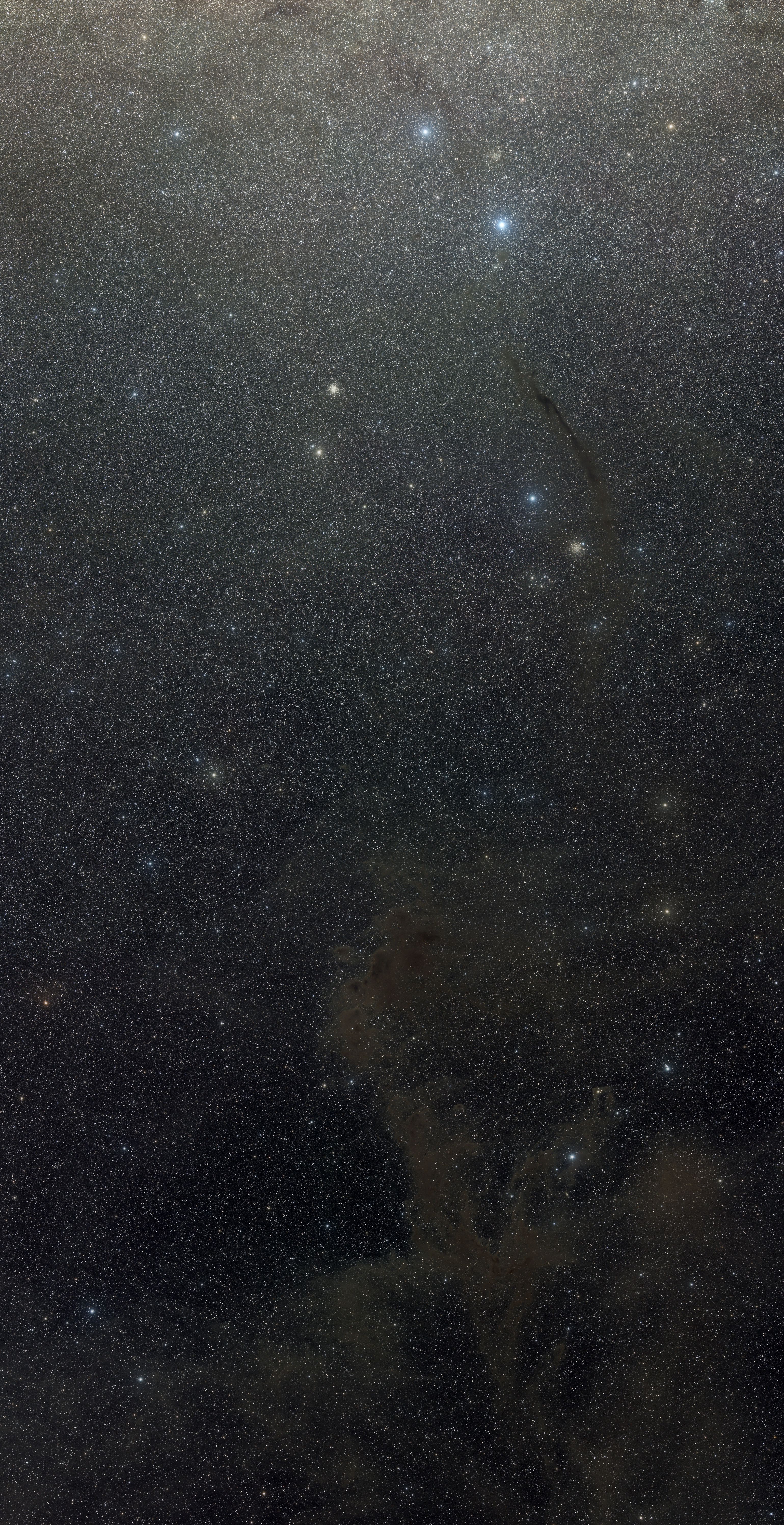

This is Field 58, with south on top. I'll have to share the RGB composite as some point while I ponder what to do next, probably start shooting around the equator. Field58_Chilescope_T4_RGB.jpg |
