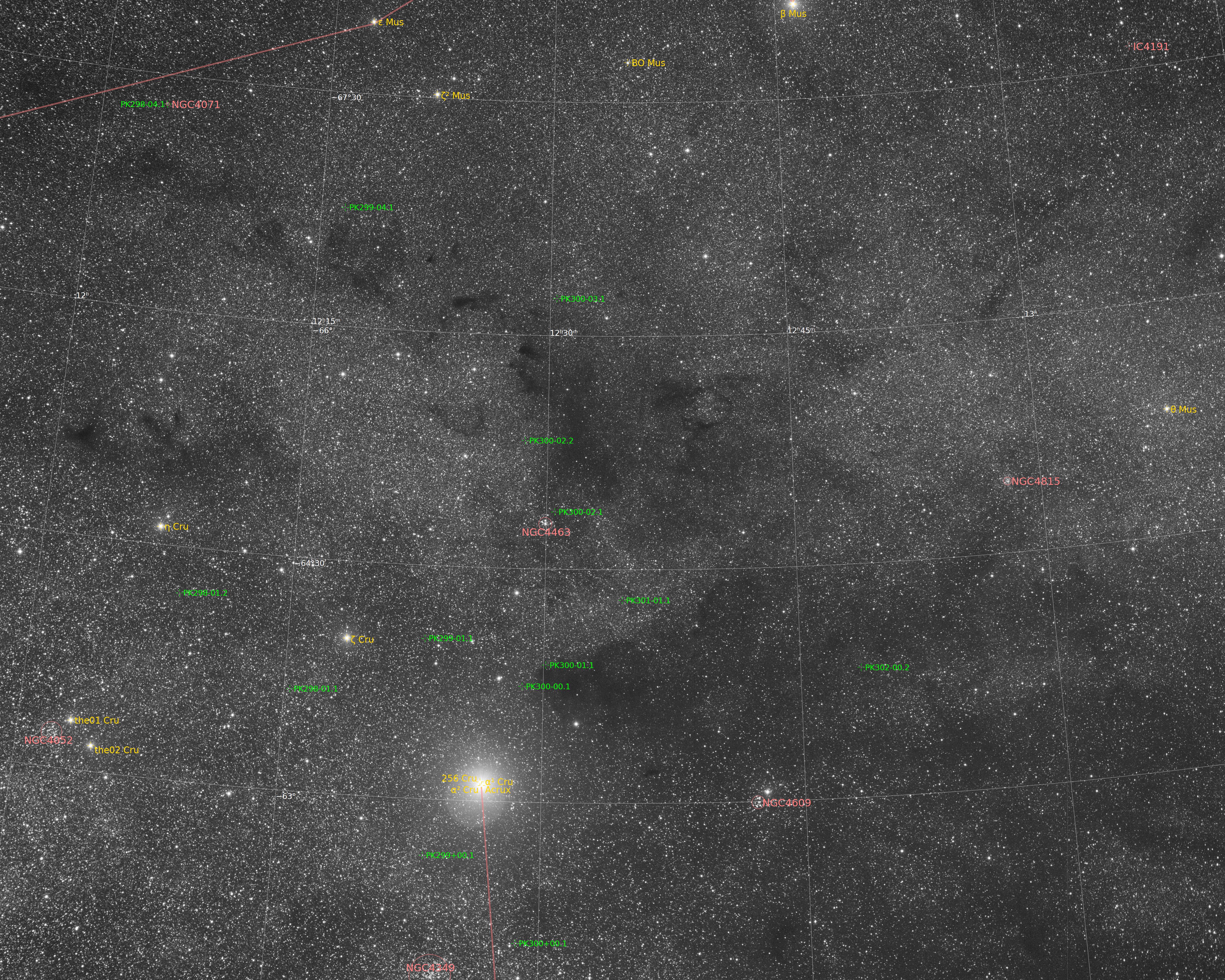

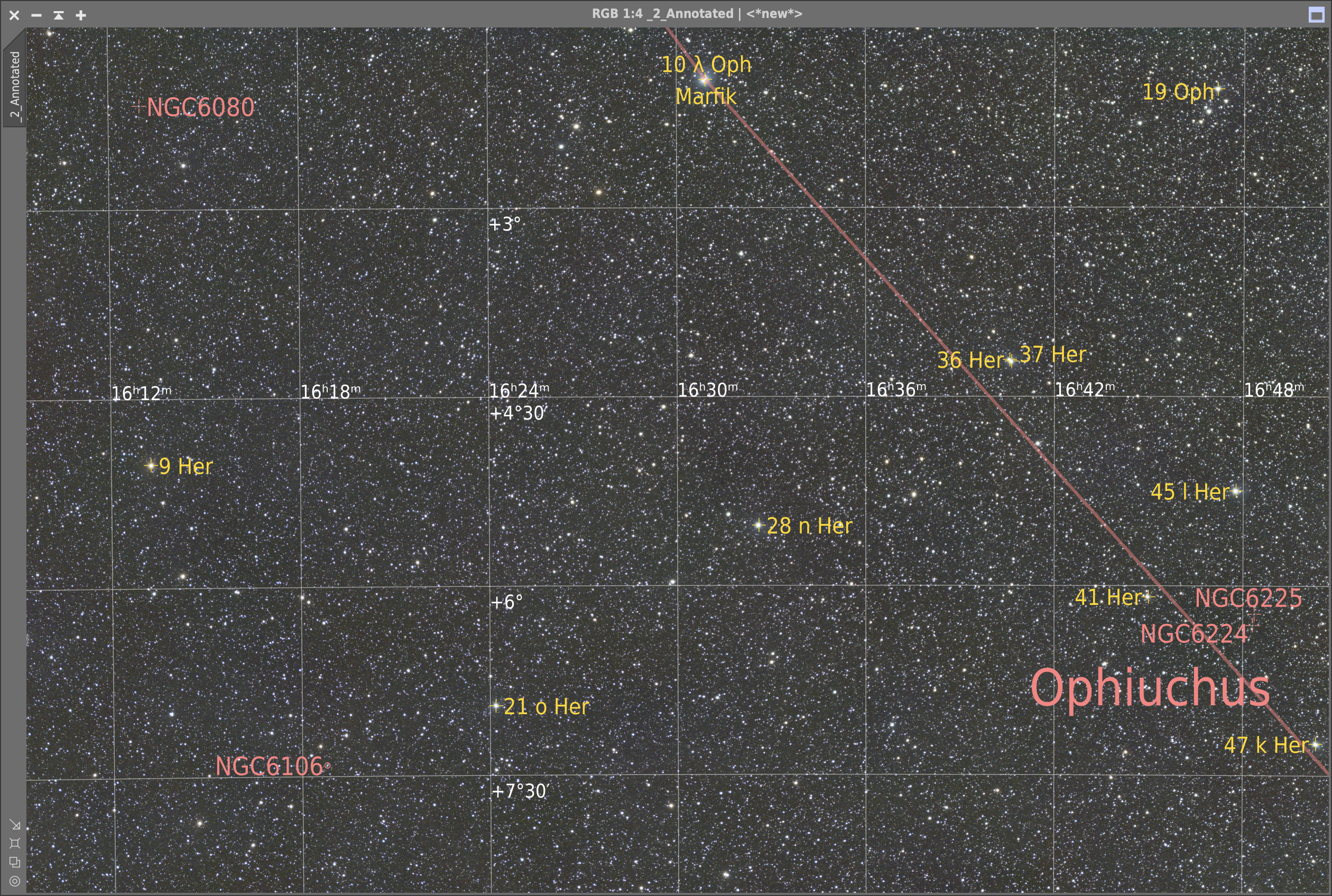

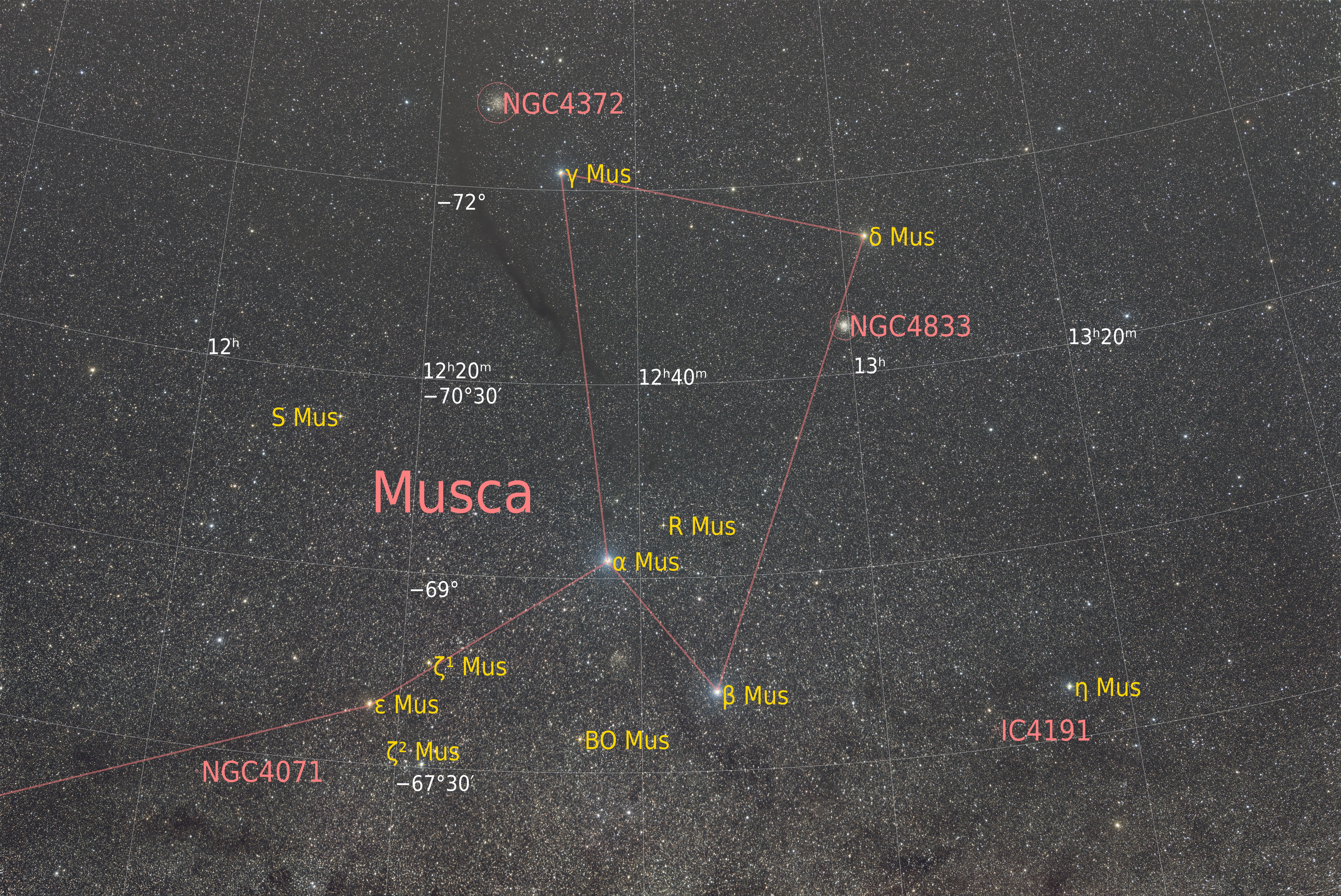

Managed 29 x 180sec sub frames on Field 39 over last two nights before fog rolled in.  Poor transparency on about half of them, I reckon an 1hr effective expsosure time.  However, I am in Bortle 2 and have a 200mm f/2 camera, so that should almost be enough.
Will check the SNR tomorrow after a bit of sleep, but for now here's the annotated image with STF applied.  Ir has south at the top, as befitting our field grid.
The Dark Doodad and C108 - nice!
Only 1119 fields still to go

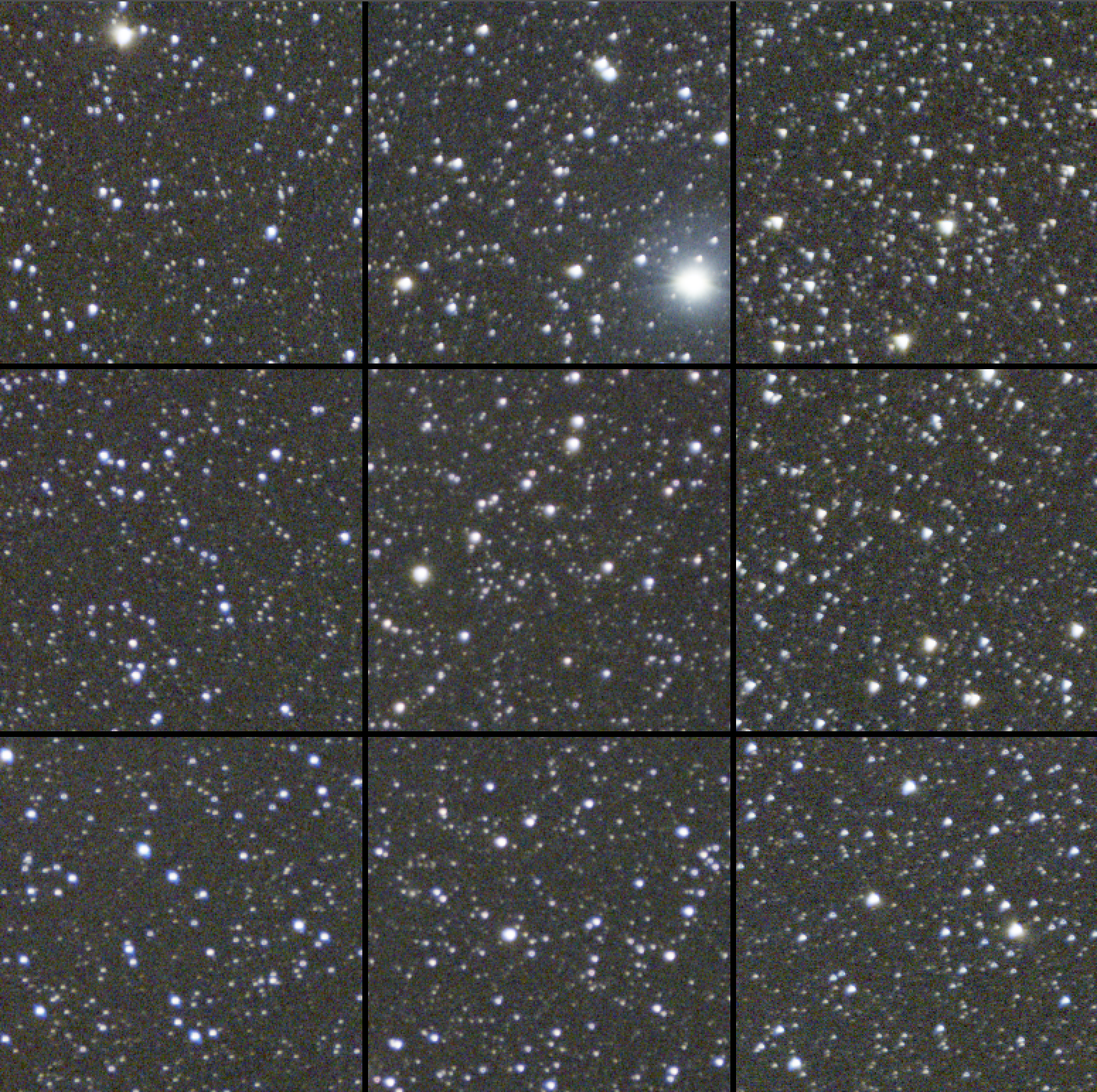

We need to check if quality of my subs is good enough, the stars in some corners are a bit triangular and applying BlurXterminator is making star shapes even worse.
Any help from other Samyang Users is highly apprechiated, I am just printing an aperture ring to step down the lens a little bit but the triangular shaped stars more feel like pinched optics.

Are you using a FF or APS-C? as for the star shapes and colours, the lens suffers from coma rather than tri-foil, with chromatic variation of the same. I though the Samyang haa an aperture stop but if you don't like the star-burst effects then you can put a step-down adapter (or series of such) to achieve the equivalent effect.
MichaelRing 4.64
Sensor is APS-C size, ASI071MCPro.
The lens does have an aperature ring but I am in the mood for experiments and thought I try the aperture rings as my 3d printer felt a little bored anyway…

Thanks James. I chose the field because it was on the meridian during moon down at the start of the night, and -70 because I am already at lat -45.

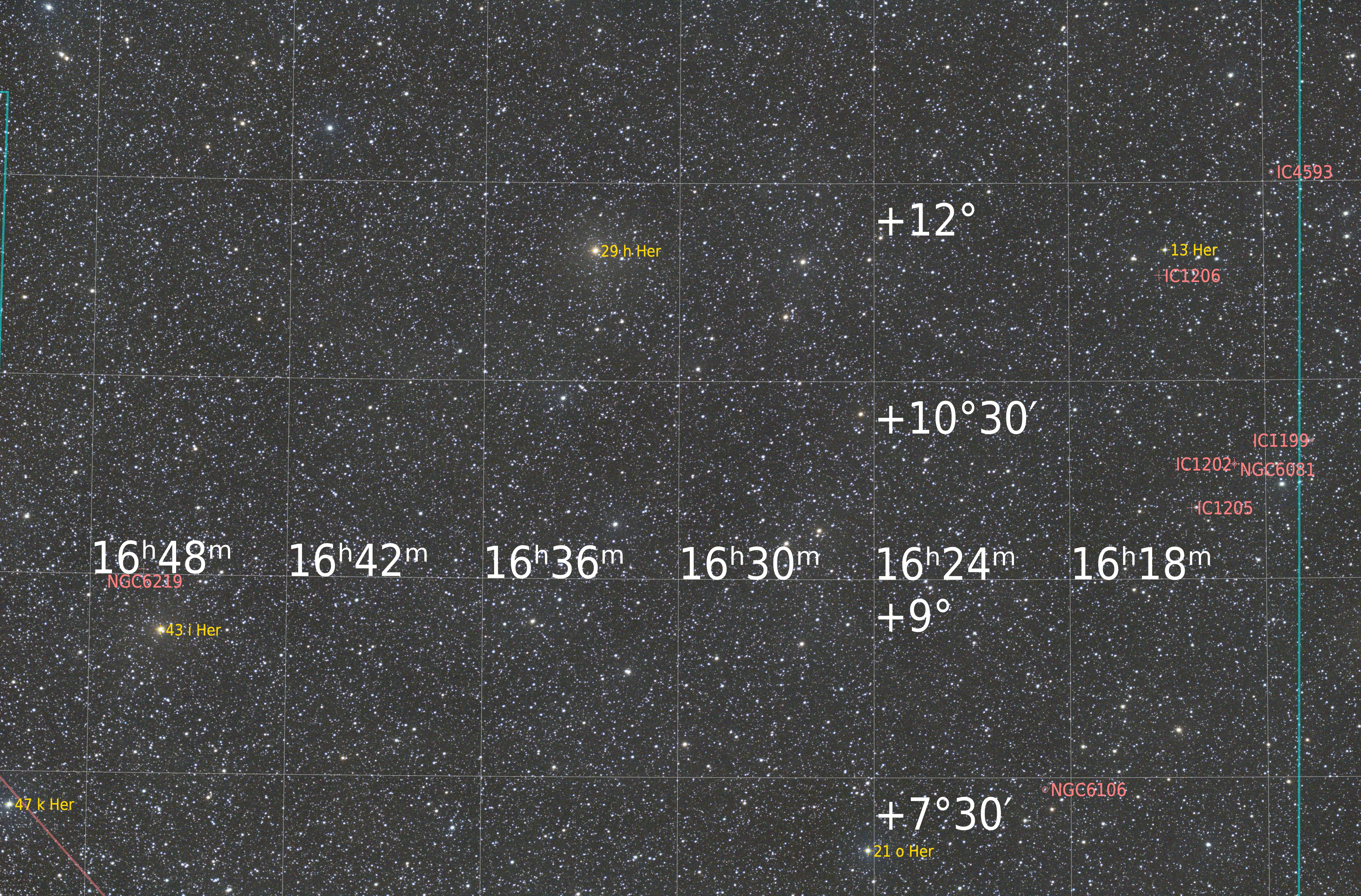

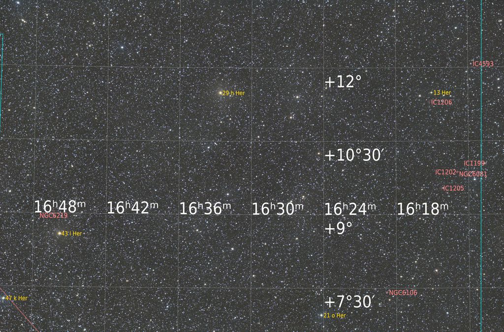

Yesterday I was able to start Field 666, another one of those boring fields with not much going on.
The question is what to do with those areas, do we want to keep up our quality oriented rules or is there an option for shortcuts?
Two things that come to my mind is allowing non Astro-modded DSLR's in those areas (I could then do 2 boring fields in one session because of the larger sensor) or/and to allow shorter integration times.
The following is done with 1.5hrs and not perfect skies, there were some high clouds yesterday but still, could it be good enough for such an area? What do you guys think?

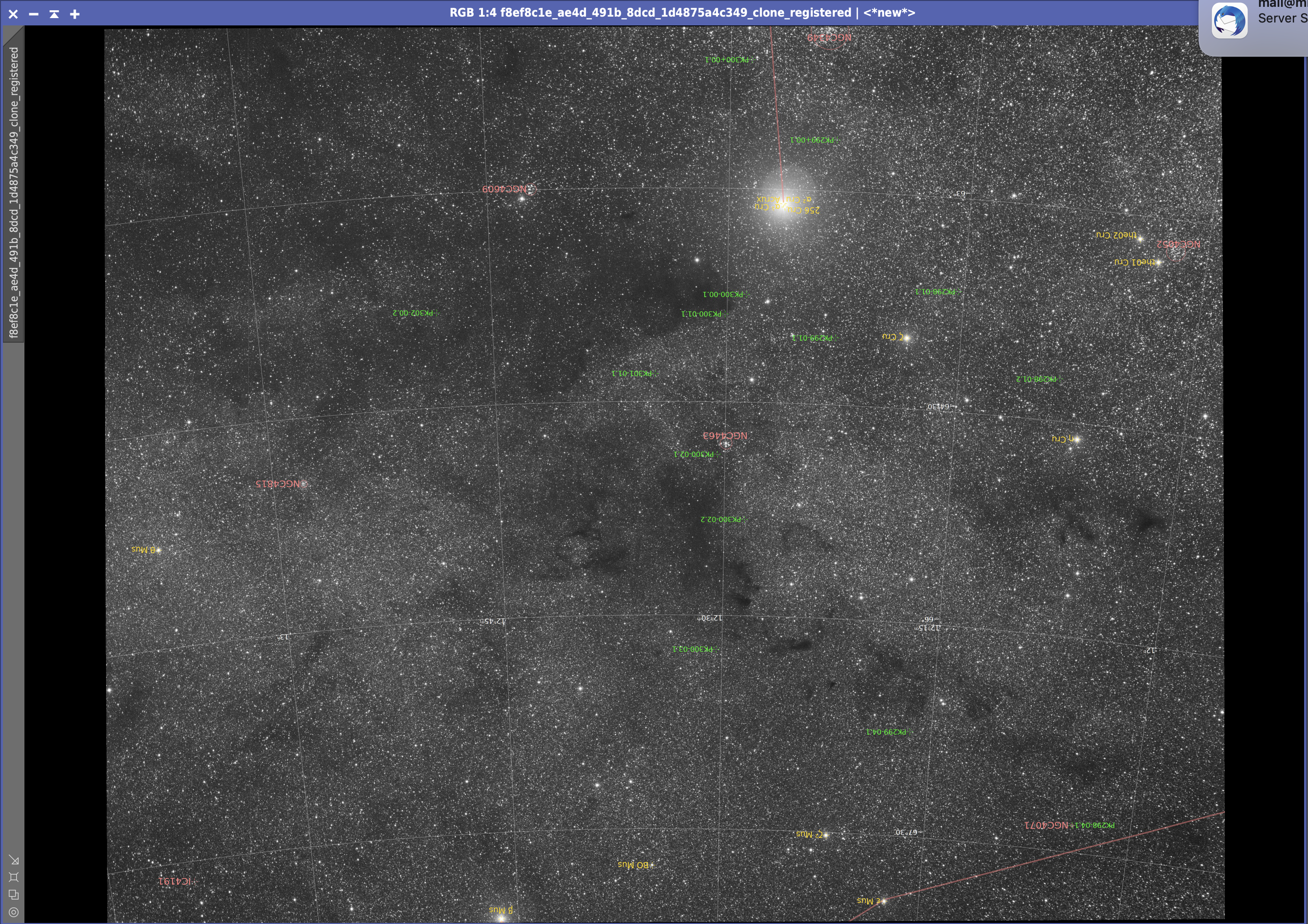

Here is one frame (B) from my field (58). I hope it is wide enough as I'm bit tight in RA (using a FLI Proline 16200).

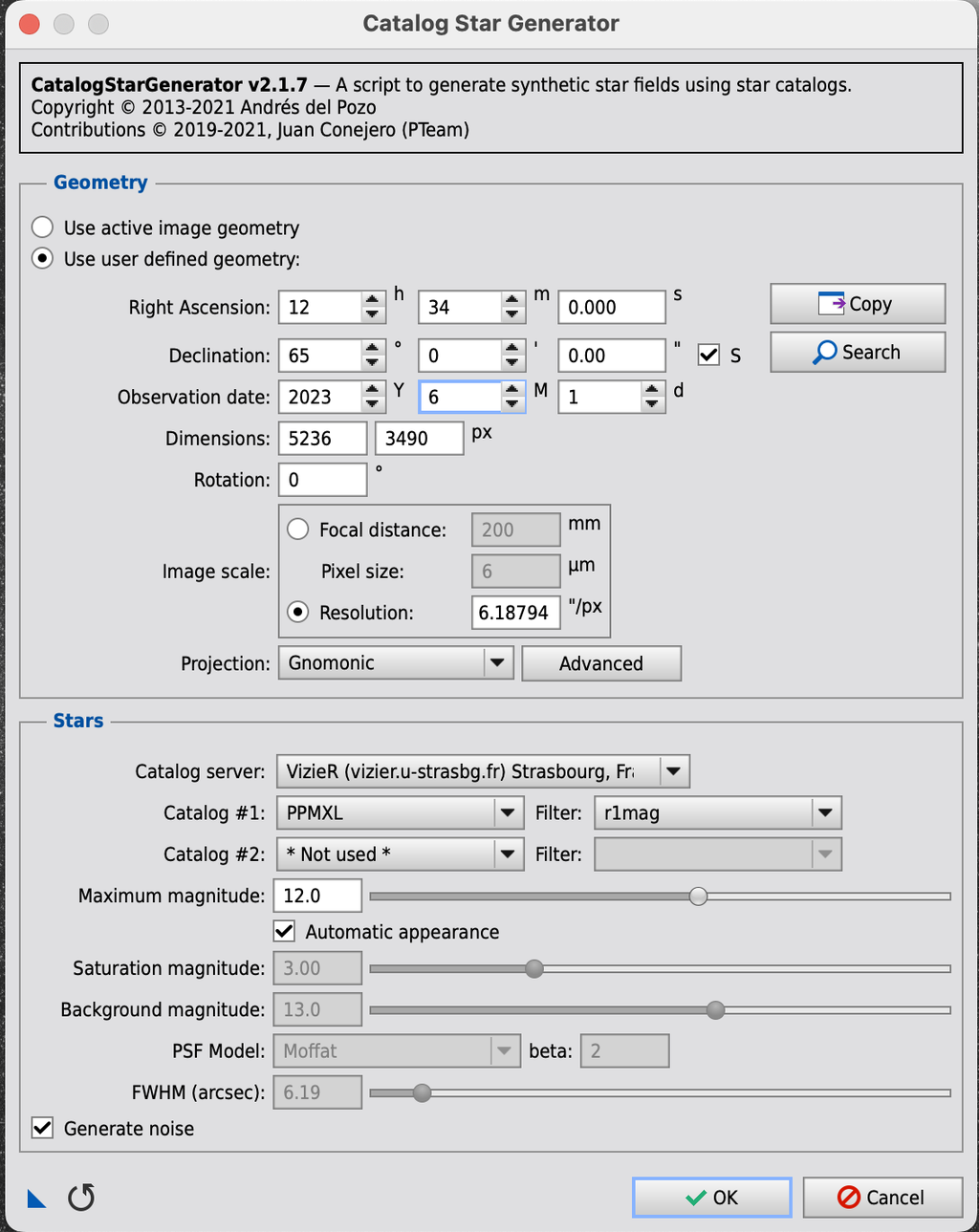

You can check with CatalogStarGenerator if you framing is OK. When you provide your focal length I can also create a reference image for you
Michael
Michael Ring:
Michael
Can't see how. Never mind it doesn't work.

Yepp, there's quite a bit missing left & right, the black parts in this pic should not be black:

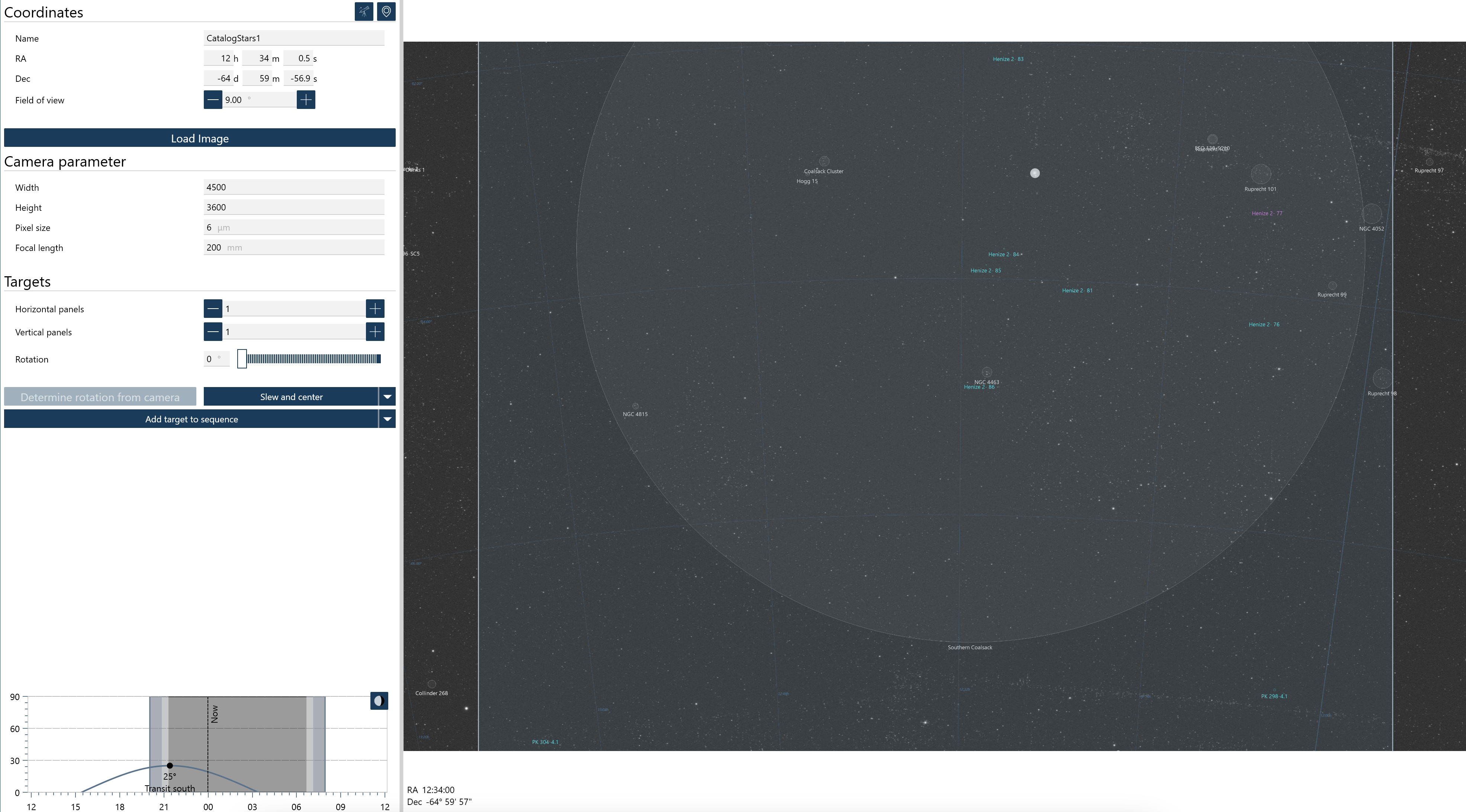

N.I.N.A also agrees, the white lines show the limits of your sensor, the background is the 9x6 sized field:

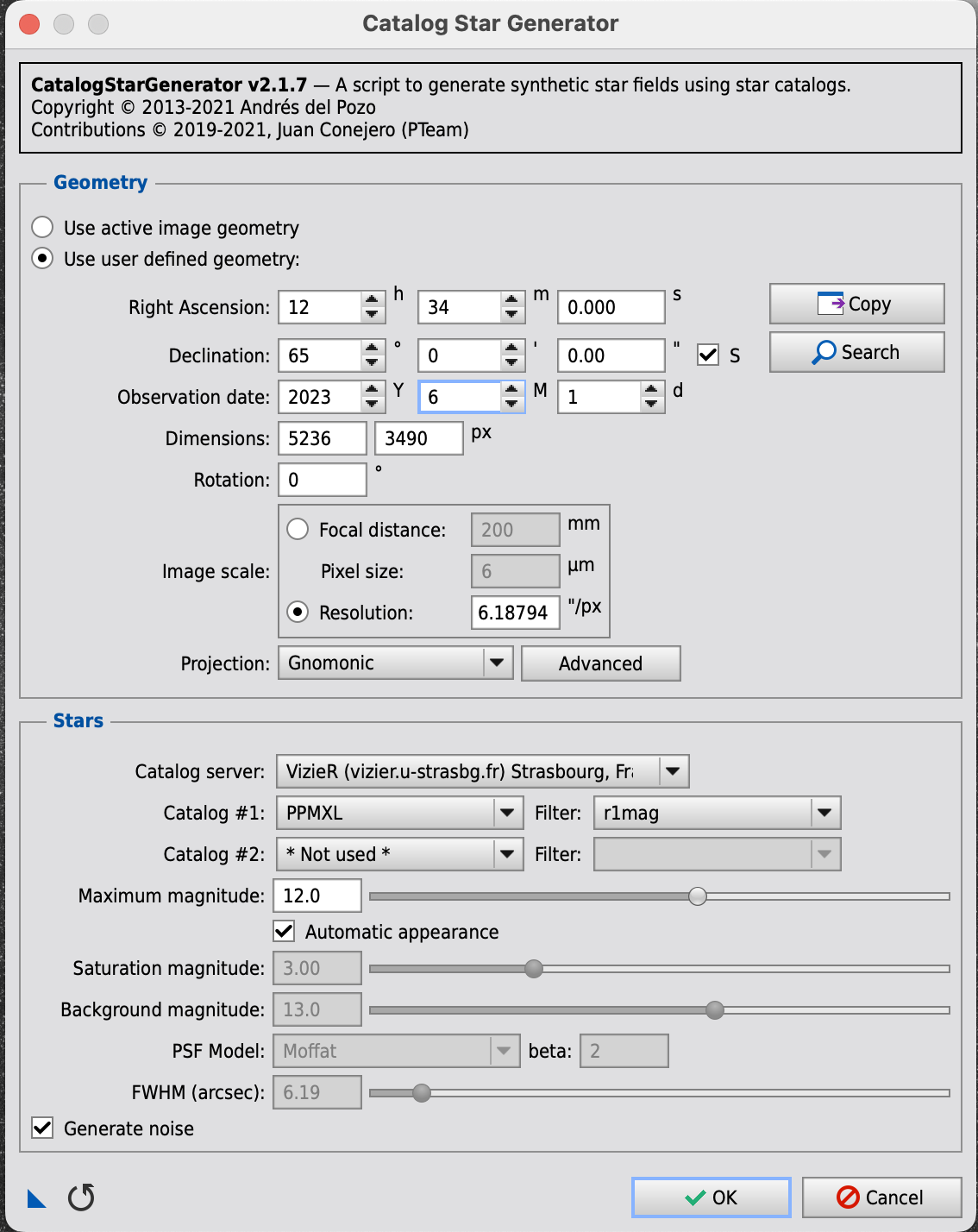

Here are the parameters required to draw your 9x6 tile:
