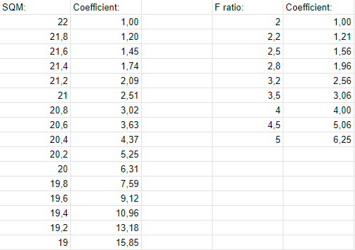

Your Bortle 4 = 4 times exposure time fits well with my table, so if someone is short on time or wants to fit in as closely as possible, he can use those values to calculate the needed time.
I can't really comment on your moonlight considerations, as my Bortle 6 skies are complete trash, regardless of the moonlight. Most of the time, I do not only take moon illumination, but also the angle to the target into consideration. I try to image as far away from the moon as possible. Should we include something about that into our criteria list?

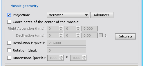

- My hope for field correction is that the PI MosaicByCoordinate tool should allow users to produce images that are corrected for lens distortion and also accurately aligned to the field centre, accurately rotated to be parallel to constant DEC lines and at a consistent images scale (10" at the centre). I think all of these corrections (not just distortion) will be essential for stitching.
I noted your comments (and Brian's) about problems using this tool. I am not a PI user so I have not tried the tool, only read the description in the documentation. What are problems you've found? If it is with the plate solving and alignment then this could prevent us using this tool at all. But if the problem is with seams or gradients then this is a different challenge. I'm interested to hear your experiences. @Brian Boyle The only clarification I'd add to your instructions would be to specify which images we need and which are optional (at the moment this is a bit ambiguous I feel). Must have: linear images (flat field/dark corrected, stacked, gradient removed etc as per the pipeline) Highly desired: stitched field image (as per discussion above, assuming MosaicByCoordinate can be shown to meet our needs) Optional: final image (stretched, noise reduction, sharpening etc etc) to the users' taste - not needed for the survey
James Tickner: noted your comments (and Brian's) about problems using this tool. I am not a PI user so I have not tried the tool, only read the description in the documentation. What are problems you've found? If it is with the plate solving and alignment then this could prevent us using this tool at all. But if the problem is with seams or gradients then this is a different challenge. I'm interested to hear your experiences. First and foremost, I've used it the last time 2 years ago so something of what I'm about to say might have been improved. Caveat emptor spelled here the issues I've found: 1. At high galactic latitudes the plate solving might fail (and thus MosaicByCoordinates). 2. For unknown reasons the feathered areas might be subject to signficant local distortions (vortexes). One may have to resort to manual mosaicking. Reducing the extent of the overlap area also helps. 3. The above might be related to widely different PSFs in the feathered areas between overlapping panes. This is more of a supposition than a fact but the presence of field aberrations in the (local) PSFs does not help with transitions between one pane to the next. 4. Highly elaborate colour corrections (such as PSCC and PCC) might add an additional layer of hurdles in the transition zone between panes. I'd strongly recommend using only the simplest of colour correction procedures, that is CC in PI. This said I used it successfully for a rather largish mosaic of M31/110 (28 tiles), which you can see here (note that those tiles were taken in B6/7 skies): https://www.astrobin.com/6q60h0/?nc=collection&nce=2681 |
