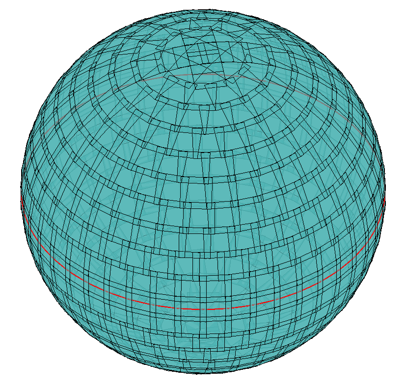

I couldn't resist having a play at the tiling question. I went for the simplest option of keeping the centres of the field edges parallel to lines of RA/DEC and have assumed 10 x 10 degree fields. If we go for a 20% overlap, then the cleanest solution I can find has DEC centres at 86°, 79°, 72° [... every 8° ...] -72°, -79°, -86°. The number of fields for each declination sweep ranges from 4 at +/- 86° to 45 at the equator. The total number of fields required is 662. As each new field adds a unique 64 (= 8 x 8) square degrees of coverage, this compares pretty well to the theoretical minimum of 41253/64 = 645. With a 10% overlap, the DEC centres are 86°, 79°, 72° [... every 9° ...] -72°, -79°, -86°. The number of fields for each declination sweep now ranges from 4 close to the pole to 40 at the equator. The total number of fields is 532 versus a theoretical minimum of 510. The image below illustrates the 20% coverage option. The N pole is approximately at the top and the red line marks the equator,  |
