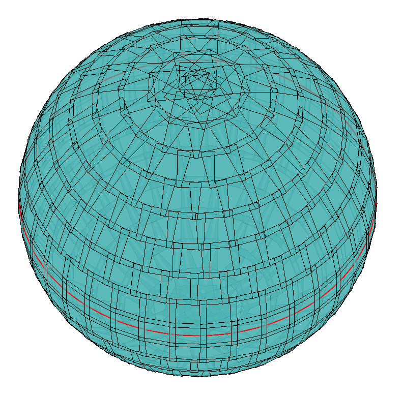

Can I ask how many fields there would be if we want to 10degree gaps between RA and Dec centres with individual field at 12 x 12 deg size?
I ask this because I am thinking perhaps (incorrectly) that the most likely imaging setups will either be a 135mm lens or a 200mm lens with fuil frame sensor.
A 12 x 12 deg field can be easily achieved by 2 x pane mosaic for 135mm lens (closer to 15 x 15 deg) and by a 4 x pane mosaic for a 200mm lens.
For both lens operated at the same f/ratio, the 200mm will get to the required depth per pane quicker, because of binning to the required spatial resolution. With a 135mm lens we are at (or very close to)  the proposed resolution already.
People who who a 85mm - 100mm lens can do at least a 12 x 12 deg field in one pane; the down-side is the will have to so a bit longer per pane and drizzle to get down to 10arcsec/pix.
All in all, I think 12 x 12 fields at 10deg centres maximises the efficiency for as wide a range of focal lengths.  It also means slightly less fields.
What do you reckon?  Note that I am trying to establish common terms  to describe the various scales:  panes (determined by observing set up ) , fields  (determined by the survey team) and the sky (defined by the Universe)
For survey to be a success we need to successfully mosaic panes into a field, which I propose is dome by the individual observer.  At most it is likely to be up to 4 panes, which with existing software tools should not be too challenging.
It is the next step - mosaicing the fields into the sky which I am not sure about.  I started thinking no - to keep things simpler, but the discussion on this thread has made me realise just how much more useful and impactful the survey would be if we could do it.   There are significant challenges here, but in the spirit of collaboration demonstrated above by James is the anyone willing to volunteer to try to lead this part of the effort?
Clear skies

james.tickner 1.20
@Brian Boyle  No problem. Using 12 x 12 fields with 10 degree centres requires about 430-450 fields, depending on exactly how you interpret the 20% overlap requirement as you get close to the poles. As you move to higher and higher N/S declinations, neighbouring fields overlap at increasingly large angle. So you then have the decision of whether fields should overlap by 20% on average, or by at least 20% everywhere.
There's also the option of moving away from a strict RA/DEC alignment of fields close to the poles and thereby removing the singularities that occur at these points. This could save 10-20 fields by my estimation, but at the cost of introducing more complexity. Probably not worth it I reckon.
Anyhow, here's one option with a reasonably generous interpretation of the 20% overlap requirement that needs 450 fields (versus a theoretical minimum of 413). I avoided putting fields exactly at the poles as in my experience achieving both RA/DEC and rotational alignment here is really hard.

James Tickner:
James,
That looks perfect.  Can you post the list of field centres for this.  I might like to have a crack at trying to create a field over the next few nights, in the fe hours while the moon is still down.
CS Brian

james.tickner 1.20
@Brian Boyle CSV file with field centres attached. They are ordered by increasing DEC then increasing RA, thereby putting the southern hemisphere in its rightful place at the top of the list
field_centres.csv
