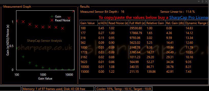

For anyone else following this thread, this is a summary after a few iterations of sensor analysis testing:
1. Upgrading the camera firmware to 4.36 as per instructions, and using the Native Driver:

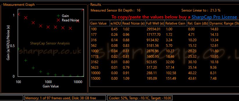

2. After upgrading the firmware to 4.36, but before applying the fix for the ASCOM driver cooling issue, the results were the following using the ASCOM driver:

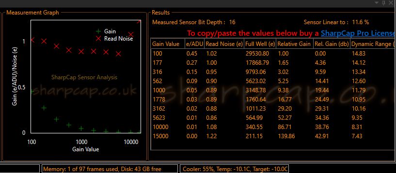

3. After applying the fix so that the cooling function works properly with the ASCOM driver:
Additionally, in an attempt to revert back the original ASCOM driver state, I replaced the cooler fix dll with the original, ran the camera firmware upgrade tool again, and reinstalled the Touptek Ascom Setup. Unfortunately the results are the same and I don't have a way to get back to the original performance with the ASCOM driver (as alluded to earlier in this thread by another user) it seems like something changed that can't be reverted back.

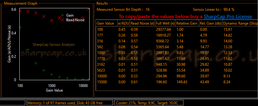

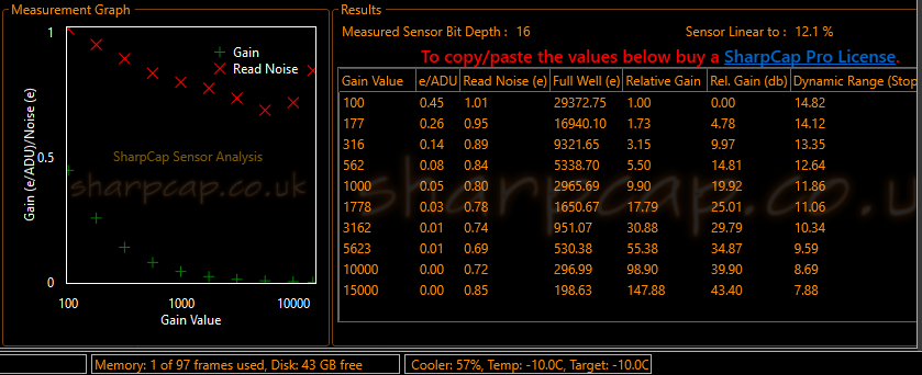

New sensor analysis after installing the 2024-08-19 'ToupTek Astro Equpment Driver. This .exe will uninstall the previous version and has placed all updated .dll files where they need to go so no need to manually do this. Cooling functions work on both Native and Ascom drivers. I don't see much difference in the results with the Aug. 14th? (previous) version but here are the results nonetheless (camera has been previously upgraded to firmware v4.36): Native Driver, -10c:  ASCOM Driver, -10c:  To summarize, whether you are using the latest driver package or the previous version, there doesn't seem to be any appreciable difference in the sensor performance. However, since there are no release notes or info from Touptek directly, we have no idea what changed in the latest version. So I can't really say whether or not you should upgrade to the latest version if everything is running smoothly. The super low read noise (half of what we see currently) and dynamic range above 15 stops that has been observed with the ASCOM driver that had the cooling problems, seems like it's not coming back, or at least not with this version. But unless you have unique conditions that can fully utilize those specs, it may not even matter in a practical sense.

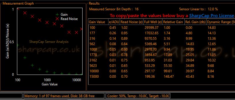

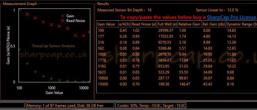

ASCOM Driver, -10c:
The super low read noise (half of what we see currently) and dynamic range above 15 stops that has been observed with the ASCOM driver that had the cooling problems, seems like it's not coming back, or at least not with this version. But unless you have unique conditions that can fully utilize those specs, it may not even matter in a practical sense. So where is the high dynamic range with the HDR turned in, this should give close to 16 stops of DR, and it does not show this, this is not good as this was the whole point of the issues and the camera was advertised around this feature…☹️ mine is going back…

I want to give Touptek the benefit of the doubt, but I can't find anything officially from them that said the camera would be capable of 16 stops of DR. Both the manual and the camera's web page show HDR mode being 16-bit, and just over 14 stops of DR at gain 100. Which is what is observed currently with firmware v4.36.
Now, Toupteks advertised specs for read noise in HDR mode at gain 100 is 0.69 e, and we unfortunately observe 1 - 1.02e. At least for me being in bortle 7/8, I'm certain that the read noise is irrelevant when compared to my sky conditions, but is still something to be aware of.
Additionally, Toupteks advertised Full Well for HDR mode at gain 100 is 13,000, while we observe over 29,000. Which again for me, I think is more relevant than the lower read noise.
So at the end of the day is it a good camera? In my opinion I'd say it's pretty great and I'm impressed with the results I'm getting and from what I've seen from others. Did Touptek release a camera before all the bugs were solved? Yes. Did they fix them? It seems like it?
