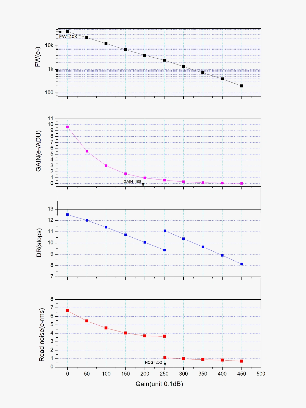

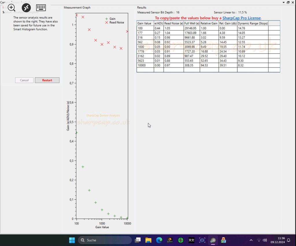

So, What happened to the 0.65e- read noise advertised here on the touptek website: Big difference between 0.65-ish and 0.95 at gain 177 (factor of 1.46x more read noise than advertised)!! https://www.touptek-astro.com/ATR585C |
John Stone: So,
 * It seems that with the current firmware version and clear hdr algorithm, Touptek is not able to provide a read noise lower than 1e and a stable camera. Yes, the specs were better but the camera had cooling, banding and hdr issues. Currently, it should be fine. @all Just for you to know, it seems the monochromatic version of the IMX585 is hitting the markets soon. QHYCCD released an All-In-One package with the MINICAM8, filterwheel and custom filters. Astroshop/Omegon is listing the Mono in their shop already: Omegon Camera veTEC 585 M Mono Available February 1st, 2025. Omegon is a Touptek rebrand, so I contacted Touptek to verify this. Maybe Touptek releases the "native" Mono version a bit earlier. Why do I write this? Look at those QE graphs from the MINICAM8: Quantum Efficiency Performance of the IMX585 Sensor in the QHY miniCAM8 | QHYCCD Astronomical & Scientific CameraThe sensor has over 90% QE for half the visible spectrum and even high IR and (assuming) high UV response. With Toupteks HDR algorithm, high full well and low read noise this sensor should be absolutely bonkers. As I moved to Mono imaging, I will definetly try out this camera and see how the luminance performs on my RC with no corrector in between and all that UV/IR hittin the sensor. SNR per sub should be nice. EDIT: Touptek answered me and the ATR585M will release "this month". Regards.

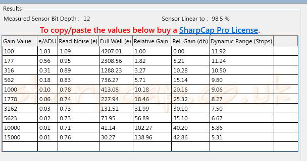

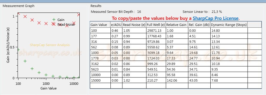

I just received my touptek atr585c pro and of course ran some tests in sharpcap. I think there might be a bug somewhere haha Latest touptek firmware, latest sharpcap 4.1 and native driver HCG :  HDR :  |
You should submit this back to SharpCap and see what they say.

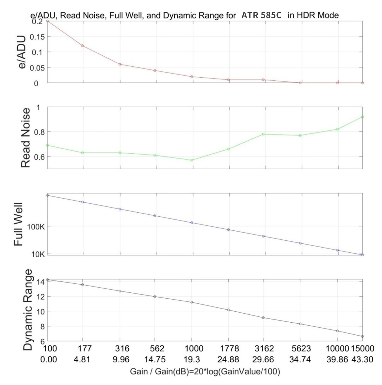

The ATR585M manual is available already and if you can believe those charts it seems Touptek fixed the read noise/dynamic range topic in HDR mode: ATR585M(ATR3CMOS08300KMA) User ManualLet's see if Sharpcap will agree :-D Regards

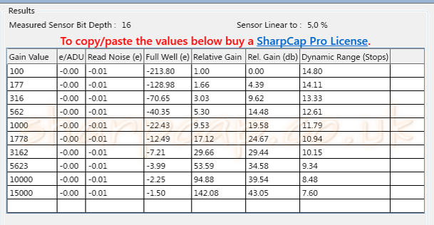

I tested on a older version of sharpcap (4.1.12711) as Robin on sharpcap told me. At least the HDR analysis is not bugged :  |

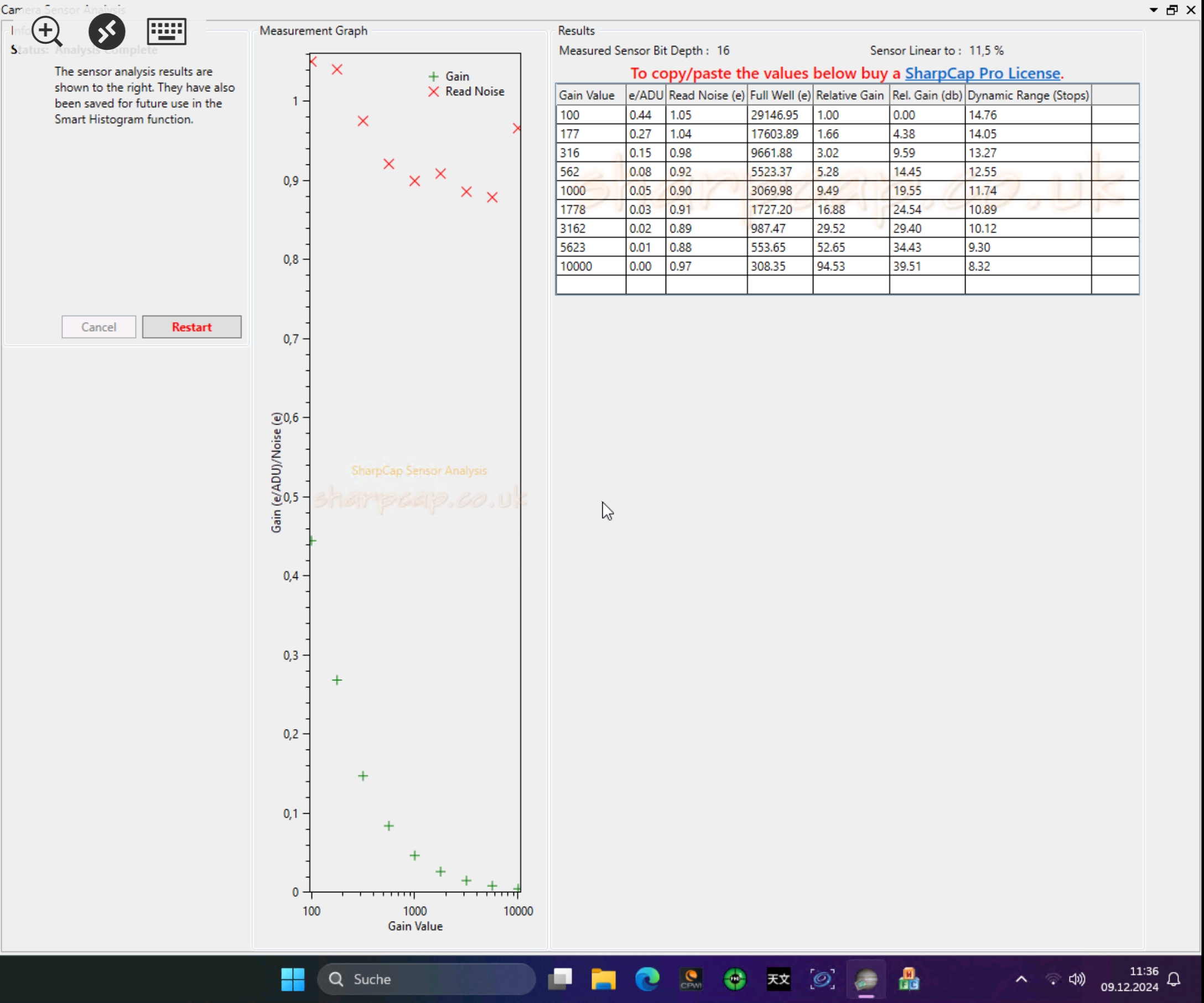

Received the new mono camera & the sensor analysis of sharpcap shows the same result as the color version. The new manual for the 585M is stating 0.64e readnoise in HDR and gain 100. Contacted Touptek again.  |
Hi Tobiasz, same scenarion with my 585M received today. Let me know once you get Touptek reply otherwise I will write them as well. Seba  |
 Yes, will do. I am still excited, that they released this fantastic sensor in the monochromatic version. Yes, the current performance is slightly reduced, but it is still crazy good. Almost 15 stop of dynamic range with a 12Bit sensor. You have to love it.

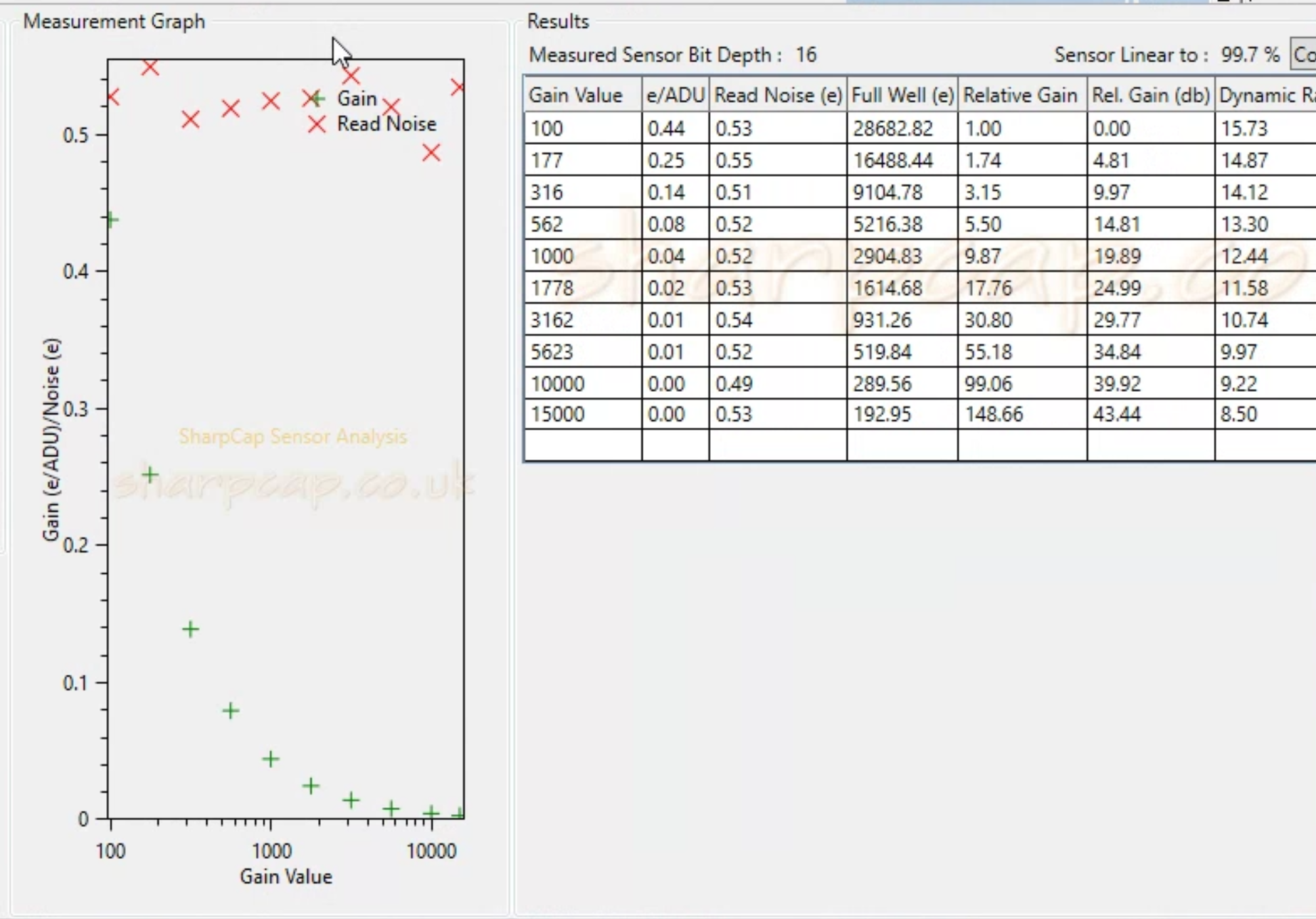

Hooooold ooooon. I ran the sensor analysis again but this time by using the ASCOM driver instead the native driver, aaaand...... AMAZING results in read noise and DR. I will need to use the ASCOM driver anyway with Voyager since they have not developeed the respective native driver for Toputek cameras. So I am all settle here   |
 *whaaaaaaaaaat I have to rerun my sharpcap analysis, thanks for the hint! Galaxy lucky imaging here I come wohooo! Almost 16 stops of dynamic range, Touptek has some of the craziest engineers. Edit: Which driver version are you on?

 * Touptek does not provide the sensor modes like ZWO and others, where it switches automatically with the gain. You choose the mode in the dropdown menu in Nina beforehand. Nothing odd with the super low read noise, it is just Touptek making use of the "Clear HDR" feature that comes with the sensor. See earlier posts for more information on that topic. As far as I know Touptek is the only vendor who achieved to develop an HDR algorithm. Every other vendor (e.g. ZWO) uses only LCG/HCG modes, which underpowers the sensor by a large margin.

*Ah okay, then it makes sense to me. I only achieved 0.7e read noise in sharp cap with the ASCOM driver, but this was the dll provided by the Touptek ASCOM Setup and it was way older. The separate .dll on their website is newer and a more current version. I will use this and forget about every other .dll from now on  At the moment I can't test the HDR mode in sharp cap because I too have the weird bug, which messes up the measurements. I accidently updated sharpcap and a rollback to an older version does not help either. Regards
Tobiasz: At the moment I can't test the HDR mode in sharp cap because I too have the weird bug, which messes up the measurements. I accidently updated sharpcap and a rollback to an older version does not help either. Robin on sharpcap forums contacted touptek about my issues with the HDR mode on the color sensor. And they gave me a new firmware which is not in the website for some reason. It will not work for the mono i guess but all good in my imx585C. https://we.tl/t-ZC8aD9QNi6 |

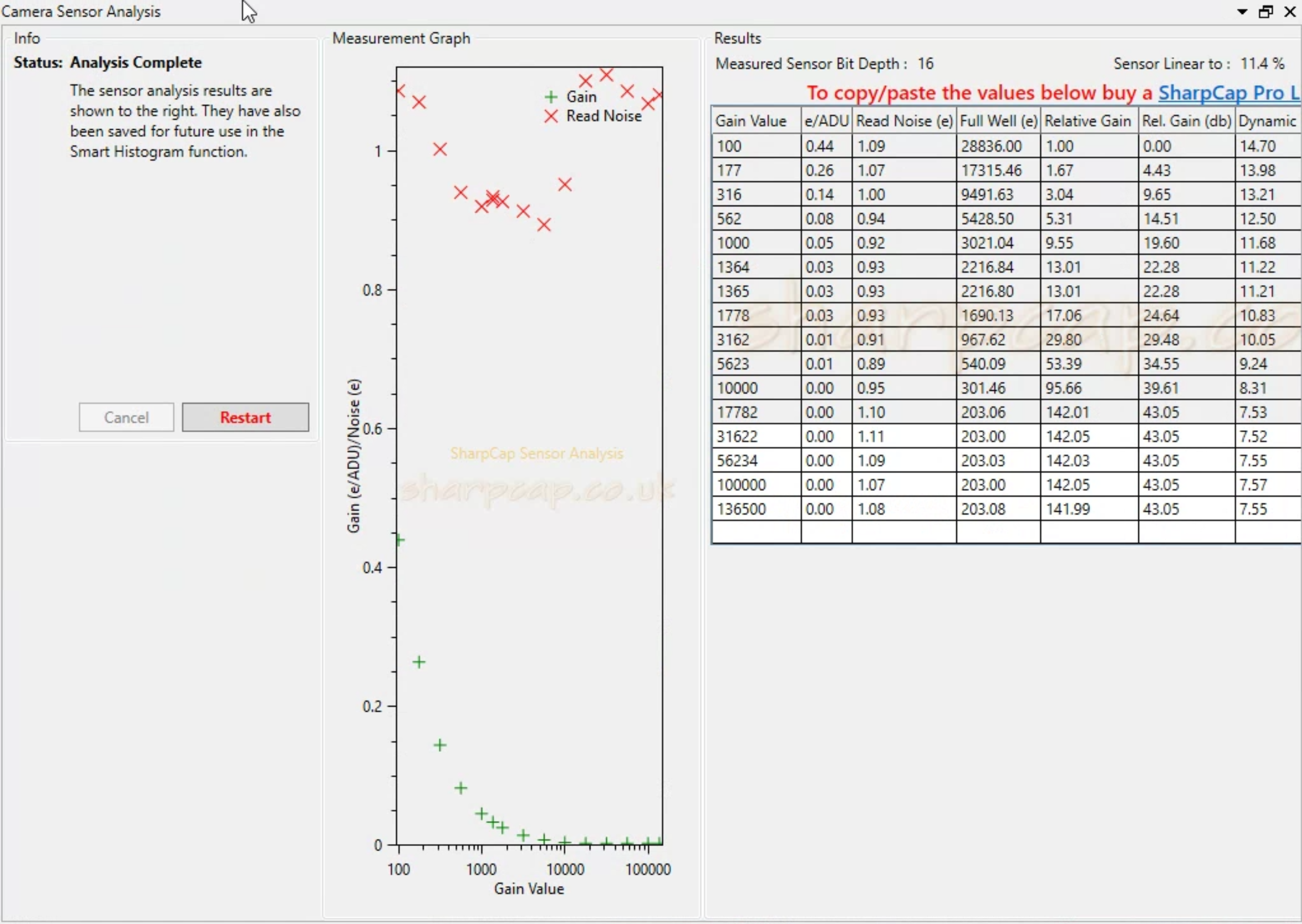

Hmm, I tried out the toupcamx64.dll from the website, exchanged it with all the ones in the NINA/Sharcap/Ascom folders and still get the buggy result with 14,6 stops DR at best. Something's wrong here. What does your .dll's have as a version? When you move the cursor over the dll it displays the version. Mine is 57.27119.0.0.
