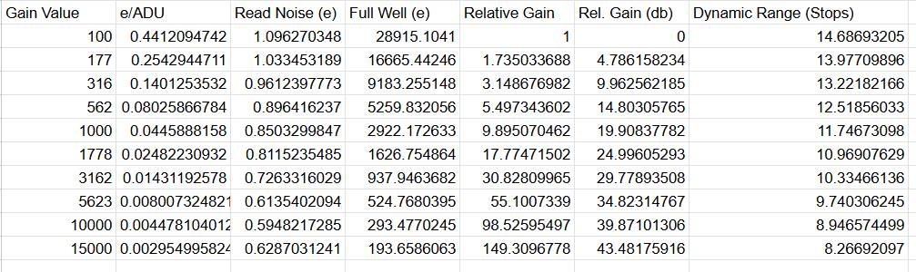

Hooooold ooooon. I ran the sensor analysis again but this time by using the ASCOM driver instead the native driver, aaaand...... AMAZING results in read noise and DR. I will need to use the ASCOM driver anyway with Voyager since they have not developeed the respective native driver for Toputek cameras. So I am all settle here
*whaaaaaaaaaat I have to rerun my sharpcap analysis, thanks for the hint!
Galaxy lucky imaging here I come wohooo!
Almost 16 stops of dynamic range, Touptek has some of the craziest engineers.

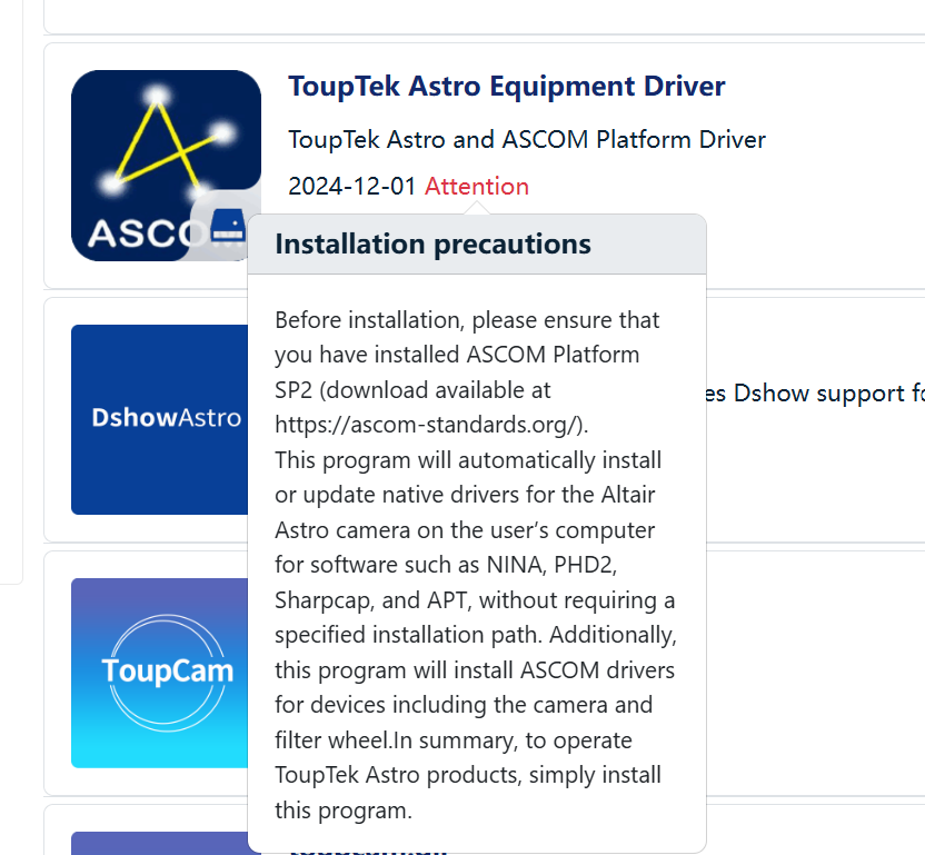

*the ASCOM driver that Touptek uploaded on their site on Dec 1st
*Ah okay, then it makes sense to me. I only achieved 0.7e read noise in sharp cap with the ASCOM driver, but this was the dll provided by the Touptek ASCOM Setup and it was way older.
The separate .dll on their website is newer and a more current version. I will use this and forget about every other .dll from now on At the moment I can't test the HDR mode in sharp cap because I too have the weird bug, which messes up the measurements. I accidently updated sharpcap and a rollback to an older version does not help either.
Regards
*I still don't understand why Touptek provide those DLL files. It creates only confusion. All you have to do i to install the new ASCOM drive which will automatically update the respective DLL.
At the beginning (with the 585C ) by playnig with those DLL files it turned my folders in a mess  and I was lossing track which one was the right one or not. Actually one thing I did before getting the 585M was to wipe my astro-PC, fresh new Windows and quicly reinstall all the app I use. It took me 2-3 hours but now I have it all clean. Well, that was not the only reason to wipe the computer but the DLL Touptek files situation contributed
Sorry I thought you were talking about the DLLs all the time, so you simply installed the Ascom Setup by Touptek and thats it?

Correct. THis is also what they state on the website. And this is why I don't understand why the provide the single DLL files

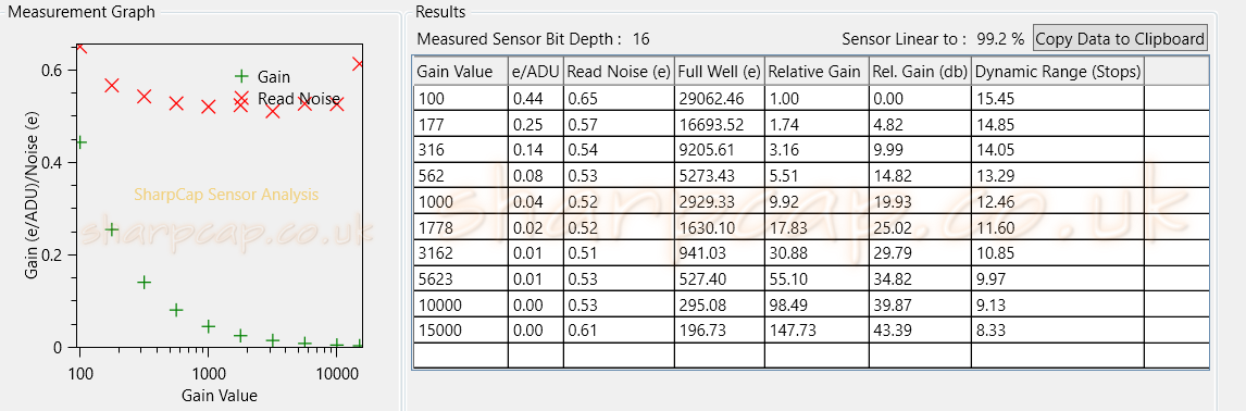

Very good results with the ASCOM driver, but not as good as yours. But it is alsmost in spec, so I am happy for now. The hassle with all the dlls was mind bending, so I will keep that as it is.

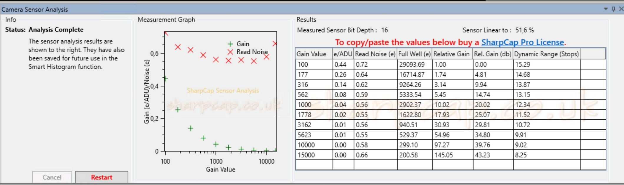

EDIT: I ran it again (damn)  and values are back to the lower side. Don't ask me why as I am still scratching my head) and I am not going to figure this out by messing up with DLL files. I feel going through the exact same saga I ran with the 585C and at the end I settled by accepting the latest results that were comaparable to the 16 bit IMX571 sensor (this forum has the record of thse comments if you browes a few pages back ) .
So the party is not completly ruined but still left me with a bitter taste from Touptek that advise something different from reality.

I feel your pain, but those results look like you connected the camera as "ATR585M" and not "Ascom Touptek Camera", correct? Because when I run the test as "ATR585M" my results are 99% the same as yours. But the better results I get (~0,7e RN) are with the "Ascom Touptek Camera".
I got only the answer from Touptek that they will contact the engineering departement, nothing more until now.

That is the unexplainable thing: camera was connected as Ascom Touptek Camera. The ONLY thing i did was reinstalling the Touptek ASCOM driver (the exact same one  I still had saved in my download folder and that I installed just a couple days before).

and as promised, I just ran again the sensor analysis under ASCOM driver HDR mode. And voila'.
I will not run it again and take these as last official ones. Perhaps someone will be able to figure this out.

I think my results should be consistent now, because I changed nothing anymore after that. I think the DLLs Nina and Sharpcap use are the native driver. I checked both and both are the same version.
The Ascom Driver is located in the Ascom folder on my C:\ drive, where also the Touptek Ascom dll is. I think this is the real "Ascom Touptek camera" driver.
I think there is no randomness of the drivers, just the Ascom Setup which may not fully delete the old files before reinstallation. As I said before I had to delete the dll files manually before the Touptek driver setup because the versions didn't change after that.
If you want, I can test my camera later again.

Lookin' good. Now you just need to get those results consistently after several tests and then you can be 100% sure and finally sleep in peace 😀

I dont know, but I experienced the same issue here now. Started up the mini pc and get to the tests and im back again at 1e read noise. Did the test 3 times.
Now reinstalled ascom and for whatever reason I am down to almost 0,6e RN. Its my best result so far. Man this is getting annoying to be honest.
Tests are running and after a Reboot I will repeat them to see if something changed.

Did the Reboot and after that the test 3 times. 0,6e at best. Looks consistent now, lets hope it stays like that. I will still clarify it with Touptek.
