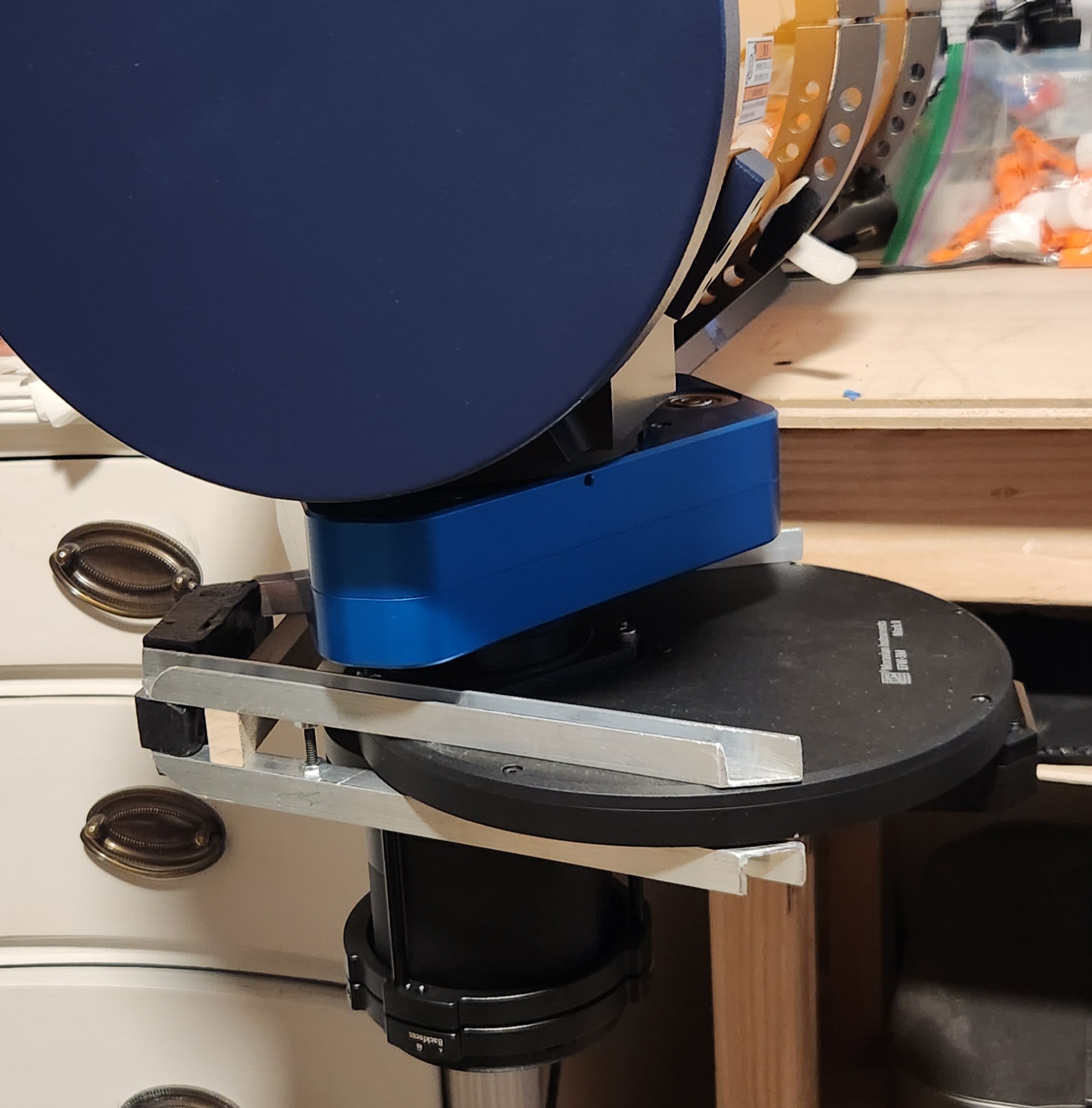

Because I am a glutton for punishment (and I like shiny new things), Pavel from Moravian Instruments did confirm that they will be coming out with a centerline FW for 50mm round filters (they have one for the squares); and therefor, I MUST have one. If there're ANY balance issues with the Hercules rotator and the ZWO EFW (I can't see 'em so far), then that item should take care of it. Plus, it'll look more streamlined. I might even paint racing stripes on it!
MZ
MZ I love you man...
MZ Is that the type of rotator with two carousels inside? If so, doesn't that double the back-focus of it compared to a sing carousel model? Isn't back-focus really tight/small on the E160?
MZ We are a dealer for Moravian cameras and accessories. The standalone EFW is only currently available in 65mm square, with the 50mm square version coming. I would expect to see a 50mm round option at some point. If you do not need a guider, any of the Moravian cameras with this wheel will fit in the 56.2mm of spacing available. Moravian camera adapters have tilt correction available on them if needed (unlikely) so on a system with a Hercules focuser (we’re also a dealer for these) you would have one very nice and clean setup on the e160ED.
Isn't back-focus really tight/small on the E160? Backfocus distance is the same with the Hercules as with other focusers — 56.2mm from the corrector. The Hercules is thicker than the TCF-LEO and uses the same flange, but the adapter from flange to focuser is thinner. The focal point with my Hercules is almost exactly midway — about 60000 out of 112000 steps.
MZ
If you do not need a guider, any of the Moravian cameras with this wheel will fit in the 56.2mm of spacing available. Moravian camera adapters have tilt correction available on them if needed (unlikely) so on a system with a Hercules focuser (we’re also a dealer for these) you would have one very nice and clean setup on the e160ED. There’s an external EFW for 50mm round filters, isn’t there? You could fit a C3-61000 with one of those? What would the backspacing be with that combo? Asking for a friend. Or maybe me if I ever win the 110gtx lottery.
Isn't back-focus really tight/small on the E160? Backfocus distance is the same with the Hercules as with other focusers — 56.2mm from the corrector. The Hercules is thicker than the TCF-LEO and uses the same flange, but the adapter from flange to focuser is thinner. The focal point with my Hercules is almost exactly midway — about 60000 out of 112000 steps. Jeff, he's talking about the filter wheel carousels not the focuser rotator.
Jeff, he's talking about the filter wheel carousels not the focuser rotator. Ah. Got it.
Yes, it will fit!!! And, I have a set of 50mm round filters for my QHY600 cameras, so I am NOT buying new filters…hence my waiting for the centerline FW that comes out for those filters. I may be dumb, but I ain't stupid!!!
I've never used a double-wheeled centerline FW before (I think FLI was the only one I recall), but I assume that the discrepancy in where one set of filters are sitting and the other (depending on their wheel) wouldn't be problematic since I refocus at each filter change.
I have had this on my bench for a while, having more pressing things to manage, but am nearly at a point where I can finish setting the system up for work outside.  The Pb counterweight nicely negates the FW. Photon cage on the C1x. Hercules in line with scope axis, on bottom. Before the photon cage, I tried quite unsuccessfully to use the Moravian tilt plate. The 10micron 1000 that it was on at the time has the expected issues with horizons when the system was rotated southward and low, and this was heavily dependent on rotation of the camera. After moving my larger scope to an AP 1100, I tried sliding this over to my available Mach 2, and found the mount far more forgiving space-wise. I did not at that time explore it in more than a cursory way though. That will come... Cheers, Kenward
You know, I always had a terrible time in arts & craft and shop…so I can't make ANYTHING on my own. Centerline for me!!! (But that's VERY cool!)
MZ
