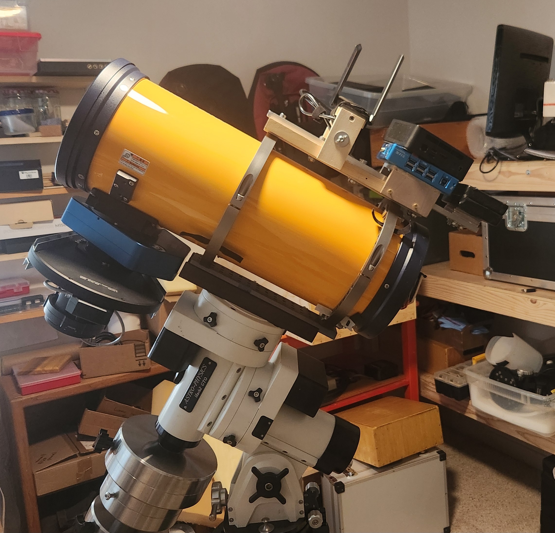

A bit off the current topic but I wanted to ask about focuser orientation. I will utilizing a Hercules rotator on my ordered 180 and would like to implement in focuser down orientation. Is there a good counterweight solution, positioned behind the mirror that you are using to make this work?
Photos would be great.
ChemProf 0.00

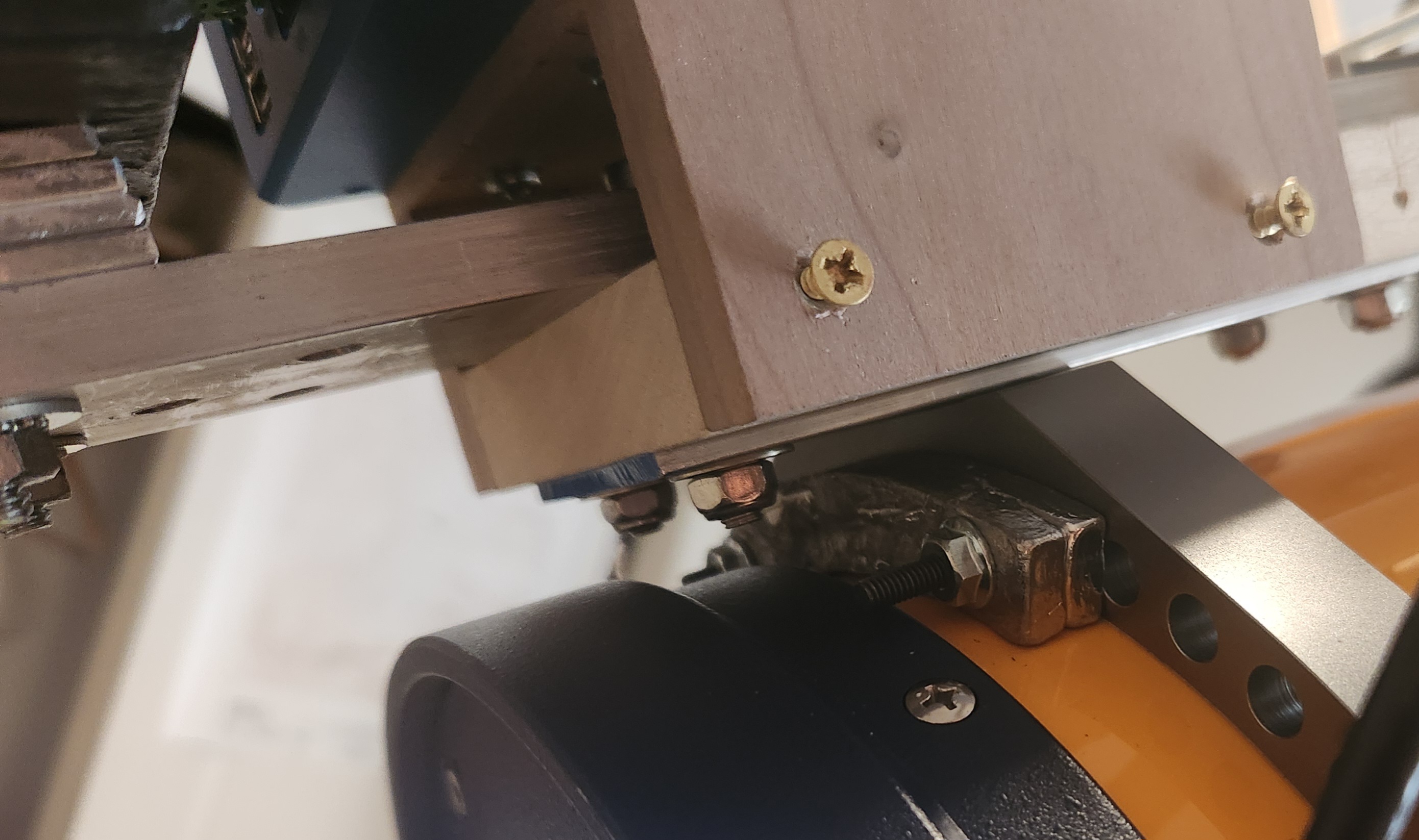

My rig is shown below.  Impromptu setup, no cables, etc.  Sorry about the image sizes... I haven't tried to figure out how to control that.
I like wood!  ;-)    The poplar plank is bolted between an 1/8" and 3/8" plate of Al.  The 3/8" plate extends beyond in the back, and is where the Pb weights (black plasticized coatings) are attached using bolts.  Those work in combination with the PegUPB /computer group as the primary "sideways" (Y axis?  Z axis?) counterbalance for the weight of the imaging "group" up front.  If I place the rig on a bench on its side, it is pretty well balanced against rolling, meaning the added torque from the camera side is canceled out.  In the pic below you can see four 1/8" Al plates under the back Pb which serve to set the proper distance away from the tube's cylindrical axis to accomplish this.  The wood riser does the same for the computer.  The mass of the Pb weights total about 2.1 kg.  The PB/computer boxes total about a kg.
The balance point front to back required an additional 400 grams of Pb weights which I added top and bottom on the back mounting ring (image of one shown below--no black coating yet).  This places the Hercules at about the position it's at in the image above.
While people may think it's crazy to add all this weight, the rig is compact (reduced moment of inertia, I believe it's called) and roughly 45 lbs. total, which the mount handles with ease.

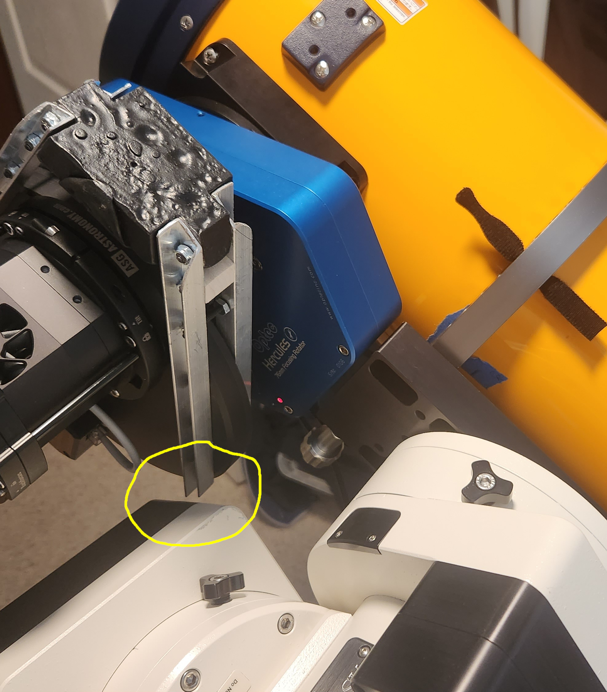

Concerning pier collisions, with my setup on the Mach 2, the worst position is shown below (hard to understand, I know) where the scope is pointed in the neighborhood of Az 180, Alt 25 degrees.   I am unsure of the altitude, but if I need lower I will file down those corners of the rails to easily go another 5-10 degrees lower.
This is my rig, though (e.g. using a Mach 2 instead of a 10m1000 mount).  YMWV for this aspect depending on your own setup.

Thanks Kenward, very nice setup. I'm going to temporarily mount side by side on my AP1200 mount till I'm able to get a Mach2.
Did you ever consider a longer dovetail and mount the extra weights there?
Thanks
ChemProf 0.00
That would work too (I assume you meant a long dovetail on top?).  It would require a longer offset (vertically off the dovetail) for the Pb bricks, but that could be done using a block of Al with the right thickness.  One thing that would also have to be addressed (and certainly can be) is being able to attach the other stuff using a method that allows adjusting their position to fine tune the CG of the system.  Something as simple as a wood block on the dovetail...
The reason I chose what you see?  I used what I had (Al stock and hardwood) to create the most rigid system I could without the expense of a dovetail, and it allowed me to easily adjust the height + lateral position of the UPB/computer with the wood parts.  The vertical distance of the main weights (the 2 kg of Pb) was perfect with the original thickness of the top "structure."
This worked until I later added the photon cage.  That added more weight both up front, and out to the side.  Instead of changing everything, I added enough Al plates under the Pb to counter the increased side issue, and slid its attachment point backwards.  As that didn't completely manage the front-to-back imbalance, I added the extra Pb to the mounting ring so I could keep the front-to-back positioning of the OTA where I wanted it.  (It cannot get pushed back to balance the photon cage out since the Hercules would crash into the saddle way before balance was achieved.)
Adding the 400 g Pb to the back ring on both top and bottom kept that new weight from upsetting the top-bottom balancing trick...
Cheers,
Kenward
ps.  Something to helped me when setting this up was knowing that the front-to-back balancing is independent of the top-to-bottom balancing.  I did a lot of calculations ahead of time and during the build phase to know approximately where everything needed to go.  Worked well for me.

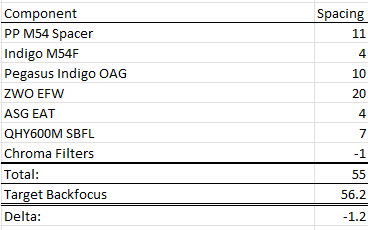

Not sure about your math (the target backspacing is 56.2mm), but here's my configuration with Hercules and the guide camera clears fine.
Hey Jeff,
Why are you subtracting 1mm with the Chroma filters?
menelmacar 0.00
Same thing, I just added the 1mm for the filter and revised the target to 57.1mm.
So 15mm is enough clearance?
Your Indigo is without the helical focuser?
What guide camera are you using?
Thank you for you information, Mike
Hey Jeff,
Chroma filters are 3mm thick. 1/3 of that is 1mm.
jpridder86 2.41
Not to argue, but unless Pegasus changed it, the M54 indigo spacer is 4mm, not 5mm, which leaves you 1.2mm to play with.
I use the ASI290 mini for my guide cam.
Hey Jeff,
Ah sorry. I was thinking the filters add a 1mm to backfocus requirement, but what you are showing is the math for your backfocus consumption. Makes sense now 👍

Another question: can anyone confirm which OAGs fit between an EFW (they are all pretty much the same - flat -  on the OTA side so model likely doesn't matter) and the Leo body?
The gap is very narrow for the camera barrel part of the OAG. I have a player1 "max" OAG which I am going to give a try but it looks like it may not fit. The Pegasus Indigo seems like it may fit as its very thin….
