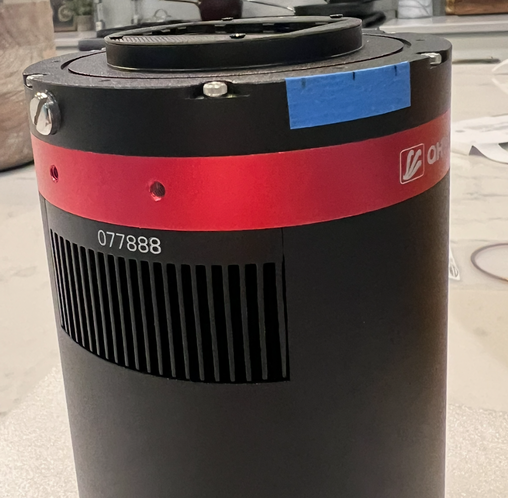

@Jeff Ridder, I just received my QHY600 SBFL and removing the front plate still leaves this raised sensor part that takes up around 5mm or so. Using a photon cage means the backfocus is still 12mm or so for the camera instead of the 7mm like you mentioned, if the camera didn’t have this bump. Did QHY recently change the camera design? Does yours not have this? Otherwise how are you accounting for this?  Thanks, Ani
Ani Shastry: @Jeff Ridder, I just received my QHY600 SBFL and removing the front plate still leaves this raised sensor part that takes up around 5mm or so. Using a photon cage means the backfocus is still 12mm or so for the camera instead of the 7mm like you mentioned, if the camera didn’t have this bump.
Thanks, Ani My SBFL version of the camera does not have this additional adapter looking thing on it. Looks like a design change to me.
Does it come off? Looks like screw heads in your pic.
Unfortunately that is where the glass window is, so I can’t really remove it! Looks like they tried to move the sensor further up in relation to the body and this quirky design is what they came up with.
And you would think they would make is a standard dimension like M54, but no, it’s 56mm in diameter so I can’t even push it through the central hole in the photon cage base plate.
QHY’s random changes without revving version monikers is extremely frustrating.
Ani Shastry: Unfortunately that is where the glass window is, so I can’t really remove it! Looks like they tried to move the sensor further up in relation to the body and this quirky design is what they came up with.
QHY’s random changes without revving version monikers is extremely frustrating. I'm guessing that they wanted to move the window away from the sensor to prevent fogging. It's a problem with the sbfl in humid environments. What a PIA.
@Chris White, looks like that is indeed what they did. @Josh Jones, this is the issue I indicated in my offline thread to you. Ani
Ani Shastry: @Chris White, looks like that is indeed what they did. @Josh Jones, this is the issue I indicated in my offline thread to you.
Ani Ani, PM me if you want contact information for Cha at QHYCCD. I don't post other people's email addresses on public forums. The front end of the camera is removable. You might be able to get QHY to send you the old style so that you can get that backspacing back. They are probably unaware that many people are removing the front plate to reduce spacing even more, which only works of course when using a clamp on tilt device for the connection method. I would push QHY on this, considering it is a major design change and a bit of a surprise...
