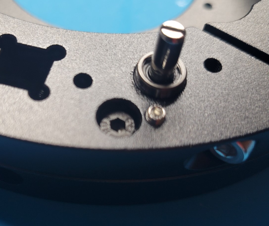

I had not thought about transport much, but it got me thinking about shipping this epsilon down to Chile and I had a set of push/pull systems installed in these when designing.  The idea was that a person may want to lock it down after adjusting so it didn't move, but once we ran them, it doesn't really move much so I abandoned them... but what if you put the push/pull screws in these ports and locked it for transport.  Then just have the tech remove all 8 of the screws once there?  Might be a good use for them.  They are just M3 x 10 or 12mm and 4 set screws, 4 socket head screws would do the trick from the hardware store.
Or, just put the 4 socket heads in and zero it all down so it's all held down flat and tight at 0 zero.

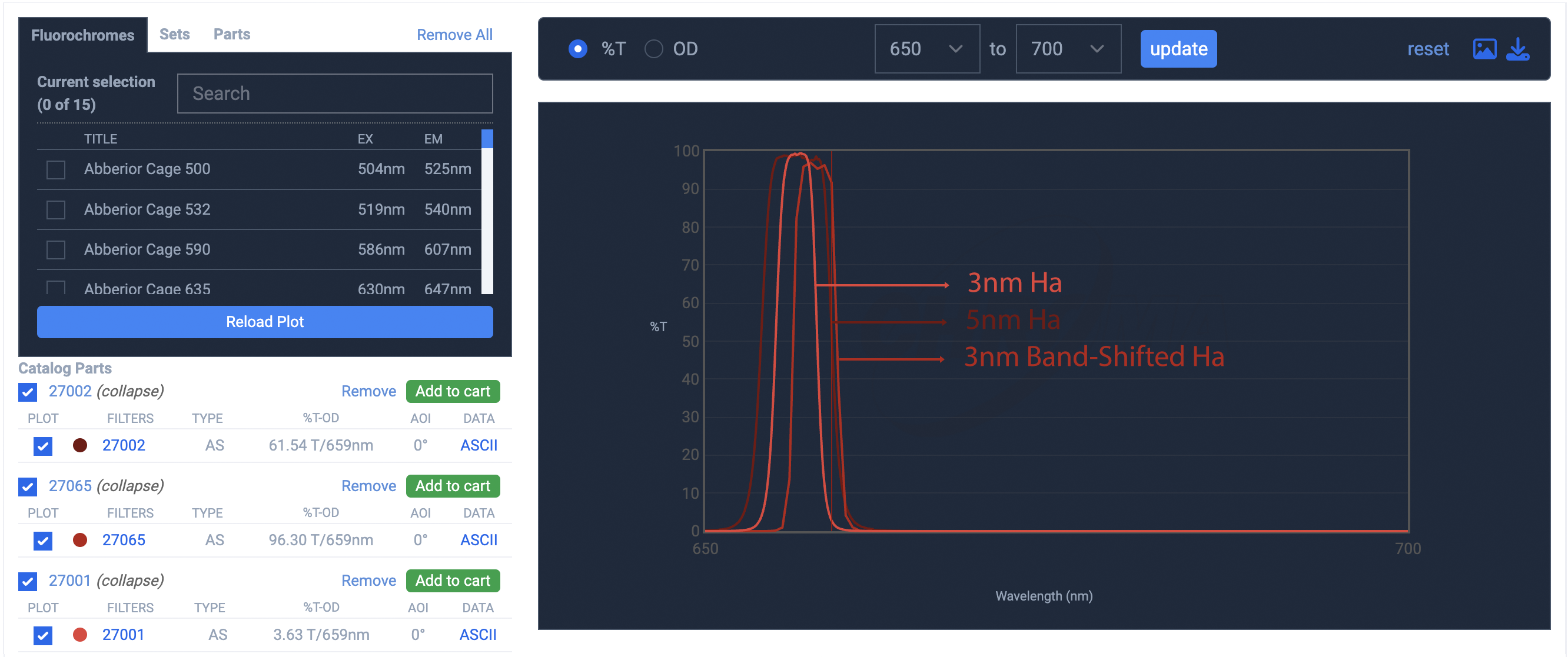

ashastry 2.81
Thanks for your feedback @Daniel, really appreciate it. I will reach out to Astronomik and see if they have 50x50mm still available. As for Nii signal, there are definitely some targets that are wide-field and still exhibit Nii. Plus, there is the possibility that I will upgrade from the Epsilon to a fast but deeper scope like the Delta Rho in the future, and it would be nice to be able to reuse the filters.
Anyway, I did some more digging in, and here are the transmission graphs for the Chroma 3nm, 5nm and 3nm band-shifted Ha filters:
What is actually interesting here is that the 3nm band-shifted Ha might actually be the best equipped to transmit Nii signal at faster focal ratios compared to the 5nm.

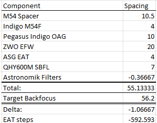

@Jeff Ridder are you willing to share the measurements and equipment of your imaging train that allows enough clearance for the OAG. It looks like you have a lot of space between the hercules and the OAG plate. Can you tell if there is space for a guide cam on the epsilon mounting bracket with the herc?
jpridder86 2.41
Sure thing. Here ya go:

Hi @Jeff Ridder, how did you get the backspacing for the QHY600 SBFL down to 7mm? I thought it’s either 12.5mm with the QHY filter wheel, or 14.5mm due to the rim that sticks out when used any other filter wheel and/or with the Photon Cage or EAT.
Thanks,
Ani
jpridder86 2.41
Ani Shastry:
Thanks,
Ani
The front plate comes off. 7mm without that.
