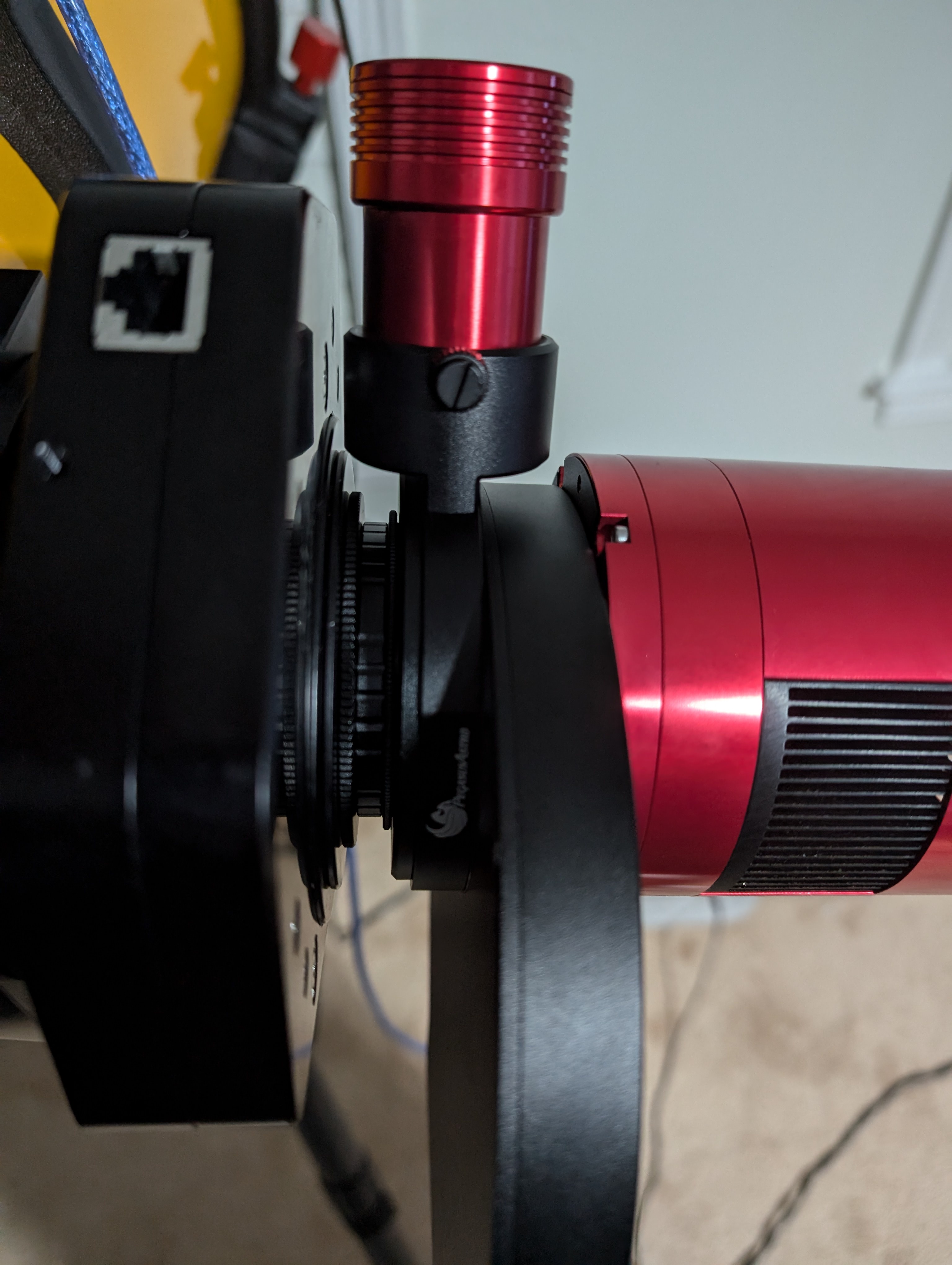

Daniel Carter: I don't recall if it was M2.5, M3 or M4 screws. I think ZWO has the size required on their EFW page on their website (I think it may have been M2.5 but im not 100% sure). I ordered a kit on amazon that had multiple lengths of the required size. The PA Indigo OAG needs some longer screws (maybe 10 mm?) to secure it to the EFW so the kit with multiple lengths worked well.
Ah great, I think you are correct , that M2.5 sounds familiar from my other ZWO EFWs. I have my share of (life saving or "sanity" saving) metric screw sets - will start there.
Thanks !
JT
It's m2.5. Mine needed a previse parts spacer between the oag and the fw so I could reach focus with the qhy600sbfl... so i cant recall the ideal length. I think the Indigo is 10mm, so probably 12 to 14mm length with no spacer.
Chris White- Overcast Observatory: It's m2.5. Mine needed a previse parts spacer between the oag and the fw so I could reach focus with the qhy600sbfl... so i cant recall the ideal length. I think the Indigo is 10mm, so probably 12 to 14mm length with no spacer. I think you and I have the same set of components, Indigo OAG - ZWO EAF - ASG - QHY600Sbhl, I'm curious to see what will change with the Hercules, would love to avoid Precise parts (mostly for the wait...). JT
JT
PP has a pretty quick turn around right now. I couldn't reach focus with the guide camera with these pieces. I needed a spacer between the oag and efw for the guide cam to focus. It is a zwo174. EDIT- I removed the faceplate of the camera to get the filters closer to the main camera. This made the spacing more of a challenge for the guide cam. If you leave the faceplate on the front of the camera you'd be fine...

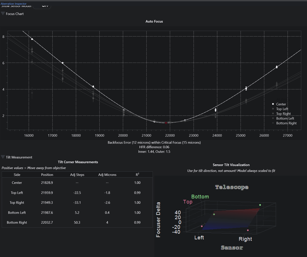

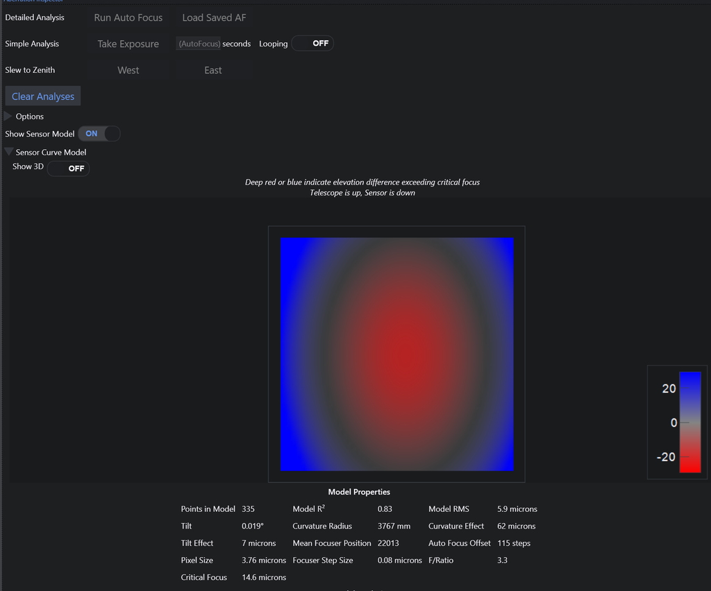

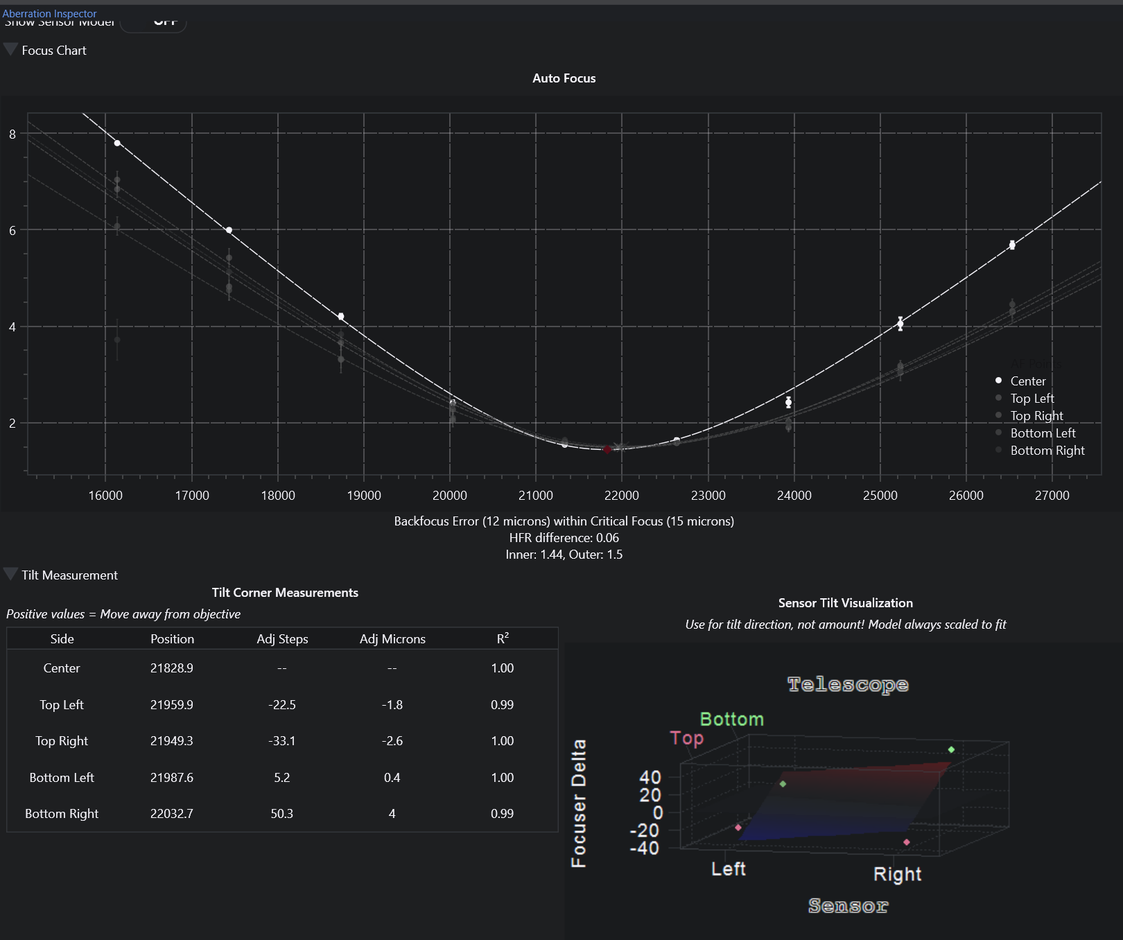

Ashraf AbuSara: This is where I am last I left it before the clouds rolled in. It took me a while to figure out which tilt adjuster on the ASG corresponded to which screw on the camera sensor, but to me it looks like the (Top right) in Hocus focus corresponded to the Bottom Left screw on my ASG looking at it from behind the OTA.
I think the tilt adjustments looks good, needs just very fine tuning, but to my eyes it looks like the backfocus is a bit off. I think I have to move it away from the OTA? HF analysis reads as if you are standing behind the camera looking at the corners. So if your Top right corresponds with bottom left... you might want to rotate your camera 180 degrees in the holder. That would make top right correspond with top right. (Honestly though, its probably not worth rotating it and messing up your tilt adjustments). I remember seeing that off-axis diffraction artifact ("v" shaped stars) getting better with additional spacing. Keep in mind that 0.05mm matters! So if you decide to mess with spacing, I'd recommend testing 0.1mm differences at a time. What you have looks nicely symmetrical though! Nice work!
I remember seeing that off-axis diffraction artifact ("v" shaped stars) getting better with additional spacing. Keep in mind that 0.05mm matters! So if you decide to mess with spacing, I'd recommend testing 0.1mm differences at a time. What you have looks nicely symmetrical though! Nice work! Thanks Chris! Love your Pegasus Indigo OAG focuser. It works great, much better than the native tube for the Pegasus, and did not make it bulkier so it fit with the f/3.3 corrector. Highly recommend it for anyone who gets the Pegasus Indigo OAG. Yea it is strange that it is like that because I thought the top of the sensor corresponds with the desiccant port. Maybe I got it wrong. Now that I know the orientation, I will just leave it as is. I am happy with how the camera/ EFW and OAG are oriented with the tube. Luckily, the ASG allows me to adjust the backfocus on the fly without having to mess with spacers. I can just use the backfocus adjustment on the back of it and move the sensor closer or farther It does affect my tilt a little bit when I do adjust it. Hoping for maybe some clear skies tonight to finish it up!
Ashraf AbuSara: Thanks Chris! Love your Pegasus Indigo OAG focuser. It works great, much better than the native tube for the Pegasus, and did not make it bulkier so it fit with the f/3.3 corrector. Highly recommend it for anyone who gets the Pegasus Indigo OAG.
Luckily, the ASG allows me to adjust the backfocus on the fly without having to mess with spacers. I can just use the backfocus adjustment on the back of it and move the sensor closer or farther It does affect my tilt a little bit when I do adjust it. Hoping for maybe some clear skies tonight to finish it up! Glad to hear! Believe it or not, I've heard of some sensors being installed upside down before. But yes, once you have it figured out you just want to leave it alone! The Photon Cage is a great product. Very nice for dialing in spacing, especially with superfast system like epsilon where you only want to make very small changes.

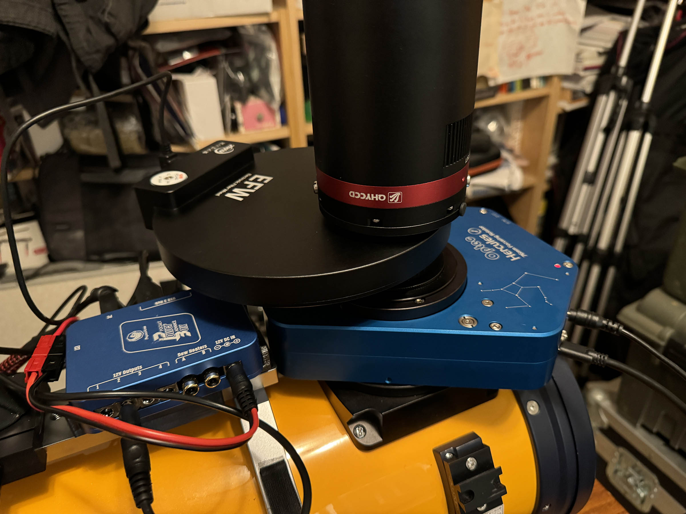

hi guys, i just wanted to ask you who had pre-ordered the Hercules focuser. Does anybody get it already, maybe succesfully installed and tested out? By any chance pictures about the focuser? CS
Kaptas Attila: hi guys, i just wanted to ask you who had pre-ordered the Hercules focuser. Does anybody get it already, maybe succesfully installed and tested out? By any chance pictures about the focuser? CS Mine arrived late yesterday. Hoping to install today or tomorrow.
Kaptas Attila: hi guys, i just wanted to ask you who had pre-ordered the Hercules focuser. Does anybody get it already, maybe succesfully installed and tested out? By any chance pictures about the focuser? CS Mine's up and ready to go. Hopefully next Saturday I'll take it out and work on backfocus. Works like a dream indoors!  |
Kaptas Attila: looks sexy It fashionably matches the Pegasus Astro blue.  |
