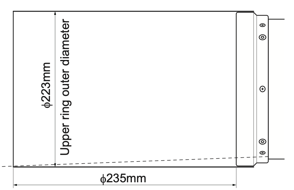

A last question (I hope not off topic) : What is the max lenght of a dew-shield for the 160ED (max lenght before vignetting issues) ? I have experienced dew on the secondary...
If I remember correctly, you can find this information in the users manual. I believe there is a specific length they say not to exceed. I followed Bill's advice and had a custom heated dew shield made by astrozap. It is 10" long, and about 2 inches are on the OTA itself. This puts the extension under the limit specified by Tak. I have been using this in VERY humid conditions and it has worked perfectly to prevent dew from the secondary as well as the primary. And of course the fan helps as well.
Page 26 of the manual. I am also considering to get custom made dew shields. Does anybody know where I could get a rigid (aluminium) version though ? Astrozap has a few versions for Meade, Celestron, etc but nothing that I see for Tak.  |

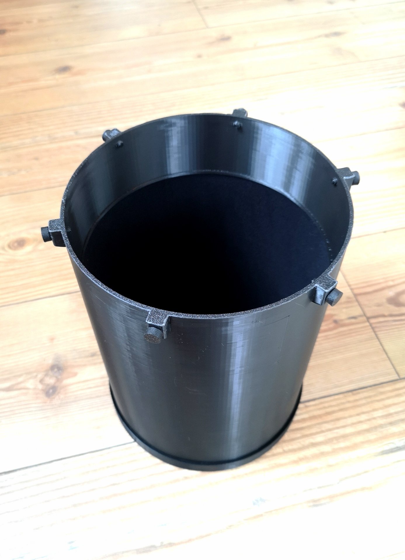

@Aygeni asked some guys in Germany to doing some high quality 3d printed dew shield. they arent heated but is not flexible and inside is velour. Maybe its could be an option for you, combine with a dew heater straps? i got a pic from him it s looks like this one.  The length you can define yourself. Hope a bit i could help you Best Attila
@Kaptas Attila Thank you dude ! Will send you a private message to get further details. Best, Aygen
Kaptas Attila: @Aygen i asked some guys in Germany to doing some high quality 3d printed dew shield. they arent heated but is not flexible and inside is velour. Maybe its could be an option for you, combine with a dew heater straps? i got a pic from him it s looks like this one.
The length you can define yourself. Hope a bit i could help you Best Attila *** Type your reply here ** Cool just make sure that's PETG, ASA or ABS

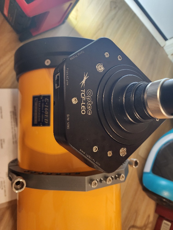

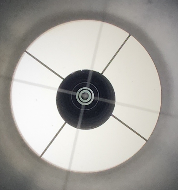

I got my Optec installed and I think I have it collimated best I can tell. I wear glasses and my prescription is horrible (-14.5 in my right eye with some astigmatism) so it makes it hard for me to tell when everything is lined up well. Once I got the saddle off (those extra 2 hex screws inserted from the inside were a pain to get out) getting the new one installed wasn't too bad. I loosely installed the saddle plate and installed the Optec with the collimation tools installed. While looking through the collimation tool, I adjusted the saddle until the collimation looked close enough. I tightened the screws on the saddle and adjusted collimation a tad and ended up with the picture below. I think i need to adjust it a tad bit more to get it lined up a little better. Trying to get a decent picture through the tool with my phone was tough!   |

Daniel Carter: I got my Optec installed and I think I have it collimated best I can tell. I wear glasses and my prescription is horrible (-14.5 in my right eye with some astigmatism) so it makes it hard for me to tell when everything is lined up well.
Once I got the saddle off (those extra 2 hex screws inserted from the inside were a pain to get out) getting the new one installed wasn't too bad. I loosely installed the saddle plate and installed the Optec with the collimation tools installed. While looking through the collimation tool, I adjusted the saddle until the collimation looked close enough. I tightened the screws on the saddle and adjusted collimation a tad and ended up with the picture below. I think i need to adjust it a tad bit more to get it lined up a little better. Trying to get a decent picture through the tool with my phone was tough!  That collimation is close. The primary ring and secondary blot are offset to the northeast a tiny bit.
