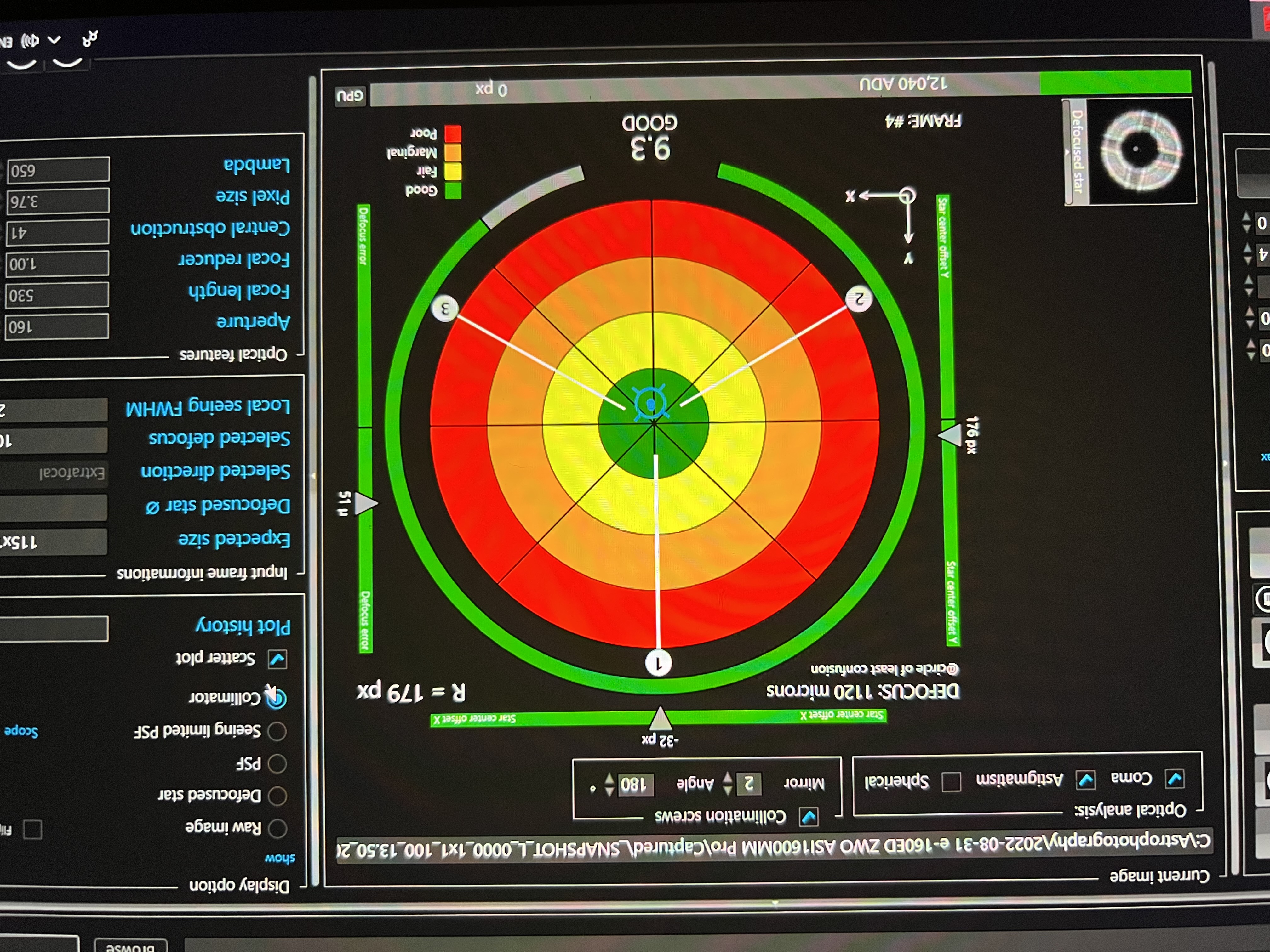

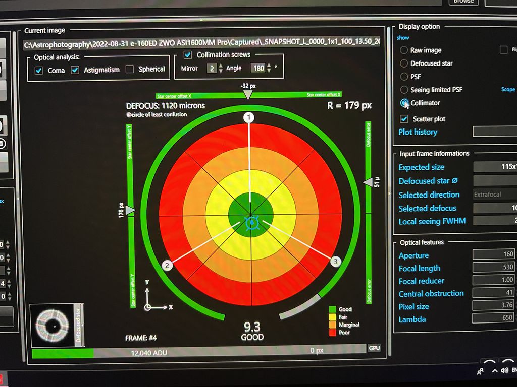

I collimated with the Tak tools and then fine tuned with SkyWave. The results below were from the first run after collimating with the Tak tools. Which reinforces just how good that process is. I adjusted up to a 9.6. Anything over 9 is considered diffraction limited for local seeing. So I’ve got spot on collimation.  I can see the central dots moving around in a circle when I rotate the CAA using the Tak collimation tools (and yes this is the stock focuser) so I suspect that’s tilt in the alignment of the focuser draw tube wrt. the secondary. From what I’ve read it’s hit and miss with Tak focusers. I must have a miss. Re. the ZWO EAF. I’m getting inconsistent results with just normal focusing. Another option is the FeatherTouch Micron Pinion upgrade and a Primaluce Lab Sesto Senso which I have. They fit quite well together and I have that setup on my TSA-120. However that won’t fix the tilt in the drawtube. So if I don’t want to recollimate every time I rotate then the only option is the Leo I think. One other thought that jumped into my head was to use the replacement Optec focuser plate with its tilt adjustment and then get a Primeluce Lab 3.5” LP. I’d need a custom adapter but that should work if I get distances correct. Might even be enough room for their rotator? Anyone know of anyone that’s tried?? Tom.

Tom Dinneen: I collimated with the Tak tools and then fine tuned with SkyWave. The results below were from the first run after collimating with the Tak tools. Which reinforces just how good that process is. I adjusted up to a 9.6. Anything over 9 is considered diffraction limited for local seeing. So I’ve got spot on collimation.

Tom. Tom, Is skywave accounting for the offset secondary? I'm sure it is as Gaston is a very smart guy, I just dont see anything on your screen shot that accounts for it. I'm not even sure it matters to skywave, but I do know that you cant collimate visually with a defocused star using epsilon.
I asked Gaston the same thing. Here’s his response.
“The offset of M2 is related to field illumination at the telescope focal plane and sensor location. Translation (offset) of M2 does not impact collimation, only tilt/tip of either mirror does.”
It’s worth noting that collimating using SkYWave is independent of any tilt you have in your image train. So I was able to collimate and then address sensor tilt. I still have some sensor tilt as I’m at the point of max granularity with Aberration Inspector in NINA using the ZWO EAF and stock focuser. So I’m at around one focuser step which is around 6 microns (rough measurement) and that’s inconsistent across runs which way the tilt is.
Gaston also mentioned that there’s going to be a plus and a pro version of SkyWave. The plus version due soon will include sensor tip/tilt adjustments and the pro version is a full blown wavefront analyser.
To answer your question Daniel. Yes, get collimation close using Tak tools and then you can use SkyWave to get it closer. Once you have a model for your scope it tells you how many microns you have to defocus by. Which makes it easy at the start of a night to defocus by a known amount. Take a 20 second image with a star on axis and then run SkyWave on it. Nice way to confirm everything is still well collimated.
