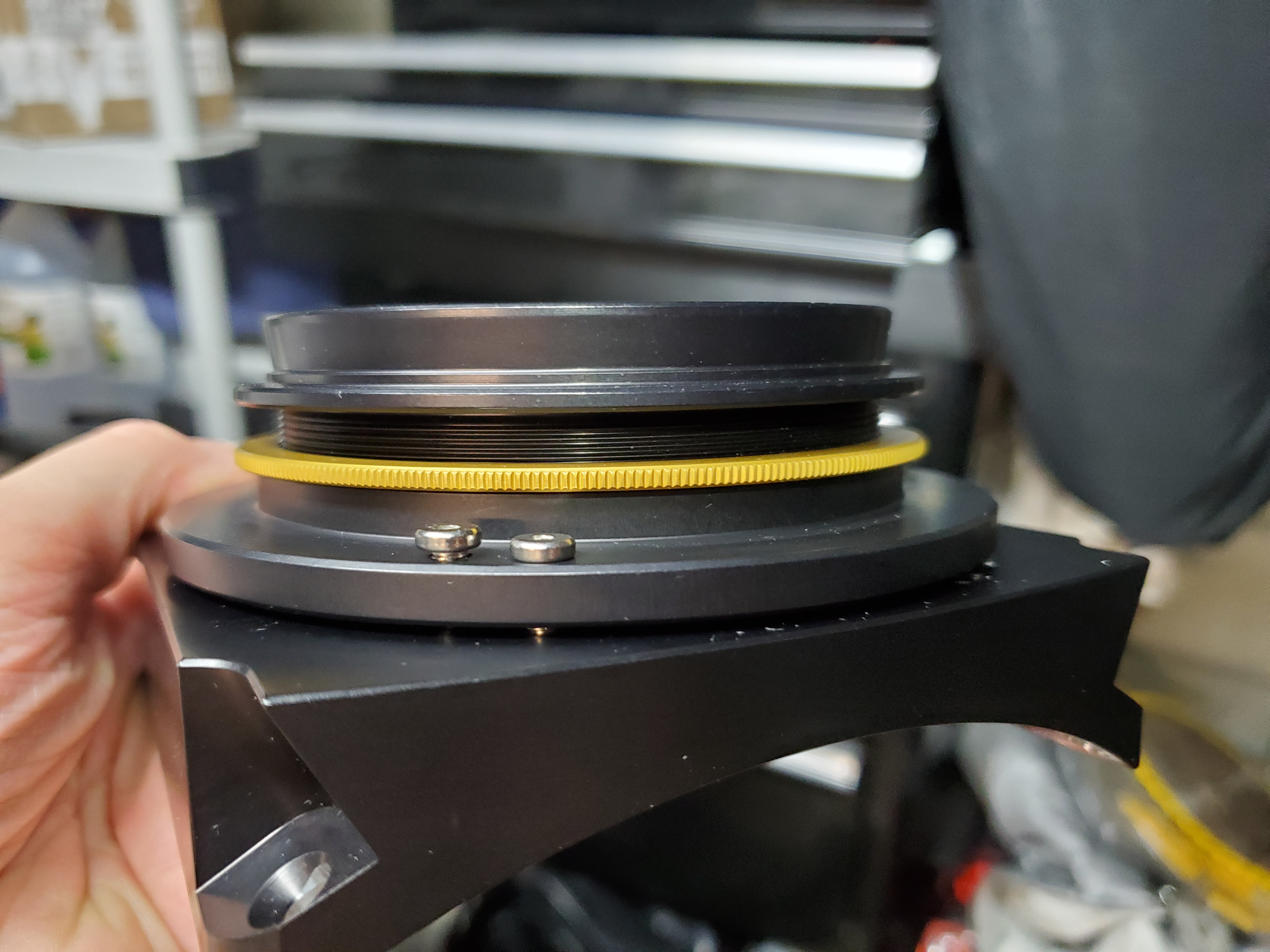

@Chris White  do yyou mean the 0-12 mm adjustable adapter or the triangel form focuser itself. if i thread out its gonna be loosen shaky right?
May i ask you for a picture where you show me where i should turn?
Thank you
Overcast_Observatory 19.90
Kaptas Attila:
Thank you
Underneath the focuser itself is a threaded mount that you can use to raise the focuser.
See this photo:
In mine I have about 2mm of threads visible.
