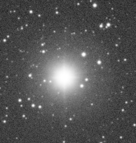

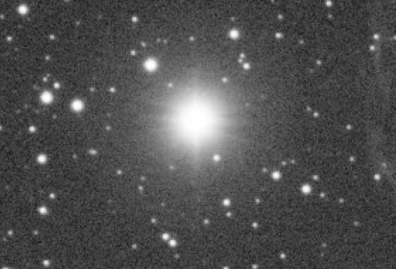

I am getting halos with Oiii on mag 2.5 stars. I'm considering selling all of my astrodons and chromas to get astronomiks. I've asked Bill to do a gamma Cass test shot with his O3 maxfr filter for a comparison.
Happy to do the test. When I shot Jellyfish, a few years back, I was using 5nm Astrodon OIII. Tejat and Propus were both in the frame: Tejat:  Propus:  Final image: Jellyfish Nebula (rockstarbill) - Full resolution | AstroBinThis is actually what prompted me to get 3nm Chroma filters instead of the ADons. While I never tried photographing these two stars again, I never did run into any halo problems. In testing the MaxFR filters I did take 5 min shots in all three filters of Caph (Mag 2) and did not find any halo effects at all. In my IC1396 image, Garnet Star is in the frame, and while not Mag 2.5 it is Mag 4, which is brighter than Propus at Mag 6 -- and there is no halo effect at all. I will do this test tonight and report back, but my guess is that I will not see any halo effect at all.
Tejat:
Propus:

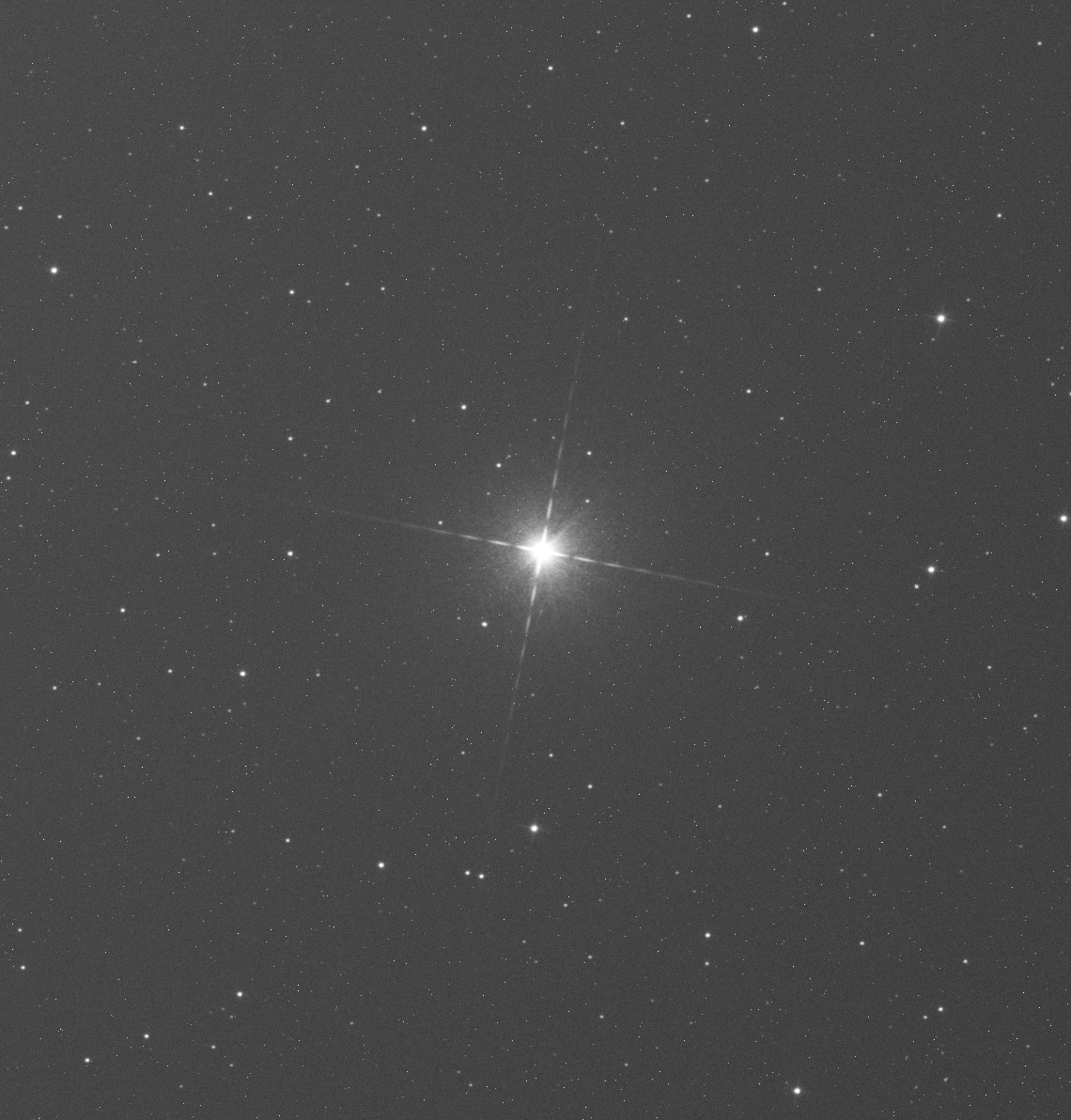

No Halo on Sadr. There is some interesting glow pattern, not really sure what to make of it, but no halo. This was 10 mins, MaxFR OIII, High Gain Mode 56/40. Sadr is offset to the same place Gamma Cas was in your previous image @Chris White.  Full Test Sub: https://www.dropbox.com/s/h7e2x0qc2mfti71/TestShot_20220908_204330.fit?dl=0Sorry for the tree bits on the left. I need to move!
Sorry for the tree bits on the left. I need to move! Looks good. The scatter is just probably some atmosphere illumination. Sadr combined with the nearby full moon... I found Halos on my HA data this morning. So yeah, time to order som Gerds.

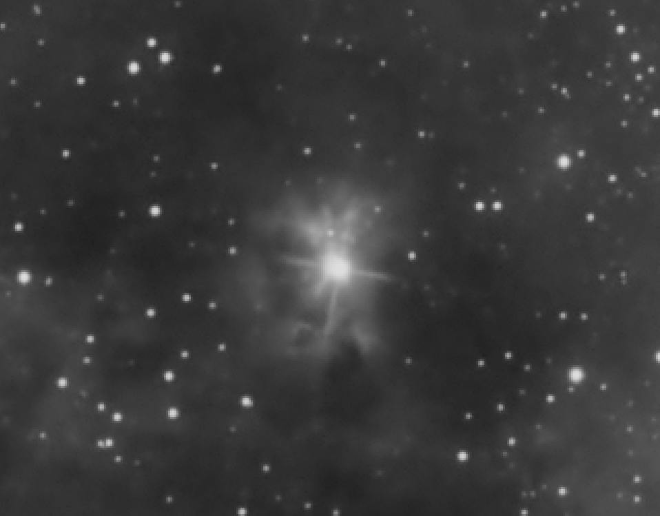

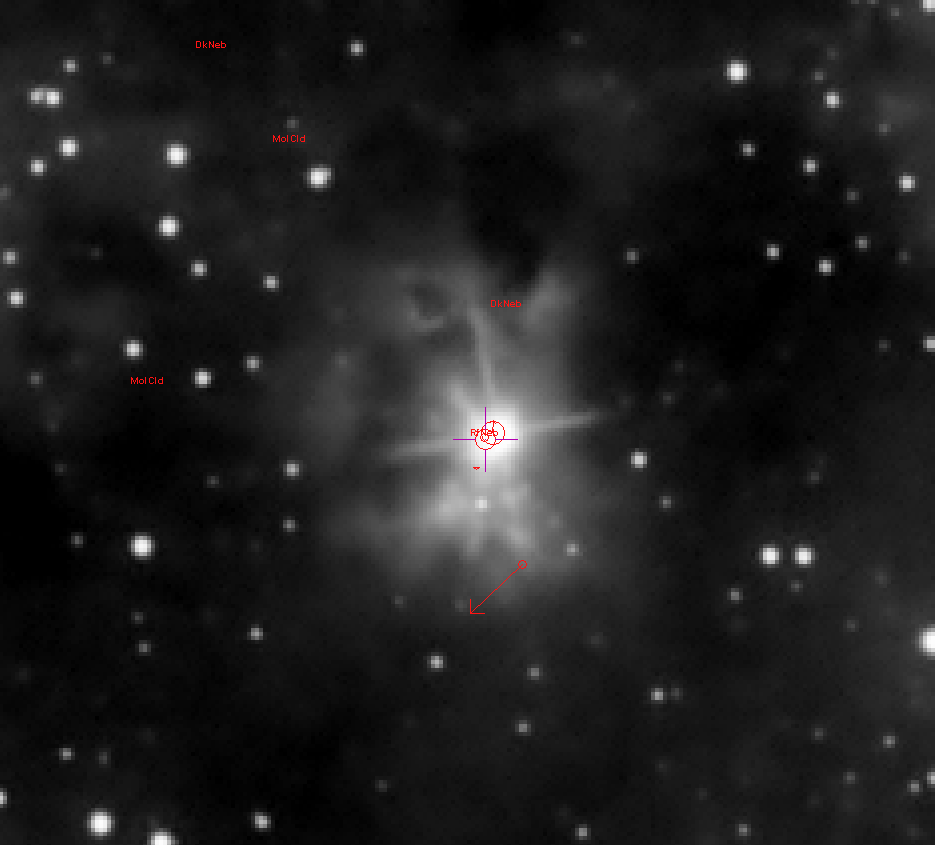

Another thing I am always impressed with the E160ED about, is the interesting objects that keep appearing in the data. Like this one for example, which is in the Bubble Wide field HA data:  I went into Aladin to look up this "mini Iris Nebula" looking object, and what I found was pretty interesting. Here are the labels from Aladin (note that it is flipped)  - The circle and arrow combo is pointing to Gaia DR3 2014109142340397824 -- White Dwarf Candidate.
- North of that, is BGPS G111.733+00.034 -- Millimetric Radio Source
- In the cluster of red circles we have:
- EM* MWC 1080 -- Herbig Ae/Be Star
- NAME EM* MWC 1080/c -- Emission-line Star
- GN 23.15.3 -- Reflection Nebula
- NAME MWC 1080 Stellar Group -- Cluster of Stars
It seems this is a "mini Iris Nebula" which is being illuminated by a cluster of distant pre-main sequence stars. Pretty cool!  |
