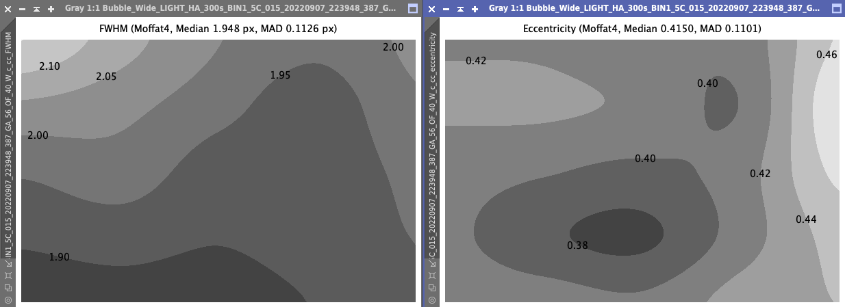

Aygen: 10 stars from my end ! Incredibly sharp, and looking at the figures, this is a great return on investment ! 99.99999999 % of people would love to reach such level of performance - needless to say with such demanding equipment (fast optic, full frame, etc.)
PS : I am in awe of the FOV !
 Look at the frame itself as well. I am not so sure these metrics are completely right. There is a lower right change I can make based on the focus pack data, but it is so small that it could have negative impacts on the full frame. Another thing to be mindful of with this scope and the big chip is that the M54 connection is a thing, and that can impact these programmatic results in ways that mislead.
Nothing "bad" caught my eyes by looking at the frame itself. Icing on the cake, we're talking only about one single frame. Hence my rating  I wasn't aware of the M54 and its respective impact - something new to me. But got it ! Looking forward to hearing from more experienced guys - but I'd be surprise if they get to a completely different conclusion. Thanks for your great contribution towards this thread. All the findings, testings will be of great help in a few weeks when I get my "banana".
Aygen: Nothing "bad" caught my eyes by looking at the frame itself. Icing on the cake, we're talking only about one single frame. Hence my rating
Thanks for your great contribution towards this thread. All the findings, testings will be of great help in a few weeks when I get my "banana". Cant wait to hear your experience, my friend.  People really need to know this scope CAN produce excellent data. Getting there, takes some work.

Bill,
Wow, just WOW! I looked at your Ha Bubble image in detail at 10:1. The stars in the corners are superb.
One request. Since this is 6 nm bandwidth image and at the long end of the design bandpass it may be hiding some chromatic effects. Do you have a Blue filter image we could look at? The shorter wavelengths are harder for the optical designer when optimizing for the whole spectrum so usually a good test. And at some point an RGB image would be important for things like lateral chromatic aberration which might show up on bright stars at the edge of the field.
One question and some advice, please. It seems there are two variables when fine tuning the camera's position. One is the extension of the focuser tube for the correct back spacing (56.2 without filter and ~57.2 with 3 mm glass filters). The other is the backspacing itself. If the focuser isn't in the right place one might be optimizing camera spacing incorrectly.
I am still using the stock focuser with the telescope colimated best I can at a fixed position angle. So what I have been doing is to try to eliminate the focuser position variable by auto focusing on a DSLR mounted with the Tak wide mouth T-ring adapter. It would seem this puts the camera at the right backspacing and allows the optimum focuser position to be achieved. I then remove the DSLR and install the imaging train (in my case a 54->68 mm adapter, ZWO OAG L, ZWO EFW, Octopi base (3mm thick) and ZWO ASI6200MM). This barely achieves 57.2 mm BFD with the camera clamp ring set to 1.95 mm above the top of the Octopi base - not ideal.
With the focuser set to optimum extension (in my case the stock focuser tube extendds 9.62 mm above the to of the flange to the bottom of the knurled corrector ring) I then adjust only the camera's position using the Octopi. I have to watch the temperature and only have an couple of hours or so to make adjustments. When I have reached the point of diminishing returns, I finally do an auto focus and check that the final position is within the CFZ of the DSLR focus setting. Of course the slop in the stock focuser adds some uncertainty to this.
Your advice: is this a reasonable way to adjust camera position?
