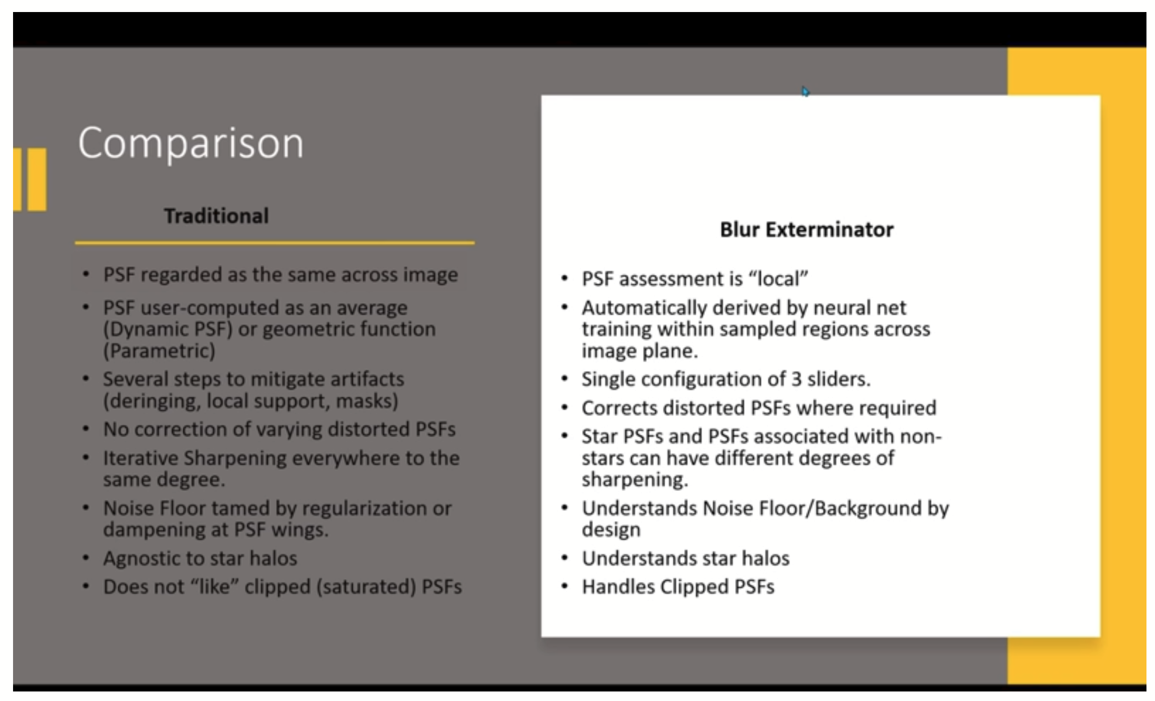

Hey guys here Adam Block dissects PSF in BlurX in detail... done regionally/locally is the Bottom Line Up Forward (BLUF):
https://www.youtube.com/watch?v=_rWEuW4MTrQ

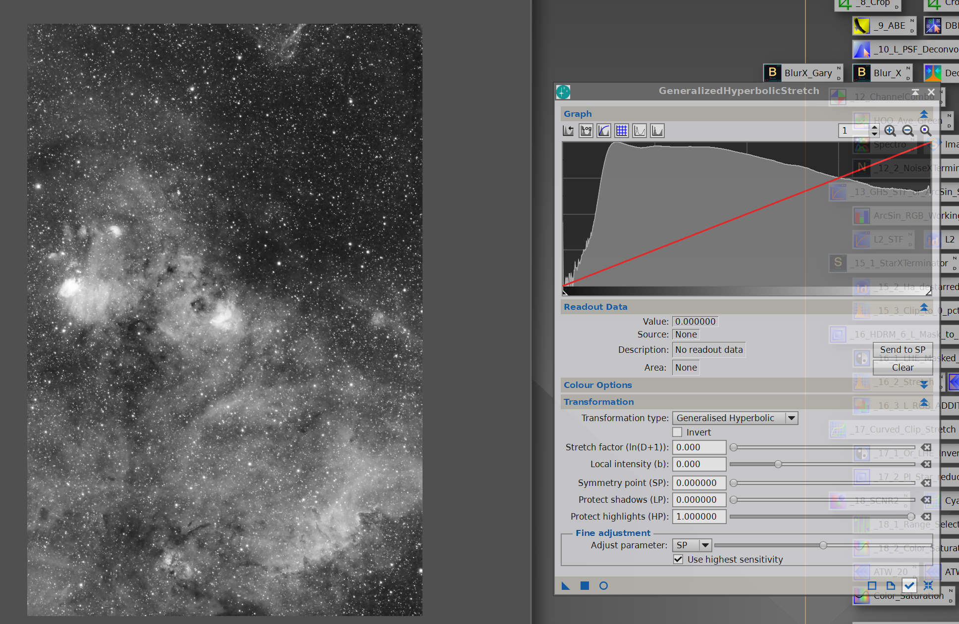

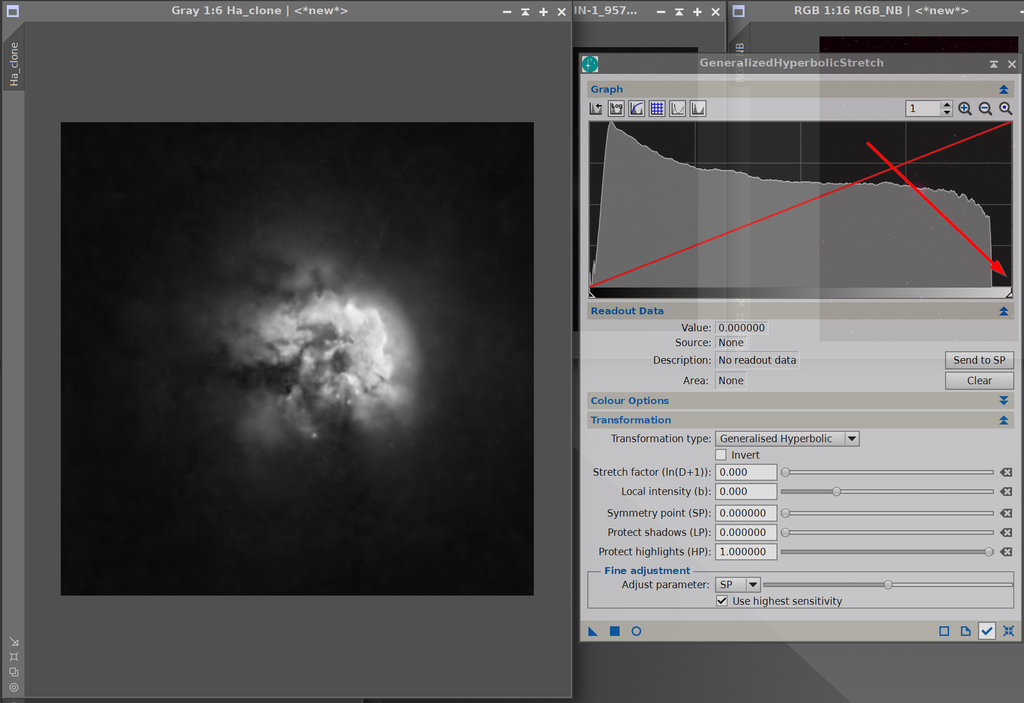

Lotsa fog and few images but I have a bit of a question.  I just put this image up and could not master the right side of the histogram.  This is a comment response to Gary Imm:
... The GHS allows you to make the most of the subtle greyscale variations.  I had one problem with the GHS that I need to bring up with the developers... have mastered getting the histogram to the left but I am having problems optimizing the right (bright) side.
Cannot seem to stretch this out without blowing out the brights....
Am I missing a trick here????
Sh2 93 (Two Acquisitions Contrasted)
Gunshy61 11.24
Hi Jerry,
I would put SP on the far right of the histogrom - right where is starts to fall off a cliff downwards - Just to the left of the straight cliff, but after it bends downwards towards the cliff - if that makes sense.   In this case I would start with a b of say 2-4.   When you apply D - stretch amount, you will see it darken the image, but lessen the cliff - this will add contrast in the brightest part of the nebula.  So at first, concentrate on getting the amount of contrast here to roughly where you want it - by playing with D, b, and SP.
This will darken the rest of the image, which is something you don't want to do too much, so the next step is to move LP upwards towards SP, which will brighten the image again - and you may have to apply more D.  Overall get the histogram profile right.
For overall final brightness adjustments, I usually apply a b<0 with SP at 1 or 0 (or even an inverse GHS).   This value of b tends to leave the histogram profile more or less intact and just controls the brightness more than anything else.
I hope this makes sense and let me know how you get on.
Cheers,
Dave

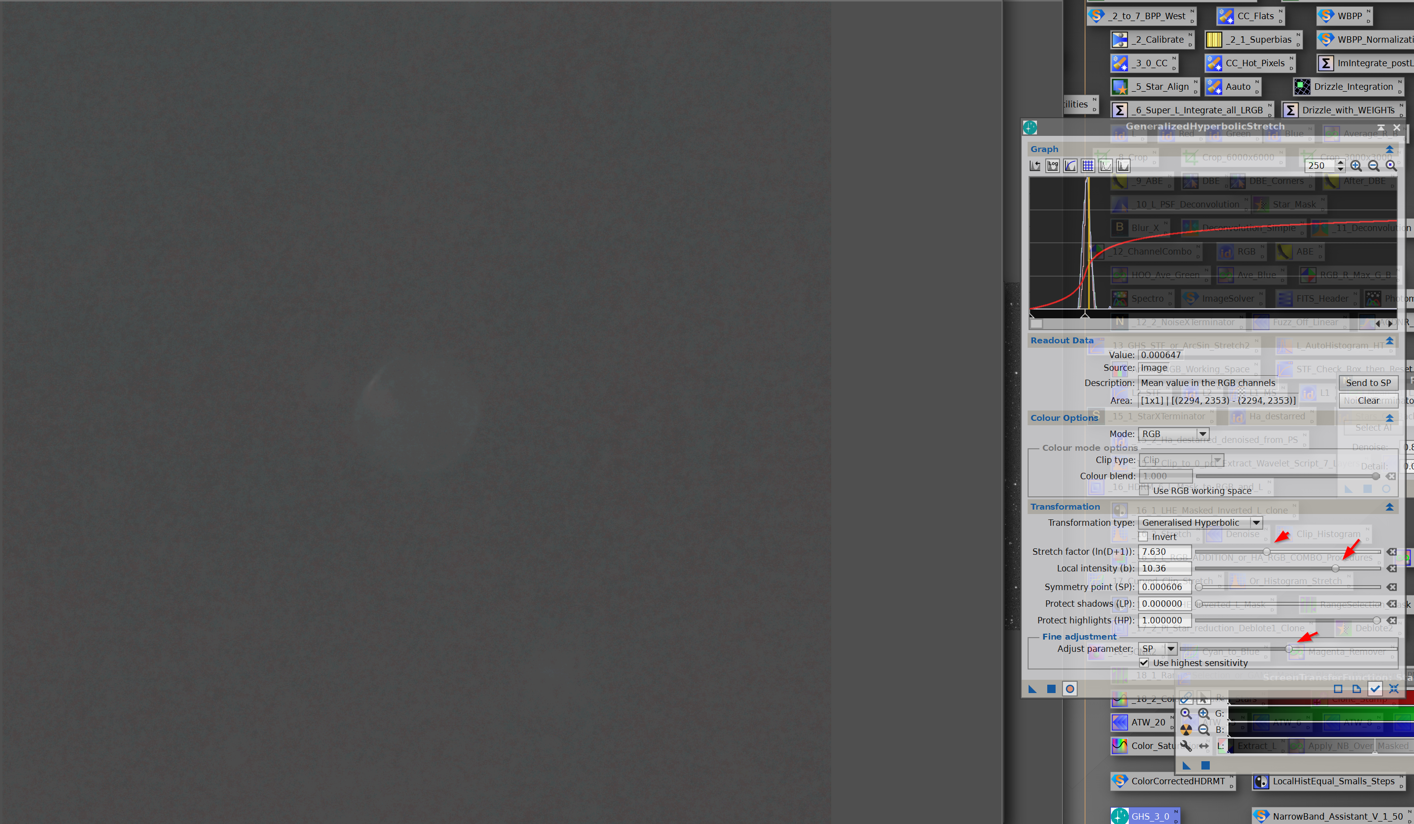

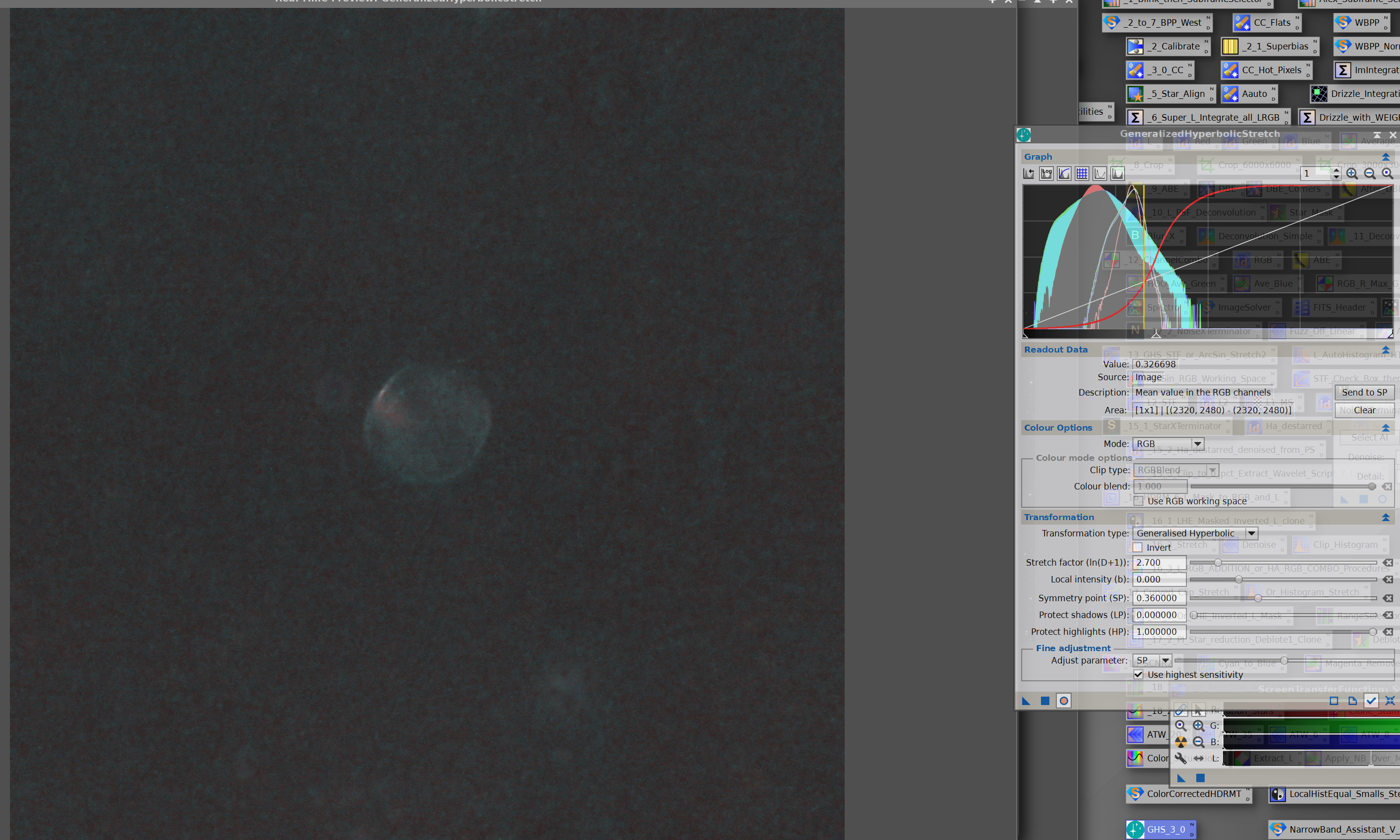

AM back with another tricky GHS problem.  I have this very dull PN that I am trying to bring out.  This is 8h of H-alpha and O-III.  This is my initial setting and the arrow is where I selected the SP:
You can just barely see the PN.  But it is there and I wonder should I manipulate the SP first and then b, or vice versa or does it matter and it is just artistry.
Here is what I get with the changes made... maybe just needs more exposure and is very dull?
Here is the second stretch, I think you can see what I am trying to bring out... these are cool objects... never thought I would see the detail at this scale.  A mask cleans up the background stuff.
This is the work in progress.
Planetary Nebula G1296+034
Gunshy61 11.24
Thanks for the post Jerry, and great capture.
As for using GHS, it just takes a little getting used to.   I would go back and forth on b, SP, and even D.   Just my initial thoughts from the settings - I would try and even larger b (put it to 15 to start), and then move SP a little to the left.  This will help darken the background, yet bring out more of the dim stuff and contrast it against the background.  Once this is set, you may want to back off b somewhat.
The other hint that I would give is to remember, you don't have to do the full stretch in one go.  On your last image, you have the whole RHS of the histogram plot to work with.
Hope that helps, but everyone seems to come up with their own style and methodology.
Dave

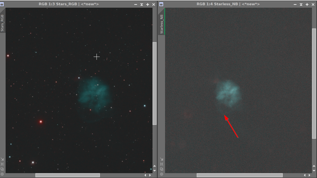

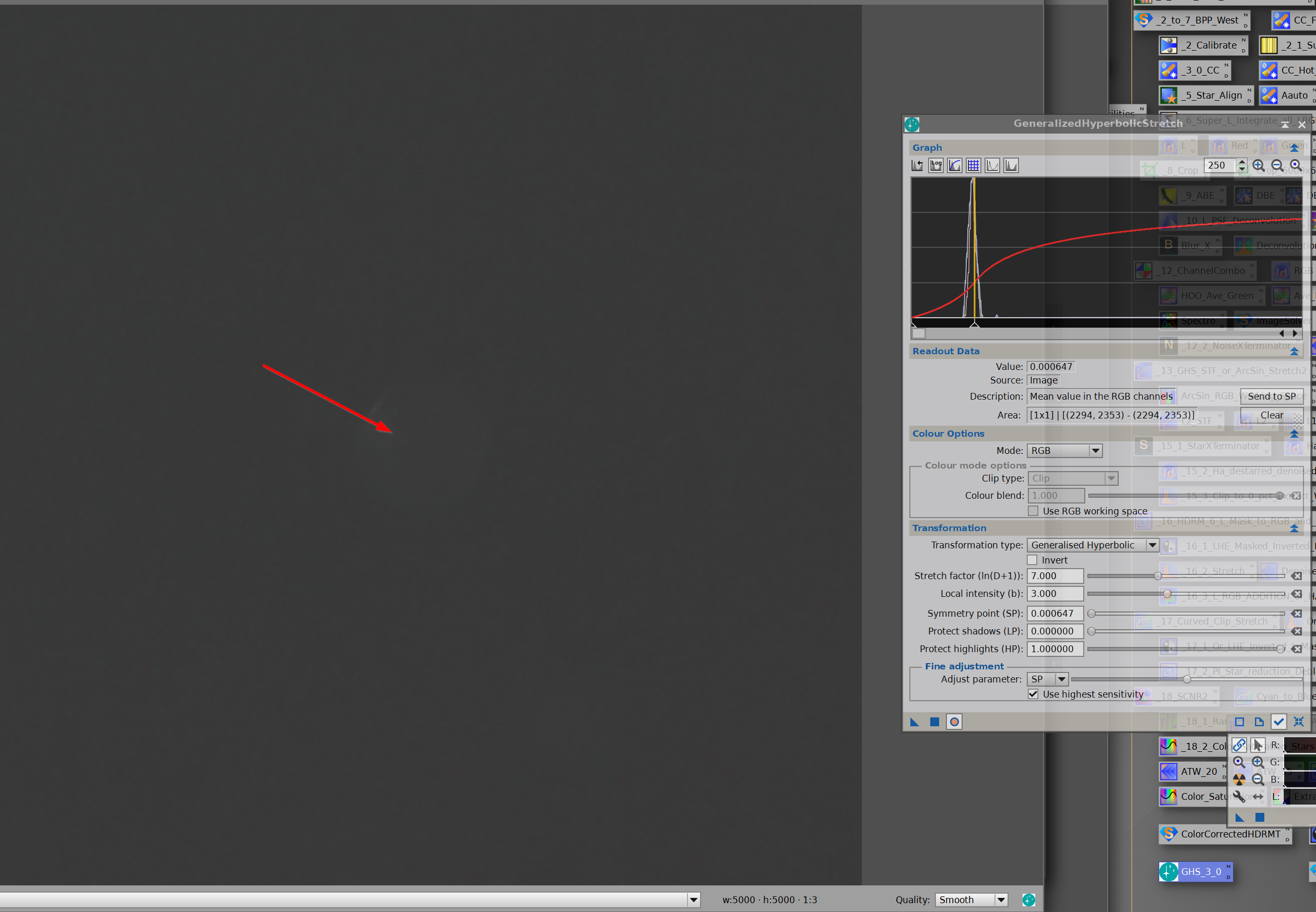

Yeah, I am playing around with some stars this AM on K 1-2... very dim PN and you can get to colors OK with RGB+Saturation.  I have gotten into using Bill B star reduction script to reduce some halos.  Stars get pretty small but they are colorful.
Having much more trouble bringing out dim structures in the PM, where the red arrow is.... best image on this is 40h cited in the work in progress at the bottom... and I am only at 9h. I may just need more time.... cannot make a pig fly!
Kohoutek 2-1
mike1485 24.46

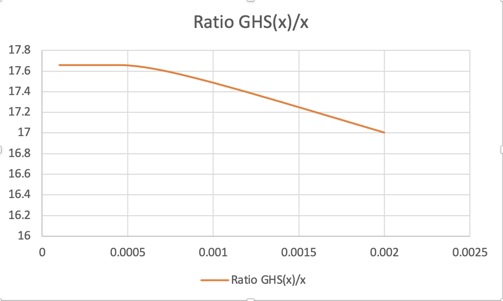

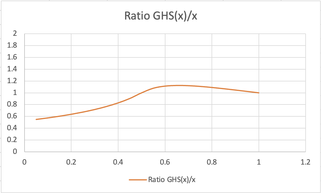

Let me start with some explanation of the difference between RGB and Colour stretch. Suppose we set the parameters (D, b, SP, LP, HP)  so that the GHS transformation maps the value x -> GHS(x). Now let the red green and blue pixel values be r, g and b.
Under the RGB stretch the new pixel values will be GHS(r), GHS(g) and GHS(b).
Under the colour stretch we find the average sample value m = (r + g + b)/3. Then we find the ratio k = GHS(m)/m. And now the new pixel values will be k*r, k*g, k*b.
Now let's think about saturation. The greater the separation between the largest channel value and the lowest, the greater is the saturation. Under one definition of saturation this can be written mathematically as (<max channel value> - <min channel value>)/<max channel value>. let's fix ideas and suppose r>g>b, then the initial saturation before the values are stretched is (r - b)/r = 1 - (b/r).
Noting that the GHS transformation preserves the rank order of pixel values, the saturation after the stretch will be:
RGB stretch: 1 - GHS(b)/GHS(r)
Colour stretch: 1 - (k*b)/(k*r) = 1 - b/r
This demonstrates that the colour stretch leaves the saturation unchanged.
The RGB stretch, on the other hand, will usually change the saturation. Specifically  if GHS(b)/b is greater than GHS(r)/r, saturation will reduce and vice versa.
Now let's look at your image. With stars removed the histogram is very tight with almost all pixel values falling between 0.0004 and 0.0005. Furthermore if you look at the readouts of channel values at each pixel, the values in each channel are very close. In the chart below I graph GHS(X)/x against x for a sample initial stretch for this image (specifically: D=6, b=10, SP=0.00045, LP=0, HP=1).
You will see that over the range of values covered by this image the ratio is pretty much constant. Hence, the Colour method and the RGB method will have very little difference in effect. In other images we will often see pixel values extending over a greater range and, in particular, extending into the area where the graph slopes down. In this area larger values are stretched less proportionately than smaller values and, from our previous analysis this means saturation will be lost.  When this happens the Colour method will preserve saturation as you have seen in most of your images.
You also commented that sometimes you see the Colour method reducing saturation compared to the RGB method. Let's take a look at the GHS(x)/x graph for a different stretch, perhaps something you might use as a second or subsequent stretch (specifically: D=1, b=4, SP=0.5, LP=0, HP=1). The graph looks like this:
Clearly the relationship here is more complicated and the upward slope of this graph below c0.6 means that applying the RGB stretch to pixel values in this range will increase saturation compared to the Colour stretch.
In general the RGB method will reduce the saturation in the image for your initial stretch but this isn't necessarily the case in subsequent stretches.
This may be far more detail than you wanted but maybe it helps?
CS, Mike

Hi Jerry,
Lots of good work here.... I am really enjoying your postings
I have been experimenting a little bit on the extraction of lum to use to bring out dim features such as you describe.  For many narrowband, most use either an extracted lum from an RGB image (minimizes noise by combining the most images) or the Ha channel, which, most often, has the strongest signal.   We are free, however, to use whatever channel or linear combination we want.   Since your object has the strongest signal in O3, i would process the grey scale O3 channel as if it were the luminance.   Once I get my best "colour" non-linear version, and my best O3/lum non-linear version then I LRGB combine them.   This will make the dim O3 nebulosity stand out from the whiter background.
So when picking a luminance to process, I often look at the dim features and their signal stretch.   In general I do a linear combination of an extracted RGB lum, and the individual colour channels to get the best SNR I can while emphasizing the features I want.   In this case, maybe 50% elum + 50% O3?
Also, on saturation, if you are dimming - saturation will be reduced using the colour option.   Often I use a muted colour option when stretching RGB, or not at all for NB and opt for a saturation stretch instead.   This is best accomplished with a -ve b (shaped like an arcsinh stretch).   If you imagine a right angle triangle in your histogram plot with its apex at 0.5 and corners at (0,0), (0.5,1) and (1,0), the right side of the triangle, sloping down from 0.5,1 to 1,0 represents a "do not cross" line when stretching saturation.
Hope this helps.
Dave
