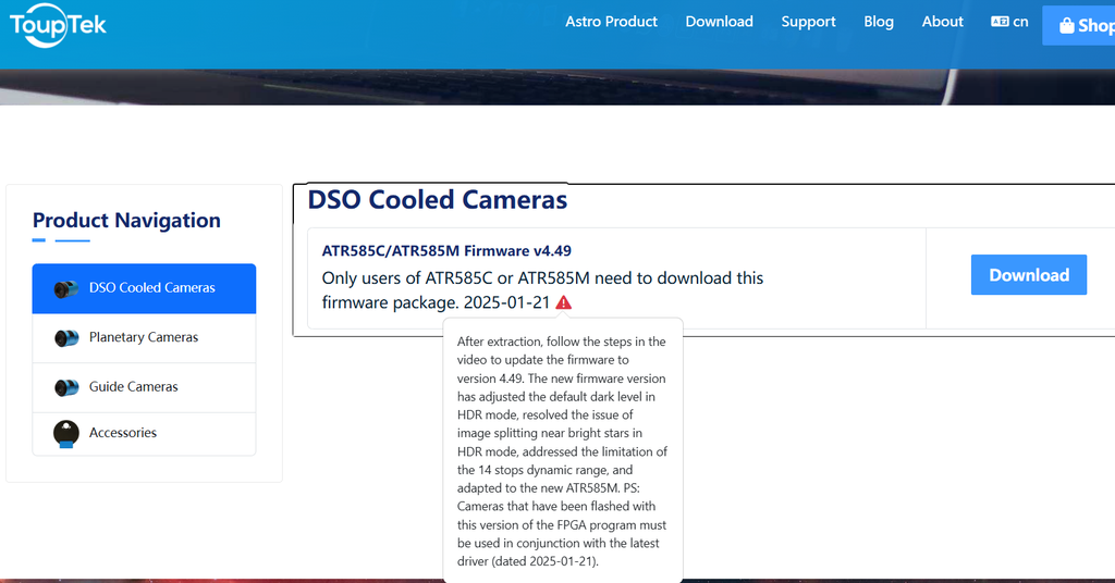

FYI - new Firmware (4.49) for ATR585C and "M" + new ASCOM have been released by Touptek  |

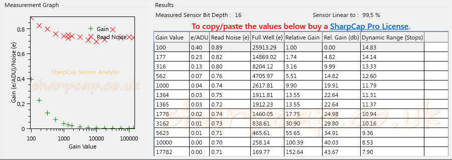

Results with the new firmware 4.49, native driver and latest sharpcap  |
 Read noise is insignificant so there's no reason not to shoot deep sky at zero gain. That's excellent performance.
Did you install also the latest Touptek ASCOM? Hi Seba, doesn't the chart show pretty ideal performance for HDR mode on the native driver? It would seem playing around with ASCOM is no longer necessary.
Did you install also the latest Touptek ASCOM? Yes that was with the latest touptek native & ascom drivers but i didnt ran a test on ascom

Did you install also the latest Touptek ASCOM? Hi Seba, doesn't the chart show pretty ideal performance for HDR mode on the native driver? It would seem playing around with ASCOM is no longer necessary. It does but my understanding is that when you update the ASCOM driver it does update also the ASCOM file in NINA and Sharpcap so results (in Sharpcap) of the sensor analysis are correct. But I may be wrong. Not an expert here.
