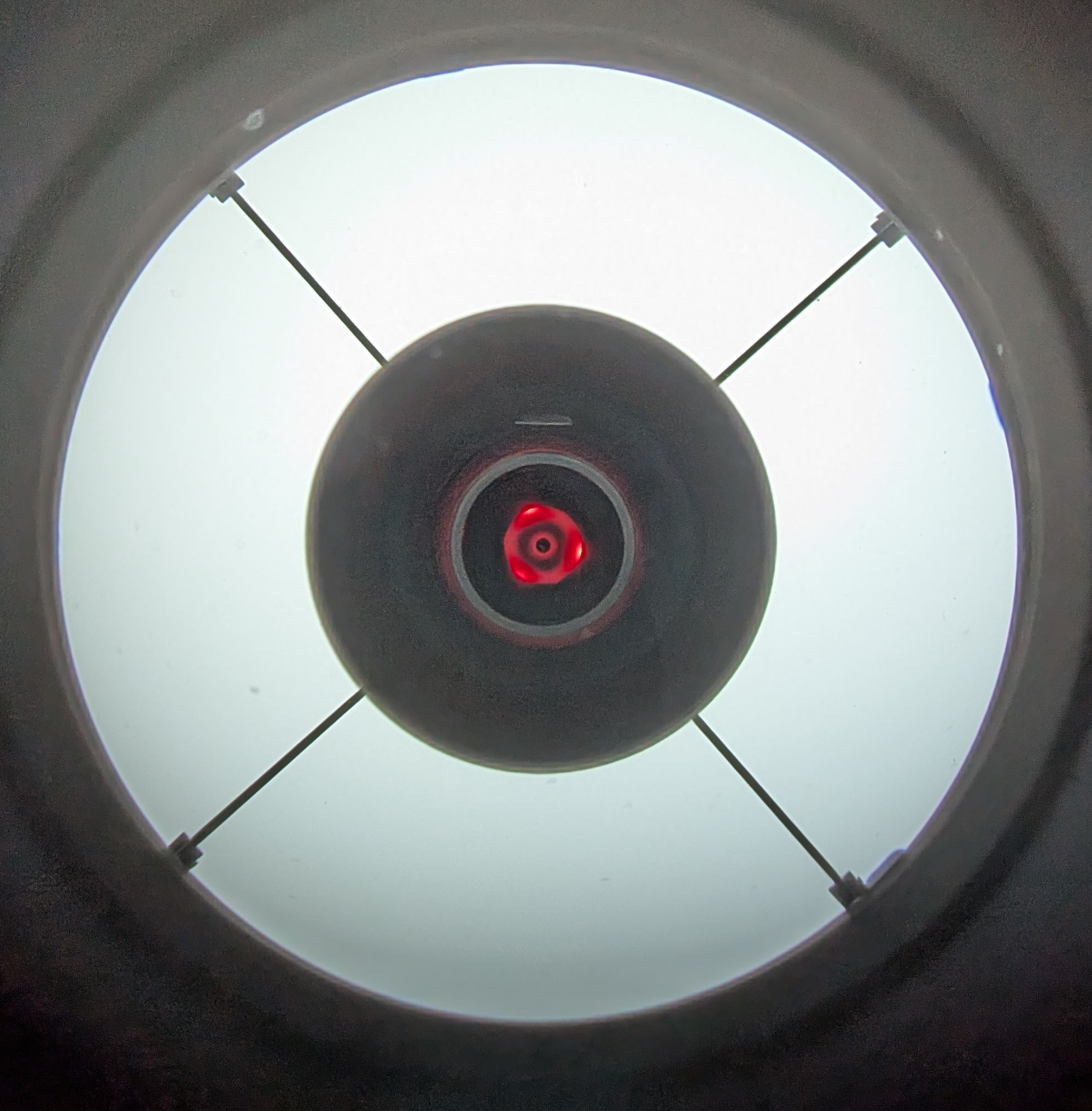

HelloI recently purchased an 8" Aperture CarbonStart RC telescope. In order to check the collimation, I removed the secondary baffle extension, so I can see better the entire reflection of the primary in the Cheshire eyepiece. One thing that called my attention is the reflection of the primary in relation to the optical axis is off center. The secondary mark seems to be well centered to the pinhole of the cheshire and the concentricity of the secondary holder in relation to the primary also seems to be good. So does it means that the primary cell is not centered well in relation to the telescope tube? The stars at the corners do not look very round, they have a bit of a triangular shape. I am including a single frame taken wiht ASI2600mc at native FLRC stars lower right corner.JPGRC stars upper right corner.JPGRC stars.JPGThank you for your help

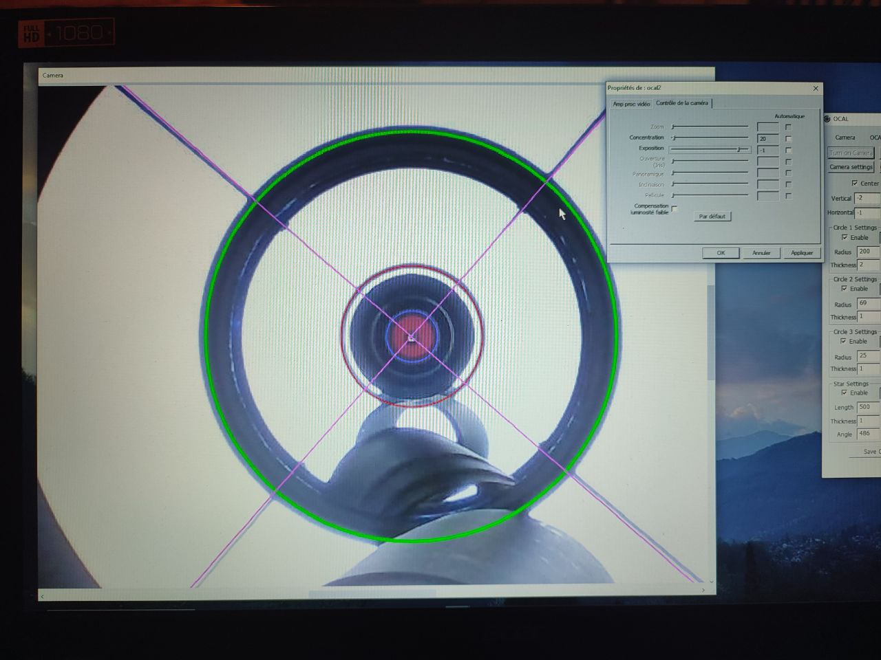

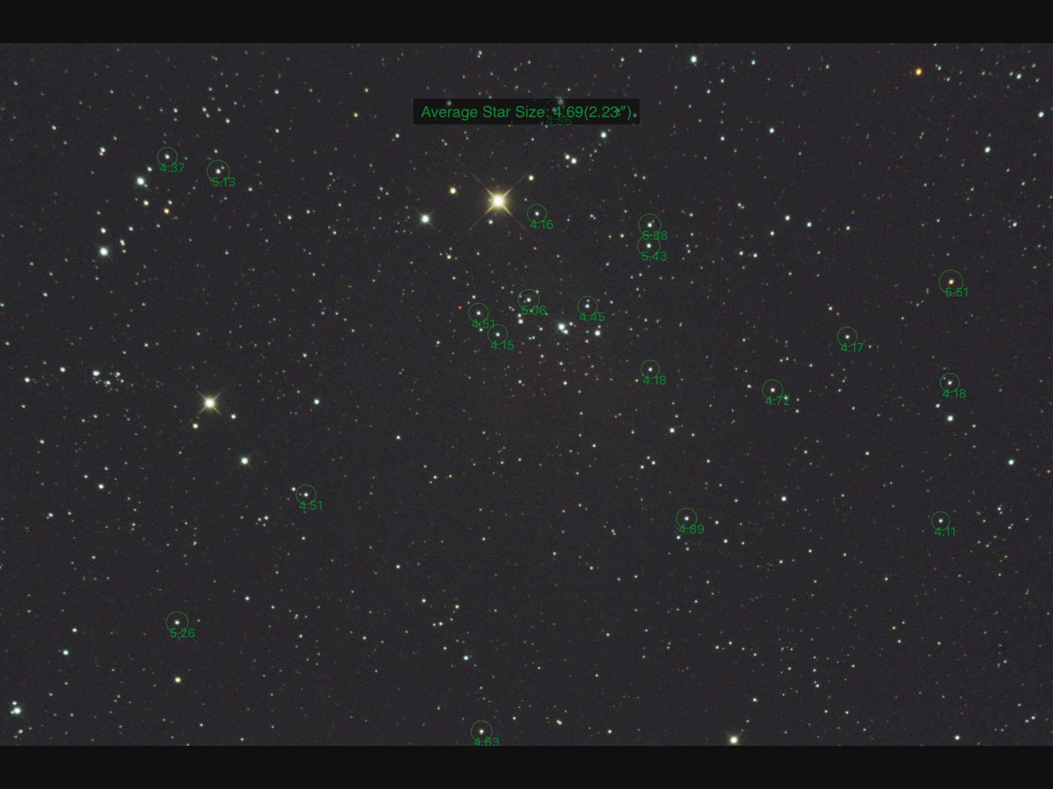

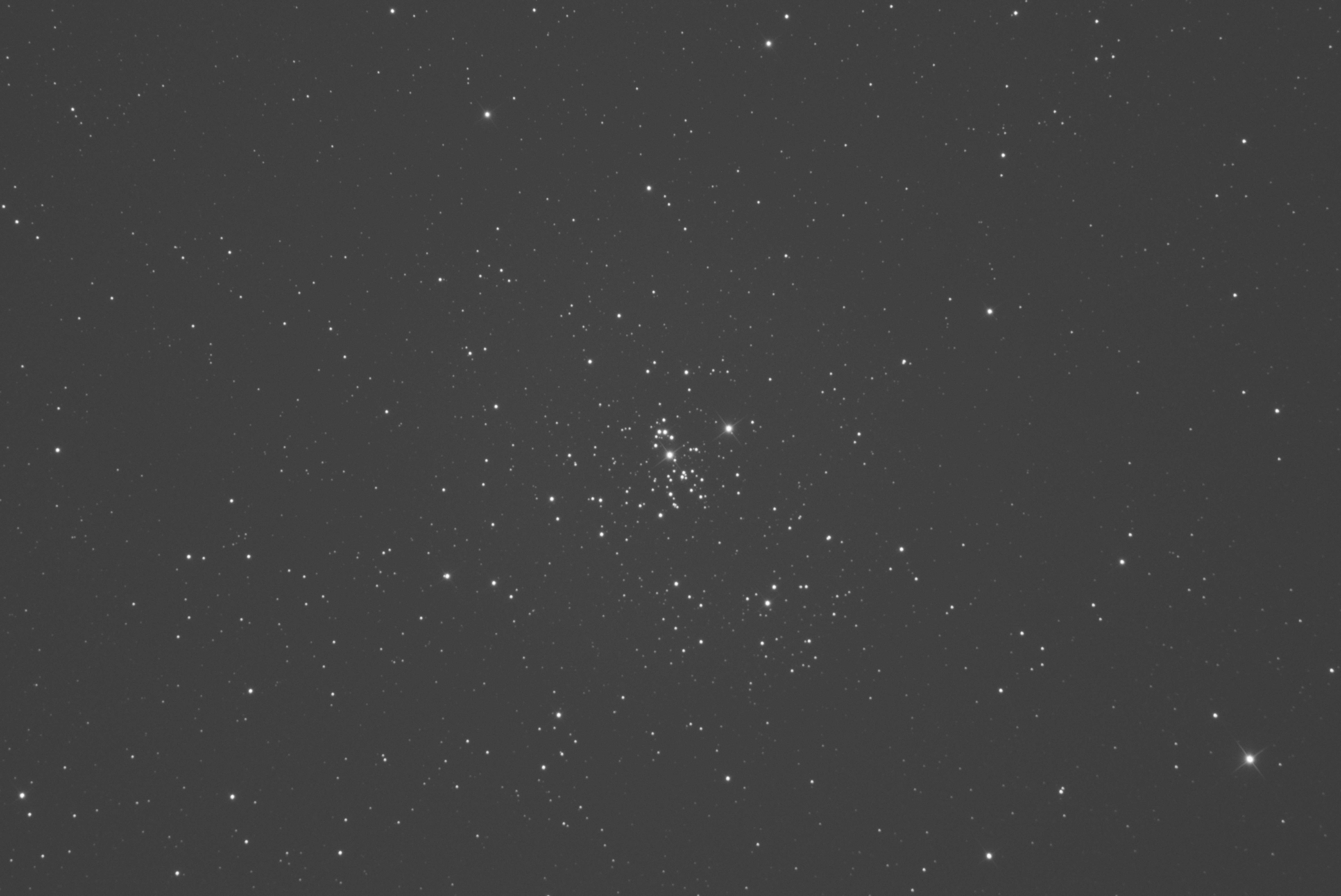

I also picked up the RC8 carbonstar. I do have pulled stars in the top two corners as well but I’m pretty sure it’s collimation on my part. It’s also my first RC coming from newts and learning about what it wants. Using an OCAL 3.0 to get close then fine tuning with defocused stars.
below is one of my screenshots through the ASIAIR with poor seeing conditions.
Thank you. Your picture looks similar to mine. I ordered the collimation focuser plate  so  I can do what you are describing

What is not clear to me is what to see in an out of focus star in this telescope.  Assuming the star is in the middle of the field of view, if the secondary shadow is not concentric to the white disc of the star, does it mean the secondary needs to be collimated? I have seen two videos: One tells to move the secondary to center the shadow in the middle of the bright disk, the other video tells to move the primary to center the shadow in the middle of the bright disk. What is the correct way to do it?
Thank you
Rodrigo Roesch:
Thank you
Neither. Centering the secondary against the primary with respect to the image plane (e.g., the Cheshire crosspiece) should done ahead of tilt correction which is what you do either using a tilt plate.

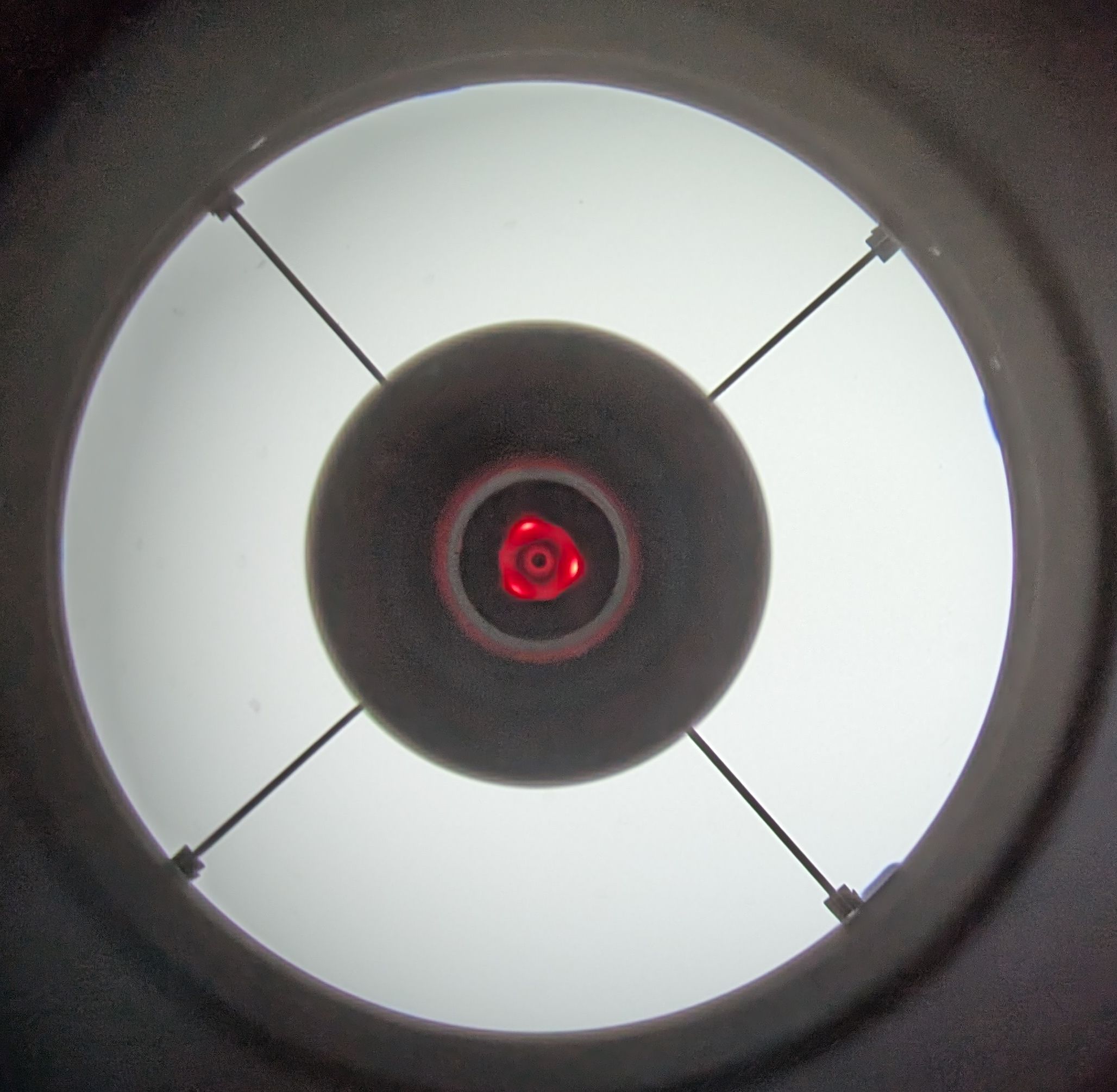

To refer to the first post : triangled shaped stars mean pinched optics. I noticed i easily can get triangled shaped stars by just tighten the screws of the sec a tad too much. From the moment you feel a little resistance do not screw it any further. The word 'tightening' is almost an overwhelming word for my screws on my sec.
rroesch 1.20
Freddy Meiresonne (Fmeireso)To refer to the first post : triangled shaped stars mean pinched optics. I noticed i easily can get triangled shaped stars by just tighten the screws of the sec a tad too much. From the moment you feel a little resistance do not screw it any further. The word 'tightening' is almost an overwhelming word for my screws on my sec.
Thank you, I most have tightened too much when I collimated the secondary

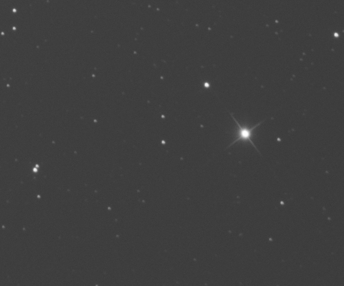

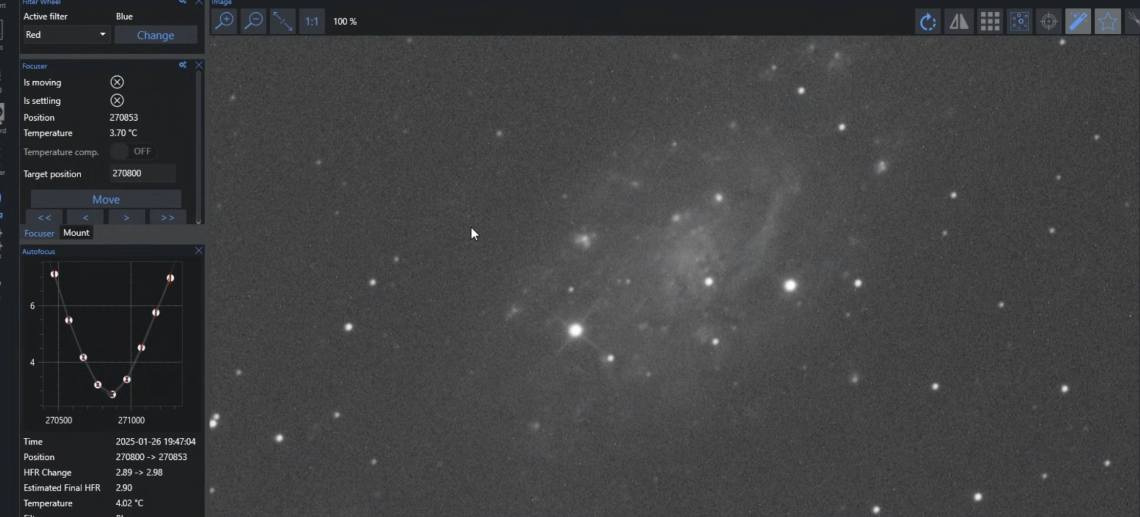

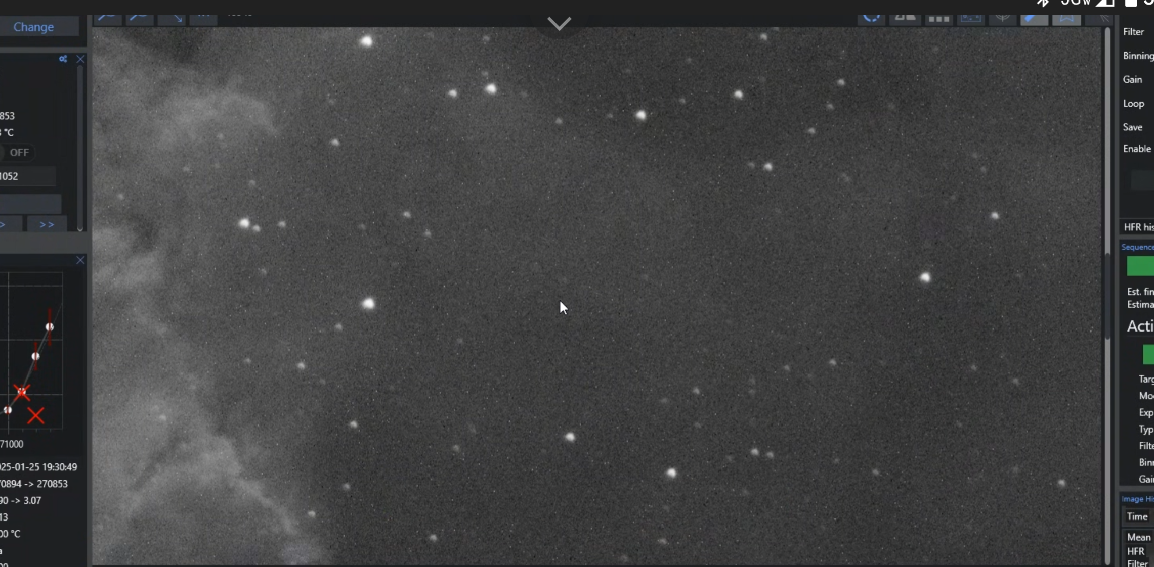

Someday I'll learn how to collimate this thing, not today, but someday. Everything looked great inside, not so much now. I thought my defocused issues were just thermal since the scope had only been outside about 30 minutes when I checked, coma and astigmatism looked pretty good though. Now I have these ugly looking star shapes. I do like testing just how much blurX can fix.
I cropped off the guiding graph, but I'm at 0.4 to 0.5 tonight so I doubt that's causing my issue. Screenshot_20250125-195906.png
That really looks like guiding error to me. At 1800mm 0.5" RMS might not be good enough, especially if the delta error is high between RA and DEC. I shoot at 900mm and can certianly see the effect if guiding gets much above 0.6" RMS.
jmdl101 1.81

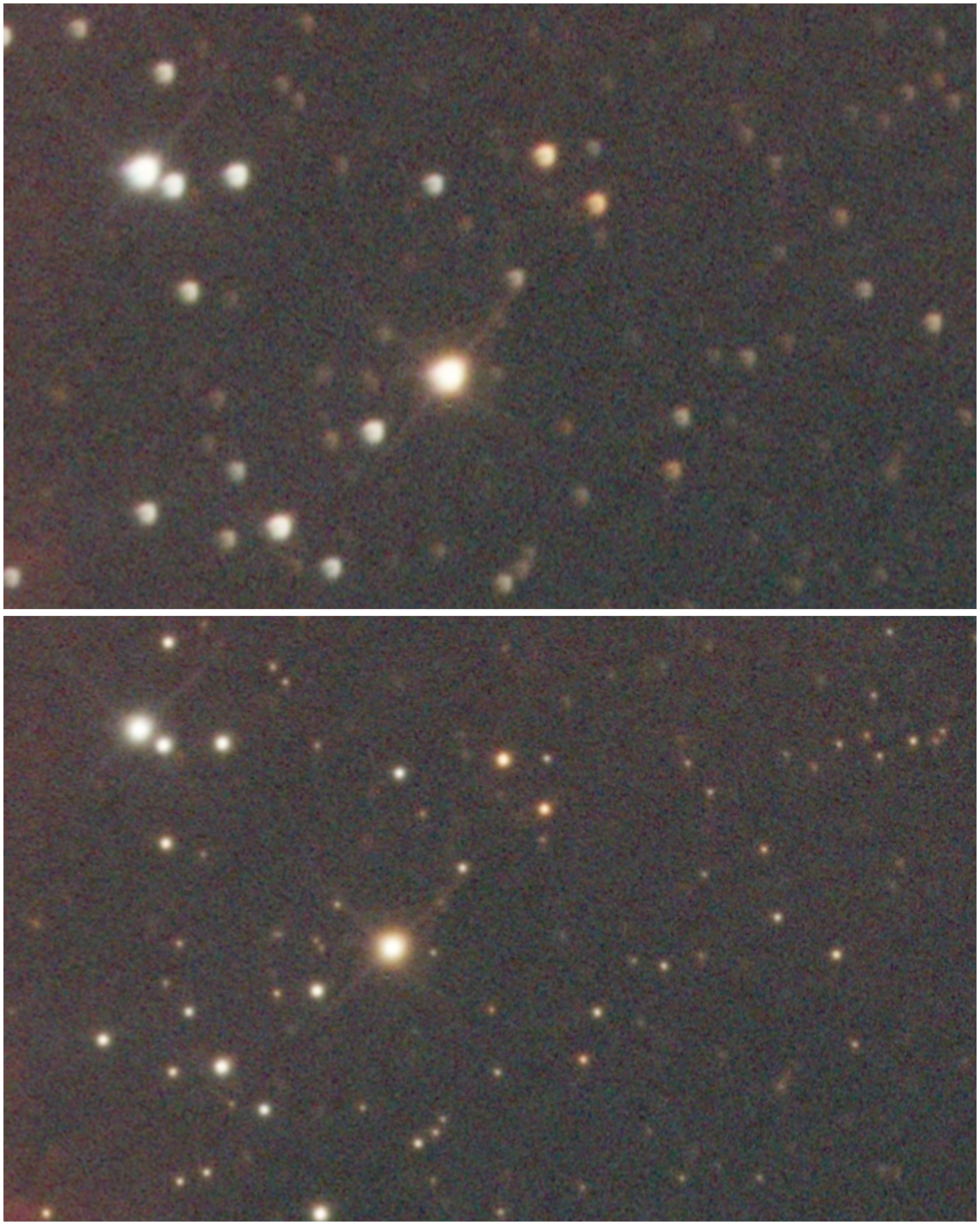

It's with the reducer at 1100mm, but the stars look the same blobby and spiky in the sharpcap live view at 1 second exposure length. I really think it's just my collimation, plus ASTAP is showing 23% severe tilt, that's probably not helping either. I think I'm just going to start over once I get the new focuser, maybe try it one night without the tilt plate at all.
Oh wow, a lot of things adding up then.
jmdl101 1.81
At least blurX can compensate for my failure. This is correct only mode.
Fmeireso 0.00
That still looks liked pinched optics to me…typically triangled shapes stars….

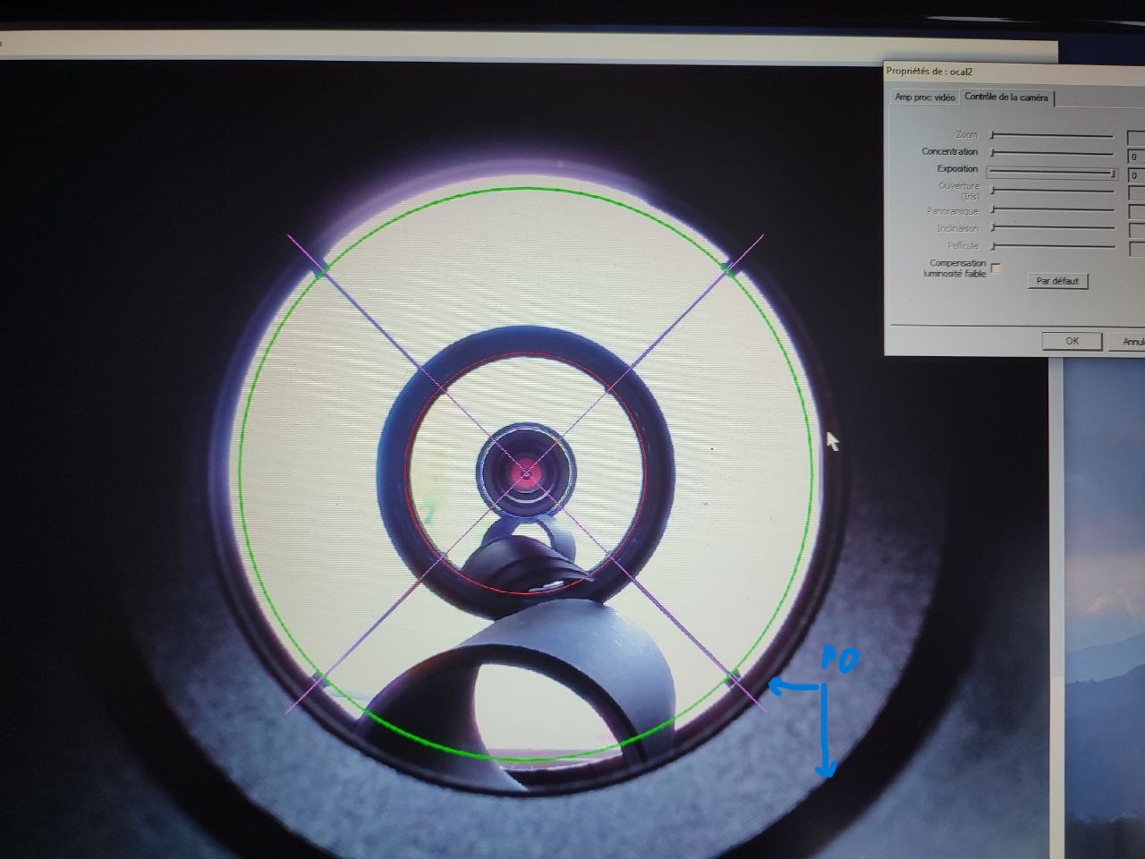

Also I am using ocal to collimate the RCs (I have 10,8 and 6')  it is working very whell but you also need to remove the primary baffle to have clear view of the spider and all the circle  inside. Then just follow the tutorial ocal has done for collimation of a RC6  because it works for all size of tube.  The only thing I do more is to adjust the tilt ring to center the black dot that remain not centered in the RC6 tutorial from ocal. After that I have nothing to touch  , the residual tilt is less than 9%.
The picture below show a residual tilt before I adjust the tilt ring, the spider is not perfectly aligned
at the end you have something like this
Are the blue arrows indicating the separation between the primary and the tub? do you center that by using the focuser tilt plate?  That is the part that looks off in my scope
