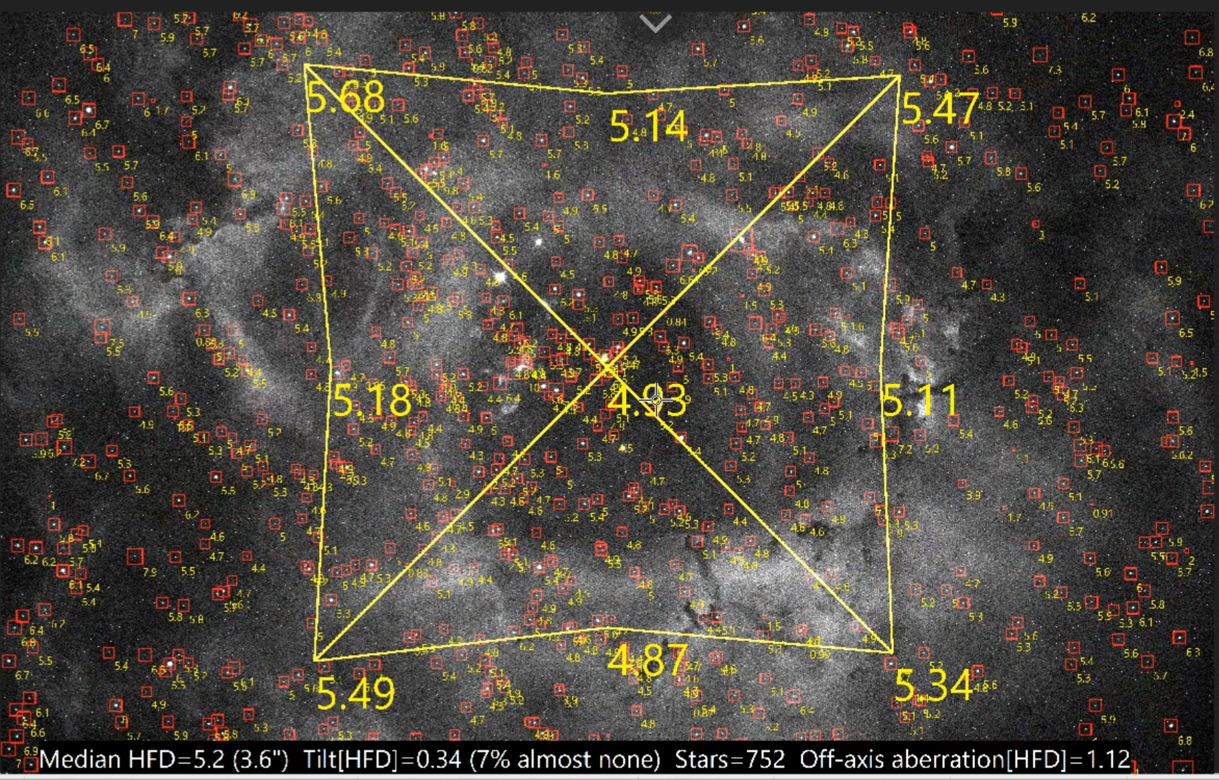

this is the result on Eskima nebula field of view image.png​​​​​​​

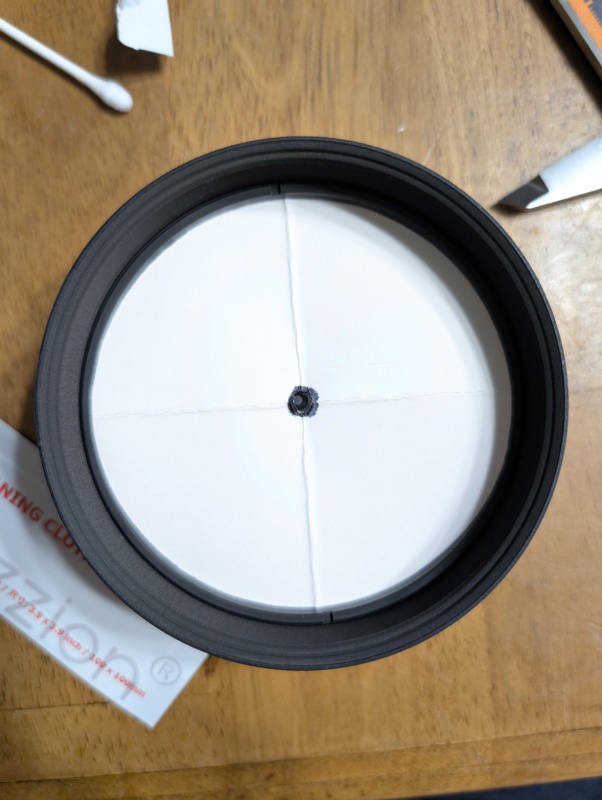

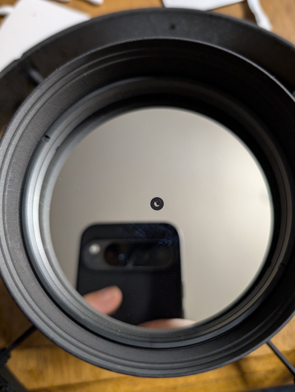

Well, my center mark is about 1/4 of an inch off on my Carbonstar RC8. You'd think putting a sticker in the center of a circle would be something that could be done without error. Weeks of frustration trying to collimate this thing have been because someone just didn't bother to put this sticker in the right place at the factory. I am glad I finally decided to check, but annoyed it had to be checked at the same time.
jmdl101 1.81
Apertura unfortunately etched the glass instead of using a sticker for the donut, so I reached out to see if I can get a new secondary with an actual center mark, instead of an off center mark. My center check looks exactly where my Cheshire is centered on after DSI method collimation. I'm confident the mark was made in the wrong place at the factory.1000014181.jpg1000014182.jpg
Wow, I did some collimation using the cheshire ignoring the center mark and centering based of concentricity of the secondary in relation to the primary and then centering the  secondary by making the reflection of the primary concentric to the tube. The position of the secondary mark is very similar as the one in your picture. Highpoint agreed to take the scope back and check it
Could not it be possible to simply place a sticker on top of the wrong sticker  to correctly mark the center ?  You ave enough space  not used because of the central obstruction in the middle of the secondary to do that I think
I've had mine a few weeks longer than you I think, delivered on December 26th. I really can't stand the 30 day policies for returning to the sellers, especially in this hobby where you can't hardly even truly test out a scope in that short of time. The center mark is very obviously a manufacturing defect, but now I'm going to be going back and forth for months probably to try and get mine fixed since I'm passed the magical 30 day point. I've sent an updated review on the RC8 to address the off center secondary mark, hopefully highpointscientific will publish it, customers should know to be aware of the issue before they waste multiple nights of imaging assuming the scope is properly made.
It's not a sticker, that's half of the problem, the mirror itself is cut for the donut so putting a sticker on it will then just create a figure eight looking cluster. I have marked the actual center with a sharpie marker, but it's very difficult to see through the cheshire since the original donut stands out so much better, and the true center is inside the original cut donut ring. At least there is a very large central obstruction so I do have plenty of room to work with, maybe I'll just make a big X to mark the center at some point.

Just a quick update, my collimation is dead on tonight using only the cheshire and the new center mark. Hopefully I hear something from Apertura soon, but at least the problem is an easy fix and just cosmetic.
jmdl101 1.81
Probably my last update on the thread. Highpointscientific reached out today, and after talking with them I decided I wanted to just keep my scope as is, instead of going through the hassle of exchanging. I think my image quality is excellent and now with the new center mark that I put on it I can collimate inside to nearly perfect. Hopefully they'll check some of the ones they have in the warehouse to see if more of them are mi's marked. I imagine if more than a few mirrors have the issue people are going to be struggling with collimation like we were and probably get fed up with the RC8.
