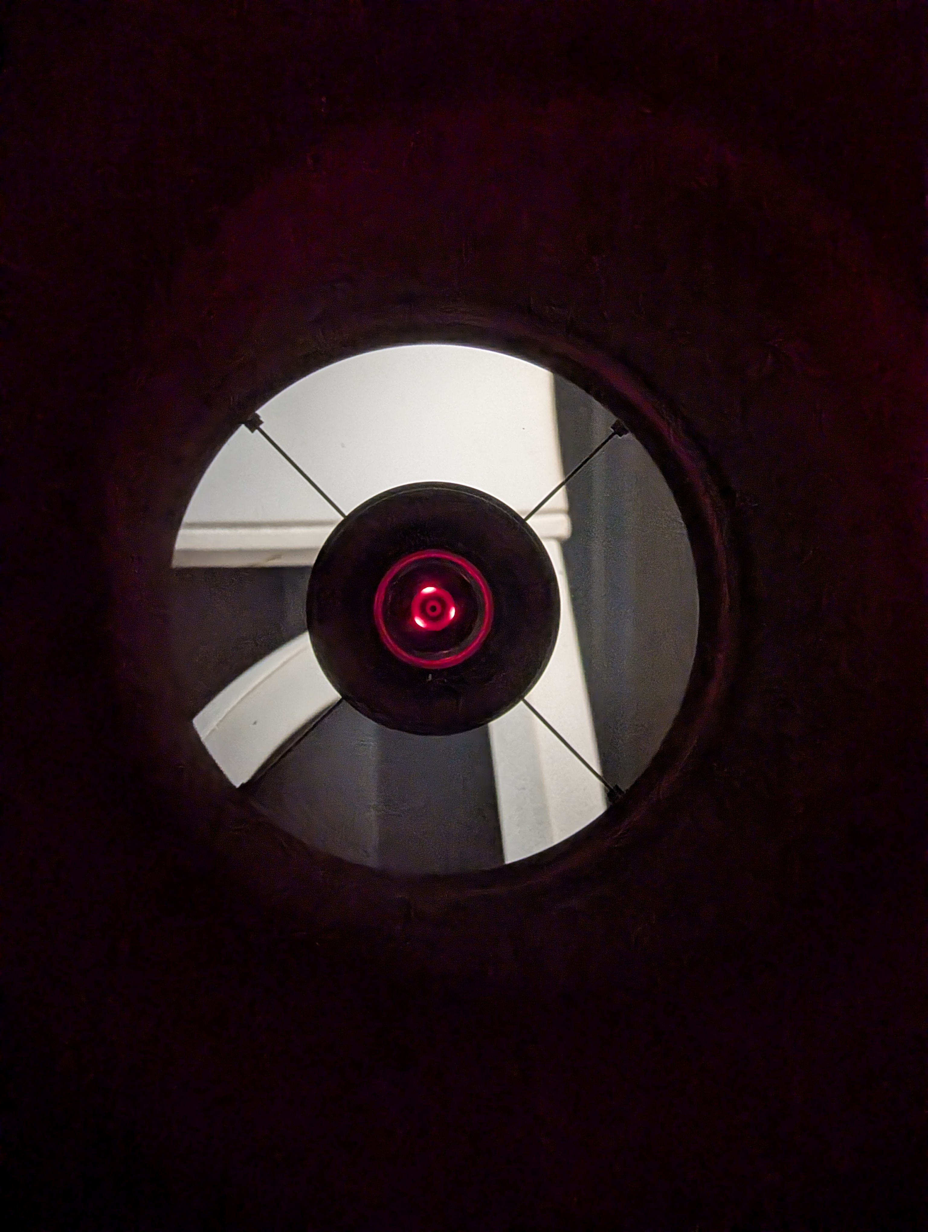

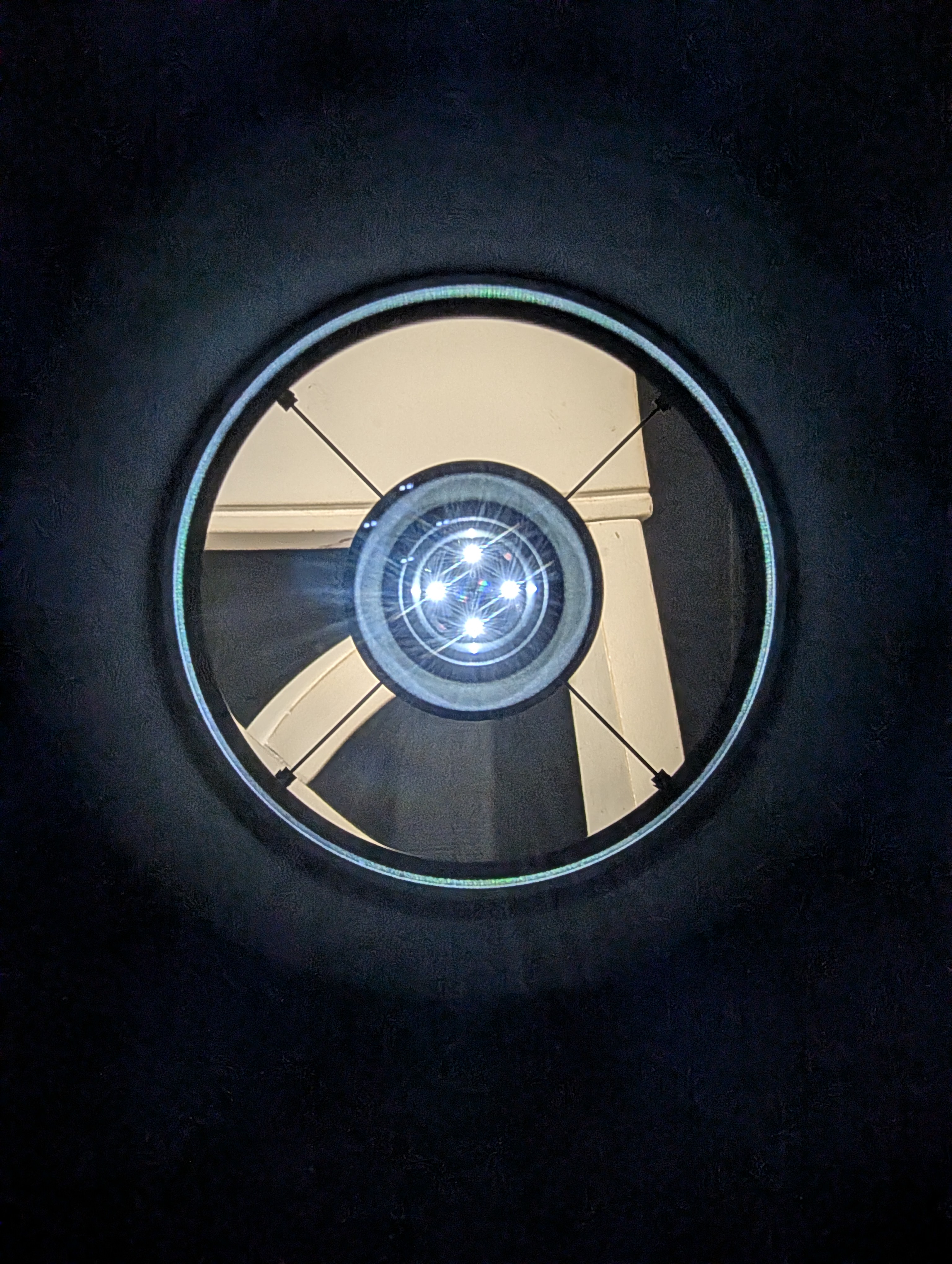

Here's a picture of my RC8 collimated with the TS RCKOLLI, basically an illuminated cheshire eyepiece. With it you just center the secondary donut in the eyepiece, then make the baffle tube concentric to align the primary. You can get a similar picture with a cheshire and collimation cap. This gets me very close on real star tests and I rarely adjust it any more in the dark.   Thanks for the instructions on resetting the primary. Finally got the collimation nailed down. Albeit, it's still off a tiny bit but then most probably I'll do star test and refine it further that way. Just tired at the moment so will try to at least enjoy what I got so far. Thank you.
