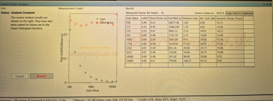

Today I received the new firmware 4.36 together with the Ascom Touptek dll.
After FW upgrade i did a Sharpcap sensor analysis:
At gain 100: 0,52 read noise!
15.75 STOPS
I'll post a screenshot later!
NonkelErik 0.00
TiffsAndAstro 1.81
Erik Derboven:
something looks odd as there is no unity gain? Also 585 is 12bit not 16bit.
Emission 2.11
Erik Derboven:
Wow! Absolutely mindblowing. I am so excited to use this sensor under the stars

Tobiasz:
Erik Derboven:
I'm not certain this image/test  is correct as it doesn't show unity gain? I'm deffo not an expert. Struggling to link a screen shot of my result from my 533 to compare though
StewartWilliam 5.21
TiffsAndAstro:
Tobiasz:
Erik Derboven:
The 585 has an HDR mode that up until now did not work, that is what this whole thread is about, the HDR mode means high dynamic range mode, it works by adding 2 modes together to produce a 16 bit mode, and now with this new firmware it seems to work….
so the test is correct 👍🏻

I Read that screenshot of the test such that at 100 gain it needs 2 1/4  electrons to gain one adu.

Emission 2.11
TiffsAndAstro:
Erik Derboven:
585 is 12Bit in LCG/HCG Mode. HDR output is 16Bit.
StewartWilliam 5.21
So what is unity gain then, as that confuses me too, it’s not on that chart, or is it a lower setting like a gain of 50 or similar….?

I'm really wondering how this works. I need to read more into this, apologies. Is the temp set to plus 10c ? Can't see a minus sign.
NonkelErik 0.00
Yes +10 deg C
Emission 2.11
TiffsAndAstro:
Tobiasz:
TiffsAndAstro:
Erik Derboven:
Temperature should not matter, but Touptek uses minus 10 degrees in their manuals.
If you want to read more about it, then Sony's Starvis 2 and "ClearHDR" are the terms you are looking for.
No need to apologise.
StewartWilliam 5.21
So I ask the question again, what is the unity gain of this camera when using the HDR mode, as there is not one on that chart….??/
Emission 2.11
There is no unity gain in HDR mode, because the sensor has already 0.44e/ADU in base gain, which is 100. Regarding the touptek manual of the 585, unity gain (1e/ADU) can be achieved with High Conversion Gain mode and gain 100.
You are free to use HCG/gain100 but the HDR mode is and will be superior to HCG regarding full well, read noise und dynamic range.

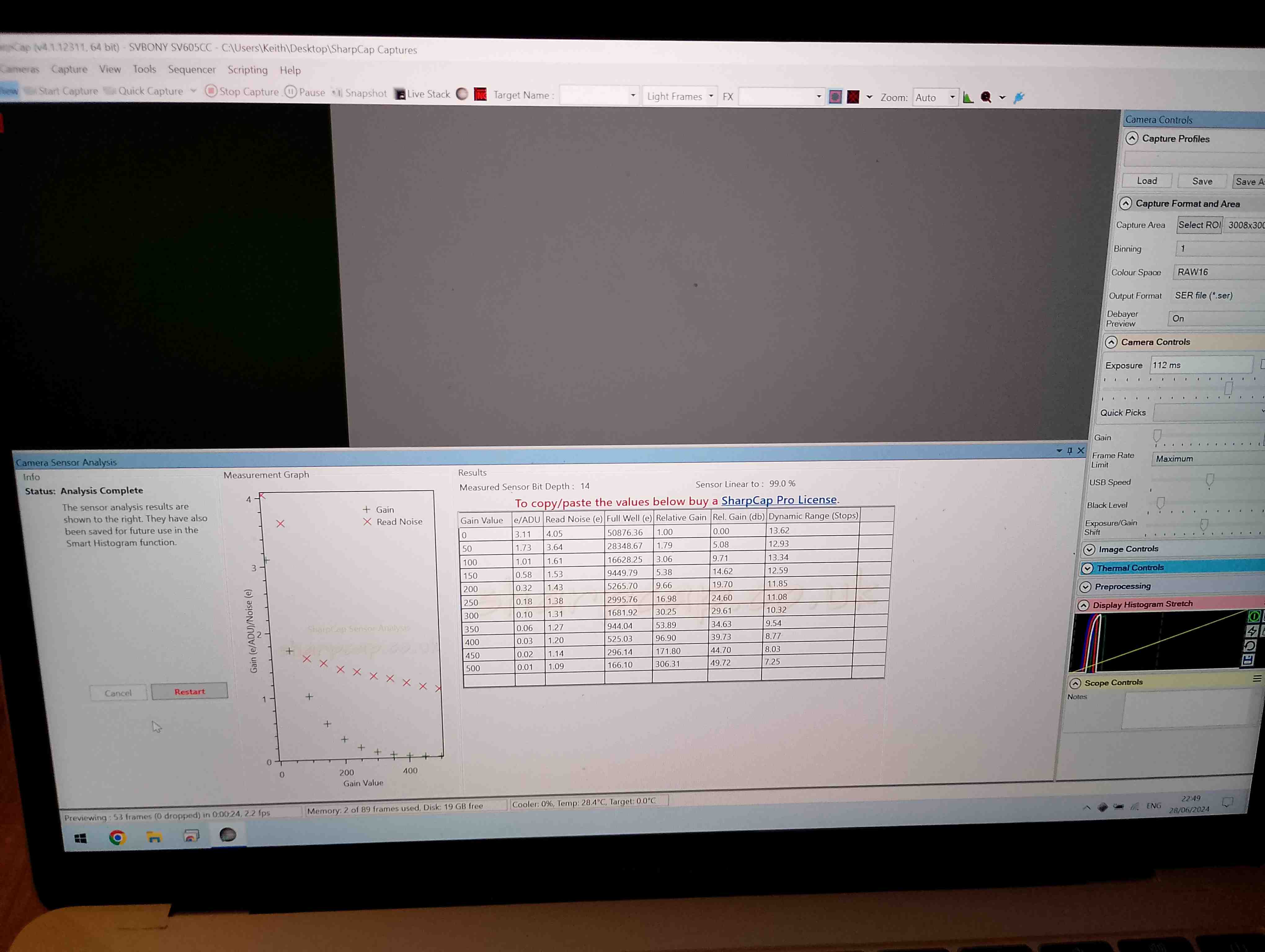

TiffsAndAstro 1.81
here's my test of my 533 couple weeks ago for comparison in case it helps any. 533 has a 14bit adc and sharpcap reports it as 14bit, so im a tad wary if sharpcap says 585 is 16adc. is it possible the revised driver converts 12 bits to 16 bits and could that account for the lack of unity gain showing? i think both sensors output 16bits to nina when imaging, but the 533 doesn't seem to in my sharpcap, so i have to wonder why the 585 says 16bit in that test?
Emission 2.11
TiffsAndAstro:
Yes, the 533 has a 14bit ADC which combined with the other sensor specs results in measured 14Bit Output. Regarding NINA and 16Bit, I think NINA does some bit scaling with images.
As far as I understand Sharpcap does not report the ADC resolution from the sensor directly but calculates it based on the images and measurements it takes.
I can only repeat. The 585 does ClearHDR imaging, which takes two images at the same time and merges them on the sensor directly. The sensor is doing that, what we are doing with astrophotography: Stacking/Merging images to gain a higher dynamic range.
Edit: Now that I see your screenshot and Gain0/50. You have a SVBONY camera correct? Most brands do not have modes like "Low Conversion Gain" or "High Conversion Gain", the switch is done "on the fly" while raising the gain. You can see it in your sharpcap result between Gain 50 and 100. There is a great fall off of read noise and full well, because the camera switches over to high conversion gain.
Touptek cameras don't do that, you have to know which mode you want to use first and choose it via dropdown in NINA directly. And regarding the 585 you get a third option, which is "HDR". With this camera I would forget about using LCG/HCG and simply use HDR forever.
StewartWilliam 5.21
TiffsAndAstro:
I think it’s been explained multiple times why the 585 shows 16 bit in the chart, this is a superb feature of the camera and apart from the smaller sensor is superior to the 533 in many respects, so your chart has no real bearing on this camera as it’s a different beast altogether…
The HDR mode is very interesting and clever how it works and maybe something that could be built into other 12 and 14 bit Touptek cameras in the future…
Emission 2.11

yeah i watched cuiv's video some time back. i'd imagine other 'manufacturers' using imx533 will be implement it on their versions if they wanted to. ill go find out how the imx533 is able to turn 12bit into true 16bit on chip as someone said happens, above. perhaps touptek make use of the ddr buffer to store both images and then some processing capacting to merge them or something.

i don't think imx533 is starvis2, which is a shame. i think its great touptek can improve on a 12bit sensor by doing stuff like this. pretty amazing.
