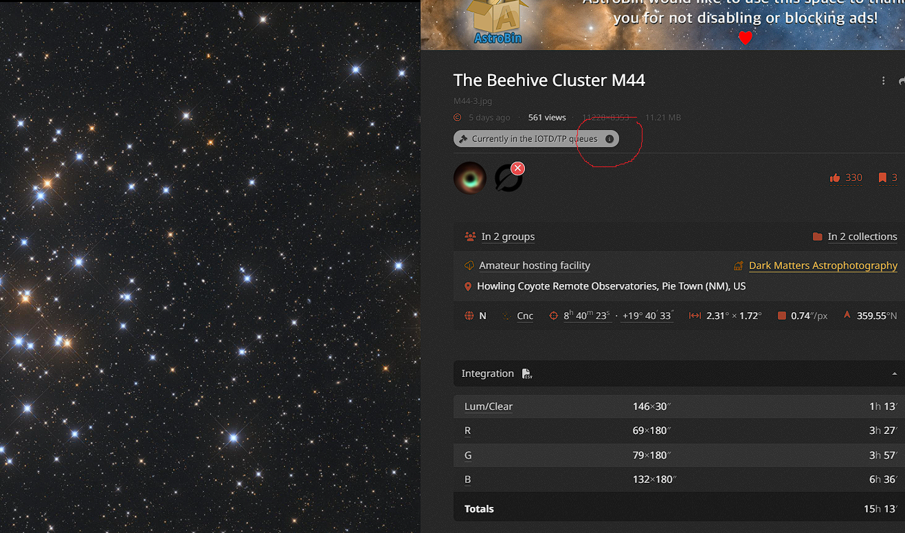

Where do you see submitter votes?
bdm201170 8.64
Hi.
just click here
