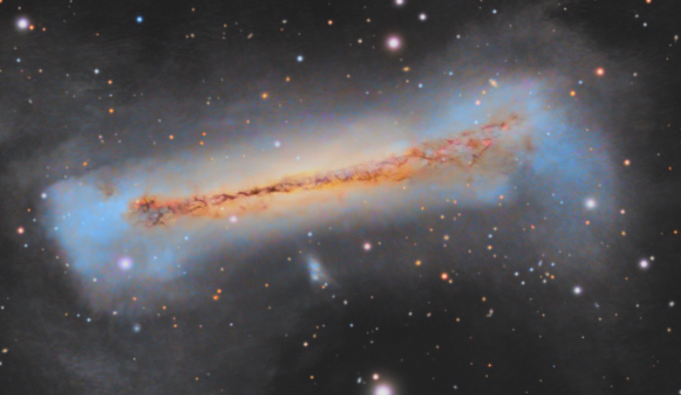

pmneo 2.15
Thank you Alex and Rainer.
@Rainer Raupach you are right. I think I was too focused on that tidal trail instead of the galaxies itself. What is your opinion about this Version:
https://app.astrobin.com/i/1m3ks5?r=F
Philip

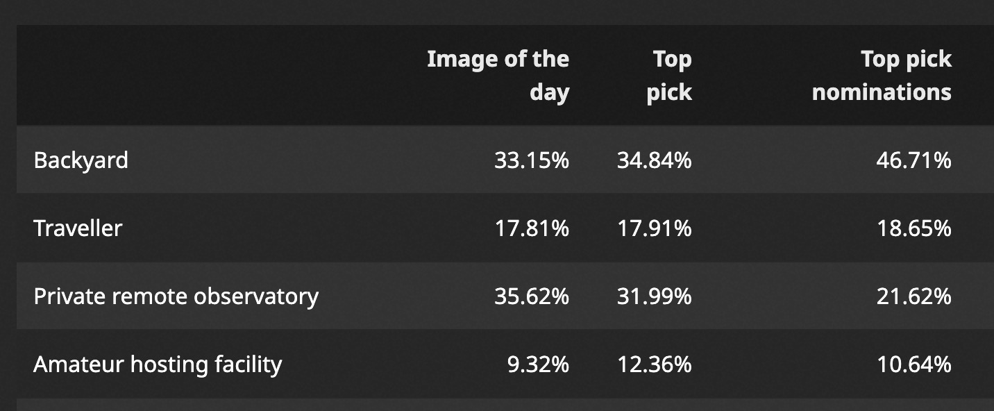

·  14 likes
Monty Chandler:
It's a nice image, but backyard astro-photographers rarely get the nod.  History shows they appear to prefer the bought images.
This is demonstrably false tho.

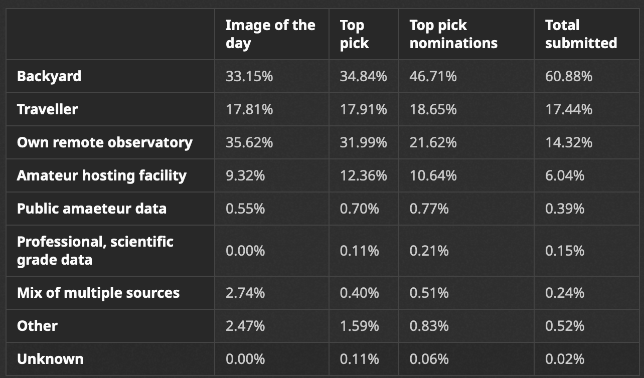

HegAstro 14.24
·  6 likes
Salvatore Iovene:
Monty Chandler:
Hi Sal,
You should share the full data which also includes total submitted. When you do this, you see that backyard is underrepresented as a proportion of submitted. Of course, there are very good reasons for this. People travel or set up remote sites because what can be done from most backyards is limited, especially for L/RGB.  My only point here is that if you only share part of the data, people will start to question why. I don't think there is any conspiracy here. Submiters, judges, promoters etc. are all just doing their job. Which is to select, in their view, the best images, regardless of source. FWIW, if I could afford to go remote, I would too. It is just a fact of this effort.

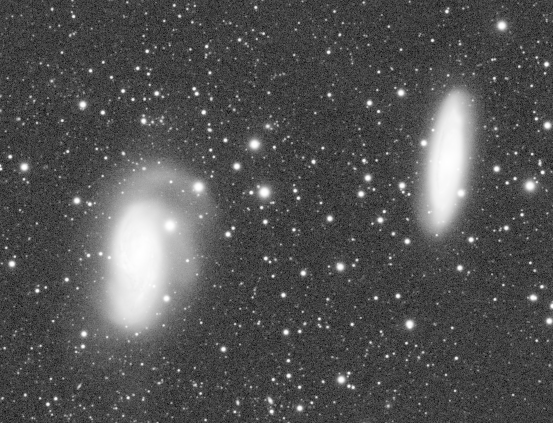

Well the AutoSTF from the RAW Luminance of the galaxies is looking like this:
I have created a more galaxy core detailed version and less statured stars:
https://app.astrobin.com/i/1m3ks5?r=H
Thank you all!
siovene
Good point, thanks @Arun H! Didn't think of that, seeing that this data is linked straight on the front page near the "Image of the day" label. It is true that the remotely acquired images are over-represented, but this actually proves that the IOTD/TP works well in selecting for good images, which its goal after all, regardless of the acquisition type. Remotely acquired images usually benefit from better equipment and better location than the average backyard image, so that's only natural.
I suppose that if we tracked "money spent" that would also correlate with "probability of having an IOTD/TP award".

It is an over-processed rendition of the tidal stream, in my humble opinion. Isn't it strange that a galaxy (IC 2787) has almost the same brightness as the knots in the tidal stream (relatively) next to it? I don't mind the color noise and saturation by the way. Please don't start another "why this and not that" thread. Enjoy the hobby ❤️
pmneo 2.15
Die Launische Diva:
Well, over-processed is relative in my opinion if you take a look into the auto stretched starless lum:
