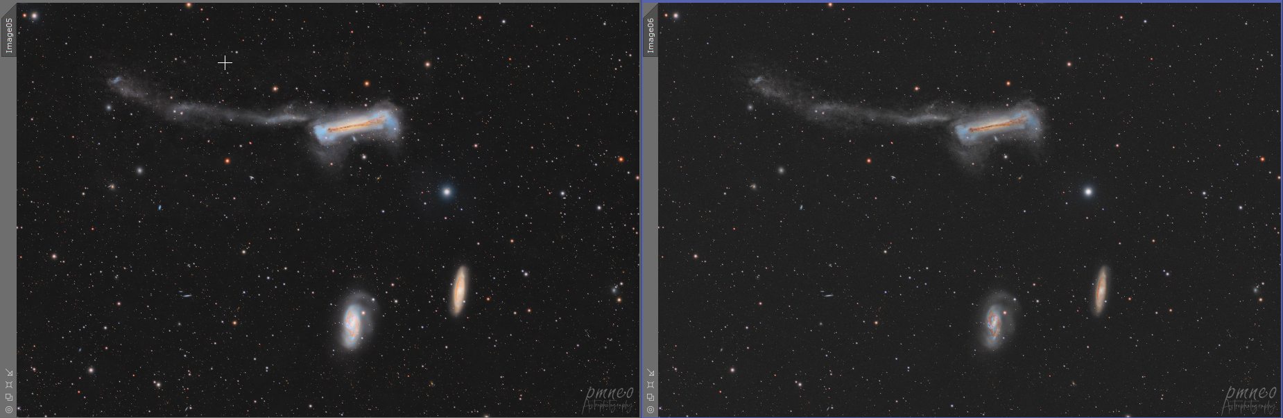

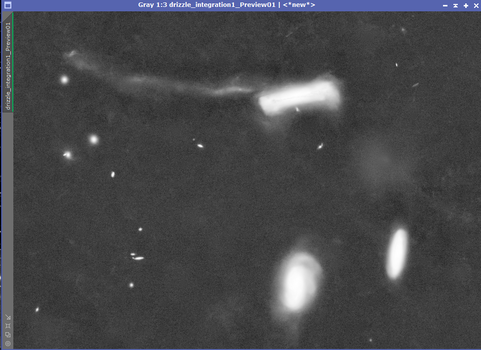

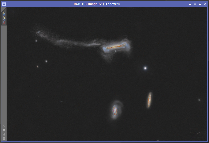

Die Launische Diva: It is an over-processed rendition of the tidal stream, in my humble opinion. Isn't it strange that a galaxy (IC 2787) has almost the same brightness as the knots in the tidal stream (relatively) next to it? I don't mind the color noise and saturation by the way. Please don't start another "why this and not that" thread. Enjoy the hobby ❤️ Well, over-processed is relative in my opinion if you take a look into the auto stretched starless lum:
And this is the starless version of your image which shows a nice processing of the Triplet galaxies, and some selective processing of the background and the tidal stream:  I (want to believe) that Submitters have become more experienced in spotting such issues, and I eventually hope that my response was a constructive one. CS!
Yes  The CC that I got today helped me a lot to enhance my image, in my opinion!  Thank you all! CS
