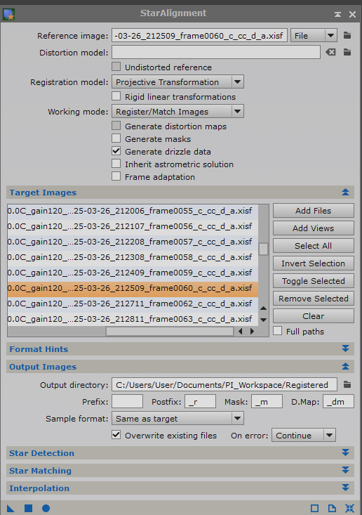

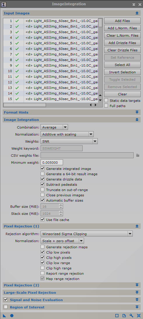

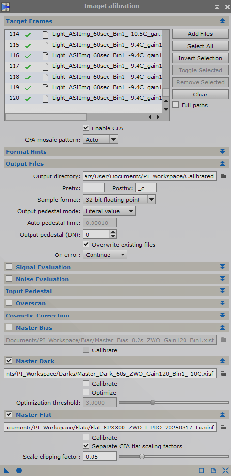

Flat-darks are absolutely necessary with the 294MM/MC and bad calibration will ensure if you do not use them to calibrate your flats. I have two of them since a number of years (it's my main workhorse, so to say) and I can swear to that.
As for the alternative way to calibrate your light frames, assuming you have the master dark and the master flat is to fill in the form as shown below:
The use Debayer . Just fill in with the files you produced at the step above.
The register the light frames, as in the example below:
Then add them together with:
This is just a basic workflow and I am omitting non-essential steps here. The point is to get a fail-proof results and take if from there (if WBPP doesn't work well for some reasons).
