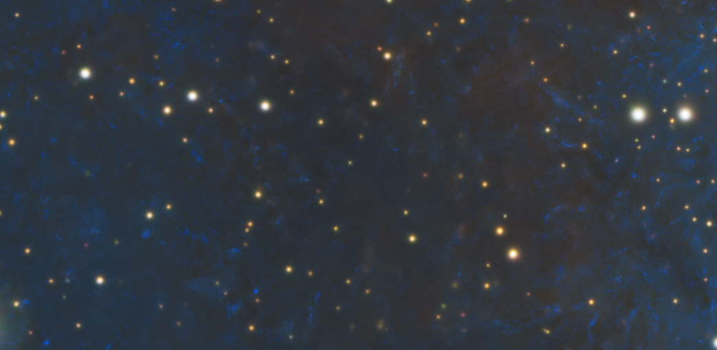

I think the biggest thing I struggle with is avoiding the imaging turning blotchy, like here:
https://app.astrobin.com/u/craigdixon1986?i=imady6
This target was fairly low down and shot through less-than-ideal seeing but I should have done a better job with the processing. I'm finding that as I start to image the less popular and harder targets, processing becomes much more important and I'm not sure that I'm doing my targets justice.
Any help is very much appreciated. I'm willing to put the time into learning but I'm just not sure where to go from here.
Your image scale is FAR too high to yield good SNR, so I'd start start with leaving the drizzle button alone. And processing everything as a NB Hubble palette is doing those images no favour either. That's even more so because they are most emphatically NOT NB images at the source. And as for the rest, it's not what you do is how you do it. Same as cooking, in a way.
WhooptieDo 10.40
Every step you do, take a look at the previous at the pixel level, and particularly in locations with sharp edges.  Did my step help or improve the image?  Compare it to the original raw image.   Does it look worse?   Often times, the answer is yes.   AI tools are extremely powerful and must be used in moderation.
In the case of your splotchy image, I would venture to guess this was due to a combination of heavy denoise and overstretching your data.
This background is a hallucination resulting from AI denoise, and you amplified it with your curves or stretch.

Brian Puhl:

WhooptieDo 10.40
Craig Dixon:
Brian Puhl:
Thanks, that's really useful. Sometimes it's hard to have self control and it's easy to forget to look at the image at a 1:1 scale. With this image in particular, I think I was just so desperate to pull the blue out that I lost sight of everything. Most YouTubers recommend running noise reduction at the linear stage but I found that this just causes blotching far worse than in this example. I therefore started leaving NR until later in the process. Would you suggest just scaling back on the noise reduction or taking out of the workflow altogether?
I hate to be that person, but I don't recommend Youtube in general for alot of processing techniques.   Very few have it right, and the ones that do I just generally don't agree with.
That being said, it's generally accepted that you perform noise reduction at the linear stage.   Personally, I try do do most my noise reduction towards the end of the process.  Prior to that, my goal is to manipulate the data in a way that doesn't require noise reduction as much.   Basically that means stretching it less.   To achieve this, my basic stretch is simply an STF, then I back off the black point, and mid points until I don't have significant visible noise.    Stretching, it's like a rubber band.   Stretch it far enough and you'll begin to see the little cracks in the rubber.    My goal is to never push the data that far..   Things like brightness can be adjusted with luminance, instead of RGB curves.

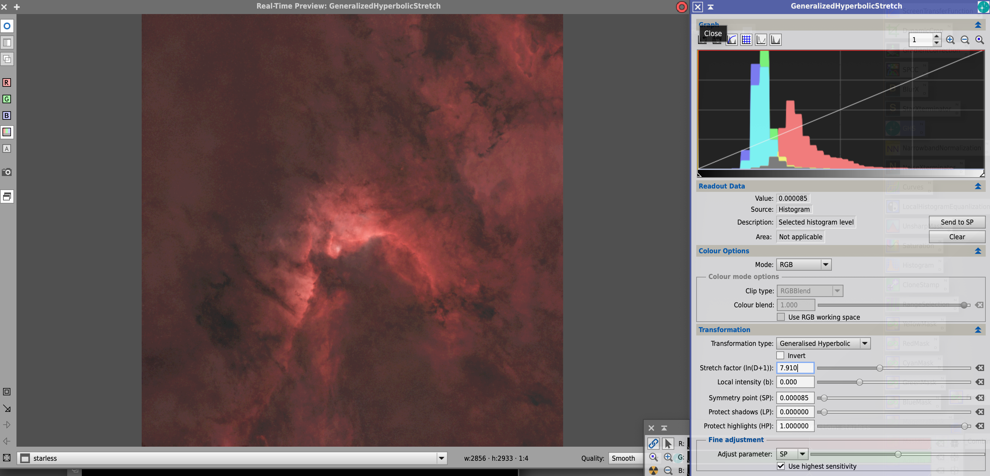

craigdixon1986 3.01
I'm re-visiting my data on the Cave Nebula and have decided to process the image in RGB as suggested above. I'm hoping to take the above onboard and see how I get one. Here's what I get when trying to stretch the data after NoiseX with gentle settings (0.4). This tends to happen with every image I try to process when I do noise reduction in the linear stage. Is this the kind of thing you get @Brian Diaz ? (I know the stretch is aggressive, this is just to show the effect clearly).Screenshot 2025-03-14 at 14.17.04.png
dk94041 1.20
Perhaps your symmetry point is too far to the left, and you are stretching background?

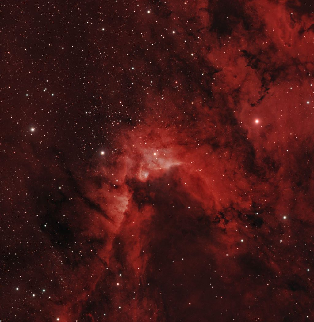

craigdixon1986 3.01
In light of everything said above, here's where I am on the re-process of my SH2-155 data but in RGB this time. This is basically the same linear workflow, and then stretching in GHS with a very small amount of tweaking in curves for the contrast. This is a definite improvement over the first iteration in terms of smoothness but I can't help but think there are still improvements to be made. Where can I go from here with it?CaveRGB.jpg
It is essentially the R channel. Where is the rest?
craigdixon1986 3.01
Nope, that’s RGB from the L-enhance.
background extraction
blurx
spcc
starx
ghs
curves
add stars
I know it's a RGB image, the point is that you're showing nearly only the R channel while the rest is essentially absent. And it should be really there given the exposure length. This is also confirmed by the stars' colors, essentially monochromatic.

add stars
I think you did a really nice job on both images but this go round certainly looks better to my eye. In comparison, the first image seems a bit over nuked on the stretch and a bit flat - this all seems to be corrected on the rework - as well as the blockiness you mentioned in your first post. I think youre losing some information by running narrowband normalization after your stretch. However, you can still acheive an excellent HOO process with the LEnhance which you were going for in your first image with a little extra pixel math and re-ordering of your initial steps.
First load the toolbox script DBXtract if you dont already have it (you can do pixel math here and I can send you the formulas, but this is slicker to use). (repository here https://dbxtract.astrocitas.com/)
1. separate your stars then run correction only in BXT on them - the corrected stars will get you a better result in SPCC.
2. Run DBE on the starless image - ADBE is great tool but applies a light stretch, so you will need to recombine the stars first and then run it if you choose that tool (I still prefer DBE).
-->side note, if you use ADBE, you can go into the history explorer, find the DBE applied, pull it up and see exactly where the sample points were applied, adjust and re-run DBE if you need too.
3. If you used DBE on the starless image, now recombine the stars and run SPCC - settings, make sure you apply a sample region, select the L Enhance filter for the RGB, under signal evaluation change signal saturation threshold to 0.95
4. Now separate your stars and set them aside for stretch and final processing later.
5. Run DBXtract on your starless image so you have Ha and OIII separated out
6. Run BXT on your Ha and OIII images separately (use a reasonable PSF size, somewhere between 3.5-4, you can measure this if you want to be exact)
7. Use channel combination, put Ha in R and OIII in G,B channels (save Ha for luminace detail for later if needed)
8. NOW run Narrowband Normalization - choose HOO and turn the blend mode slider all the way left to zero (its best to do this before stretch not after as in your initial post). Leave the settings default otherwise unless you want to reduce brightness intentionally - then this should be done after GHS. The preview may look prettier post stretch with OIII boost, but I find this method gives me better results in the end.
9. Use GHS to stretch (youtube different techniques to develop your own, but in general, dont go ham in one giant stretch). Seti also has a statistical stetch that does a reasonable job for the initial stretch.
10. now use curves adjustments to finalize your contrast, saturation and color.
11. now apply NXT (its very forgiving in the newest AI model)
12. Stretch and adjust your stars
13. Combine image, reduce stars with pixel math to taste if you wish
Couple additional steps you could incorporate if you want
-You can refine WBPP to do better than preset "best" quality, I can help with that if you need.
-you can apply a bit more BXT to the Ha file that you set aside, stretch it so only the detailed parts are visible and then apply this as a luminance layer to your finished HOO (prior to stars combination) for detail - this is typically best done in the imageblend script.
-Load the toolbox script for selective color adjustment - this is a much more precise way to adjust color than color masking and curves
-you can add "detail" - really it's contrast, by applying a mild high pass filter in the image blend script.
Good luck!

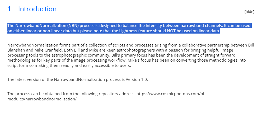

8. NOW run Narrowband Normalization - choose HOO and turn the blend mode slider all the way left to zero (its best to do this before stretch not after as in your initial post). Leave the settings default otherwise unless you want to reduce brightness intentionally.
drmdvl 0.00
John Stone:
Scott Horton:
Ah yes, I was typing this furiously on my cell phone - haha, and the way it reads is you can use the sliders if you want on a non linear image, but was supposed to say "Leave the settings default otherwise unless you want to reduce brightness intentionally, then do this step on a non linear image". I will amend my post so this is not confusing for future readers. Based on the OPs comment, he was really wanting the OIII saturation to come through and suspect he boosted it in NBN which nooked the image in the end.
Doing NBN with the method above then using selective color post stretch with a low saturation mask and or even applying the extracted OIII data as a mask to increase saturation will be much cleaner.
craigdixon1986 3.01
Thanks for the continued support and help with this. I'm trying to find the time to progress with this so apologies if I'm slow to react.
I absolutely agree there is a lot of red but this is just how the data stretched, I haven't done anything to boost the red over the other colours. I've had a little look this morning and realised that, even after SPCC, the histogram shows the red channel much further to the right. When I link and unlink the channels in STF, I get a significantly different results. This make me wonder if SPCC has been ineffective? If I apply just a standard colour calibration, I get a much more natural looking image with a histogram that is more aligned. Even the extracted stars look very red after running SPCC.
