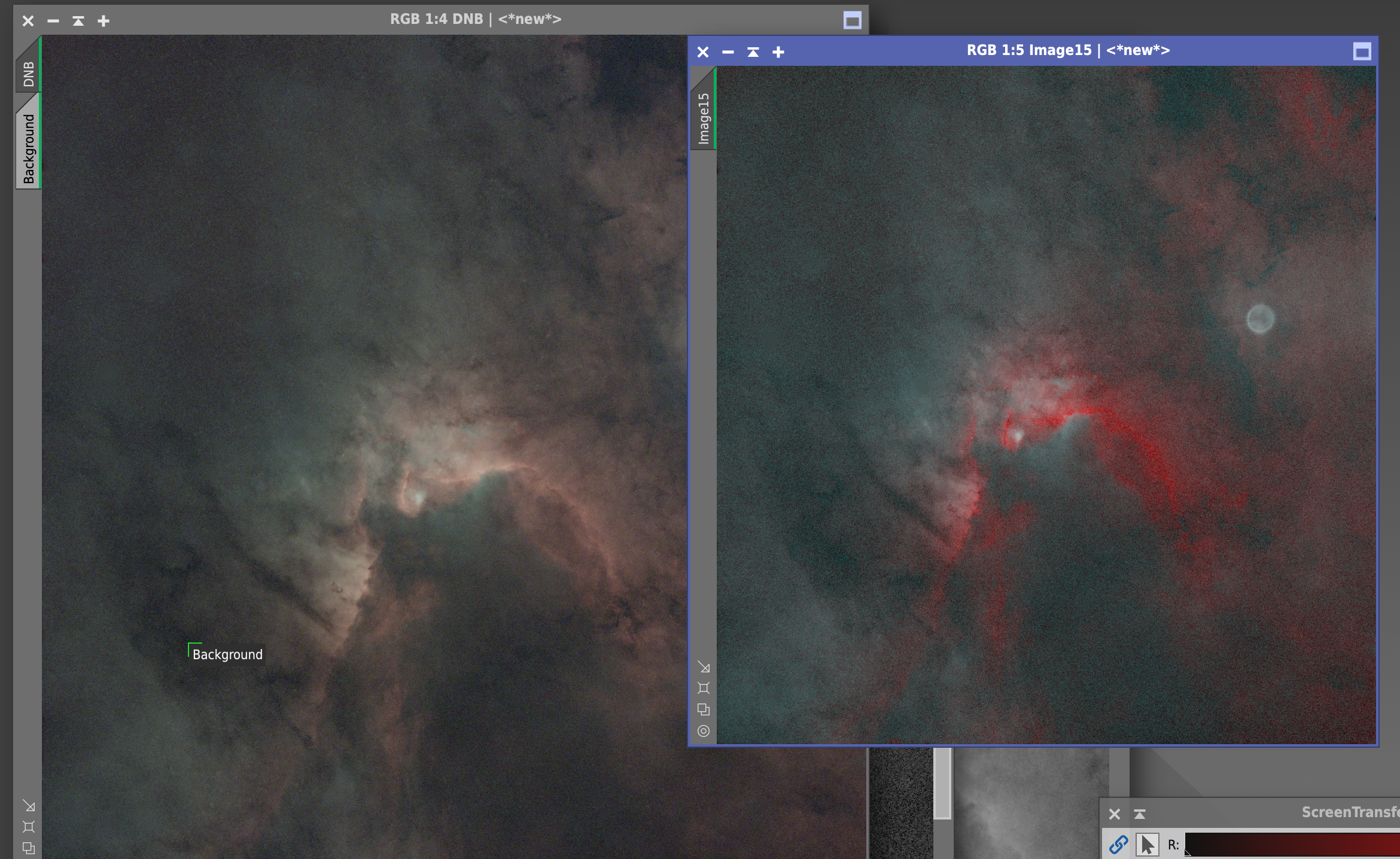

Don't use SPCC and you won't regret it. And I never use it for NB imaging.  There are in fact fringe cases (with NB filters) where SPCC makes a proper hash of things. Standard CC gets you there @ 99.9% likelihood.
craigdixon1986 3.01
Even though I can select the sensor and the filter within SPCC, in the case it is certainly giving me worse results than the standard CC. I’m also finding that most of the AI gradient correction processes/scripts give worse results than DBE so I’m thinking of going back to using standard CC and DBE as standard.
craigdixon1986 3.01

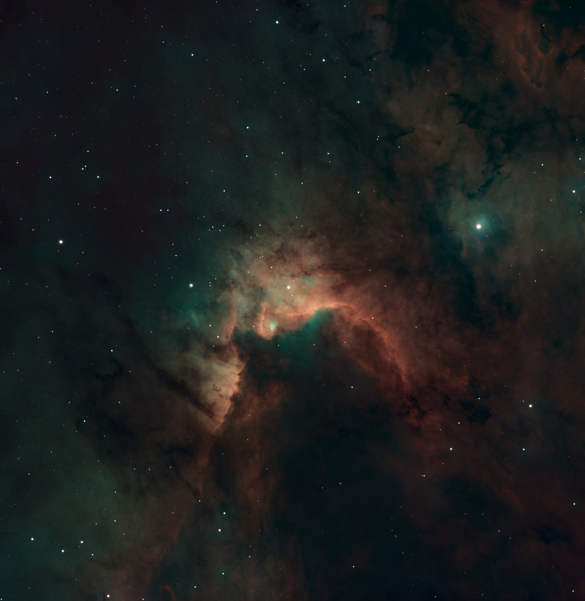

I think you did a really nice job on both images but this go round certainly looks better to my eye. In comparison, the first image seems a bit over nuked on the stretch and a bit flat - this all seems to be corrected on the rework - as well as the blockiness you mentioned in your first post. I think youre losing some information by running narrowband normalization after your stretch. However, you can still acheive an excellent HOO process with the LEnhance which you were going for in your first image with a little extra pixel math and re-ordering of your initial steps.
First load the toolbox script DBXtract if you dont already have it (you can do pixel math here and I can send you the formulas, but this is slicker to use). (repository here https://dbxtract.astrocitas.com/)
1. separate your stars then run correction only in BXT on them - the corrected stars will get you a better result in SPCC.
2. Run DBE on the starless image - ADBE is great tool but applies a light stretch, so you will need to recombine the stars first and then run it if you choose that tool (I still prefer DBE).
-->side note, if you use ADBE, you can go into the history explorer, find the DBE applied, pull it up and see exactly where the sample points were applied, adjust and re-run DBE if you need too.
3. If you used DBE on the starless image, now recombine the stars and run SPCC - settings, make sure you apply a sample region, select the L Enhance filter for the RGB, under signal evaluation change signal saturation threshold to 0.95
4. Now separate your stars and set them aside for stretch and final processing later.
5. Run DBXtract on your starless image so you have Ha and OIII separated out
6. Run BXT on your Ha and OIII images separately (use a reasonable PSF size, somewhere between 3.5-4, you can measure this if you want to be exact)
7. Use channel combination, put Ha in R and OIII in G,B channels (save Ha for luminace detail for later if needed)
8. NOW run Narrowband Normalization - choose HOO and turn the blend mode slider all the way left to zero (its best to do this before stretch not after as in your initial post). Leave the settings default otherwise unless you want to reduce brightness intentionally - then this should be done after GHS. The preview may look prettier post stretch with OIII boost, but I find this method gives me better results in the end.
9. Use GHS to stretch (youtube different techniques to develop your own, but in general, dont go ham in one giant stretch). Seti also has a statistical stetch that does a reasonable job for the initial stretch.
10. now use curves adjustments to finalize your contrast, saturation and color.
11. now apply NXT (its very forgiving in the newest AI model)
12. Stretch and adjust your stars
13. Combine image, reduce stars with pixel math to taste if you wish
Couple additional steps you could incorporate if you want
-You can refine WBPP to do better than preset "best" quality, I can help with that if you need.
-you can apply a bit more BXT to the Ha file that you set aside, stretch it so only the detailed parts are visible and then apply this as a luminance layer to your finished HOO (prior to stars combination) for detail - this is typically best done in the imageblend script.
-Load the toolbox script for selective color adjustment - this is a much more precise way to adjust color than color masking and curves
-you can add "detail" - really it's contrast, by applying a mild high pass filter in the image blend script.
Good luck!

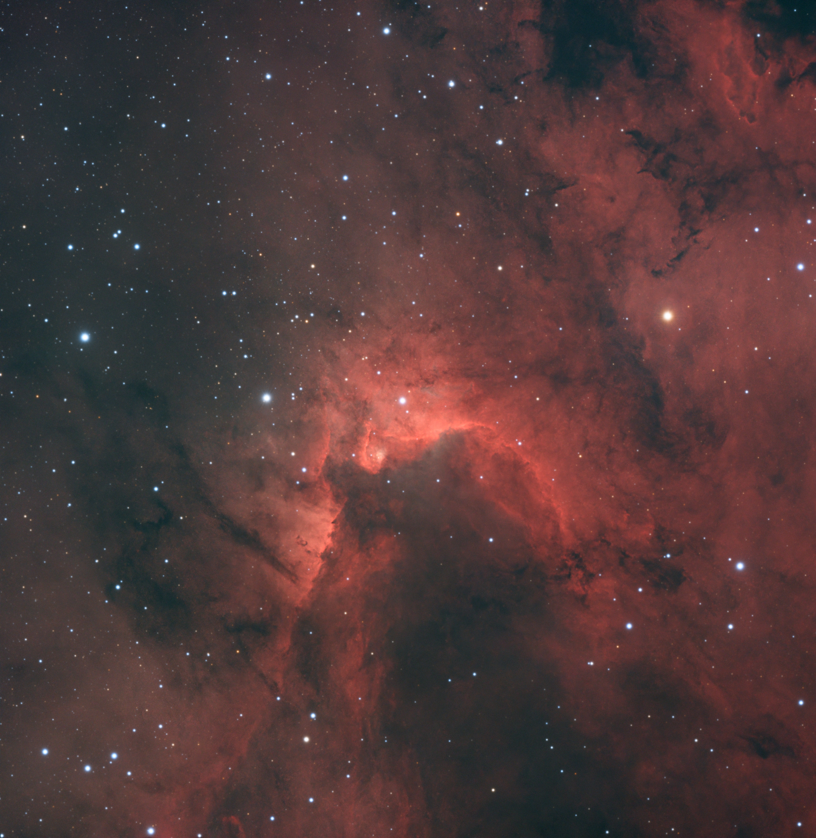

Normally I think less is more when it comes to processing. Its easy to overdo things and make them unnecessary complicated. If it was my image I would probably do it similar to this:
Taste is subjective however. I like the diffuse combined with a hint of intensity and some grain. I'm not at my processing computer at the moment, so I took this as far as I could bother considering the time it takes to run certain processes on my laptop
Workflow:
BackgroundNeutralization
ColorCalibration
BXT correct only
BXT decon
SXT
HT stretch (four passes)
Masked curves adjustments
HT adjusted individual channels slightly to taste.
Masked MLT
NXT
Stars are stretched then applied; SCNR, CorrectMagentaStars (just a bit) then increased saturation with curves before combining them. The reason for those corrections after stretching I suspect have to do with the use of filters, I had to clean up a pretty nasty halo from that filter as well.
A bit more smoothness and contrast could be added, but again this is something I would normally tweak for hours on my processing computer. This is more or less something I could be happy with.
EDIT: Before you ask; Yes, I forgot to run DBE I won't re-do it though as it would take me more time than I would like to spend on it right now - but I'd add that process in right after doing star removal. Hope it helps anyway!

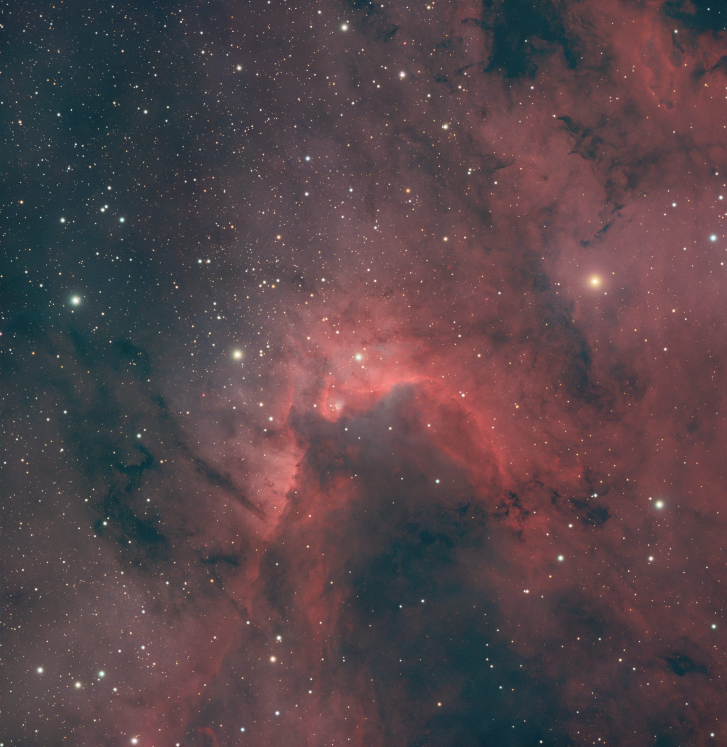

First pass processing, not entirely happy with but a starting point nonetheless. Stars are a particular sore point and I didn't spend a lot of time on them either nor getting rid of that nasty halo. No BXT applied. No DBE either. SXT and NXT, yes. MaskedStretched and ASINH applied for stretching starless image ASINH for stars only. Curves and increased B channel component with ACC. A lot of CurvesTransformation in fact and a masked stretching using them. Plus selective color correction for the stars.

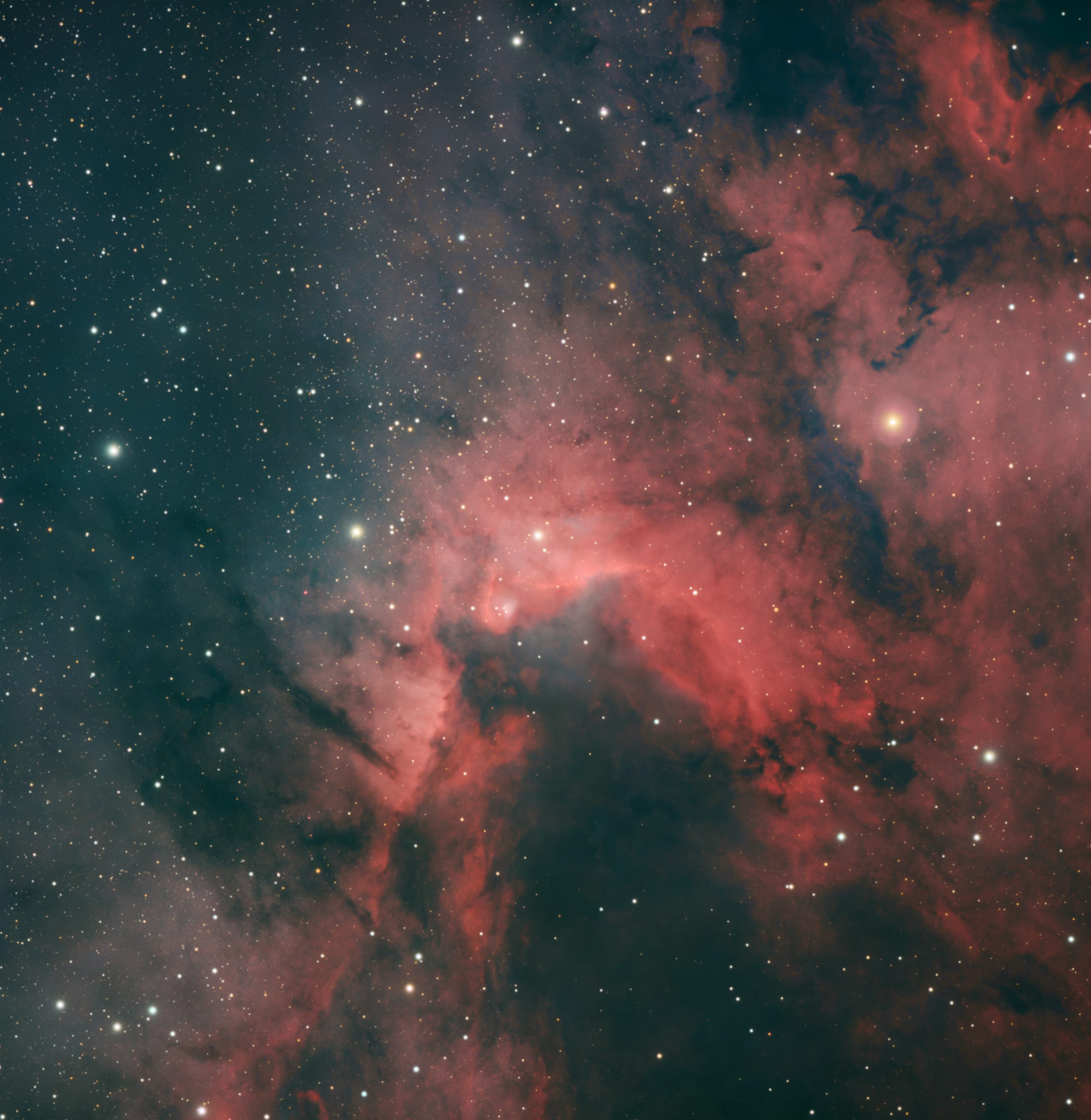

And here is the second iteration, better but maybe not final...
kevinkiller 2.11

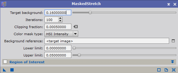

Can you go into more detail, perhaps with some screen grabs, of the 'masked stretching' portion of this processing?
How do you decide where and how much each mask should be applied?  How do you create the masks to match your vision, why is masked stretching necessary when we have GHS?
Thanks.
"MaskedStretch" is a PI process, this:
You just set how bright is the mean background level is and that is it. You then would need to further stretch the image with another tool, either CT, HT or ASINH. I use the latter. I don't know how GHS operates so I can't comment on that.
