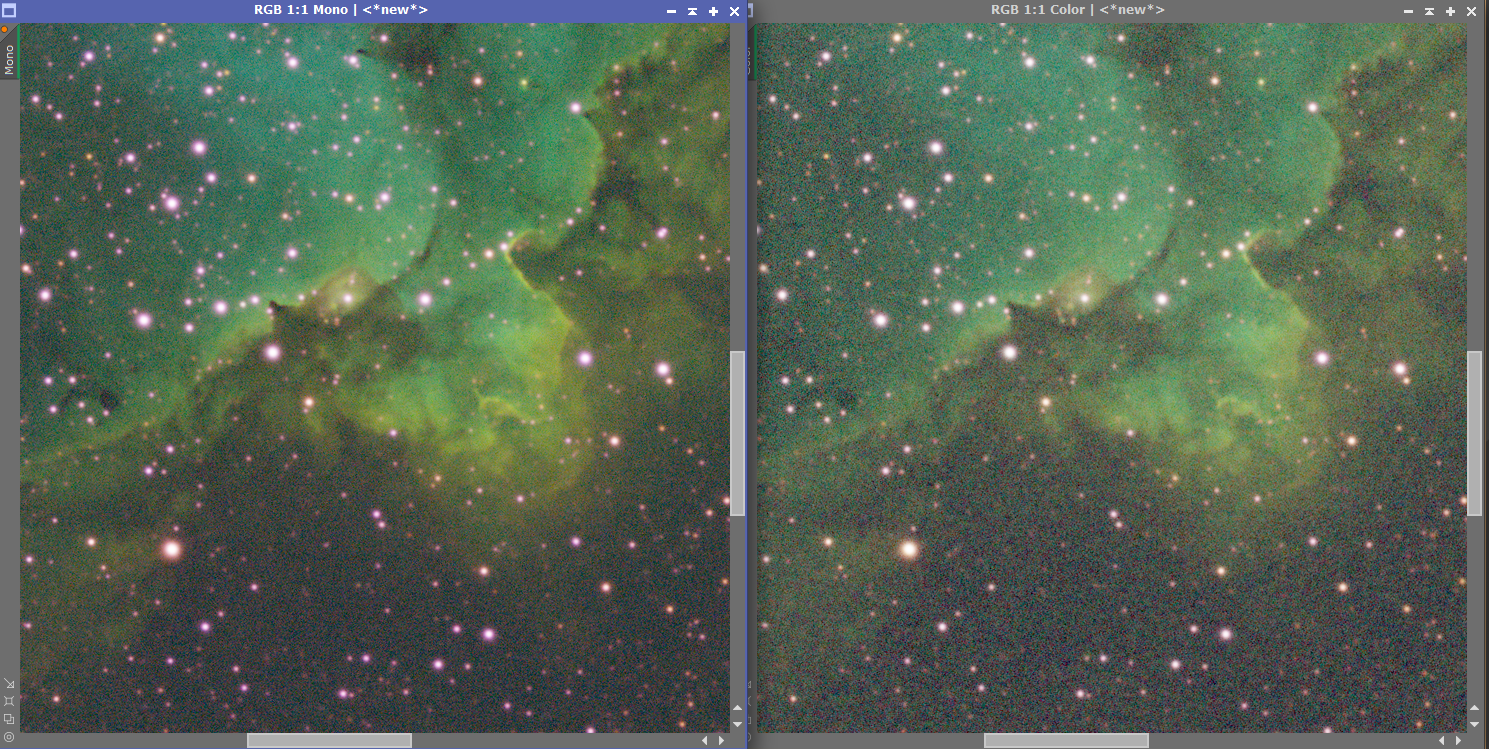

Fueling the ongoing discussion about mono and color. this is a comparison shot of NGC 7380 (zoomed in). This is not a discussion about Bortle 1 with endless clear skies, this is for heavy light pollution with clear skies every other leap year.
Both are stacked of ~30 subs, each 300s, 200gain and same optics except filters. Both images have about the same total exposure of ~2.7h.
ASI 2600MM + Mono filters:
Edge Ha, Edge Oiii, Edge Sii
ASI533MC + Color filters:
Antlia Dual, Edge Sii
For the color configuration, the Oiii data could be improved with using an Sii/Oiii filter, but that doesnt seem to be the main issue here. Also, i put more time on the Sii since that is very weak; maybe that could further improve the color variant SNR.

Mono wins, no contest, but can't you apply noise-xterminator to both as well and share those results, since that would be what most photographers would do anyway…

The quality of asi 533 is not same to asi 2600. The test is not good , is partial. The sensor IMX 571 is better respect to IMX533.
I'm not sure that this is really a fair test to be honest. There are just too many variables and the methodology I think favors the mono sensor. It would be more interesting to me at least to see a test like this done with everything the same. Maybe a hour with just the Ha filter with both images presented in monochrome. You could then just measure the relative SNR and it would also show up any real resolution difference between the two.

Nice comparison.... but you'll never convince the guys that use color that mono is better for narrowband
I have no doubt that mono is better, I just think that this particular test isn't the one to show exactly how much better.

That is not the issue at all.  What a straw man... I don' t know anyone who thinks Color is better than Mono. Do you think you are breaking ground here?
There are plenty of reasons to use Color cameras, the filters are getting better, it is simpler and some just prefer Color camera images for the ease of taking and processing.
There are currently Images of the day on this site imaged with 2600mc cameras and Dual Filters.
I think the comparison shows that a subpar camera can compete with a better camera. It is not a blow out here, the 533 image is decent in the competition and good processing could make them look about equal.

I agree; I am sure the test could be better conducted. To be fair, I don't think the OP intended it to be quantitative, merely qualitative.
