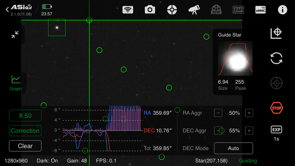

Some nights my guiding goes perfect for 6 hours, I don't lose any subs.   Tonight, it's not windy at all, and the Clear Sky Chart shows the seeing is good, transparency is excellent and no moon or clouds.
Tonight my guiding numbers are acceptable, .35"-43" RA and .38"-.45" DEC.   Suddenly the DEC jumps up to over 2.5".   I press the "Clear" button on the guiding graph and the numbers return to acceptable.  Why does this happen?  Doesn't "Clear" merely clear the graph, and not change anything with the actual guiding?
I've checked for cable snags, all cables OK, both before and after the meridian flip.  I'm also seeing sometimes after dithering, the guiding gets totally lost and, again, if I press the "Clear" button on the left side of the guiding graph, the guiding returns to an acceptable range.  Why does dithering mess with the guiding?  Is there anything I can do about that?  And why does pressing "Clear" return the guiding numbers to within acceptable limits?
I'm finding autoguiding the most challenging part of imaging.  I hate losing subs.   My PA is spot on, < 1' error on alt and az.   When imaging, I stay away from the telescope at least 15 feet to avoid any vibration messing with the guiding.  Still, it behaves erratically and I don't know why.  My AM5 strain-wave mount isn't supposed to have any backlash, but maybe it does??
Thanks,
Jerry

Are the spikes happening during the dithering between subs? The display shows you the average over the visible graph so a large spike can throw off the average until the spike moves off to the left. Pressing clear just clears the graph so the average starts to recalculate.
I think you can get the guiding log off the ASIAIR (perhaps by plugging it in to the USB C port)? You can then look at what was going on in more detail.
Because the guiding numbers shown are an average of whats visible on the graph. So for example, some big spikes will affect your RMS until those spikes disappear off the left side of the graph. When you clear the graph, you wipe out the spikes and it starts averaging out from that point. Hope that makes sense?

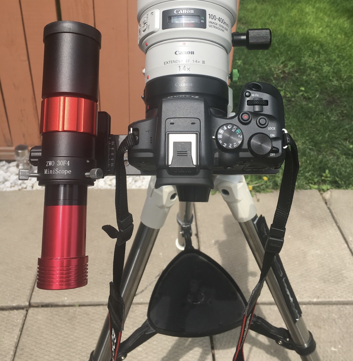

I am having trouble calibrating my guide scope for the last few weeks. When ASIAIR is doing the west steps it moves my mount in the wrong direction and after it starts the east steps, it continues in the wrong direction. I have no clue what is going on. I didn‘t change my gear or the way I set it up. My mount was balanced and my polar alignment is under 20“. My mount is the Sky Watcher Star Adventurer GTi. I have a mirrorless canon camera with the ZWO 120mm guide scope and the ZWO 120mm camera mounted. 8848C12B-FA4C-4CD6-AD80-17D1EB3538EB.jpeg
A few nights ago I was trying to photograph the Veil nebula when the calibration kept on failing, but after about 7 tries it finally worked. Guiding started good and ran for a few minutes when suddenly it seemed like guiding turned off (or actually moved in the opposite direction because numbers would probably be better without guiding) and the guiding graph plunged down and the numbers started rising into the hundreds. I tried to recenter the target and retrying but nothing helped.
So I switched over to the Dumbell Nebula and it worked until the meridian flip. After the meridian flip it didn‘t work anymore and failed just like with the Veil. I turned off everything and cleaned up for the night.
Does anybody know what the issue might be?

It’s not uncommon to get spikes every few minutes while guiding, and it’s not due to the ASIAIR specifically, but caused by external factors.
Momentary passing clouds can cause this. Tripod creaks (slippage or stress from scope weight shifting), too. Some mounts have a small change in friction as they approach meridian. Perhaps cable movement is the source, especially if one were to snag. And periodic error in the mount’s gears is often the culprit if spikes occur at regular intervals.
If guiding corrects these spikes within a couple seconds, they don’t usually smear an image (if the exposures are 60sec or longer).

Not sure, but your primary guide star is overexposed peak “255” try to lower the gain so the star is well below 255 at all times.

For the last two weeks I tried switching the Cameras. So I switched to the Canon R6. I didn’t think it would make a difference but I tried anyway because I have no clue what else to do. So after balancing and PA I started the guiding calibration. But the same issue as always occurs: The mount moves in the wrong direction and screws up the calibration. So if I notice that it’s not working I stop the looping, start it again, and restart the calibration. Mostly I have to do this 6 or 7 times before it finally works. Sometimes it works by the first or second time. I still idea what causes this behaviour. Then after a few hours if successful guiding it seems like it switches directions the primary star is far from where it should be, and the graph goes way off the chart. So, no diffrence I guess.🤷‍♂️
What I also recently noticed was that after the meridian flip that ASIAIR reclalibrates guiding (tries to at least🥴). Is this normal?
Thank You for any suggestions because I’m kind of stuck.
