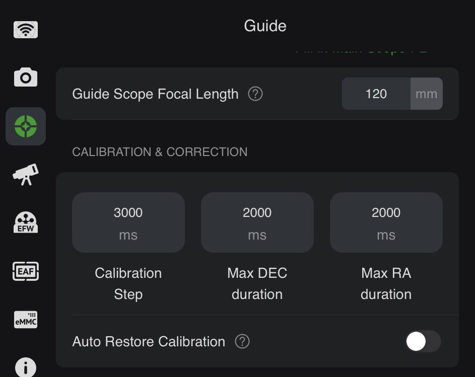

Hi, Sam Badcock.
When my GTi works properly, which is not the case for the last month, I also mostly get guiding in the .6-.7 range even though I am close to the weight limit. My RA is always balanced but DEC is never perfect and I still get good numbers. These are the settings I use:77FAFC92-47BA-49E9-94D0-256F46B524AA.jpeg
For the aggressiveness I usually have RA around 90-100 and DEC at 55.
Hope this helps.
Henric

Hi Henric,
Awesome mate I’ll have a look at those settings and dial them in and see if that changes things!!
Thank you,
- Sam
