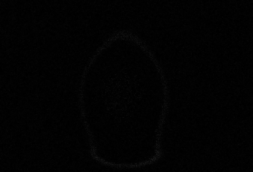

I am facing issues with frosting on ASI294MC Pro camera sensor window. Have confirmed that it is indeed frosting by recreating it on flat frames where I cool it rapidly to -10deg C.
I live in an area of high humidity (>80% is normal in 4-5 months).  In summer, the outside temperature is as high as 40 deg C, so there is no way the frosting can happen on outside window. I have admitted to be constrained to image at 1 deg C to avoid frosting for now.
I have tried all of the following methods, but it does not just go away.
- Opened the camera window to take out dessicant tablets, heat them in microwave and put them back in
- Blow the hot air of a hair dryer into the camera for 30 mins
- Cooling in slow steps of 10 deg  to 5 deg to 0 deg to -5 deg. The moment I hit 0 or lower, the frost shows up no matter how slow i cool it.
Wanted to check on other forum member's experience to see if this is common with only the ASI294MC Pro, or I have a very defective model, or the humidity is constraining me and I have to accept the fact that I cannot image below 1 deg C?
Attaching the master output for flat frames (high and low rejection frmo pixinsight) that clearly shows frosting.Flats - High rejection.jpgFlats - Low rejection.jpg
Stefek 3.81
Well, that somehow indicates that the sensor chamber is poorly sealed, so whatever you do, you have a humid atmosphere there. (the same as outside).  Try to make sure that it is properly sealed . Recirculate your tablets (or better get new ones) and try again. It can take hours before tablets  would effectively dry out the chamber. I do not know whether 294 has built in heater, make sure that it is on . If there is no built in heater ZWO and some others make special tinny heaters that you could eventually use.
It is not the window, it is the sensor and the fault is entirely on ZWO for such a poorly designed chamber. Spare yourself frustration with the ineffective tablets be either new or recycled ( I tried both to no avail). The only way to al least temporarily improve is to use a very large, very tight rubber band around the chamber being sure to cover the flange between window and chamber once you brought the whole camera in a very dry enclosure and be left there so as to leave as little humidity inside the sensor chamber. Use new tablets. Seal the camera with the elastic band or alternative use electrical tape of the thick large variety, something that doesn't yield or relax when subject to hot to cold cycling. The scope here is to seal the chamber starting from a very dry situation and avoid letting any humidity in.
