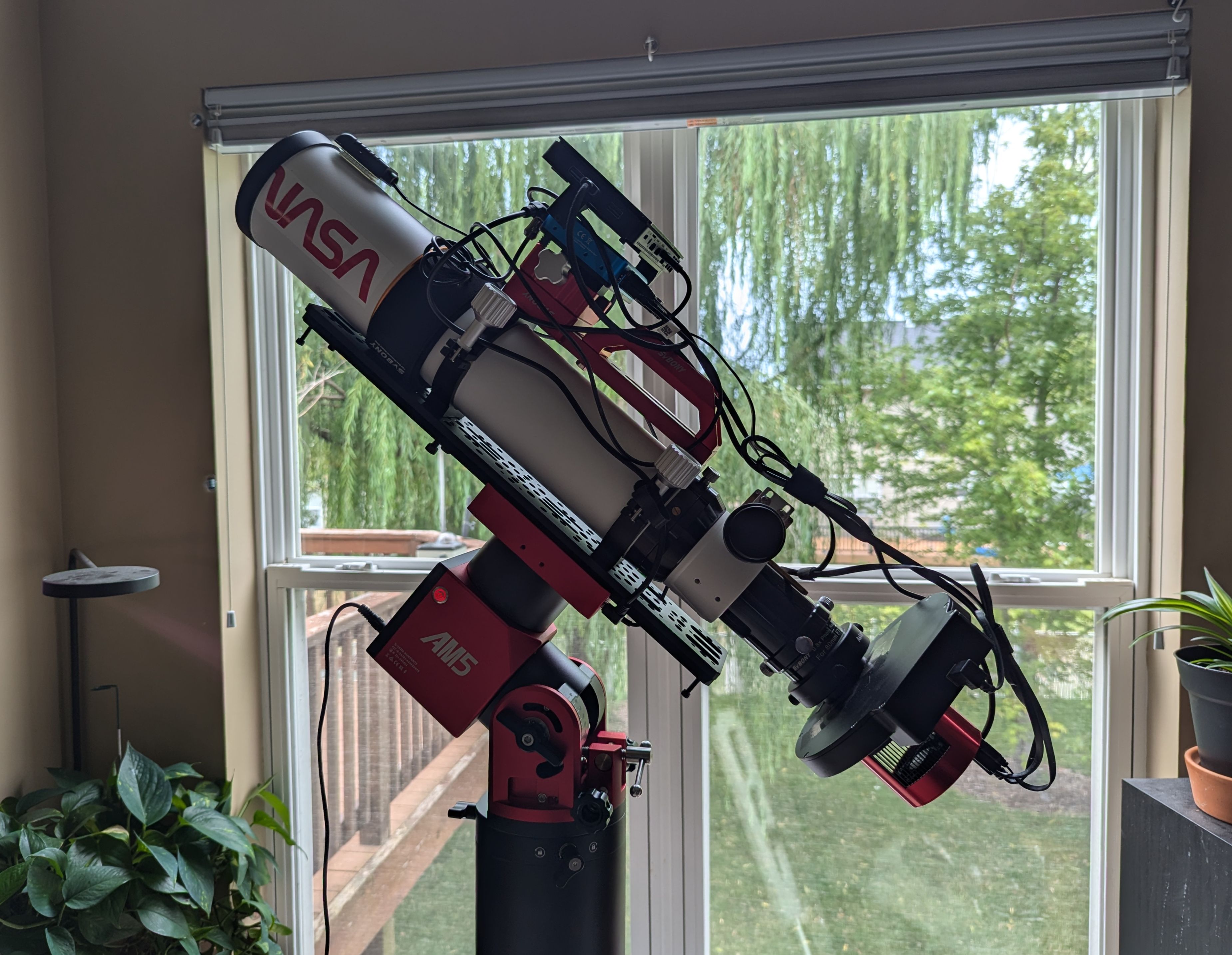

Got my mount yesterday. While the 3A on the saddle is a bit too close to my max power draw of 2.8A, the saddle ports make scope mounted cabling super clean. No more cables crossing RA and DEC axis.
Apologize for the messy cables as I was still cable managing them when I took this picture.
