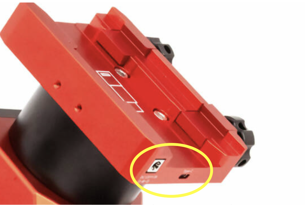

Gary JONES: 2. Improved cable management - by providing internal cables routed through the centres of the RA/DEC axes. - not certain why they only mention the DEC axis ?? - with +12v and USB-C connections on the base routed through sockets on the dovetail plate. - similar to iOptron CEM70 etc. - no mention of how many power/USB sockets - having only one of each would be of limited use for most setups.
Actually the translation above said "Dovetail plate integrates DC output and Type-C port to effectively prevent cable entanglement" - which to me sounds like something more like a cheap version of the Pegasus power saddle?
Its not through-mount cabling.
This can be seen in the screenshot on the website mentioned above
 Looks like they pulled the images from that web site.
Dunk: Do any other mounts offer multiple power outputs? Yes indeed they do ... For example the iOptron CEM70G has 2 power ports on the rear of the saddle, and 2 more on the front. The ones on the front are powered separately to the ones on the back - which is great for switching things like lasers and flat panels on/off remotely.

Charles: Looks like they pulled the images from that web site. No. I pulled the image from the OG link posted above. I also annotated in an attempt to reduce conjecture.

I honestly think that just providing one 12v power and one USB port is sufficient… almost everyone is running a powerbox of some sort that's mounted to their scope… so being able to have a static cable that goes from the saddle to the powerbox is awesome… In the same way, if that USB port allows you to run a USB-C cable from your minipc/asiair into the saddle, and control the mount via that cable, you're essentially going to have 1x12v cable to power the mount, then every other cable is from from the saddle and up, meaning 0 chances of snags and drags and much cleaner overall cable managment..
I do something similar with my setup (Not on an AM5) but I have a powerbox and a mini-pc mounted to my scope, and 1x 12v dc cable goes from the ground to the power box (routed through the RA Axis, and 1x USB cable goes from the mini pc to the mount…. Its far and away the best power/cable management I've ever had.
If I could plug power into the mount head at the base somewhere, and have a power out on the saddle, and direct USB to mount communication through the saddle, I would literally have 1x 12v power cable into the mount - and no other cables that weren't cleanly and tidily routed and attached to the rings/dovetails..
If you're really careful - it's not much benefit, but at the very least, it's aesthetically very nice to have no random cables dangling down from the scope.
Alex, you nailed it. With the AM5N, you have a single 5V power cable to the mount, and the 5V and USB mount control to ASIAIR won’t ever snag again. MUCH cleaner cabling. Summary of key changes from original AM5 to AM5N: - 12V power and USB mount-control routed thru mount to saddle

I think it's a 12V 5Amp port. Should be enough for my portable systems.
Ross Salinger: I think it's a 12V 5Amp port. Should be enough for my portable systems. Ross, my bad! Yes, the power is 12V routed to the saddle! I corrected my post. Also, the AM5N photo shows 3A available at saddle. Which should JUST be enough to run ASIAIR+ (0.3A), 2600mc-Duo w/cooler and guide chip running (2A) and my 8” Edge dew heater at 30% (0.5 A) close, but should work. Jim
If the input is 5A 12V then why would the output be 3A 12V or are there actually two outputs? My 10 year old MYT had a small 1A 12V outlet that was part of the mount power that was useful for a powered hub or a focuser.

The old AM5 is the same - 12V/5A and 12V/3A on the side.
Ross, 5A is for the total input into the AM5. The AM5 uses .6 amp when tracking and 1.3 amp when slewing. The three amp port on the saddle is what’s available after the AM5 uses it’s draw.
