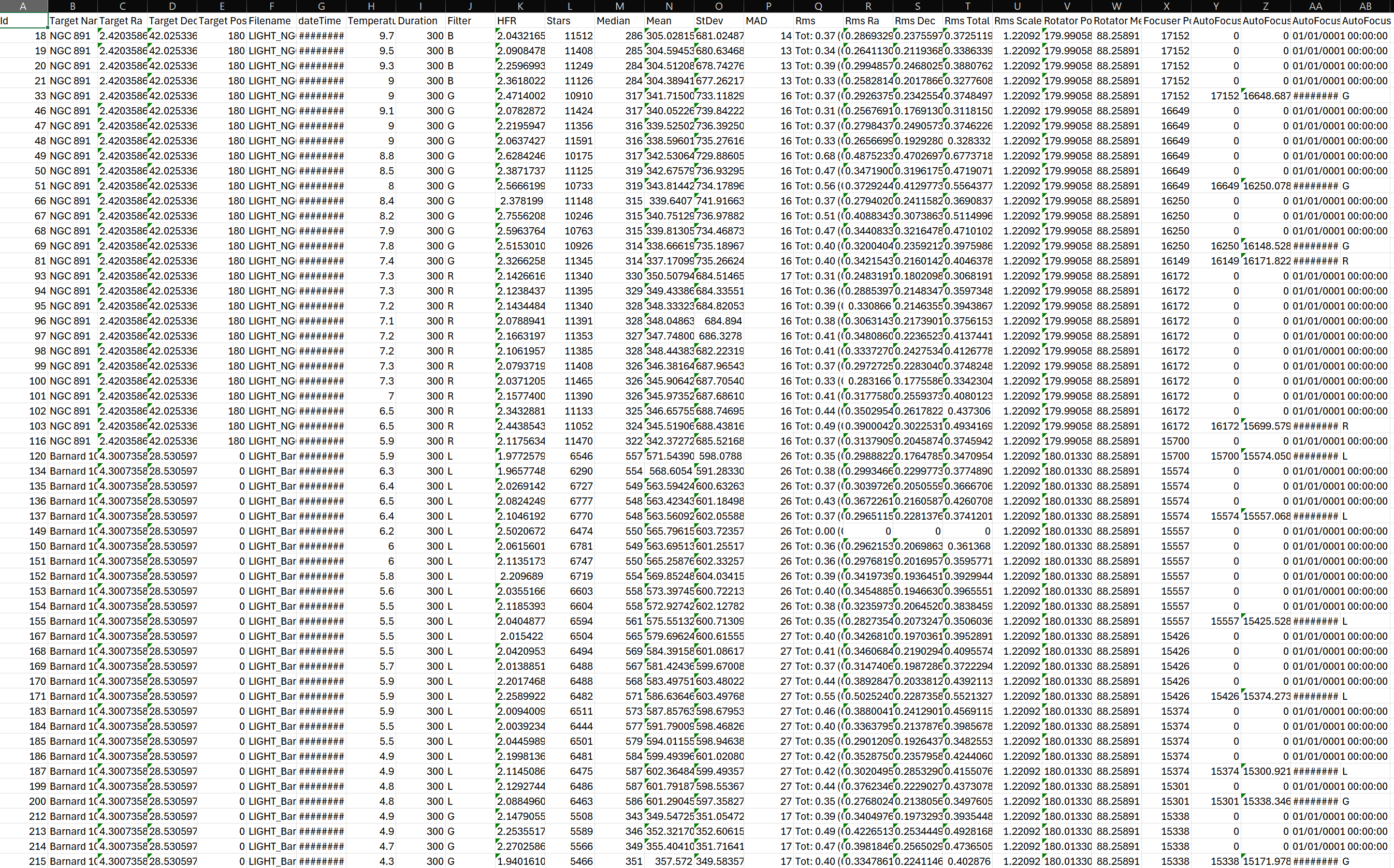

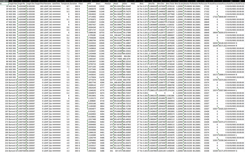

Here is a snapshot of my Autofocus history from January 3. You can see the Focuser point was about 11000-14000 depending on temps during the night.

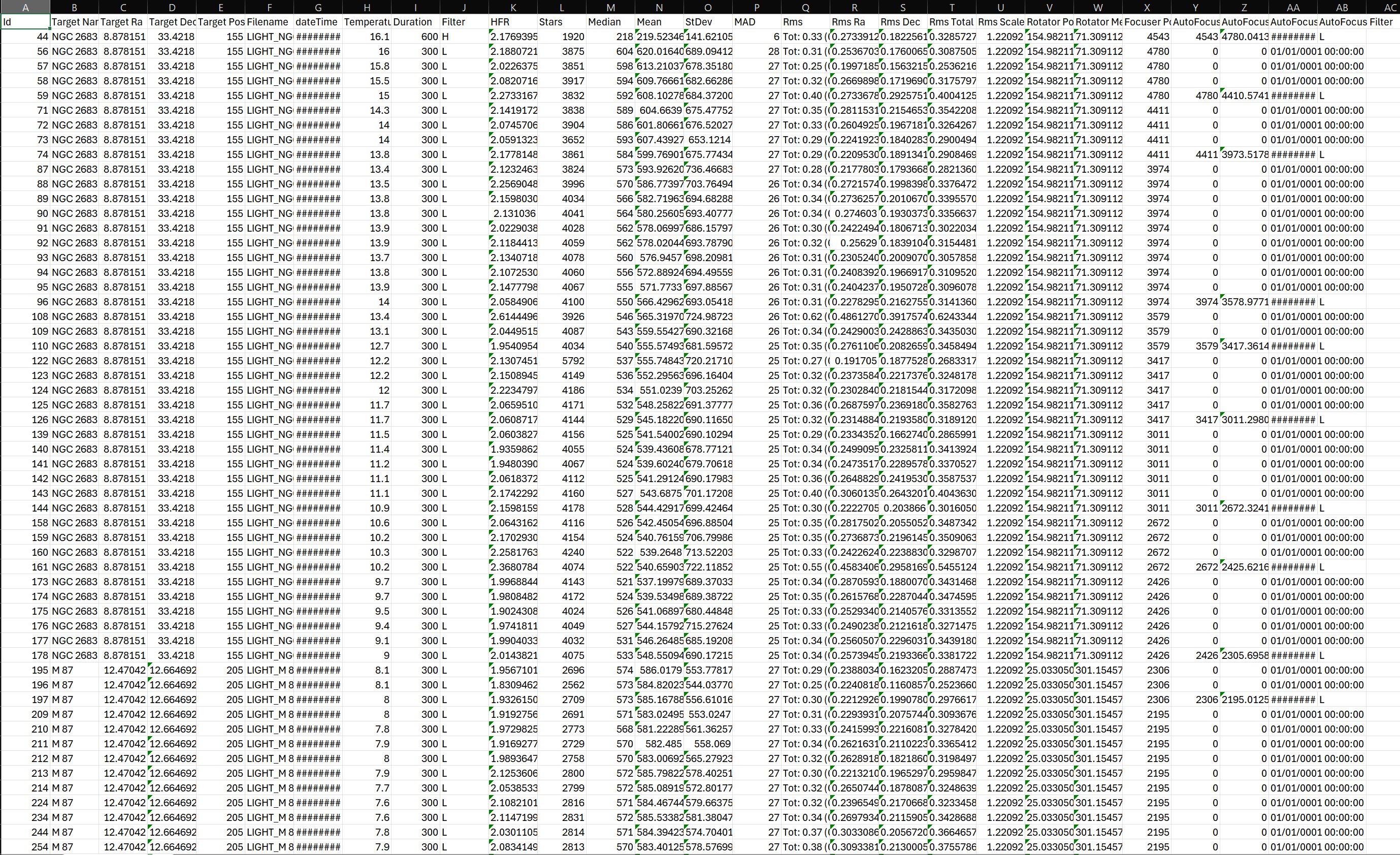

And this was an Autofocus log from last night, where autofocus eventually failed because it hit zero point during the run:

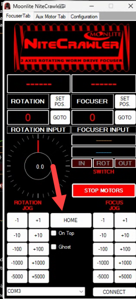

I have a similar config: TOA -> WR35 -> spacer -> 645 -> PP spacer/adapter -> Sagitta OAG -> Moravian C5
I had this same issue—except it took a year to get to the point where autofocus failed. I racked the focuser all the way in to 0 with the tech on site and he said it was still racked out about 10mm.
I exchanged emails with Ron Newman at Moonlite and he gave me a very simple fix. I just recalibrated the focuser and the focus point was restored to its original position. It took 5 minutes. Apparently it was the WR35 calibration that drifted over time.
AccidentalAstronomers 18.64
Just connect up the Moonlite app and click the Home button. That should fix it.

My TOA-150 focus can change constantly despite very stable ambient temperature.  This is particularly obvious in the first 1/3 night when day-night temperature difference is huge.  My theory is that the metal tube reaches thermal equilibrium with the ambient air fairly quickly, but the three big piece of objective glass elements don't.  So although the air and the metal tube have both cooled to a stable point, the objective lenses haven't.  This can be particularly an issue since the three objective elements of TOA are widely separated with log of air filled in between.  This makes the thermal conductivity of TOA's objective lenses very slow.  It could take more than 2 hours for my TOA-150 to reach full equilibrium with ambient air after the air reaches stable temperature.
Your logs do not show the time, so I can't tell whether you are seeing the same thing as I saw on my TOA-150.  If this mainly happen in the earlier part of the night and if the day time temperature is quite high at your site, then what I said above could be the reason.

Thanks Wei! Yes the behavior early in the night is very similar to what you describe. But what I didn't understand is why the focal point in relation to the step sizes of the Nightcrawler drifted so drastically under the same conditions.

I experience exactly the same thing with my TOA–130, both with the stock 4 inch focuser and ZWO EAF, and with the Nightcrawler WR 35.
As Timothy Martin pointed out, the solution is to simply recalibrate your focuser periodically.  With a ZWO EAF, you have to be at the scope to recalibrate. Once I installed my system remotely, I switched to the WR 35, which can be calibrated remotely.

​​​​​​Thanks for the input you were exactly right! I homed the draw tube and tonight my focal point was a whooping 20000 steps.
Really happy to know the solution was much simpler than I thought initially.
