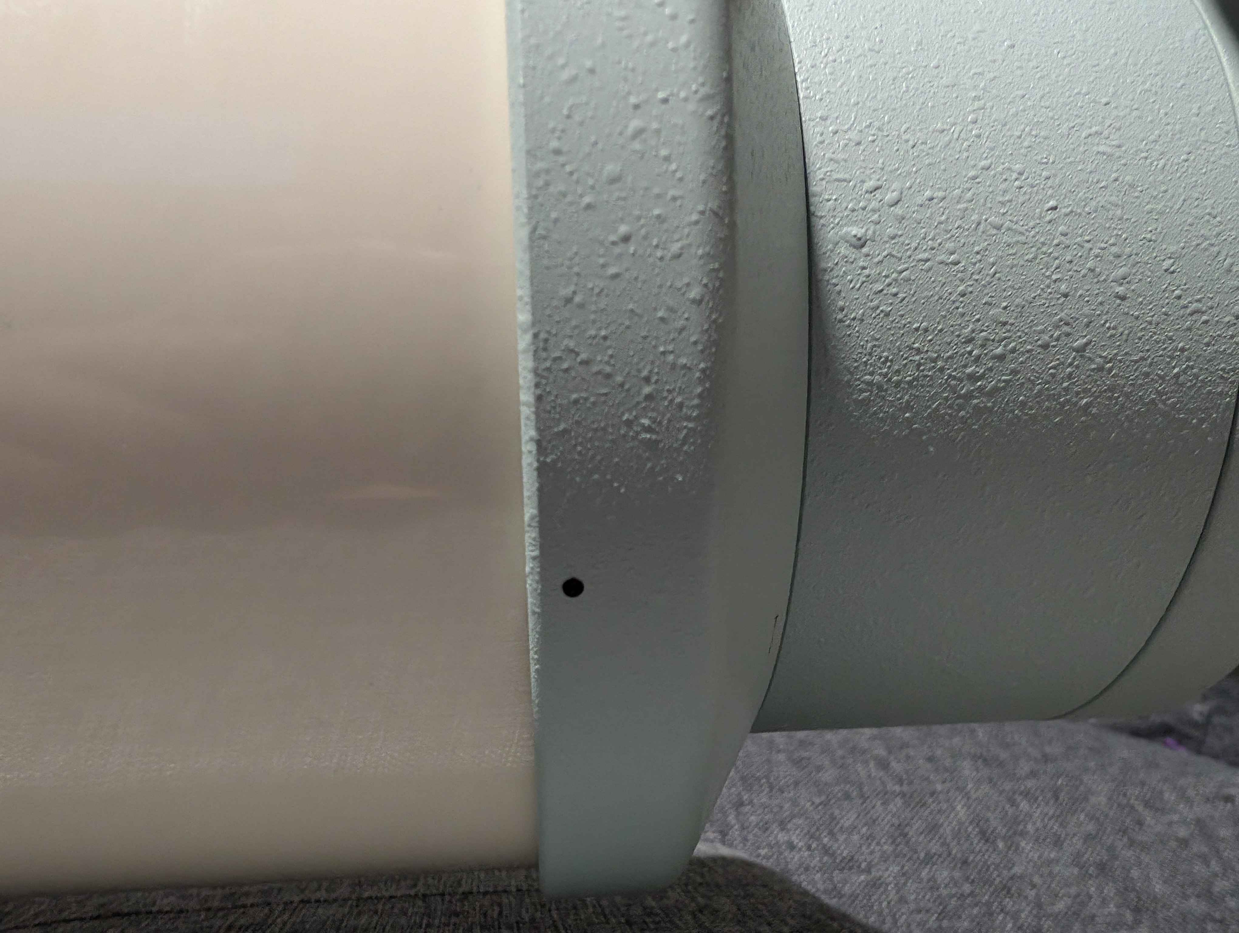

Update to this thread. I eventually went with a second hand TOA-130NS (about $5k) and moonlight WR35 focuser. I installed it yesterday. Be warned that grub screw that holds the focuser is very very small. You need a 0.9mm allen key to unscrew it. I had to get this kit:
https://www.amazon.com/dp/B001ATKWJY?ref=ppx_yo2ov_dt_b_fed_asin_title
Once that is backed out, taking off the OEM focuser and putting the moonlight on is a piece of cake.

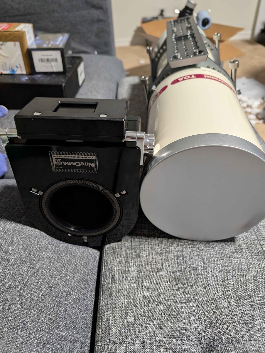

Here is the moonlight NC vs the TOA.... it is a MASSIVE focuser.

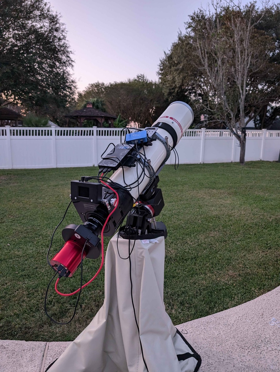

Very rough assembly to start testing it:

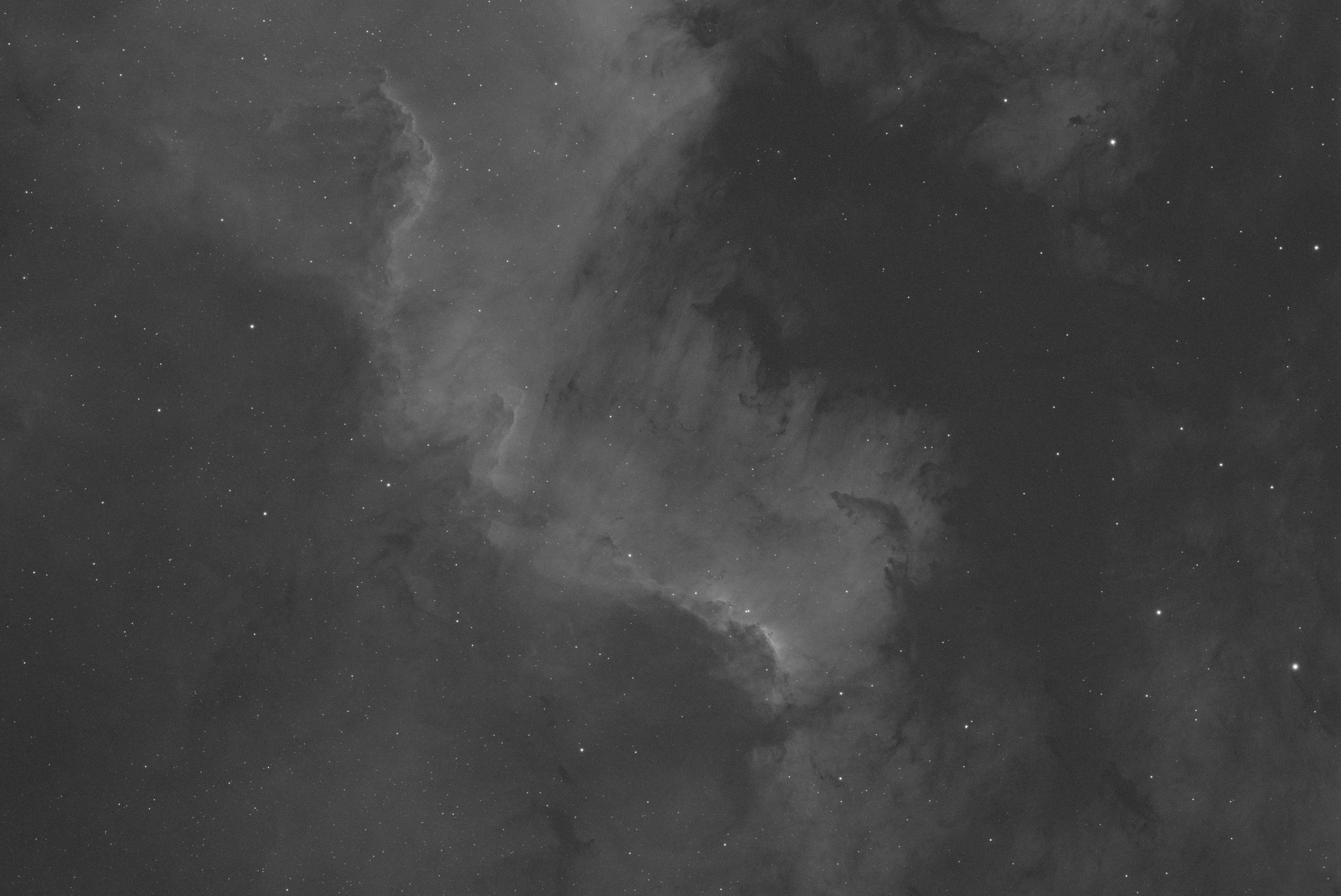

First light with 2600mm just slapped on with no further adjustment:
cygnus_wall_2024_10_13_23_27_47_H_0_00_600_00s_0000_mosaic01.jpgcygnus wall_2024-10-13_23-27-47_H_0.00_600.00s_0000.jpg
Obviously 2600mm is a piece of cake for this. Waiting on my 50mm filters before testing full frame.
