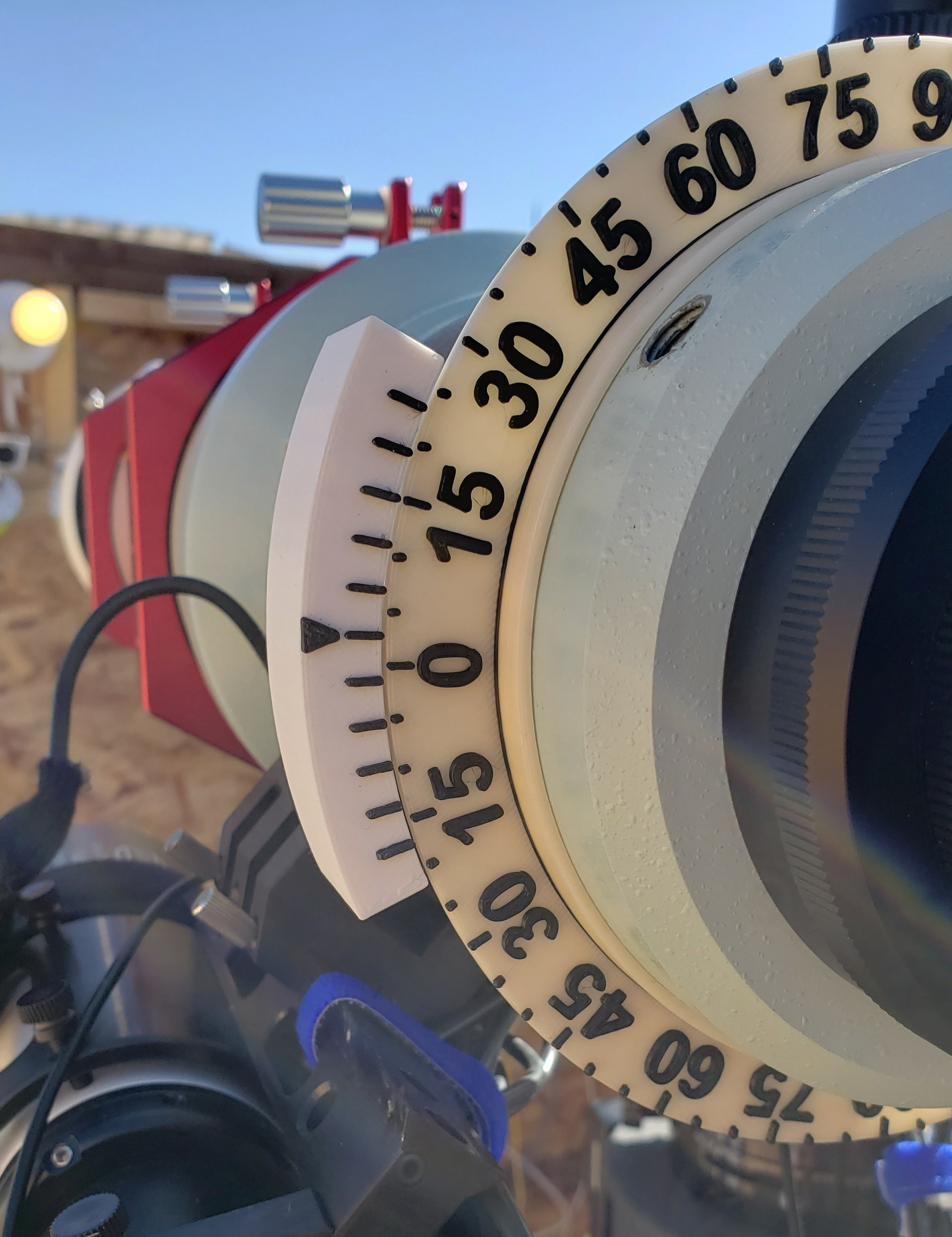

t-ara-fan 0.90
I thought the Nightcrawler was kind of expensive, especially since I am at my observatory and can rotate manually.  I decided to try the NFB focuser and decide later.  3 years later, no problems with the NFB.  I have an Optec Focuslynx focus motor - the one with a built in controller so only USB and +12V plug into it.  I have no problems, even at -20°C.
Just because I like toys, I recently bought a 25mm long M92 extension ring that I put between the focuser and the FLAT67 reducer.  This means the focuser is extended by 1" less. Not sure if necessary, seemed like a good idea.
I designed and 3D printed a Rotation Indicator, so I can get precise rotation to within 0.5° on the first try.  In this pic the vernier shows I am at 3.0° rotation.
My TOA is a few years old, so I have the FLAT67.  The new 645 has AMAZING specs.

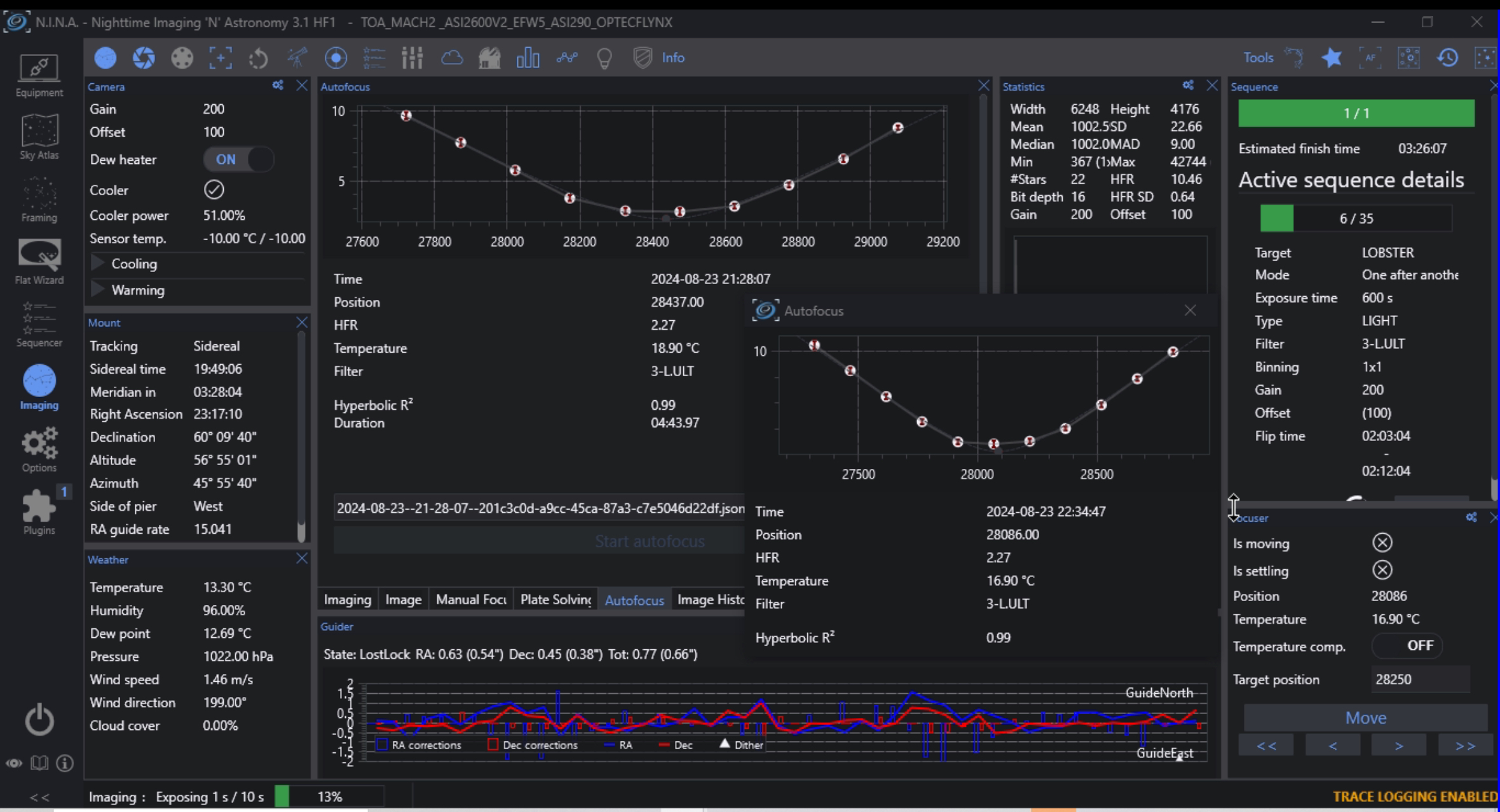

sberrada19 0.00
Hi
i have the TOA130NFB with an optec foucuslynx motor - it works great until the temperatures drops to -20C at which point it becomes too hard to move.
The smoothness of the NFB focuser seems to be variable - mine is average (but works excellent for astrophotography at above -20C), while I have a friend who has the same setup and uses it at colder temperatures.
The focus curves look great (see image)

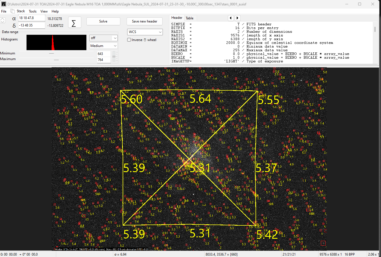

t-ara-fan 0.90
Further to my saying the NFB is fine, here is an ASTAP tilt report.  I think it looks fine.
aabosarah 9.31
Thanks! I have access to an ASG photoncage on my 6200mm. I can fix tilt and backfocus after the fact. But have you noticed any rotational play or changing tilt depending on target?
