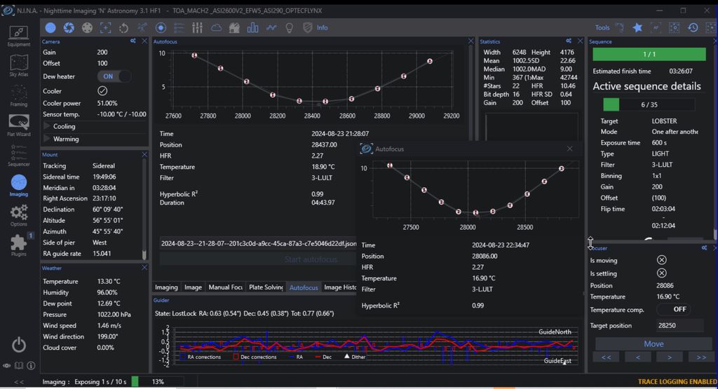

How easy is it to remove the stock focuser and put a third party focuser on the TOA-130NS? Is it easy to collimate the focuser? You need to loosen a small set screw (very small!) on the TOA stock focuser then you can thread it completely off. Your replacement focuser would then thread onto the OTA tube in place of the original focuser. It's significantly easier to do than the Epsilon focuser replacement, just don't forget the set screw. You could use the Hercules, I'm sure Jeff has a TOA compatible flange for it. You'll probably need some extension tubes though since the travel of the Hercules will be way too short to come to focus on the TOA.
I thought the Nightcrawler was kind of expensive, especially since I am at my observatory and can rotate manually. I decided to try the NFB focuser and decide later. 3 years later, no problems with the NFB. I have an Optec Focuslynx focus motor - the one with a built in controller so only USB and +12V plug into it. I have no problems, even at -20°C. Just because I like toys, I recently bought a 25mm long M92 extension ring that I put between the focuser and the FLAT67 reducer. This means the focuser is extended by 1" less. Not sure if necessary, seemed like a good idea. I designed and 3D printed a Rotation Indicator, so I can get precise rotation to within 0.5° on the first try. In this pic the vernier shows I am at 3.0° rotation. My TOA is a few years old, so I have the FLAT67. The new 645 has AMAZING specs.  |

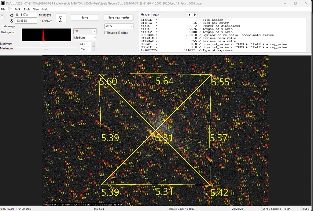

Further to my saying the NFB is fine, here is an ASTAP tilt report. I think it looks fine.  |
 Thanks! I have access to an ASG photoncage on my 6200mm. I can fix tilt and backfocus after the fact. But have you noticed any rotational play or changing tilt depending on target?
