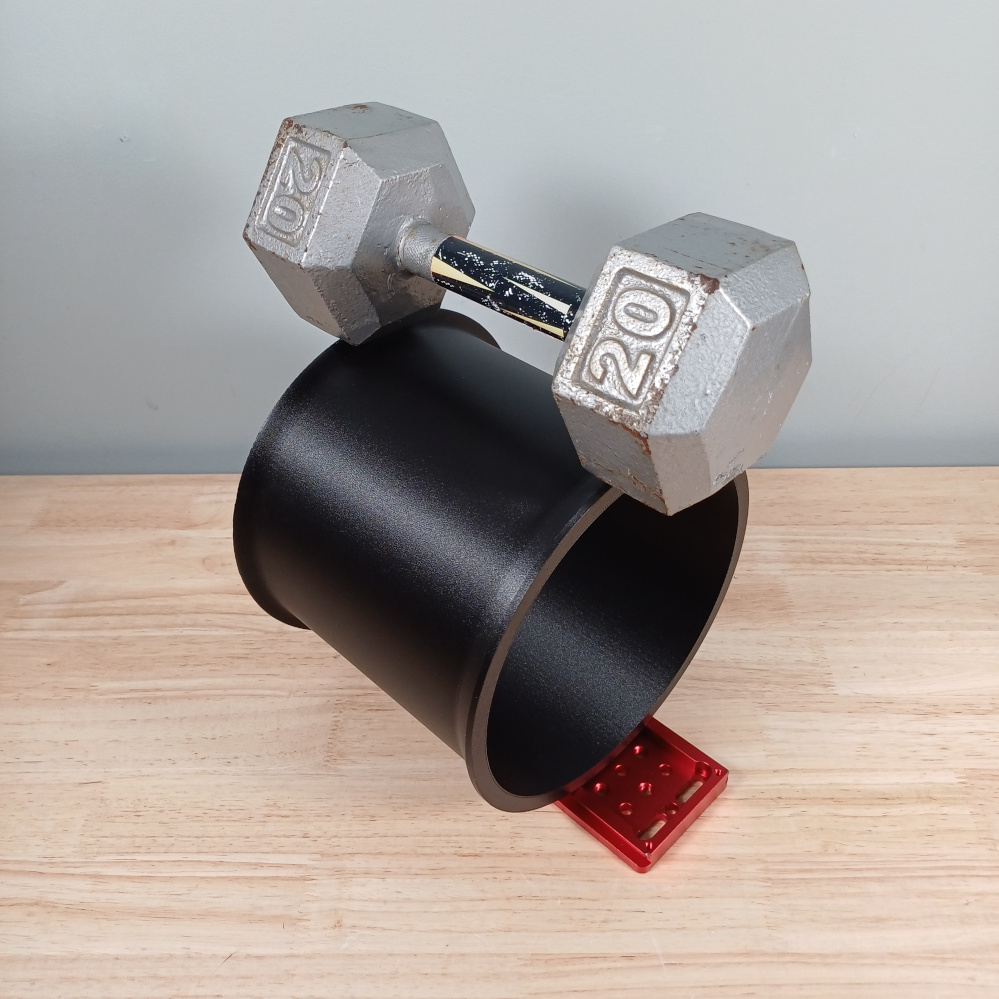

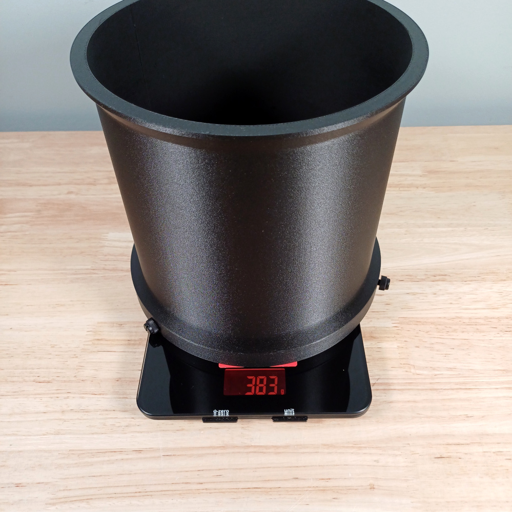

Added some lightweight dew shields for the Epsilons E130, E160, and E180: Painted flat black interior.    |

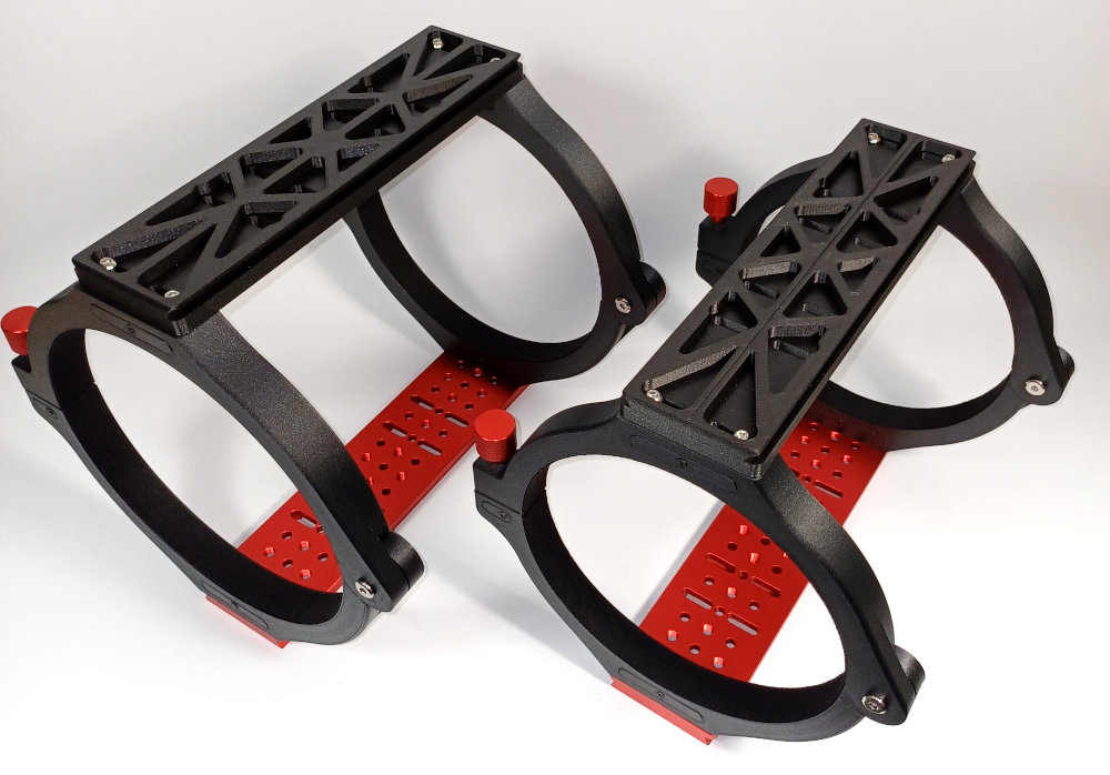

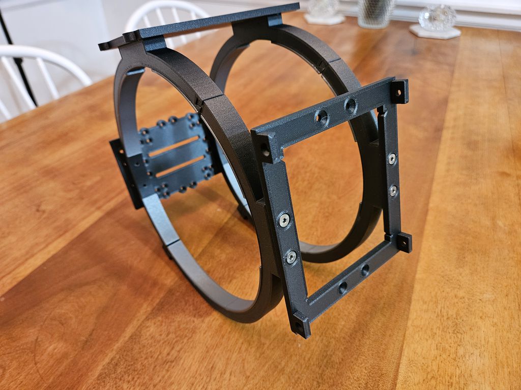

And the new version of the lightweight tube rings:   |

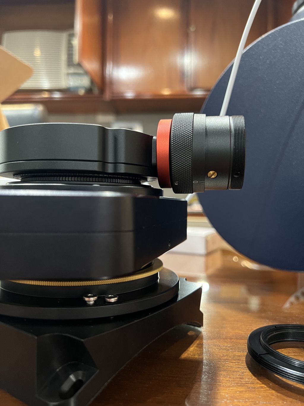

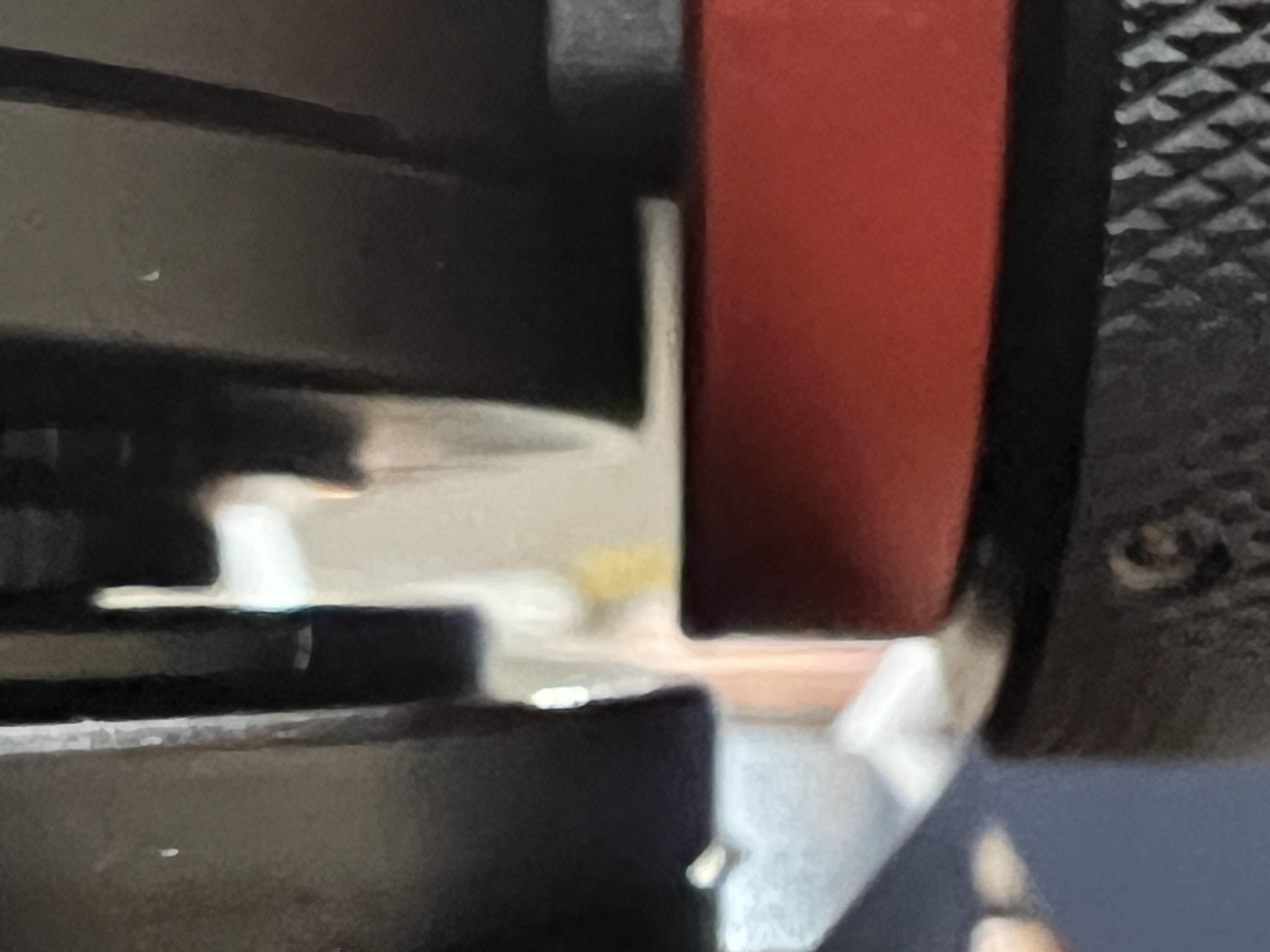

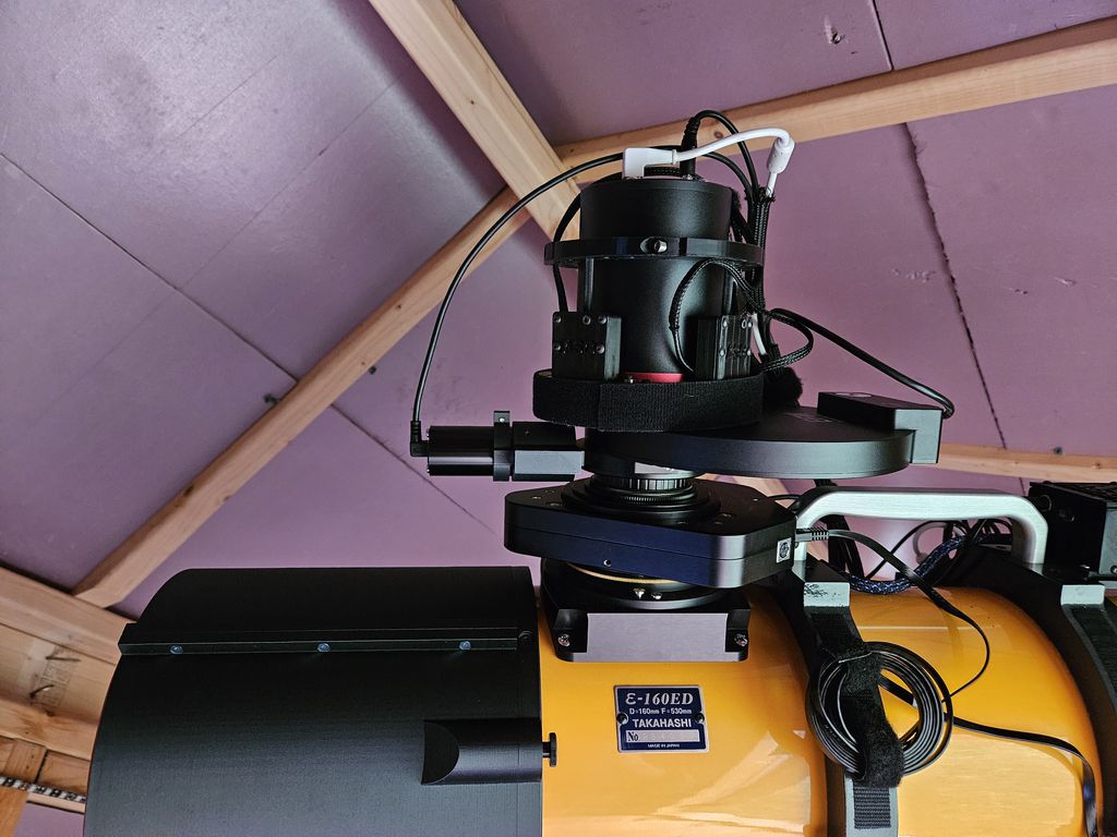

Hi everyone, I’m planning to use Optec Leo, with a ZWO Square filter EFW (16mm), along with a OAG L-68 (17.5+5mm) , an ASG tilt cage (3mm bottomed), and a ZWO ASI6200mm (12.5mm) . Tested it (Optec not installed in the Tak yet) , and needed the help of a Pegasus Astro m68 -m54 adapter (1.4mm) to avoid OAG hitting the Leo. The total length of this solution is 55.4mm . Considering I am using a Chroma Filter of 3mm thickness, I need 57.2mm of backfocus on the Tak e-160ed, so I got 1.8mm left for tit and backfocus fine adjustments. So, this solution sounds good to you? The fact that I did the testing without actually installing the Leo in the Tak, could bring any issue? (See pictures). Any advice?   |
Rouz Astro: Added some lightweight dew shields for the Epsilons E130, E160, and E180:
Nice work rouz! Looks awesome!
-------------------------- Thanks Chris, glad you like it. I see you have been doing some great work on the Epsilons. Looking forward to seeing your progress too! Rouz

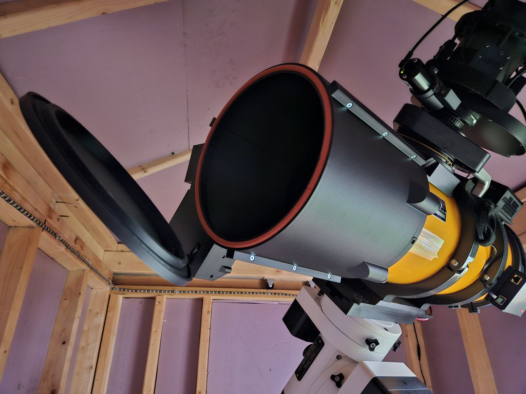

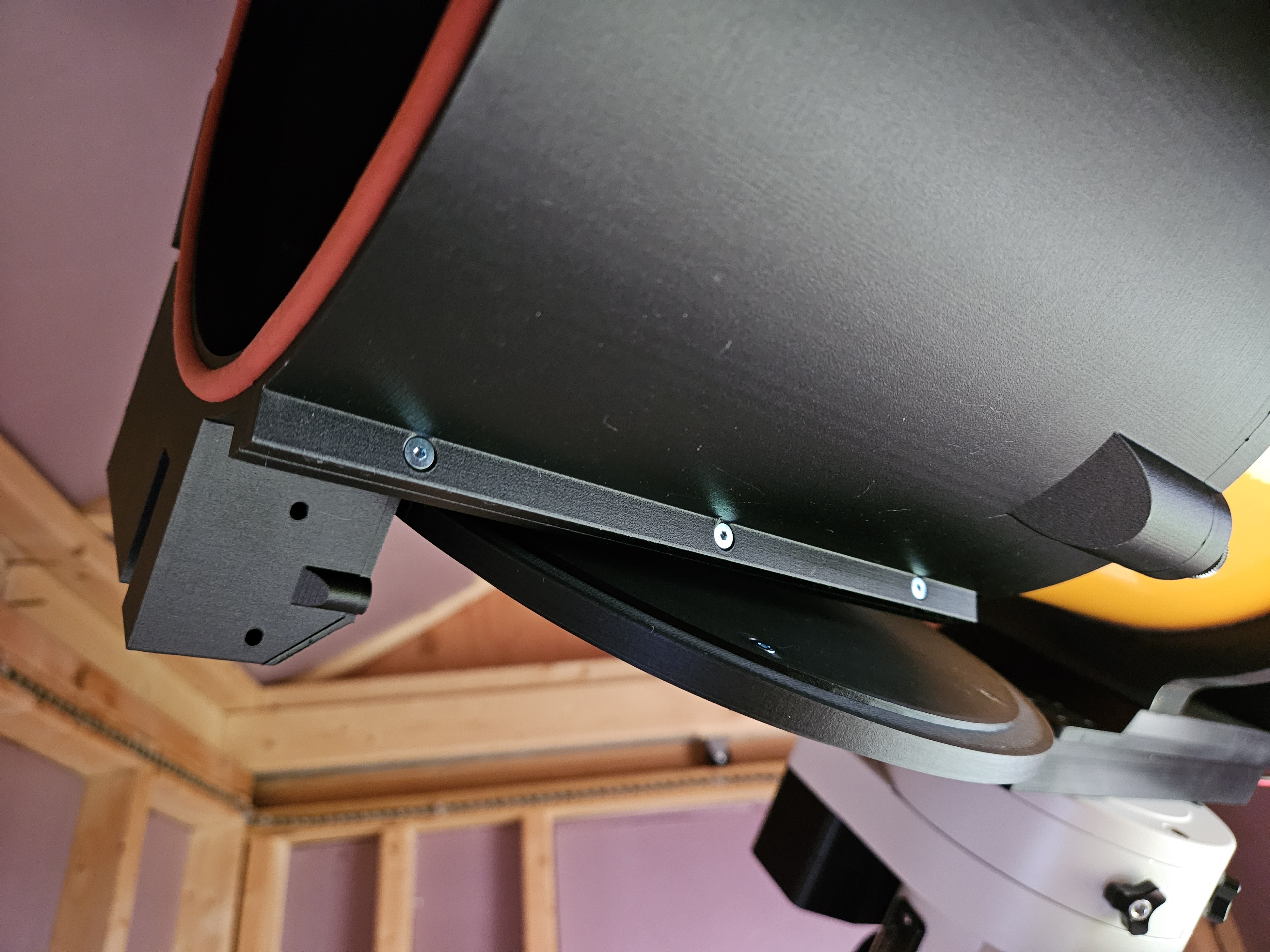

I've got a solid prototype of the Dew Shield with Dust/Light cover. I ended up changing materials because PCCF was britle with thin large walls. This one is made out of PETG-CF and I'm really happy with how it came out. The PETG is more flexible than PC but the CF keeps it strong and gives it a nice finish. I twisted one the dewshield panels really hard and it didnt break. This version weighs 2 lbs 4.5oz (1035g). Everything balanced easily. I need to fully test the light tightness of it, but i did a a quick test by pointing it at my open door and taking a 60s shot with a lum filter. Mean ADU was 812. I then closed up the observatory so it was dark and took a 60s shot with an Sii filter. Mean ADU was 809. I'm using an OPTEC board and motor. Very excited to trick this scope out for a remote deployment! Just waiting for the Hercules and the production model of the EAT.  Here is a short video: https://youtu.be/FrYfweOapHk

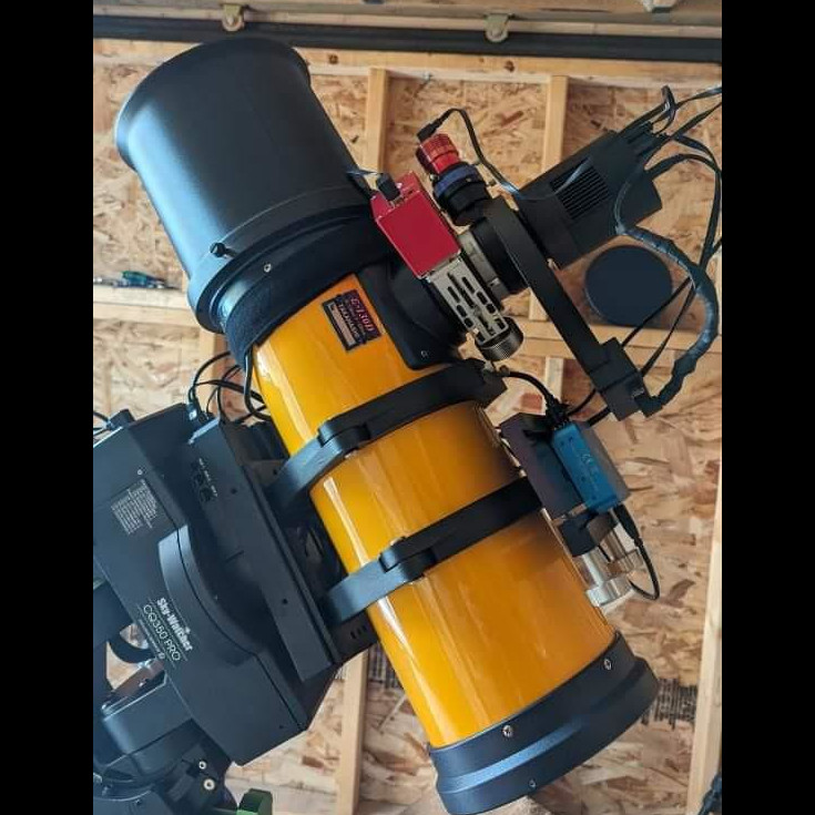

Dunk: What OAG is that? Pegasus. I made an upgraded camer holder with focuser. The stock holder wouldn't hold the camera stable.

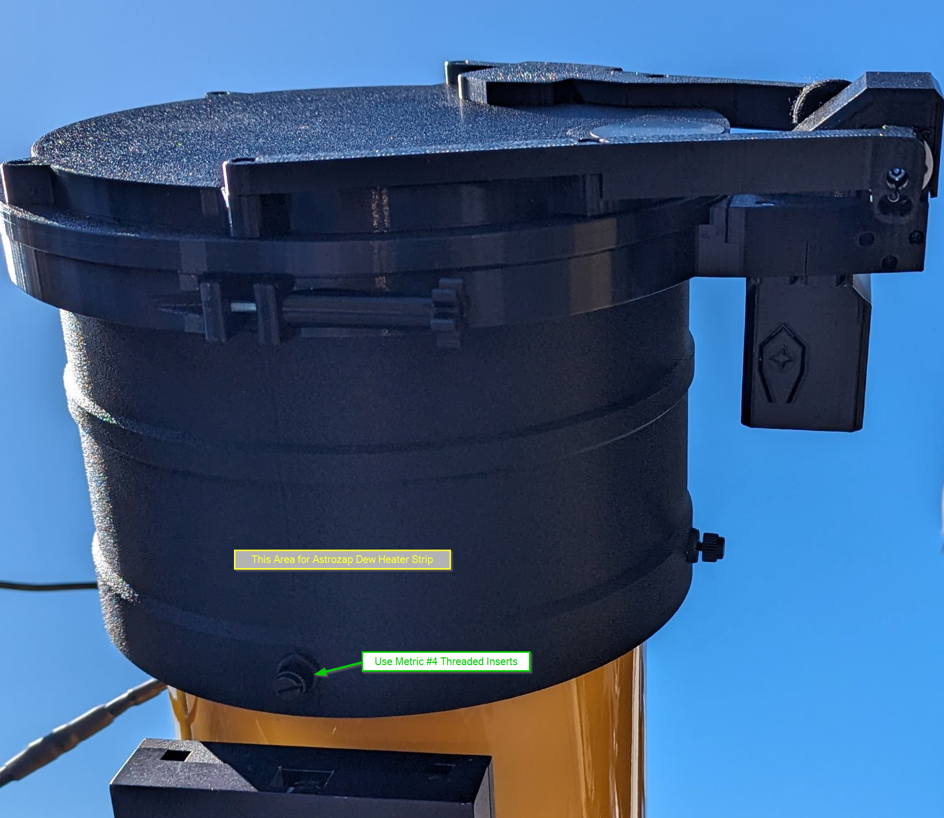

For the 130 I designed and built this to go with my DSD flat panel. It also has a groove that accepts an Astrozap dew strip. One advantage to the 130 is that it is small enough to just barely fit this as a single print on most printers. Printed on a Bambu X1C in PAHT-CF for heat and strength. STL file on ThingyverseNOTE: I have yet to try a flat with it although the DSD does nice flats fitted directly.  |
Bill McLaughlin: For the 130 I designed and built this to go with my DSD flat panel. It also has a groove that accepts an Astrozap dew strip.

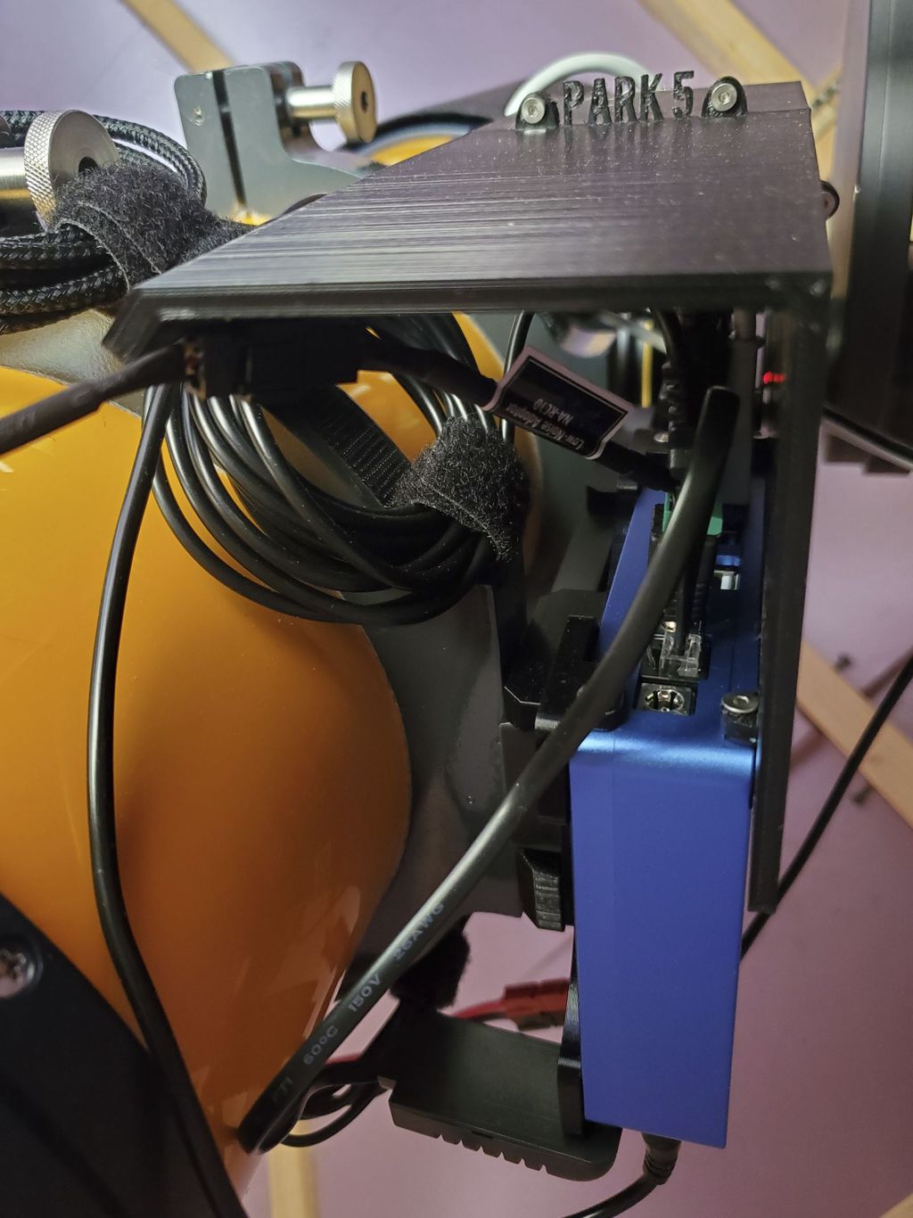

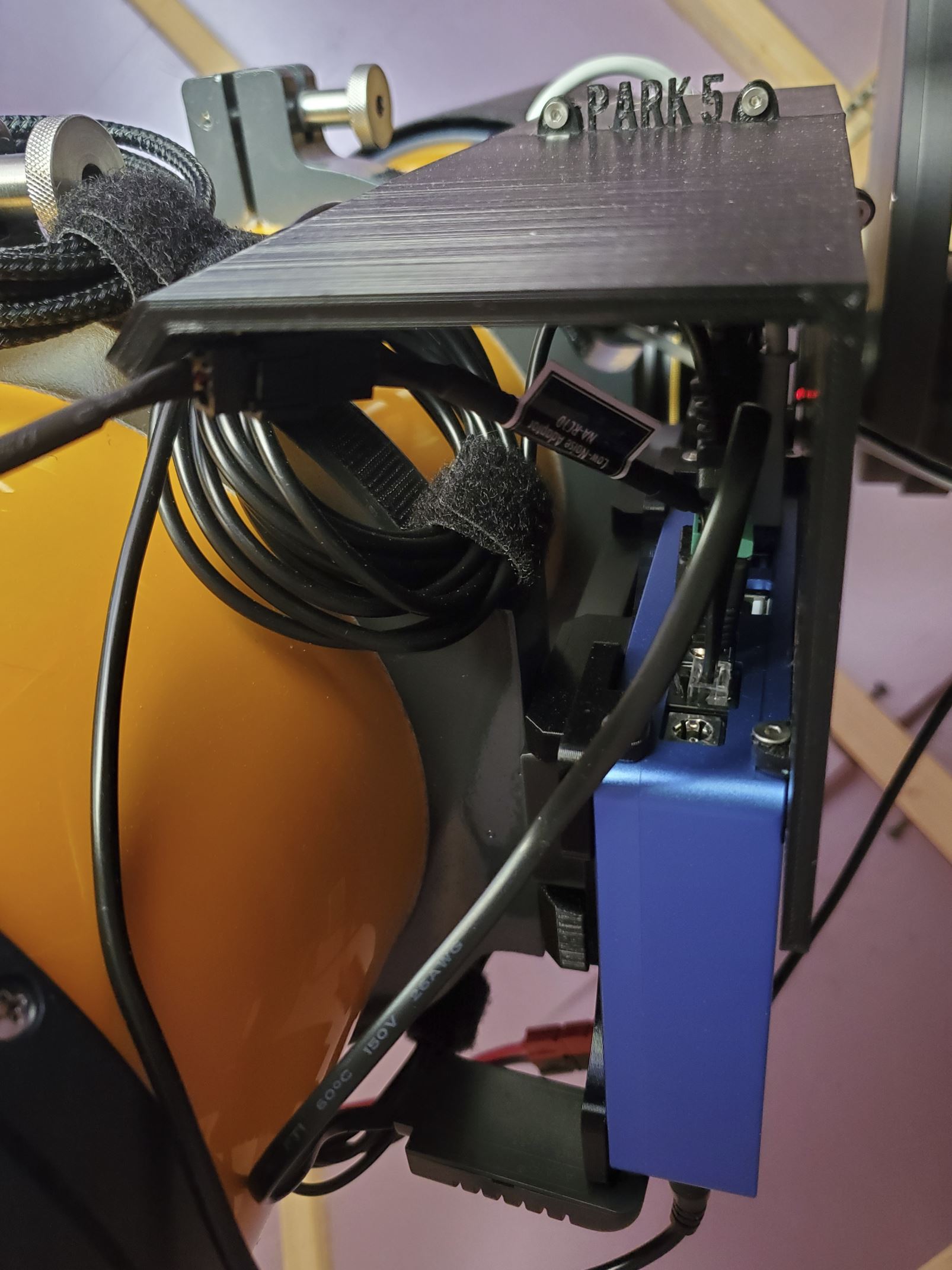

Nick Grundy: Chris, are you going unguided? I assume that box on the rear houses Powerbox etc?

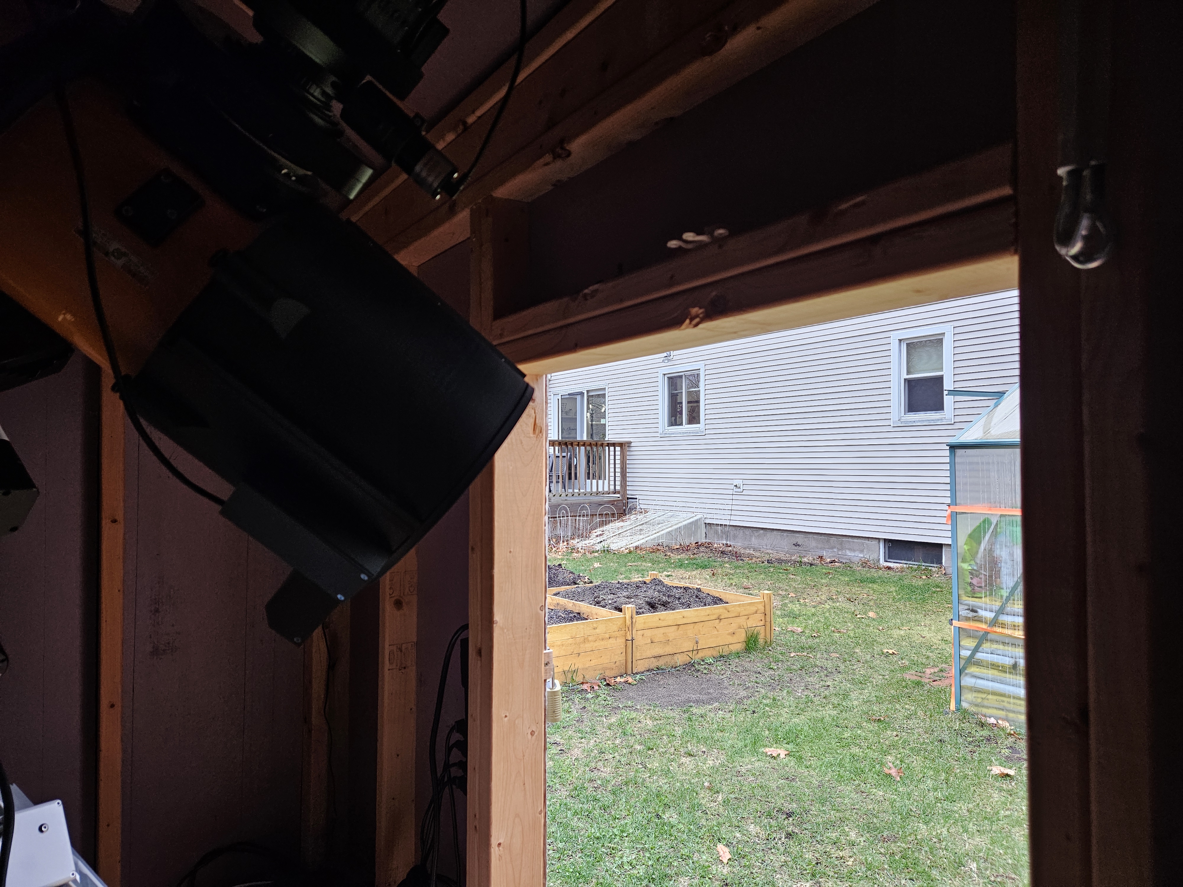

Yes, Mach2. That is actually not a box, It's just a "hat" I designed. When my rain detector triggers it puts the mount in Park Position 5, so these shrouds are in place to keep rain out of the electronics.
