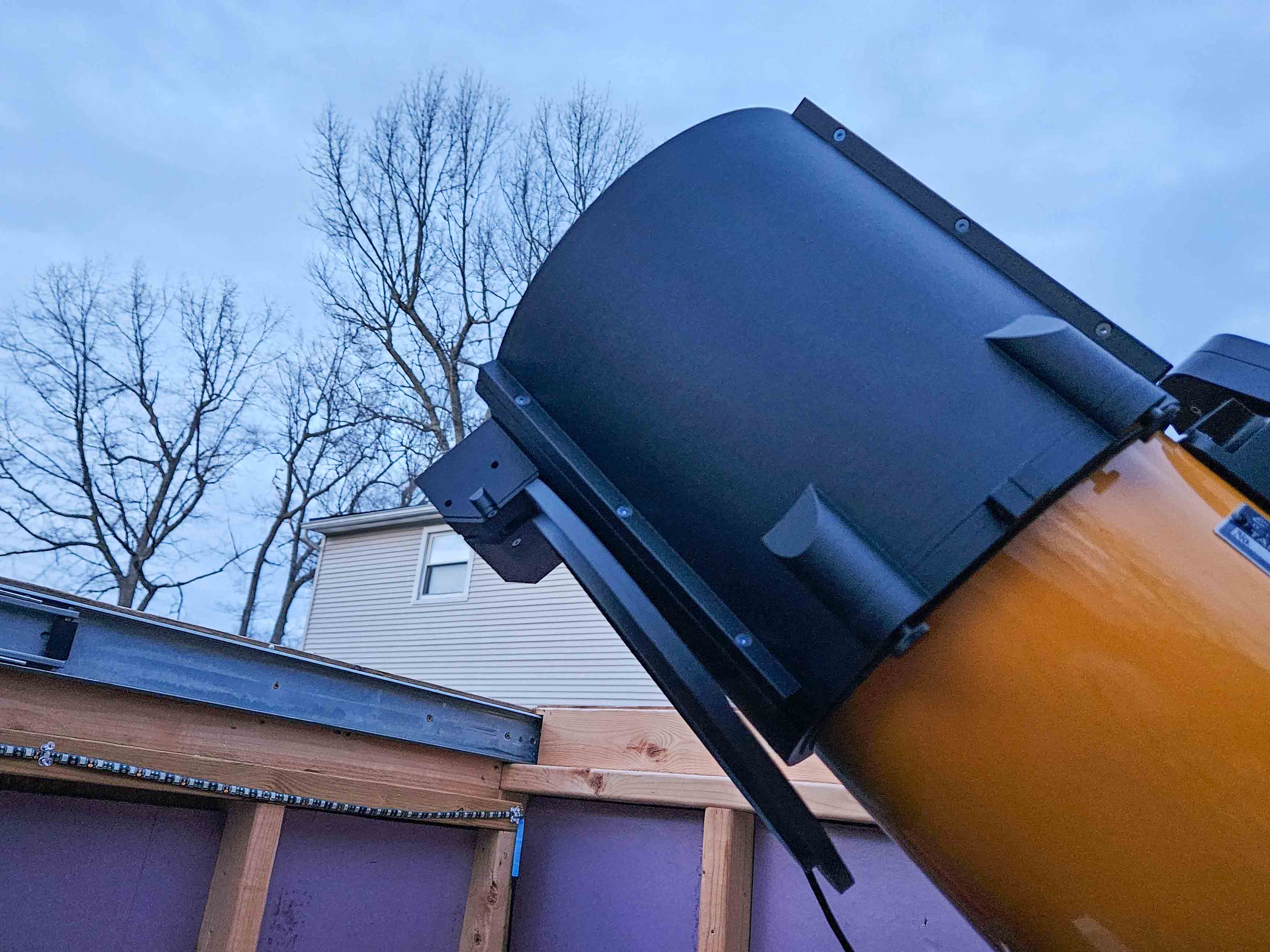

For anyone interested, here is The Deep Sky Dad flat panel on my E-130. It may or may not work well as a flat panel with the Epsilon but has a nice positive closure compared to other options so will make a great dust cover if nothing else for my remote install. The panel is heated (an option) so as not to add moisture to the OTA. I have two other options for flats at the site (sky and a large wall panel) so am not overly concerned about flats with this device, but will do a comparison once installed (early summer) just to see how it compares. DSD Flat Video |

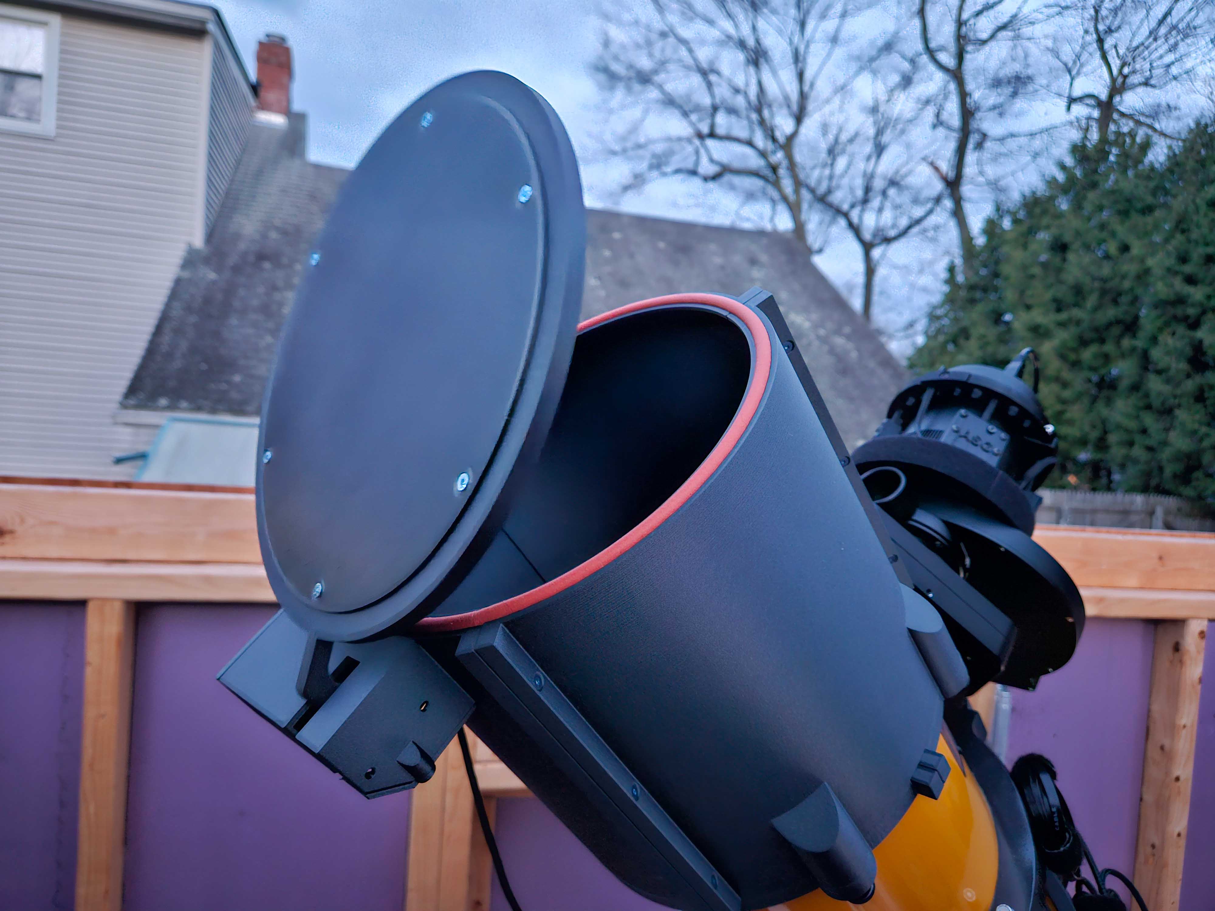

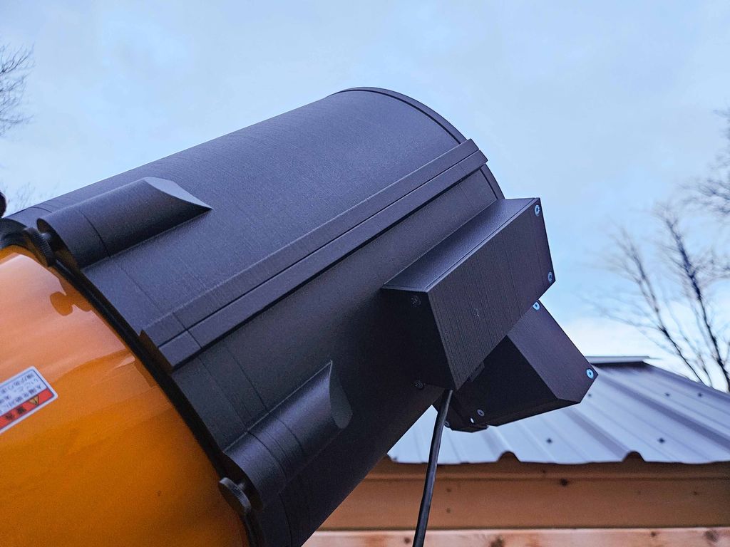

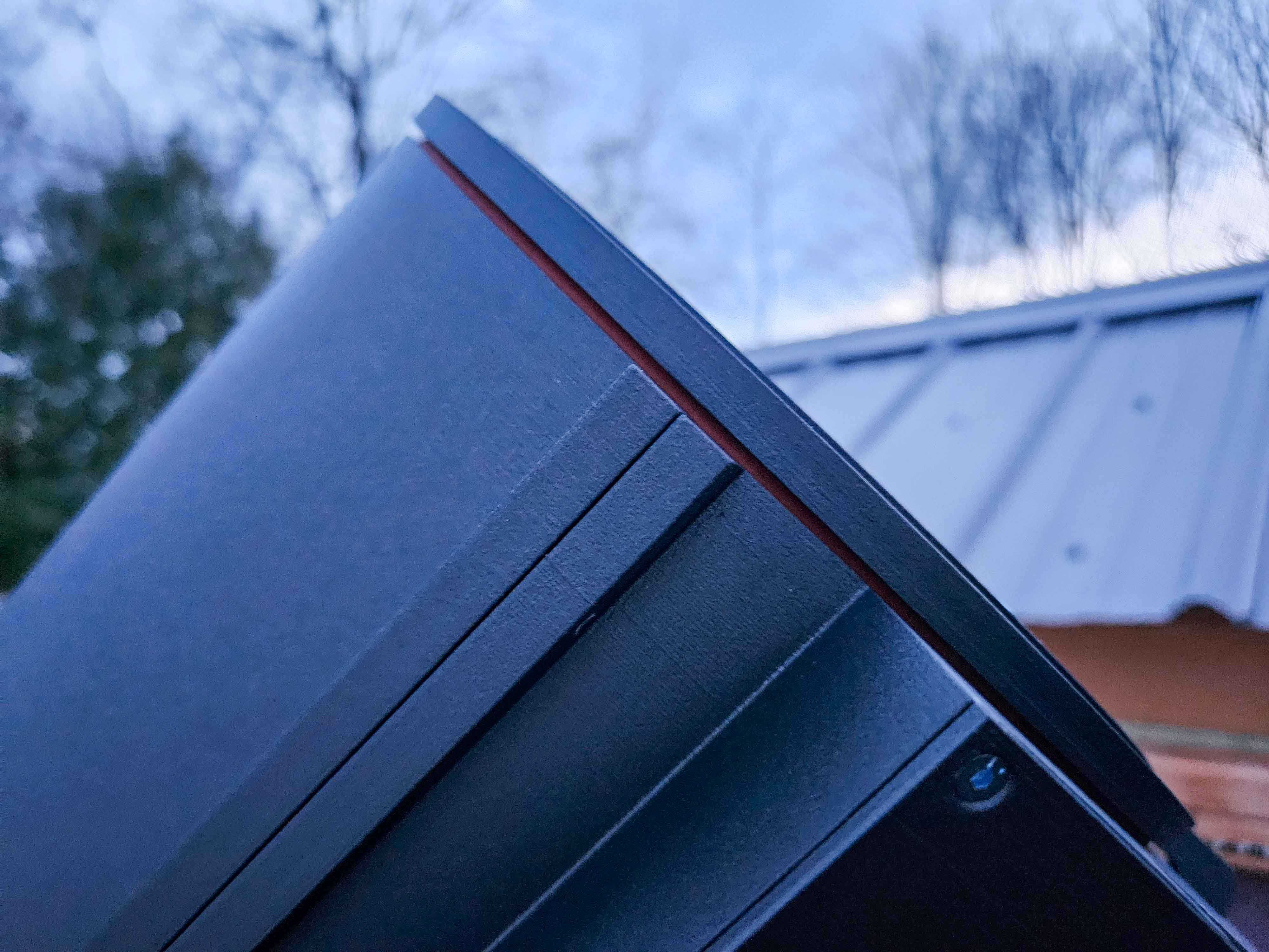

Daniel Carter: Hey all, I made a dew shield with dust/light tight cover using OPTEC motor/board. I just installed it on my scope and grabbed a few snaps. Sorry for the poor quality, it was after sunset. That is a super idea! I may have to copy that! Also, some have said that flat panels don't work for Epsilons. I just processed my first test image from my E-130 (2.2 hours of Luminance, 67 120 sec exposures of M81-82 and the IFN). I used my DSD flat panel and if there is a problem, I sure cannot see it even on the heavily stretched IFN images...
Bill McLaughlin:
Also, some have said that flat panels don't work for Epsilons. I just processed my first test image from my E-130 (2.2 hours of Luminance, 67 120 sec exposures of M81-82 and the IFN). I used my DSD flat panel and if there is a problem, I sure cannot see it even on the heavily stretched IFN images... Quick way to test to see if there is something uncorrected in the image would be to take the L master, apply gradient correction to it, then refresh the STF on it. If you see a pattern of rings appear in the image, the sky would fix that. In these countless images that have been shared with me offline, the fix every time is to not use a panel and to use the sky instead. The DSD Flat Panel has been one of many in use by folks affected by this problem. All of these were on E160ED scopes though. I have not tested nor used a 130D, and to clarify my comments about panels and sky flats has been solely about the E160ED. -Bill

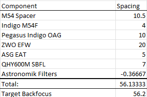

@Chris White- Overcast Observatory -- what does the backspacing of your imaging train look like with the EAT? Is it something like this?  |
Jeff Ridder: @Chris White- Overcast Observatory -- what does the backspacing of your imaging train look like with the EAT?
 That looks ok, I would just account for that 5mm or so... the EAT takes up 4mm of physical spacing, but just back it out 1mm for extra room to move around. It can move in that way a little and out about 2mm. The range is about 2-3mm in there. It's more for fine tuning backfocus, not for making up spacer kind of depths.

 Yep... that is my image train lol...
Josh Jones: That looks ok, I would just account for that 5mm or so... the EAT takes up 4mm of physical spacing, but just back it out 1mm for extra room to move around. It can move in that way a little and out about 2mm. The range is about 2-3mm in there. It's more for fine tuning backfocus, not for making up spacer kind of depths. Backspace testing with the EAT was really cool. I dialed out tilt, and then tested spacing at 0.05mm increments.
