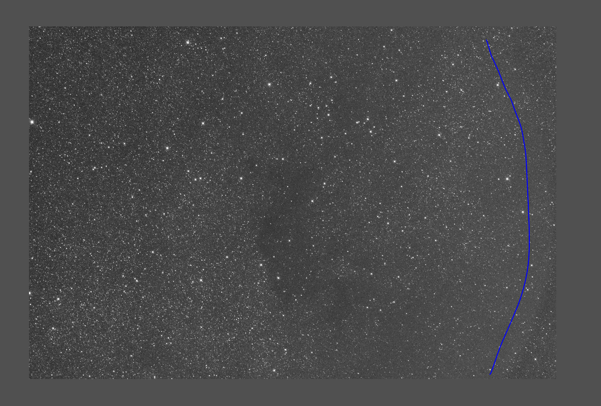

I've messed around a lot with various positions in the last few months so it's hard to find a good example (plus I mercilessly delete old data).
A current configuration looked a lot like this after calibration: The overall gradient is probably from LP. You can see the incorrected edge on the right which I drew on to highlight. This didn't start happening until I switched to a mono camera, so I assume there's some constriction occurring somewhere from the M54 to M42 adapters.image.png
Eteocles 1.51
Ok. Yeah I don’t get a pattern like that on my frames. Maybe the M42 connections are the culprit? I briefly used an M42-threaded FW with my 130D and had myriad problems that I never quite nailed down, but they all went away once I made everything M48 or M54.  I’ve just assumed since then that M42 and T2 does not jive with the Epsilon scopes.
Shinpah 1.51
What's curious is that I can push the sensor away from the hard vignetting section using the octopi and it looks fine - but then I'm contending with bad stars on that side which never seem to go away.
If you can't correct it with the right flat master then it is a light leak.

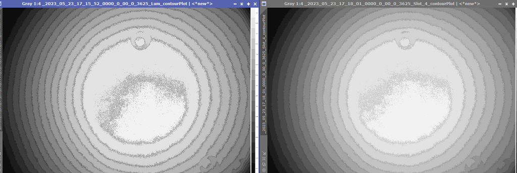

Shinpah 1.51
I realized I had empty filter wheel spot I could test in the wheel and shot a quick skyflat through one of those.
You can see the decrease in hard vignetting on the right on the empty spot vs a Lum filter on the left.
I also measured the filter depth and came up with about 8.5mm and measured the clear aperture of the ZWO filter wheel to be about 34mm; Adding in the 17.5mm focal flange of the risingcam 571 + another .3 for the octopu and you get a amount that the filter suitabilty guide says needs more than 34mm of clear aperture. so I guess buyer beware for this combination.

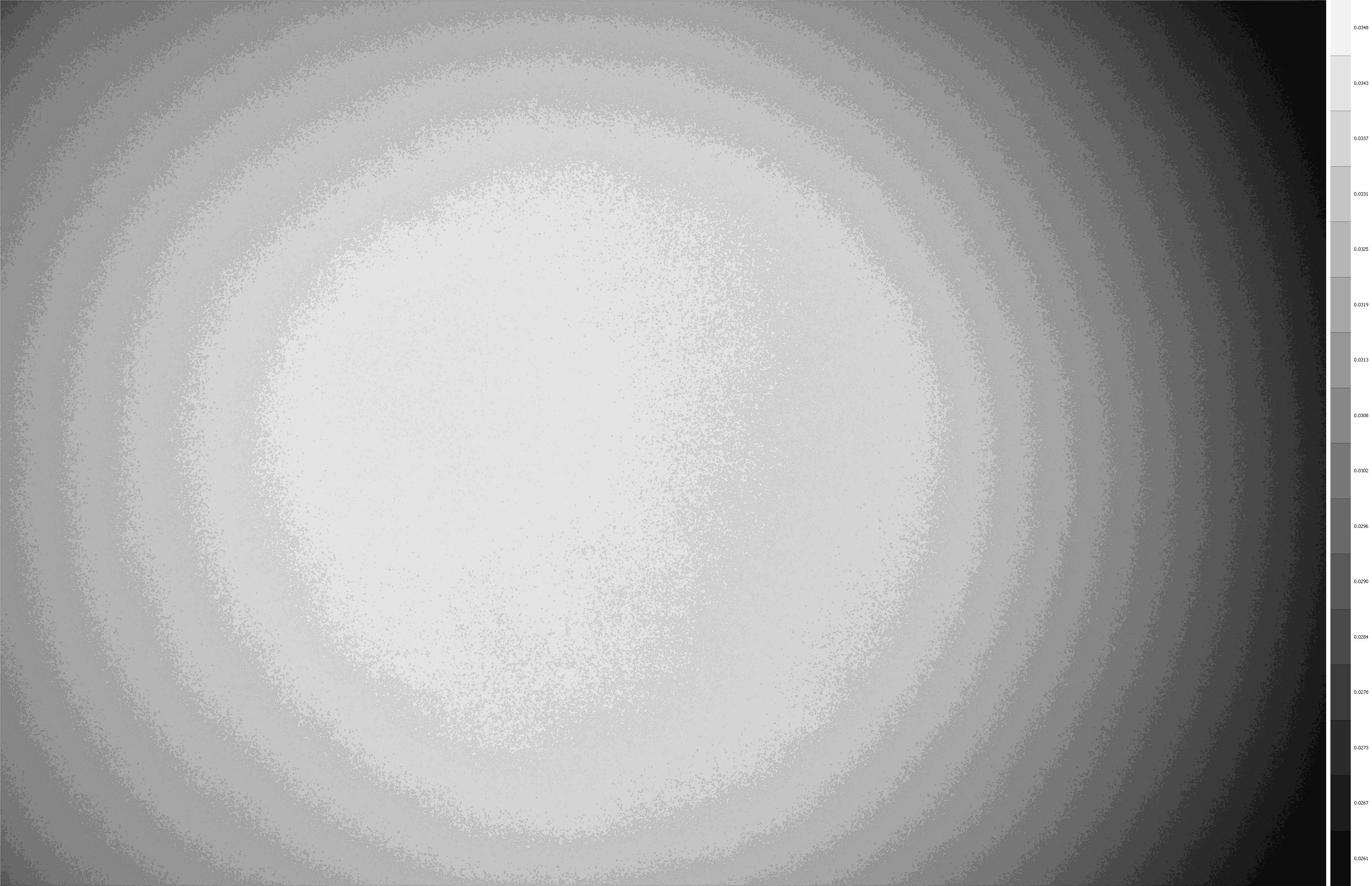

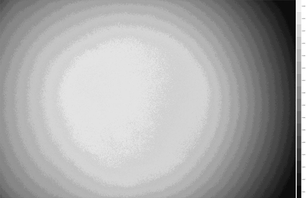

Eteocles 1.51
I get uneven vignetting with the 130D with or without a filter wheel.  Even when I used the 268C with the filter screwed directly in front of the sensor, I got the same vignetting pattern I get now.  Mine looks similar to yours but the darker side is on the right of the image rather than the left.
This is a flat I just took with the 2600MC, filter mounted in a ZWO filter drawer with M54 spacers and gender changer.
Flats taken through my 268M and CFW3L with 2" filters have the same pattern as above.  The ones from my 268C looked a little different but still clearly had the right side darker.  The only thing in common between all three setups is the M54 gender changer.
