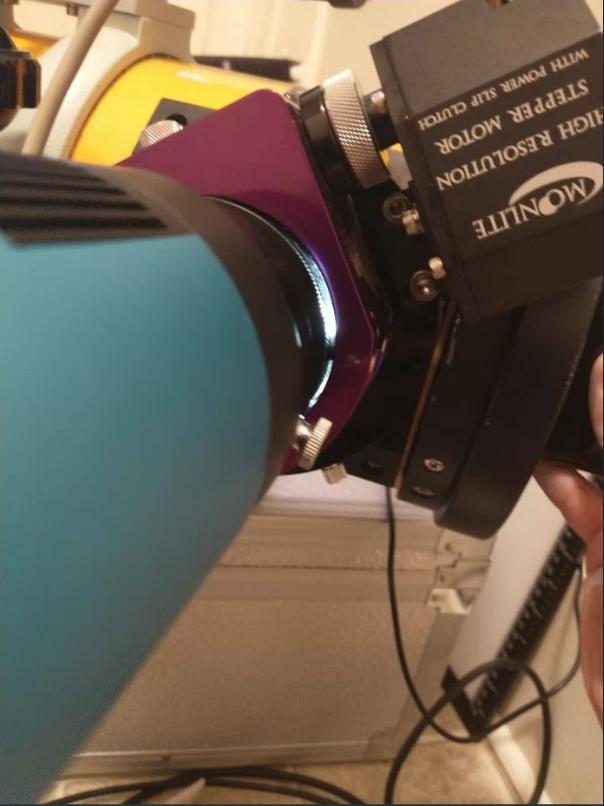

Hello Shinpah,
I haven't noticed the light leaks your are talking about. It could be at the base of the saddle and that could be solved with some gasket past.

Hello Shinpah,
I've resolved it, but mine was here (and also a trivial amount from the flange to the OTA)
ThierryBoufflet 0.00
Strange 8-O. I have just check mine with a light in front, I have no leak. Maybe I have a new version focuser. I bought it a month ago.

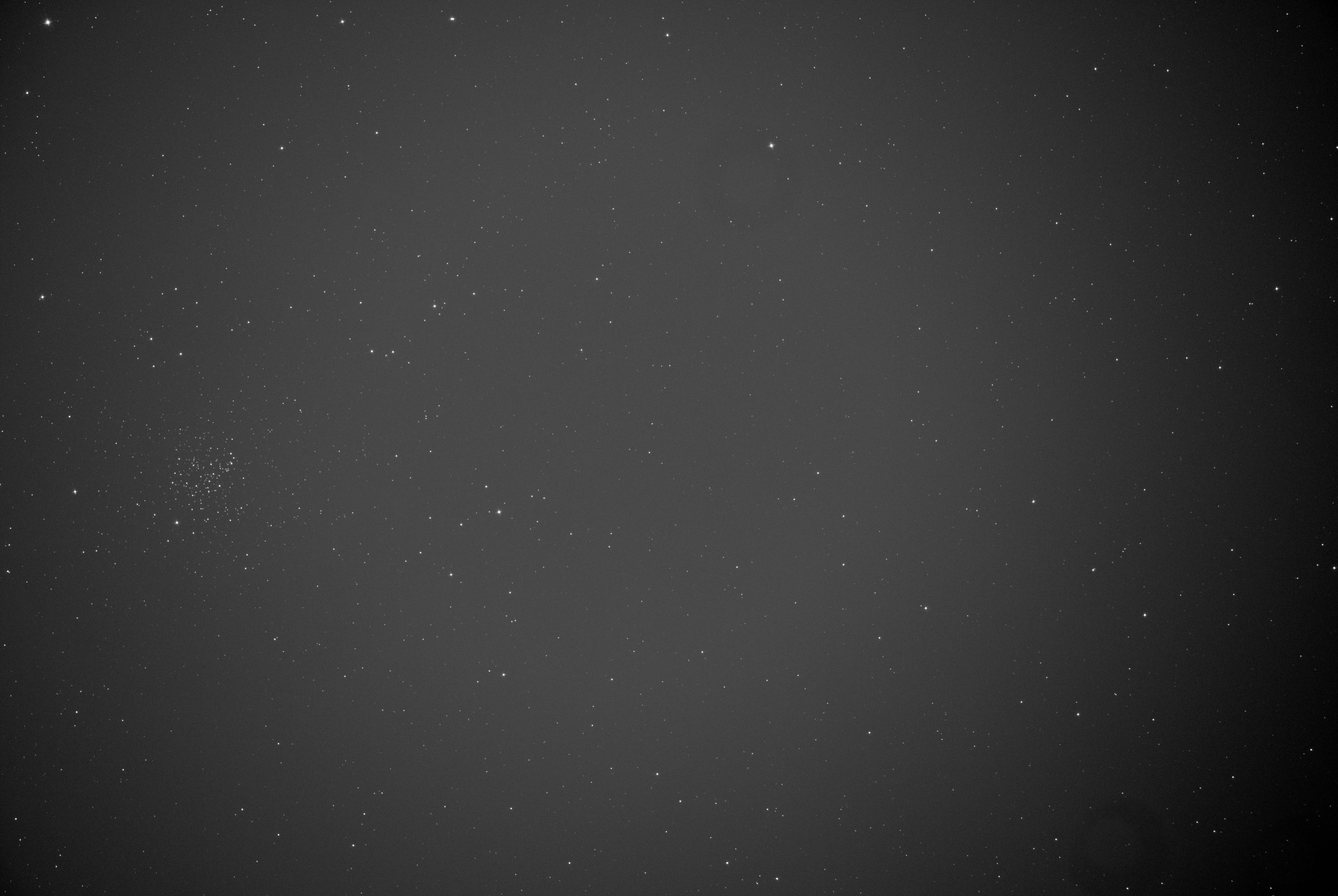

I wanted to do an update to my efforts to pick some more brains.
I ended up getting an octopi and started really digging into hocus focus and the aberration inspector and have mostly (down to about 12 microns +-) corrected the tilt (it's still mostly apparent in the bottom left).  My current issue is this persistent astigmatism that doesn't respond to collimation.
You can see that the right side of the image has bird stars. I've tried nailing the collimation down as precisely as I can, and it doesn't make any difference.
I've also tried looking at various states of miscollimation to see if slightly offsetting the primary/secondary alignment in different combinations would shift around the bird stars to a different section of the frame/change their shape. It doesn't.
I'm willing to accept that this is still in fact a collimation problem. But if that were the case, wouldn't my efforts to miscollimate have an effect?
I am at a stage where I think this could be a bad mirror.

I very much don't think so. Your issue is still with the combination of tilt and coaxiality between all the various elements (primary, secondary and corrector) but you are nearly there from what I can see from the image.

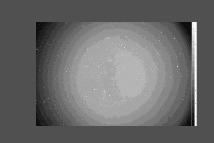

I've been having this other interesting issue where I have this uneven vignetting that's appeared both pre and post-octopi:
It shows up as compressed vignetting on one side that doesn't quite flat calibrate out. Touching collimation doesn't seem to alter it so I assume it's some misalignment of the filter wheel path and the sensor.
