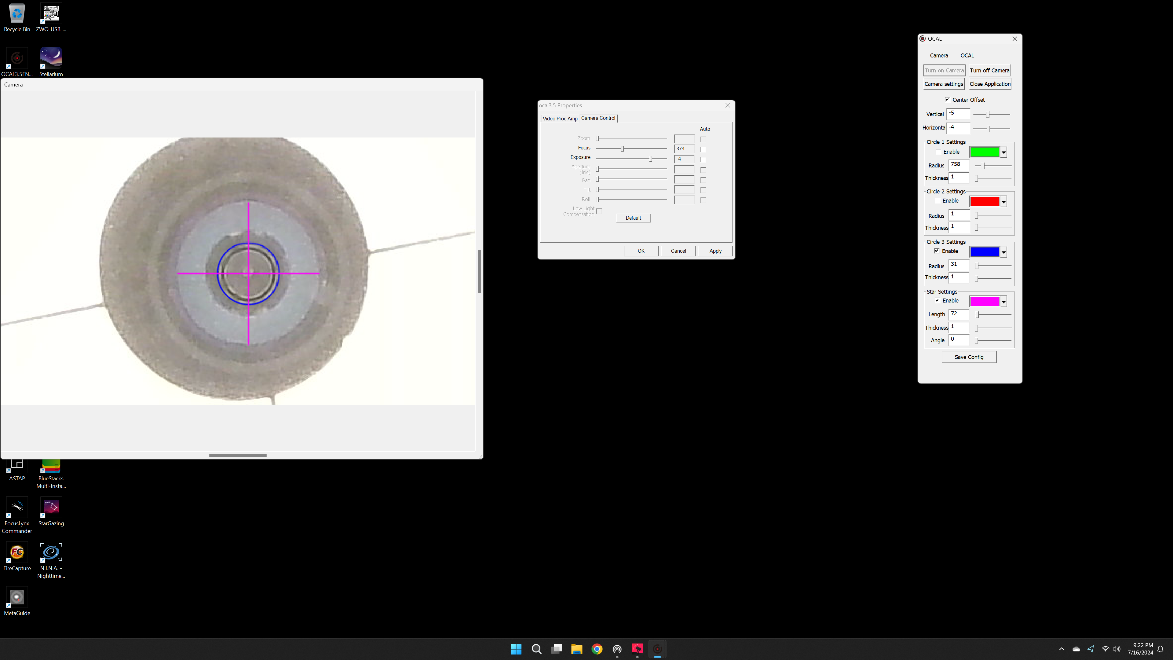

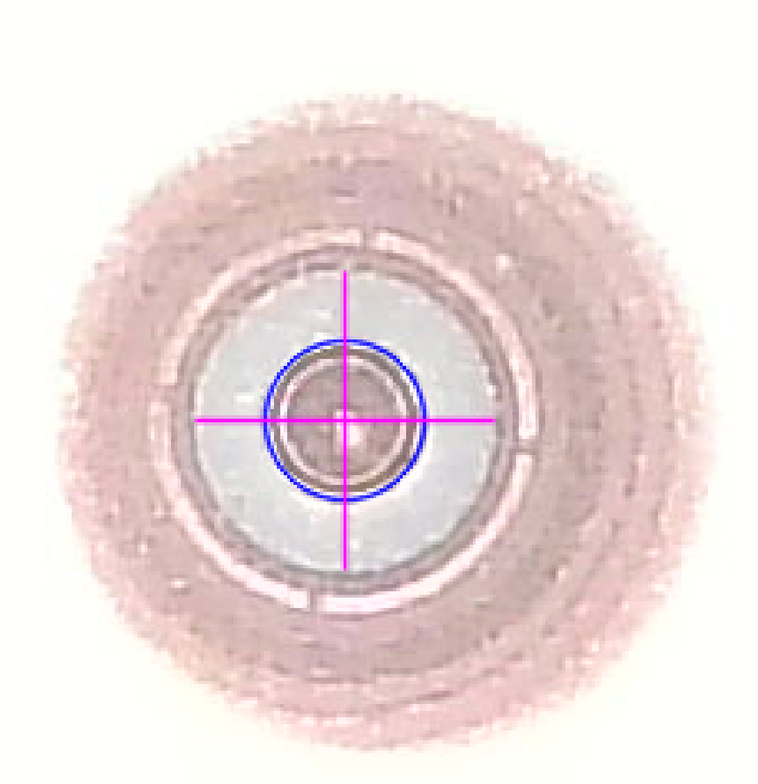

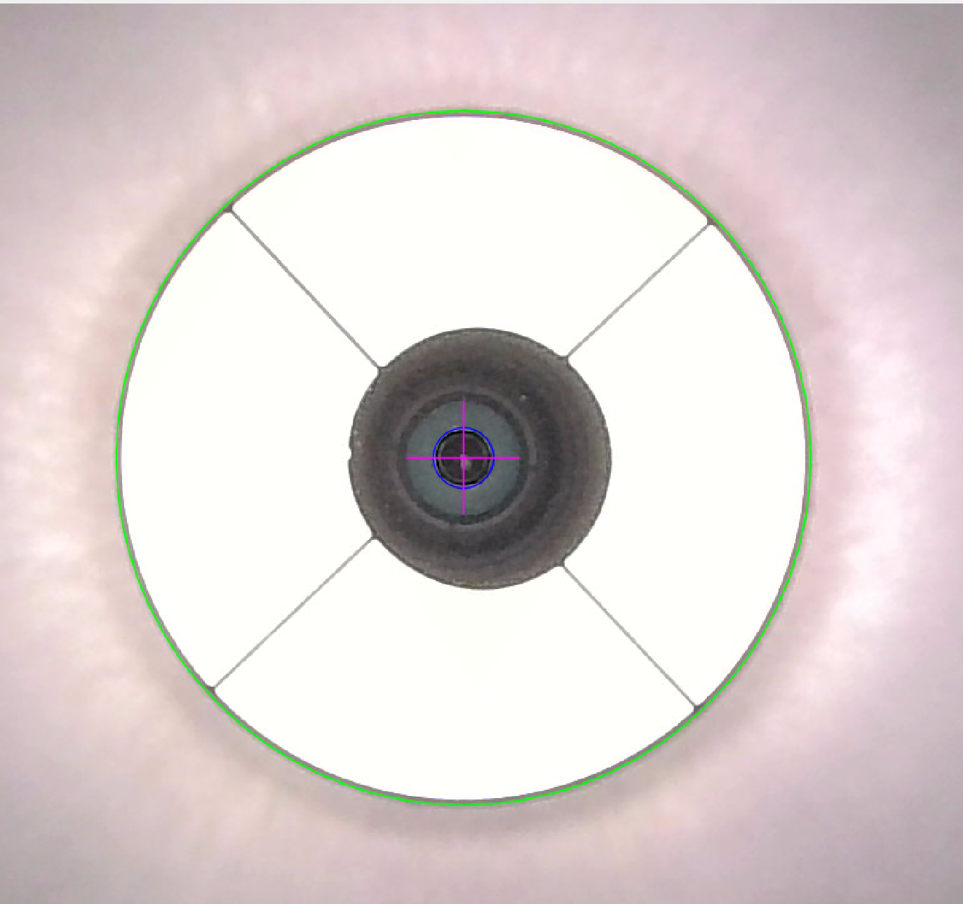

Just an update on my attempts to collimate with the Ocal on a full frame sensor. I kept having an issue with the bottom left corner looking worse than the other corners on my 6200mm full frame sensor, no matter the focuser position. Here is what my Ocal looked like:
I ended up using the Ocal last night WITH the native f3.3 corrector on, and I feel I got better results. It wasn't very far off, just needed a couple of nudges on the secondary. The primary mirror looked ok. I didn't try to get it perfect.

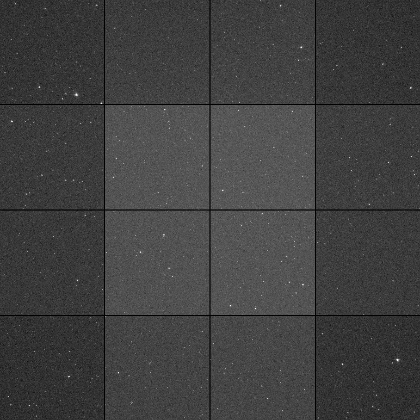

I managed to get the field "mostly flat" but the clouds rolled in. I think I have to adjust my backfocus at this point to get better stars in the corners.

I got the Tak tools, but I personally found the Ocal to be more precise and easier to use. What I did is I used the Tak collimating tube to dial the offset on the Ocal while it was screwed on. That way I knew it was exactly how it would be with the Tak Eypiece.

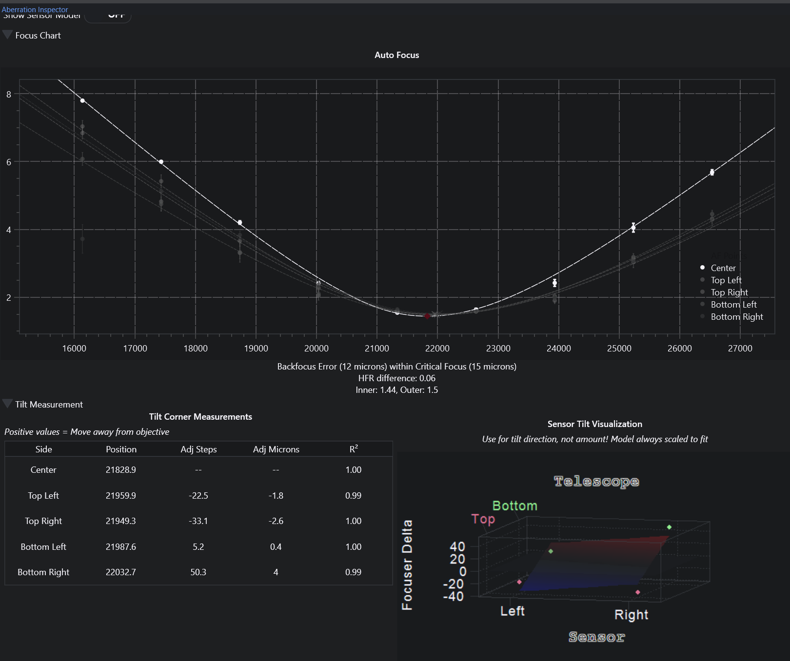

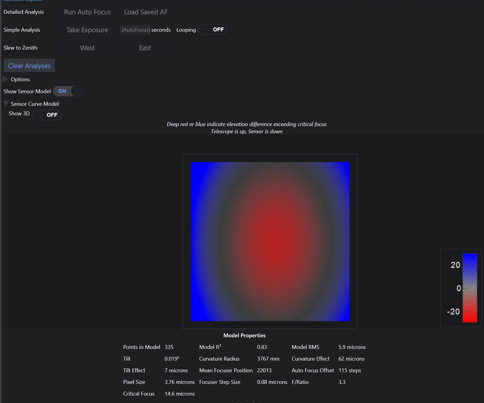

Why do you think so? The worst one was the bottom right. Hocus focus thinks it is about 4 microns away from the center focus point. Critical focus is 14.6 microns according to HF. But all four corners seem to be aberrent radially towards the center which suggests a backfocus issue to me.
Not saying you are wrong, but wondering what the thought process is?

Did you actually fill out your focuser step size accurately in Hocus Focus? Thats what it uses to give you the measurements in microns. If you leave it as default those numbers can be used as a reference but aren't exactly accurate. At the end of the day it probably doesn't matter whether you tune back focus first. I'm just of a mind that I would want to make sure my field is flat before concerning myself with sensor distance.
Yes I did. The Optec Leo is 0.08 microns per step according to the manufacturer. It is an extremely small step size.

I see. Well there definitely is a backfocus error but the one corning being visibly worse than the others is an indication of tilt so you'll need to address both.

https://takahashi-europe.com/assets/uploads/SPOT-DIAGRAMS/Epsilon-130D_spots.png  Your stars look appropriate
