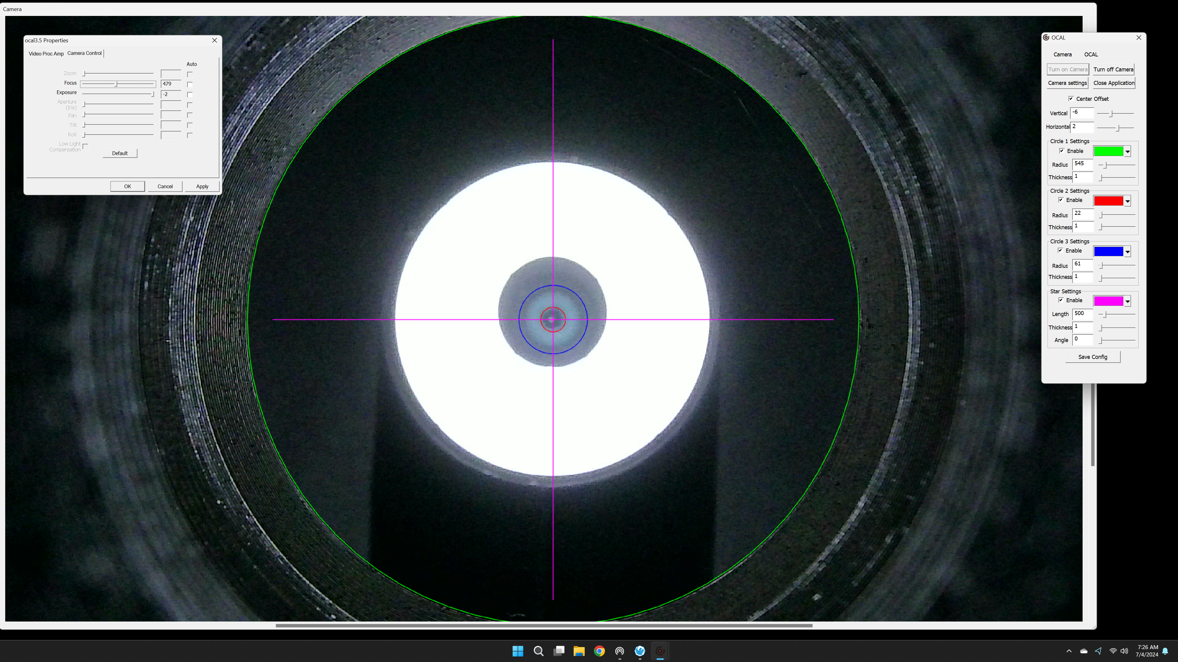

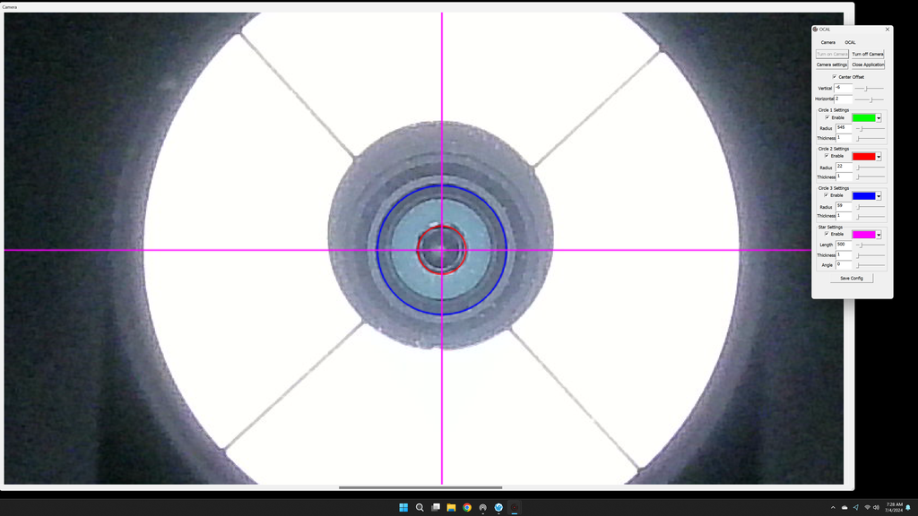

I finally put my Ocal V3 without the corrector with the stock focuser in preperation for upgrading to the Optec Leo Focuser. I have not touched collimation since I purchased the E160ED from Takahashi and picked it up my self. Been imaging with it for a few weeks. Here is what I got. Are the circles drawn where they are supposed to?
Looks pretty darn close to me?
