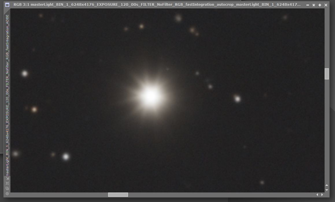

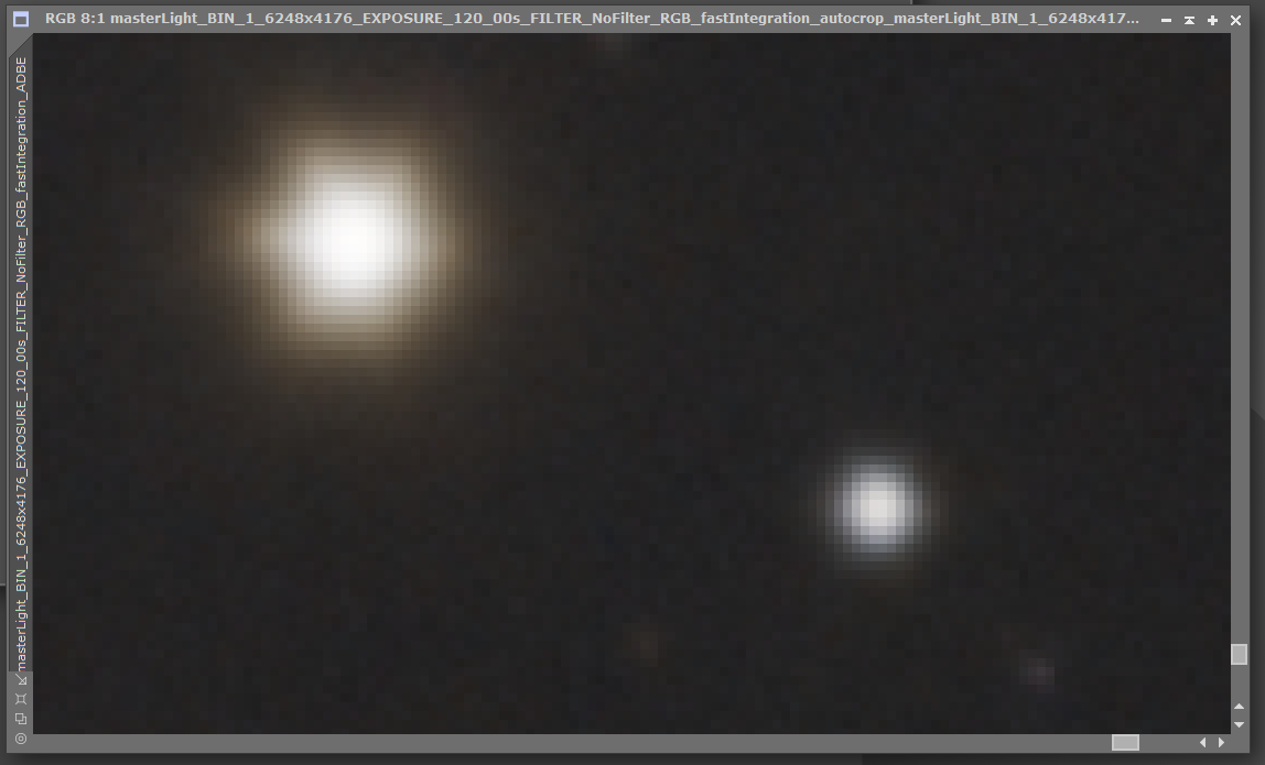

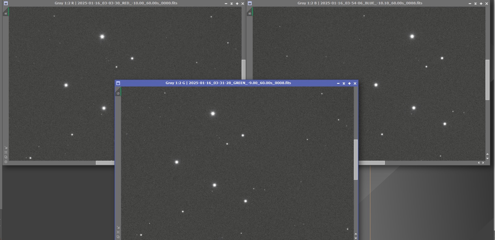

I just replaced my 8” SCT for a SkyWatcher Esprit 150.  So far I am happy to report that the first light shows the field is 100% flat.  BUT…(there is always one in this hobby…) when I look closely at the frames, the bright stars have 6 point spikes on the images taken with the red and green filter.  The issue is not that noticeable on the blue filter (odd, right?).
The temperature at the remote observatory has been below 0°C, so my first thought was: “damn…this scope has pinched optics”.   But I find it weird that the artifact is not that noticeable on the blue filter  (it also shows on HA and SII, not so much on OIII) .  Tonight (weather permitting) I will take more test frames with all the filters to see what comes up.  I am already talking with the shop that sold me the telescope.  I will document everything for SkyWatcher’s Tech Support to evaluate the issue, but I will appreciate if you can take a look at the issue and give me your thoughts.
Thanks in advance for your help!

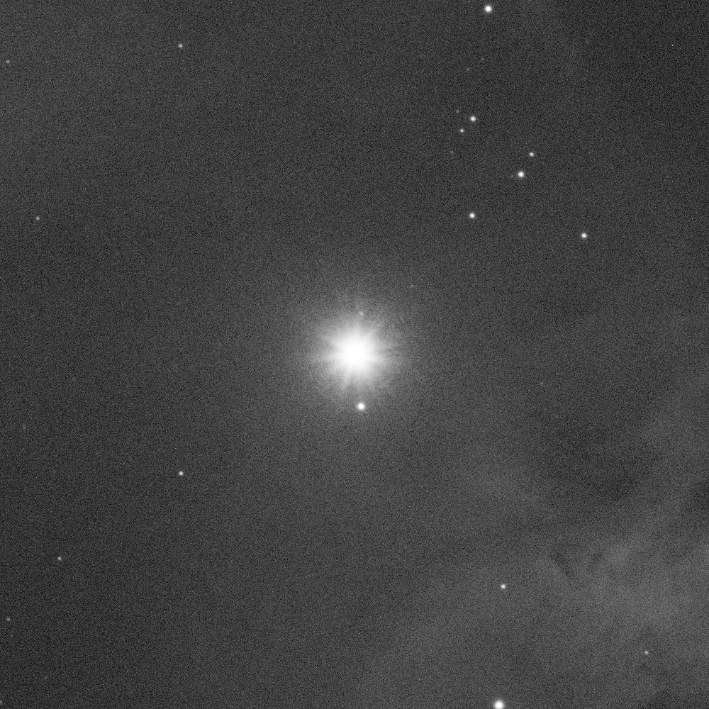

Got same "problem" with my 150ED that I purchased a while ago. Due to bad weather my first real chance to test it was a couple of nights ago.
This is from a stack of 212 subs (120s), aprox 7 hours.
Slightly stretched with GHS after gradiant removel (Seti ADBE), SPCC and NXT (70%). No BlurX used on this one.
Optical train is Antlia combined OAG and filter holder, but no filter in the holder, and the asi2600mc.
2 pics, large star in the first, heavier zoom at the bottom right corner in the second.
Subs are taken at minus 8 celsius and normal seeing for the coast of northern Norway.

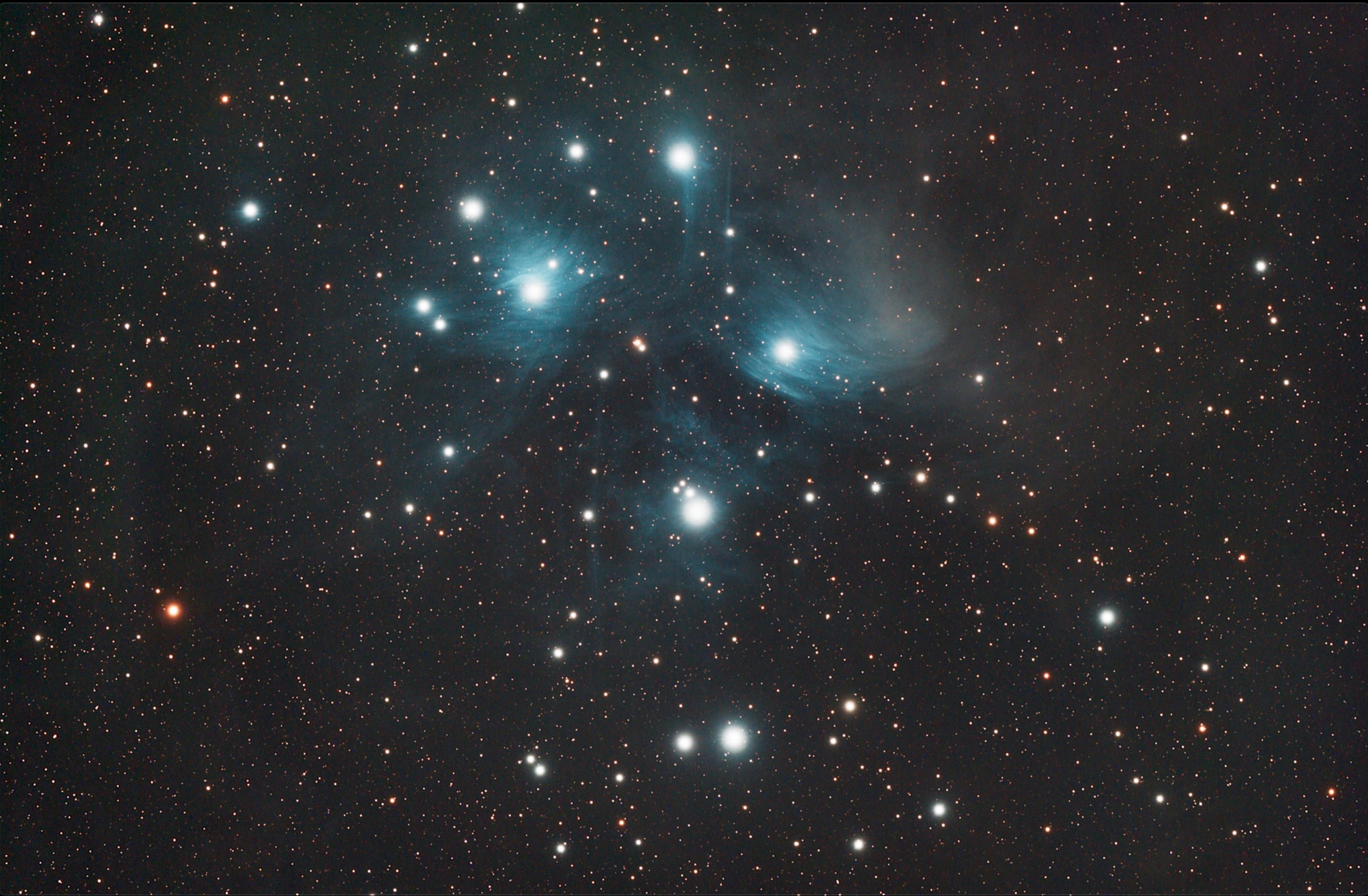

This is what I get from My Esprit 100, here in the U.K., this was taken at -2.5 degrees centigrade, a few weeks ago, with a powerful dew strap on 75% power, around the outside of the dew shield above the lens cell. Straight from the camera, with just stretch and background removal, BUT no BlurX
I am more than happy with this.

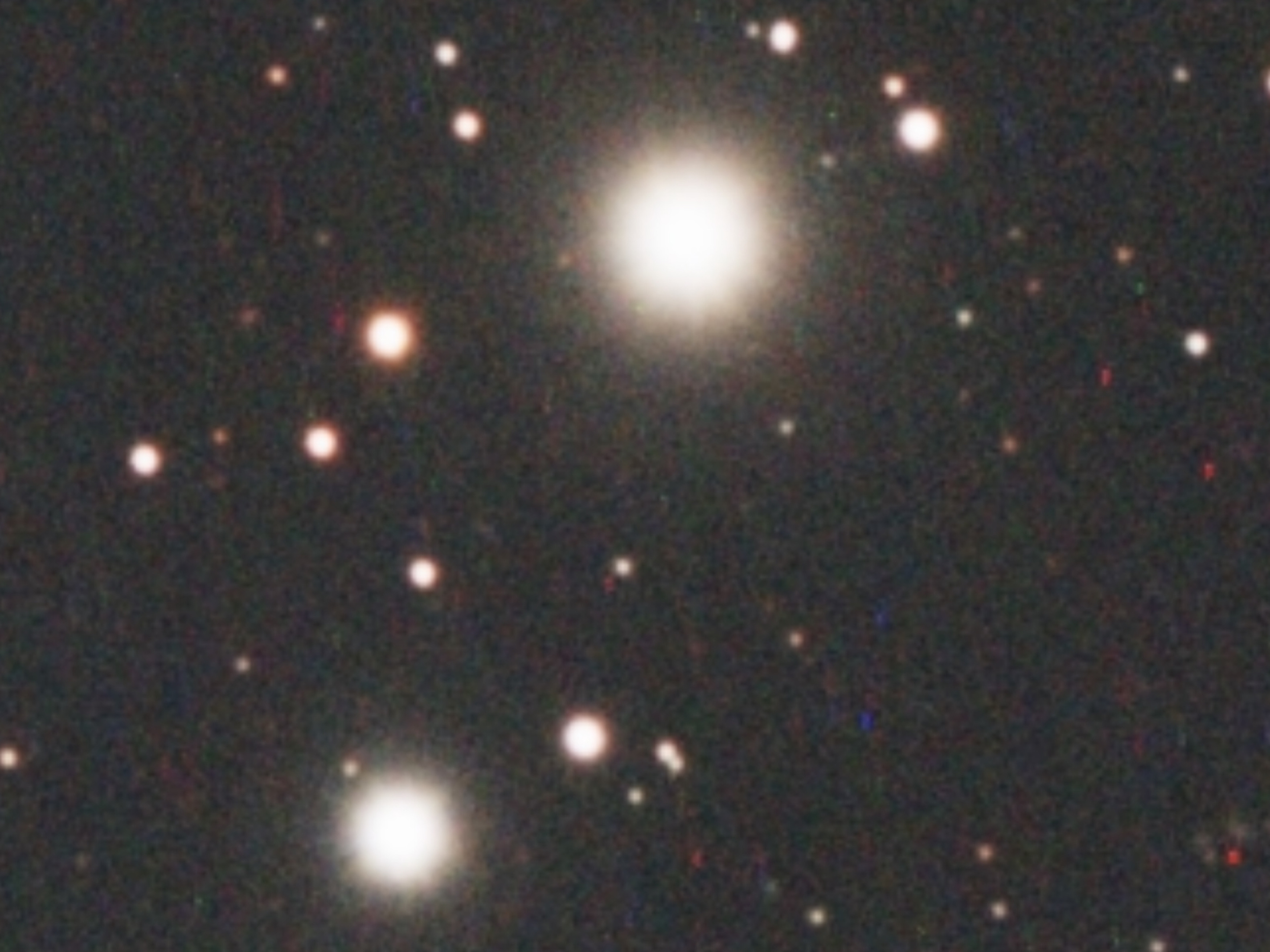

StewartWilliam 5.21
This is the final image the above example was taken from, as I said no BlurX just a slight crop, stretched and background calibration, did not even use any calibration frames.
