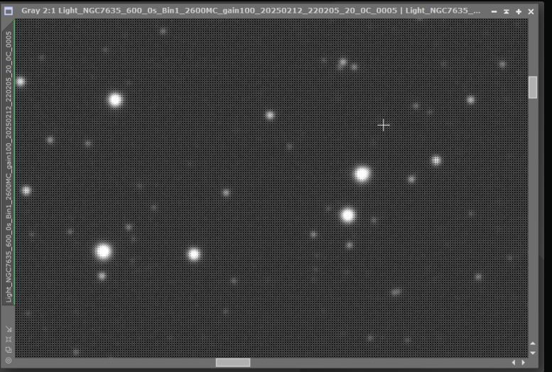

"Should" is saying there is likely something wrong with his scope or something else in his setup. And sorry for getting your dander up for asking to verify which temperature scale you were using. I'll bow out…

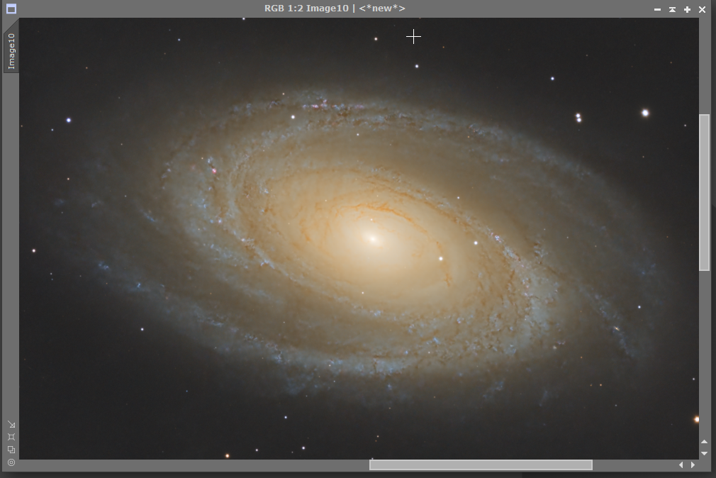

I've sent over a mail to FLO to hear what they say. Here's a crop of a more or less finished picture of M81-Bodes. Have deleted half of the subs, so this is 5h48min. I guess that one could live with it like this, but I'd really like a scope that produces perfect stars.  |

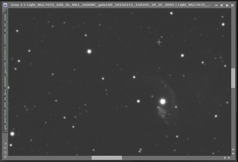

This is an interesting effect and it’s not easy to completely explain where that pattern comes from. Sometimes I even see this kind of stuff that varies sub to sub from my 24” RC. In the refractors, I’m wondering if it might be due to birefringence in the one (or more) of the elements induced by mechanical stress. As the temperature goes down, any material with a positive CTE should decrease in size—not increase. That means that if mechanical stress is being applied to a lens, the lens cell must be getting smaller faster than the glass as the temperature decreases—and the manufacturers should account for that in their design. That may also be why a heater strap wrapped around the lens cell may be effective. If there is mechanical stress, that can induce birefringence in the glass, which conceivably could produce the kind of pattern that you folks are reporting—particularly if it’s happening in more than a single element. One way to test that theory would be to put a polarizer in front of the telescope and rotate it to see what happens. The other way would be to put a 1/2 wave plate in front of the sensor to see if the pattern disappears. The problem with either of those ideas is that you would need high optical quality components—and that’s hard (and expensive). Either way, it seems like the manufacturers of these scopes need to think a bit more carefully about how to better athermalize the cell design.
John Hayes: This is an interesting effect and it’s not easy to completely explain where that pattern comes from. Sometimes I even see this kind of stuff that varies sub to sub from my 24” RC. In the refractors, I’m wondering if it might be due to birefringence in the one (or more) of the elements induced by mechanical stress. As the temperature goes down, any material with a positive CTE should decrease in size—not increase. That means that if mechanical stress is being applied to a lens, the lens cell must be getting smaller faster than the glass as the temperature decreases—and the manufacturers should account for that in their design. That may also be why a heater strap wrapped around the lens cell may be effective. If there is mechanical stress, that can induce birefringence in the glass, which conceivably could produce the kind of pattern that you folks are reporting—particularly if it’s happening in more than a single element. One way to test that theory would be to put a polarizer in front of the telescope and rotate it to see what happens. The other way would be to put a 1/2 wave plate in front of the sensor to see if the pattern disappears. The problem with either of those ideas is that you would need high optical quality components—and that’s hard (and expensive). Either way, it seems like the manufacturers of these scopes need to think a bit more carefully about how to better athermalize the cell design.
John Thanks for your view ! I fulle agree, if this is due to temperature it should be possible to handle. So far I have only had the chance to test my scope two nights, both with temperatures between minus 6 - 9 C. Hope to to see temp well above freezing in order to check if problem still exists.
John Hello John! Thank you for chiming in John! You are one of the people I most respect in this hobby. It is is greatly appreciated! Skywatcher is graciously accepting for me to send them back the telescope to check it out. But...(there is always one in this hobby, isn't it) after 5+ years in this hobby without big pockets to spend on high end equipment, overall I am very happy with this telescope. The color correction is really good, the field flattner works great....The only thing that bothers me is the shape of bright stars at low temperatures. As the temperature increases the shapes improve, but at +7 C I still see some of diffraction. It doesn't look the same across all filters...It is more noticeable on the red and green filters. The blue looks almost perfect! All of this makes me wonder if it is worth to take the risk to dismount such a big, heavy scope and send it via courier (risking falls and mishandling) hundreds of kilometers to SW's shop in Spain. Part of me says that I have to accept that this is the normal behavior of its three-element air spaced lens and there is not much more that can be done to fix this (I don't think they will redesign the lens cell just to fix my scope). Do you agree? I am processing an image I took of IC 405 (under less than ideal conditions) to decide whether or not I want to send the scope back.
Hey, I'm a little late to this one, but as an Esprit 150 user, I can say I don't see this issue in my scope. I do however, have about a half hour of acclimation to go through after astro dark as it cools off where I do see some issues that look like pinched optics. Lately, it's been down into the teens farenheit, so I don't see any serious cold like some do.

Gunder Strømberg: I've sent over a mail to FLO to hear what they say. Here's a crop of a more or less finished picture of M81-Bodes. Have deleted half of the subs, so this is 5h48min. I guess that one could live with it like this, but I'd really like a scope that produces perfect stars.
 I think that is deffo a bit of piching of the optics, the 6 points on the stars represent the 6 collimation screws around the lens cell, and as they are all a tad tight it causes this effect, not something you could really do yourself.. ☹️

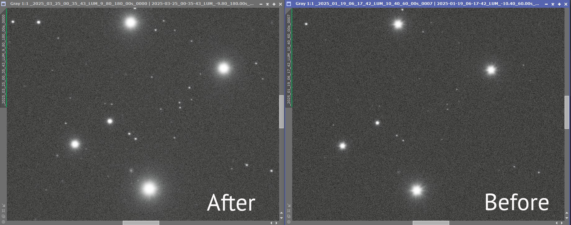

Wanda Conde: Hi John,
Today I sent the scope back to SkyWatcher. Tech team told me that the lens is held in place by 3 screws. These screws are threaded into the lens cell (a massive piece of machined aluminium). I these screws are too tight, the metal contracts and the glass tightens a bit. If that's the case all they have to do is loosen the screws (and in the process, you will also collimate the tube). Whether the solution is that simple or not remains to be seen. In any case I will keep pressing on until the issue is fixed.
Thanks again for taking the time to look into this.
Wanda Hi Wanda, So that completely explains why there were 6 spikes. Loosening those screws should fix the problem. Good luck with it and let us know how the fix works. John

Well for those of you interested in how it all ended, here is an update: Last week I received the telescope back. It took longer than expected as bad weather in Spain didn't allow the repair team to perform the last check which has to be done out in the field. The temperature has increased as the Winter is over and Spring arrived. Luckily as soon as the telescope arrivedthe temperature at the observatory dropped around 0 C and I was able to take some frames of the same cluster where I noticed the problem back in January. At 0 C the improvement is remarkable. How will it hold below 0C will have to wait until next Winter. I have high hopes because the issue was still noticeable around 7C. Here is a comparison where you can see the difference:  I have to mention that while the "Before" image was taken on a crisp, clear night with great seeing, the "After" image was taken on a night with terrible seeing, high clouds, etc... as bad as a night can get. Like I said before, the final test will take place next Winter...Until then I am quite happy with what I got. CS everyone! Wanda
Wanda Conde: Well for those of you interested in how it all ended, here is an update:

Wanda Thanks for the update, that looks much better. As I mentioned earlier I have added dewheaterbands both on, and next to the dewshield, as well as on the flattener, and my stars got much better. I have had same trouble with bad weather, so final tests will have to wait til September. Regards Gunder
CS everyone!
Wanda Thanks for the follow up Wanda! I suspect that you may need better seeing to know for sure, but that result looks very promising. John
CS everyone!
Wanda The stars are much bigger and softer now, which would mask any issues anyway, I don’t think the focus is bang on, or they have made adjustments to soften the stars to mask the issue, which is what Askar do with there scopes, as they are well known for larger more bloated stars, which cover a multitude of sins, I am really not convinced that they have sorted the issue for you, just hidden it, time will tell 🤔
