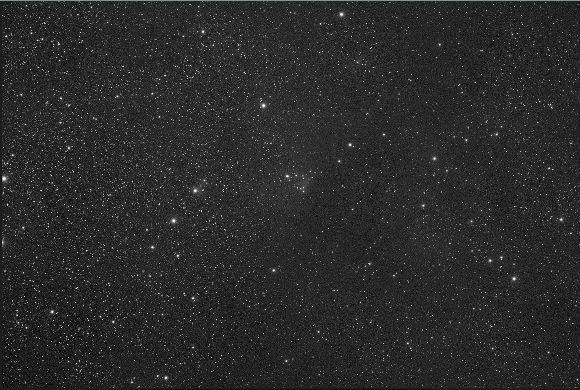

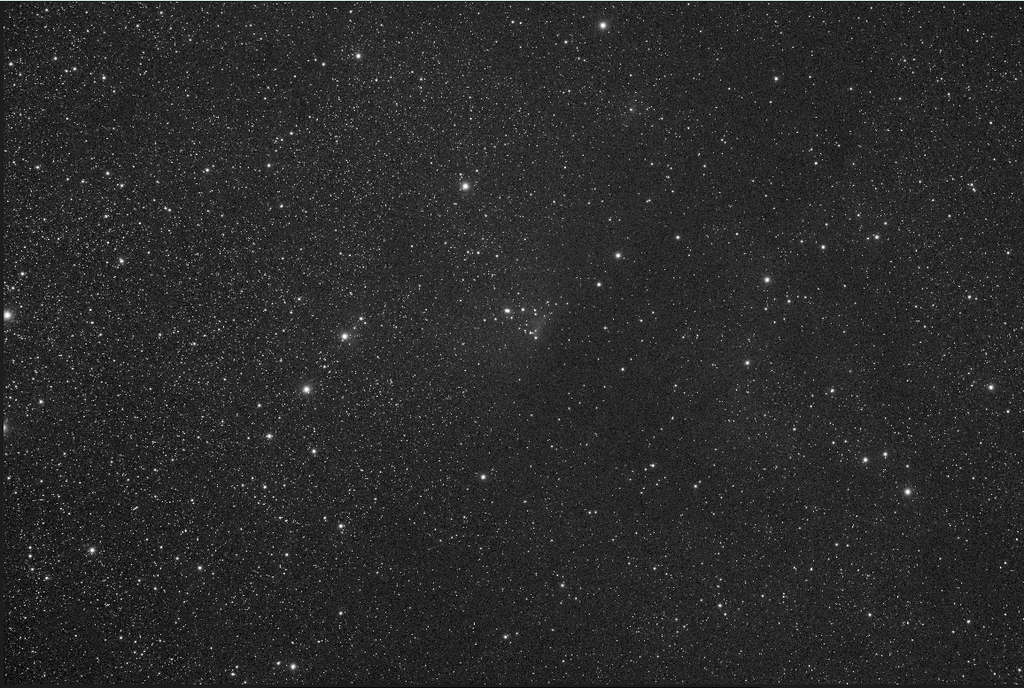

Jandro.rm 0.90
this is one light from my setup. Is not perfect 100% but i agree. As soon i process with Blurx the stars are perfect
AstroStew 0.90
Can’t tell as the image is way to compressed to see any stars clearly when zoomed in

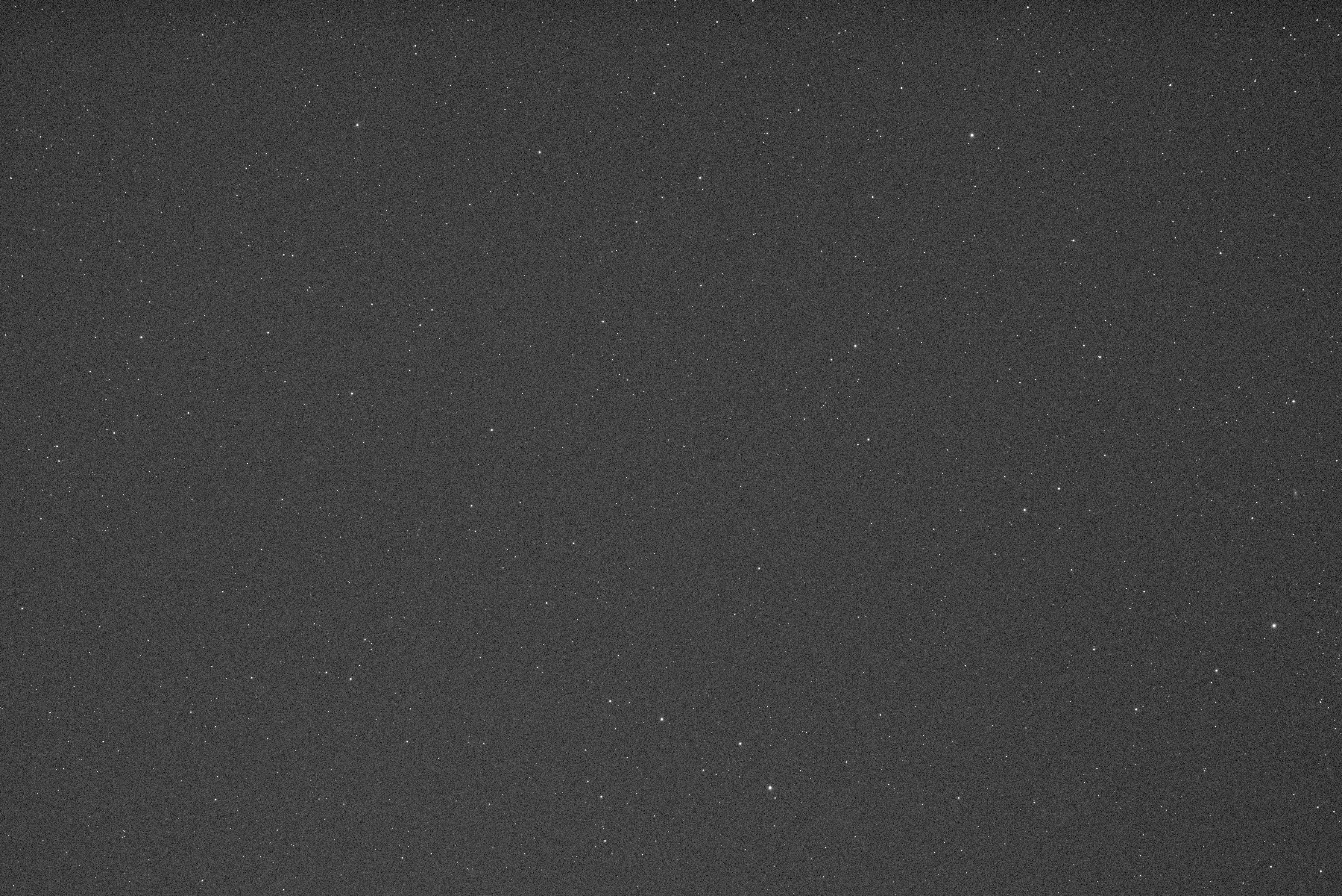

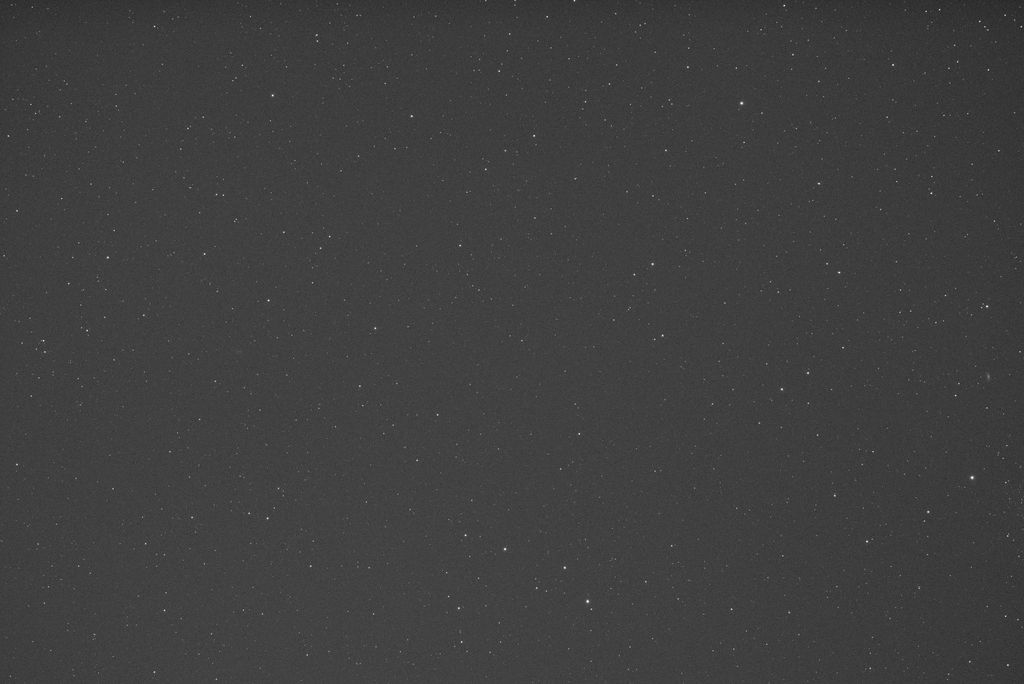

AstroStew 0.90
This is as good as I can get straight from the Esprit 100 with the dedicated flattener and un cropped, with an APSC sensor, and it’s far from perfect…(I may not have quite nailed focus) and my scope had the Zygo check and it’s properly collimated, and a very nice 0.97 strehl.
Link below so you can see full res image as it’s a max of 1mb on here which is awful…

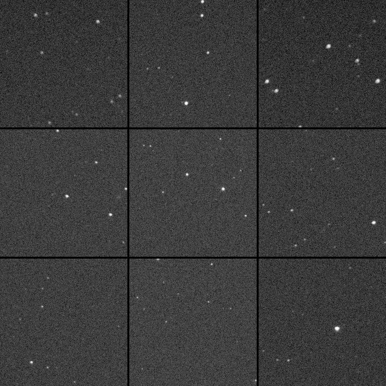

kaxmuster 0.00
I got my Riccardi Installed on the esprit 100 and the tilt adjusted (still not perfect but acceptable, blurxterminator will do). My back focus is at 78.8 mm. Sensor is IMX571

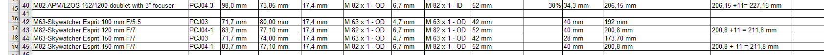

OlivierPM73 1.20
on APM site you can find an excel  with those information:
source : https://www.apm-telescopes.net/en/apm-riccardi-apo-reducer-075-x-m63-small
